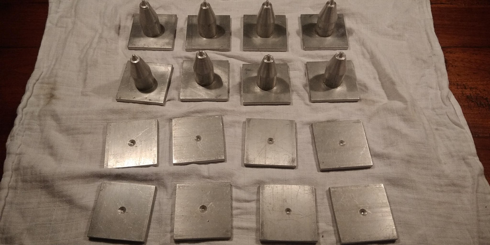

The DIY spikes, ready to be back in action (after some 20 years in the attic) ones the FB-820 speakers are finetuned.

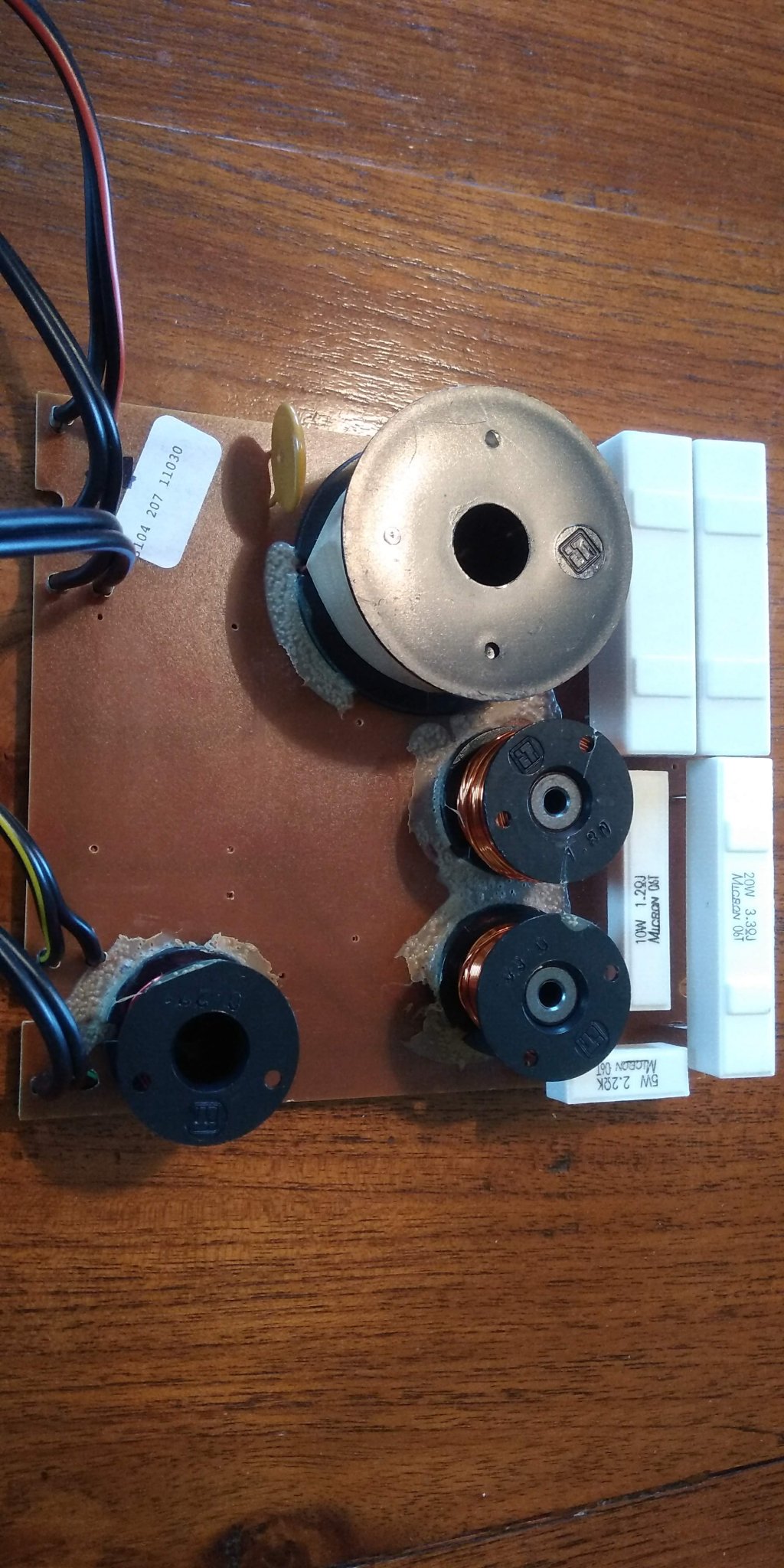

Galu, I've been looking around at the many options (among them is Mundorf) and ended up with the following replacement capacitors:
2x JANTZEN AUDIO ELECAP Electrolytic Capacitor 100V 22µF 5%
2x JANTZEN AUDIO ELECAP Electrolytic Capacitor 100V 3.3µF 5%
4x JANTZEN AUDIO ELECAP Electrolytic Capacitor 100V 33µF 5%
2x JANTZEN AUDIO ELECAP Electrolytic Capacitor 100V 8.2µF 5%

From this list I think that 3.3µF is the capacitor series with the tweeter. This capacitor is better to be a film capacitor, not very expensive one but film capacitor. The rest are OK.
It's nice you start about this because I thaught about it myself too. But I'm a novice and didn't dare, not knowing if the different voltages of a MKP capacitor matters or not. I read two things about it recently (but with soooo many opinions about it):
1 - The mid/higher frequencies benefit especially from better (MKP) capacitors. This is I guess your reason for suggesting a different 3.3uF capacitor.
2 - the higher the voltage, the better. So, I guess a Dayton Audio film/foil 3.3uF capacitor with 250V should be okay then?
The idea is nice, also because of limited space on the crossoverfilter not being an issue anymore as one bigger capacitor should be possible.
Let me first check if the 3.3uF is indeed the one for the tweeter. Thanks for your input.
Personally, I did not feel any noticeable improvement when switching from a 63V capacitor to a 250V one.
From my point of view it is not worth investing in capacitors with snake oil, as I consider these. A 63V capacitor is sufficient for peak powers of 450W/8Ω.
So a 63V-100V capacitor is enough and fits even better in the available space.

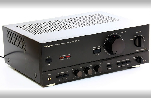

I already ordered the Jantzen capacitors so I'll stick with them. In time I want to take on my vintage amp too (Technics SU-V670) so, with all these many 30 year old capacitors in the audio path already I'm simply happy once they are replaced by brand new ones. I'll leave the true high-end stuff to the others, wether snake-oil or not...I really don't know. Thanks again for your input.

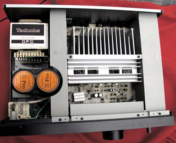

It seems you have read about that popular diy pastime, replacing ageing electrolytic capacitors in vintage amplifiers.
Be aware that this poses a greater challenge than recapping a loudspeaker crossover, so be prepared to do your preparatory homework!
The large power supply electrolytics in your quality Japanese amplifier are likely to be within specification, even after 30 years.
The time to take action on those would be when your amplifier begins to show audible signs of distress, such as hum or buzz.
Until such time, an occasional internal inspection to look for any visual signs of component distress may be advisable.

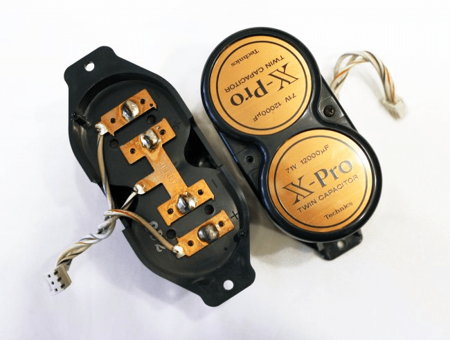

And those twin X-Pro capacitors are pretty special!
"Each X-Pro capacitor is in fact two-in-one. The cans are copper topped and potted into composite materials for less vibrations and even less magnetic leakage."

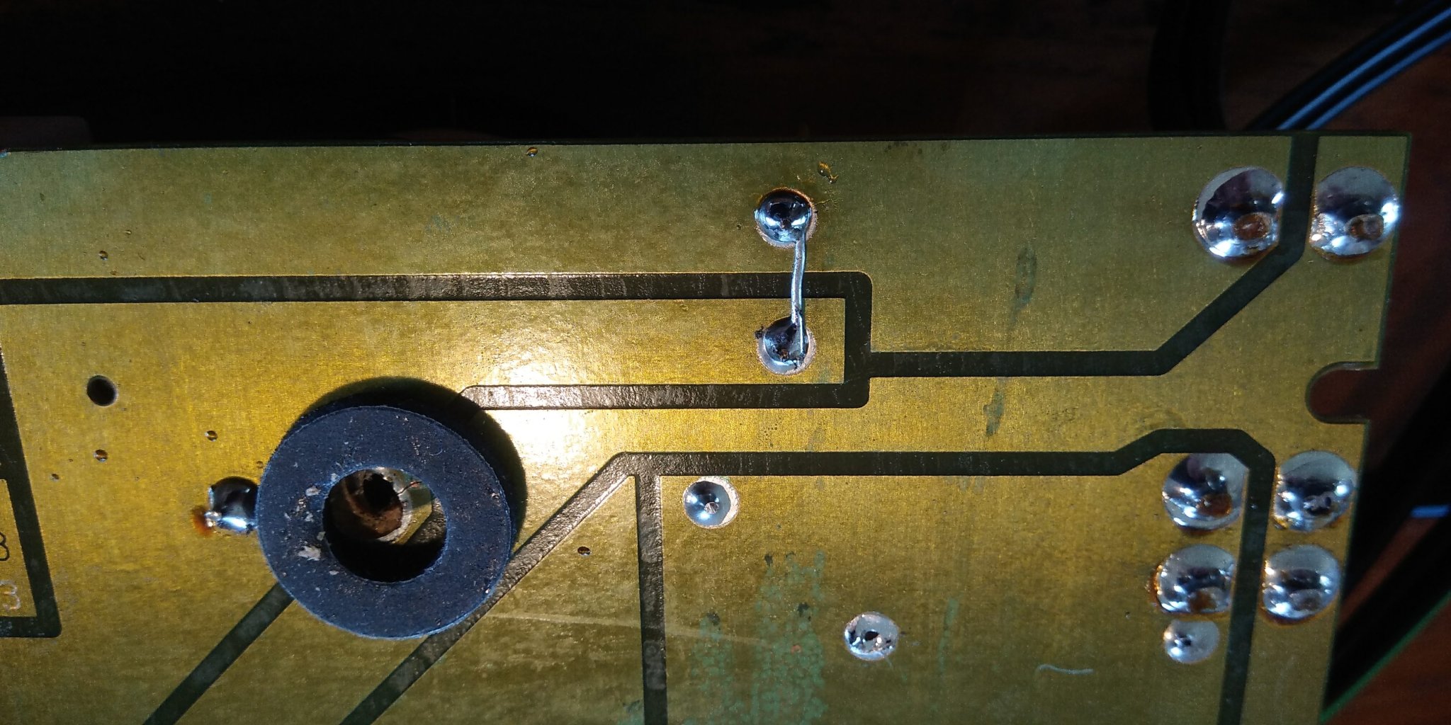

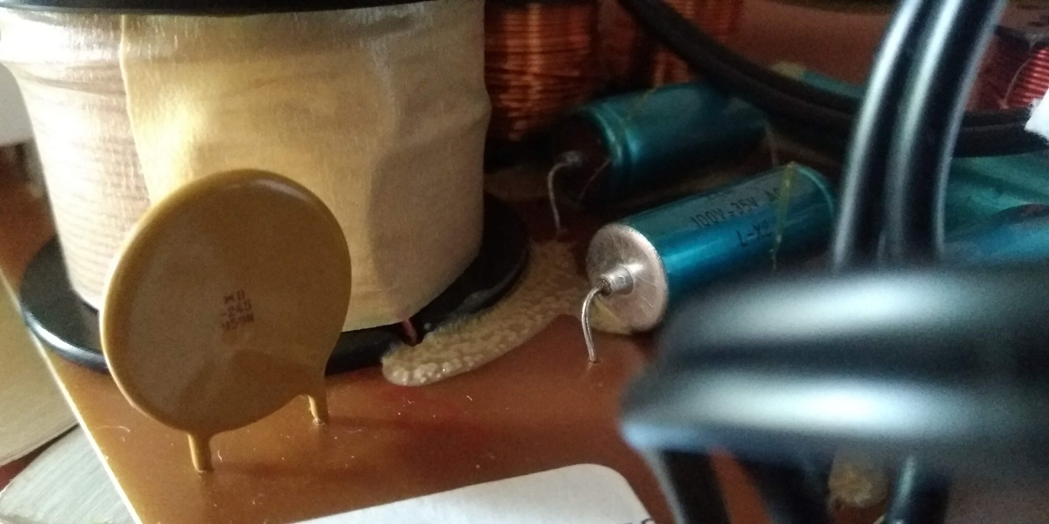

Regarding the PTC resistor on my Philips FB-820 crossover filters: How would you guys by-pass it?
1 - Simply by making a direct connection on the downside of the board and leave the PTC?
2 - Remove the PTC and make a direct connection on the upper-side of the board?
I'm thinking of the first option.
By the way; I want to remove it from the audio chain in the crossover to make the chain 'cleaner'. And I do not need the tweeter to be protected. My Technics SU-V670 never exceeds volume set to halfway so I have no risk whatsoever to blow it. Thanks for any input regarding option 1 or 2.
PS The PTC is the round yellow/brown component sitting in front-left of the picture.
Remove the PTC and replace it with a wire link.
Or leave it on the board and short it out with a wire link on the underside of the board.
Either option will work while not disturbing the signal path.
So today I did some preparatory work while waiting for the new capacitors.
I removed the old capacitors, cleaned the board from glue residues and then bridged the PTC resistor (see two pictures attached).
I choose to leave the PTC attached and simply connect it directly on the underside of the board.

By the time I place the new capacitors, is the use of certain glue very strict or pretty flexible? The original glue is like a kind of melted glue which has hardened.
When I use new glue, can I use general glue, as used in construction etc. or do I really need a glue specially dedicated to electronics?
My gut feeling is that it can be a flexible choice as long as it becomes pretty hard after drying. I will simply mimic the way the old capacitors were covered with glue. Thanks again for any input here.
