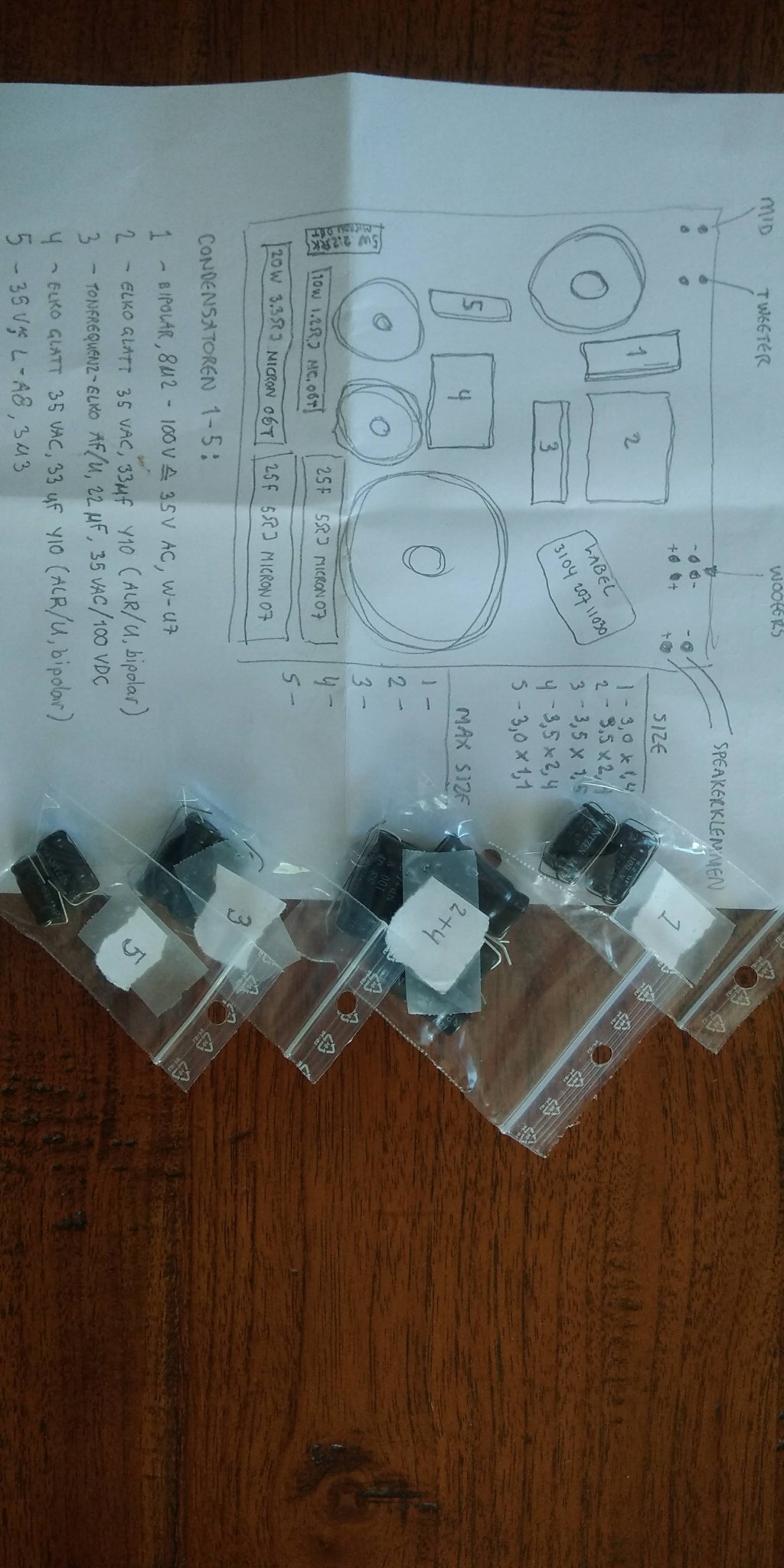

Well, amazingly enough the new Jantzen capacitors arrived this morning! Waaay sooner then I expected.

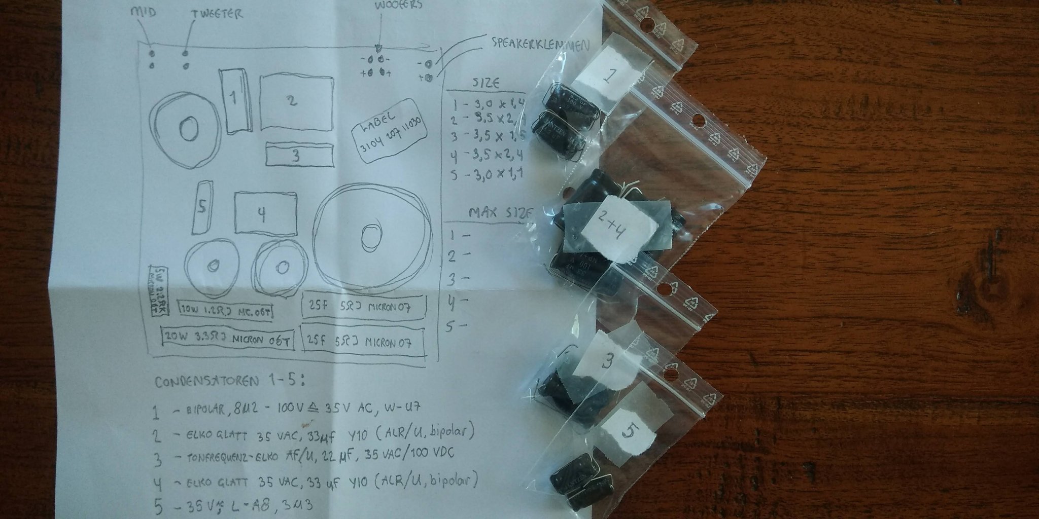

First thing I did was matching the numbers with the sheet I made earlier...so to avoid silly 'mixup' mistakes. Thanks to the sheet I know where to place the new capacitors.
Has the glue any other purpose then keeping them in place while soldering? Like maybe avoid vibrations when speakers are in action?
Now going to prepare for soldering the new capacitors in place...

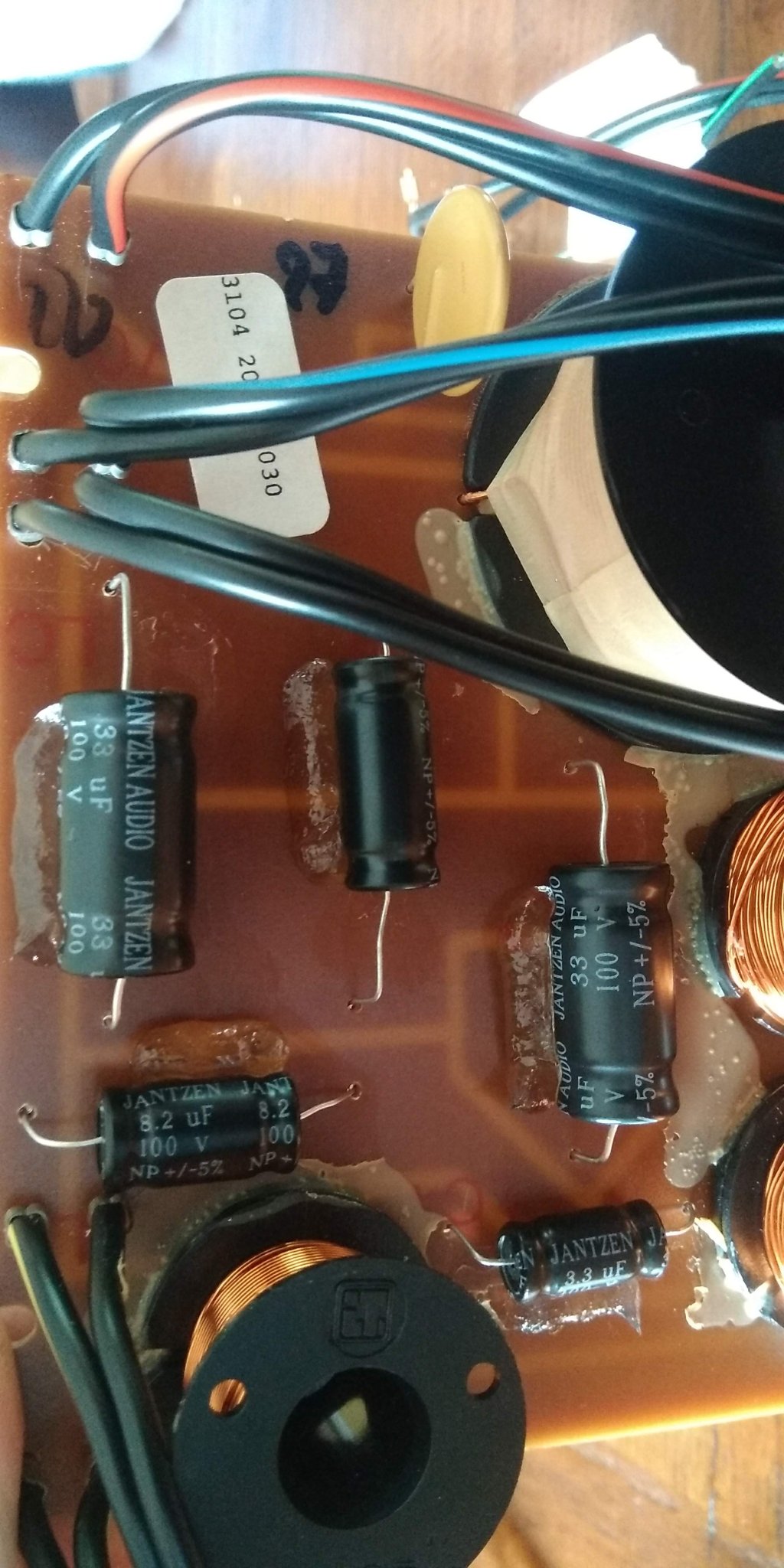

Well, so far so good. I drilled the small holes free of tin (tin still covering some holes after removal of the old capacitors) and I was then able to fit the new Jantzen capacitors, which are smaller versions of the old ones. I used a transparant construction glue to hold them in place and then waited for some 24 hours for it to dry.
Next, the soldering went amazingly well with all the tin dots bright and shiny and connecting well to the board. Finally the cutting of the capacitor wires and I can now hardly tell I did the recap job. This was nice to do! The thing that worked for me was taking my time for the job; no rush.

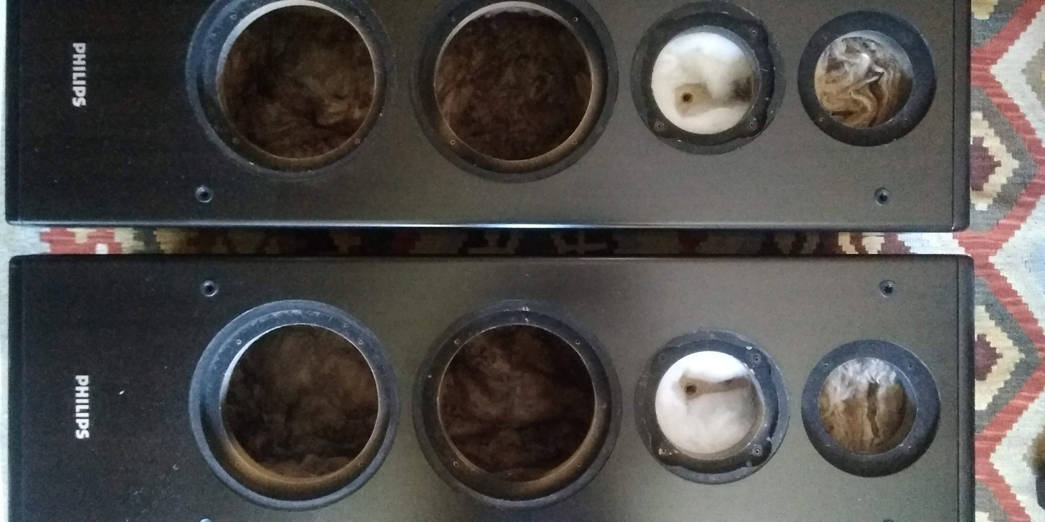

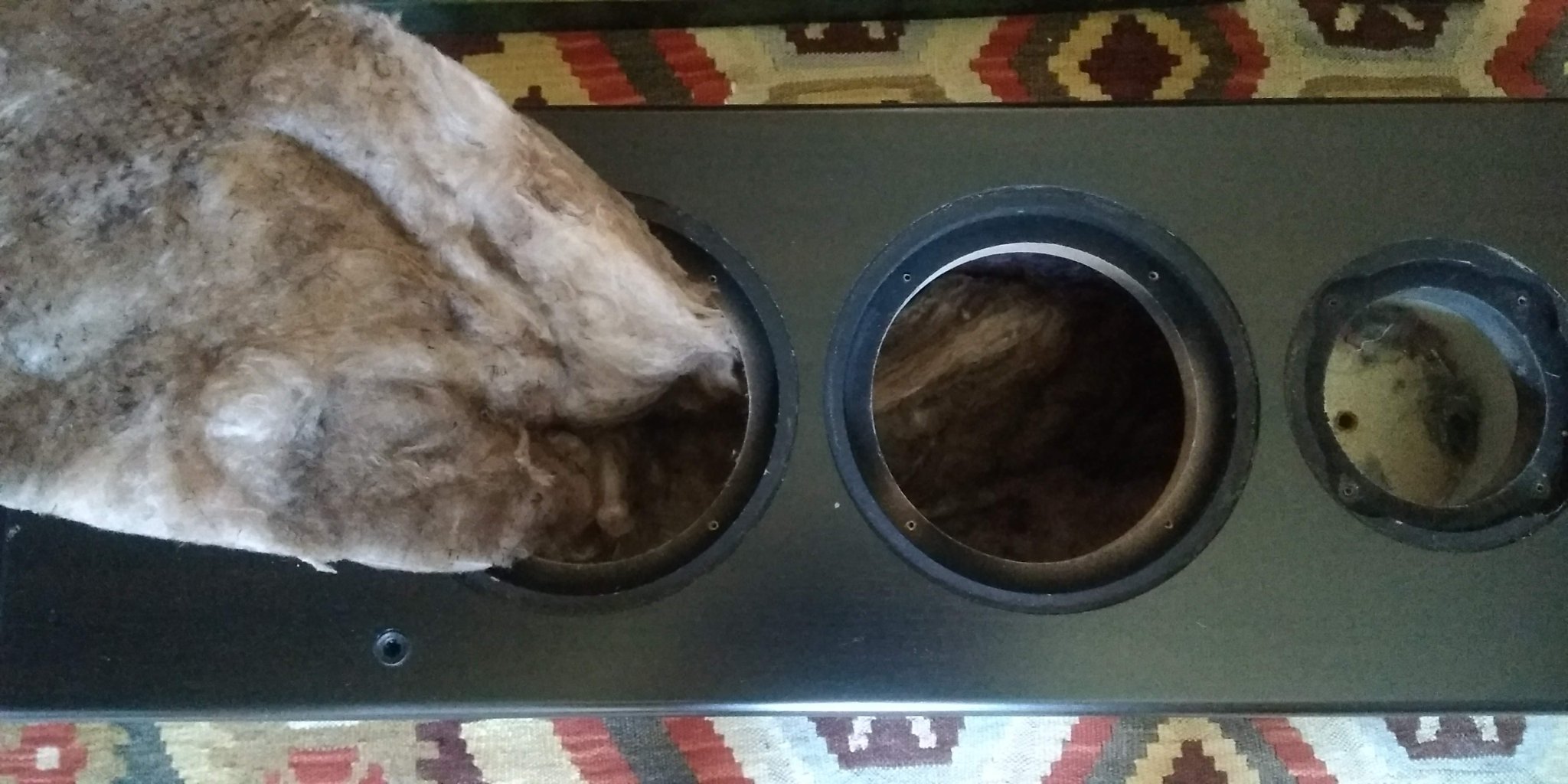

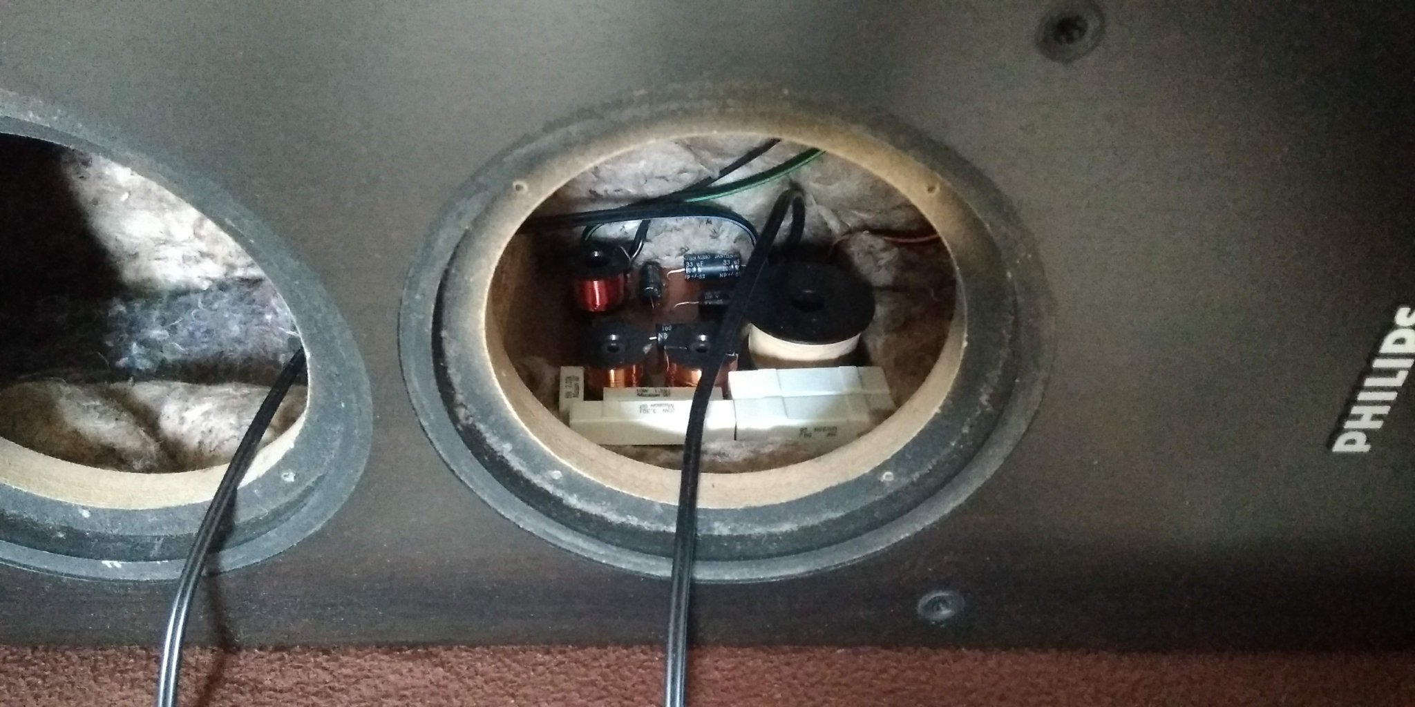

Now that the crossoverfilters are new and ready to be re-installed into the cabinet I've now started to add new damping material.
I treat both speakers equally regarding the amount and where/how I place it. I've added a pretty amount of the rockwool as the cabinets from factory were rather empty with only some basic damping material. Describing the amount, I would say I'm filling the entire cabinet about 60% (it was maybe 5-10%) with trying to apply no pressure to the rockwool; except for the sides...to keep it in place. I've also covered the plastic housing of the mid-toner with rockwool...just a gut-feeling.
I keep the space in between both woofers 'open' so that the y stay 'connected' well inside the cabinet. But this is based more on my feeling...that they serve as one big woofer, staying well synchronized.
One of the coming days I will re-install the crossovers and then...well, I guess it's time for a first sound-check 🙂
By the way; I'm keeping the part clear of rockwool where the crossover is placed. Is it okay to cover the crossover with some rockwool or will it give possible problems with heat dissipation? Not sure myself. Input appreciated; also about the way I choose to fill the cabinet.
There shouldn't be too much heat generated by the crossovers at domestic listening levels, but it is a sensible idea to give them breathing space.
I've no argument over your idea of keeping the damping material clear of the woofer combination. Remember, sometimes less is more!

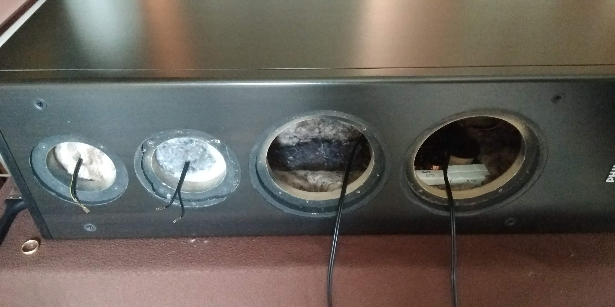

The crossovers are back in the cabinets. I've added some more rockwool around the boards but I leave them free so that heat will never be a problem.
Now it's waiting for the glue to dry (used to cover the small hole to put the mid-toner cable thru in its own, small housing) and then I will re-insert the speaker units. Can't wait for the first sound-check!
With the new Jantzen capacitors and the added rockwool damping these 32 year old speakers feel like new and finally treated well.

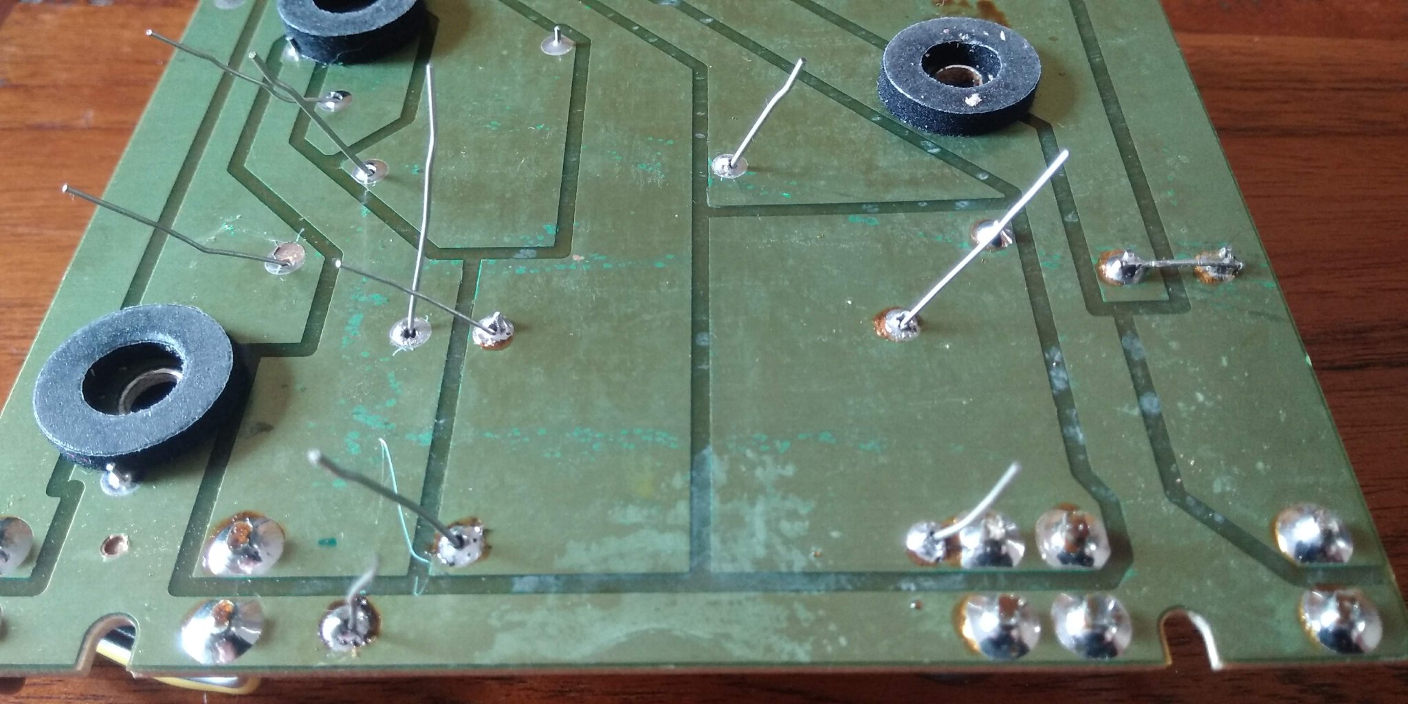

So, this morning I re-inserted and reconnected all the speaker units in both cabinets according to the pictures and drawing I made of the wiring.
However, the first sound-check, carefully performed on low volume, was a dissapointment. Not soundwise, because I think I've made a mistake somewhere.
To describe the problem in the best way: it's as if I've switched the mid-tone and tweeter cable; so, the hi frequencies seem to come from the mid-toner and the mid-frequencies from the dome tweeter. I'm pretty sure that the cables to the tweeter and mid-toner are correctly connected. In my case; the mid-toner cable is marked green on the +wire and the tweeter cable is marked yellow on the +cable.
The woofers sound good. I re-checked the wiring on my drawing, where I made a note of which cables go where and I've also re-checked all the new capacitor values being in the correct place. They are all bipolar by the way.
I've also checked + and - connections to the speaker units themselves and last, re-checked the speaker terminals on +/- connection.
What could be wrong?
I've attached my drawing, where I made a note of the ' MID' and 'TWEETER', with these being the outputs to the mid-toner and tweeter.
On the board the 'TWEETER' connection has the yellow labeled cable and the 'MID' connection has the green labeled cable. So, this is how I reconnected them.
Still, when I put my ear right in front of the mid-toner and/or the tweeter, the high frequencies come from the mid-toner while the dome tweeter has the mid-tones. I'm sure of this.
I'm also aware, from another forum, that the mid-toner is ' out of phase' , so, +/- switched. But as this is done on the board itself I made sure to re-connect the mid-toner as originally done, + to + and - to - terminals.

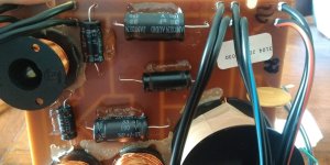

I've added pictures of the board underside and the upper side with new capacitors on it, in case any of you guys might be able to pinpoint the possible problem or (silly) mistake I've made(?).
Once you’ve sorted and confirmed your connections, keep in mind that one of the things that usually happens to older electrolytic crossover capacitors is that they will gain capacitance. This changes the function and sound…
This may be an adjustment if you have been using the speakers in a well used state.
Electrolytic capacitors that don't dry out, but only see a small applied voltage for some time, can suffer an increase in capacitance
On the other hand, electrolytic capacitors that do dry out over time can suffer a decrease in capacitance.
It's all a bit of a lottery!
Fresh electrolytics will likely give a slightly different sound balance to which one's ears will adapt over time.
