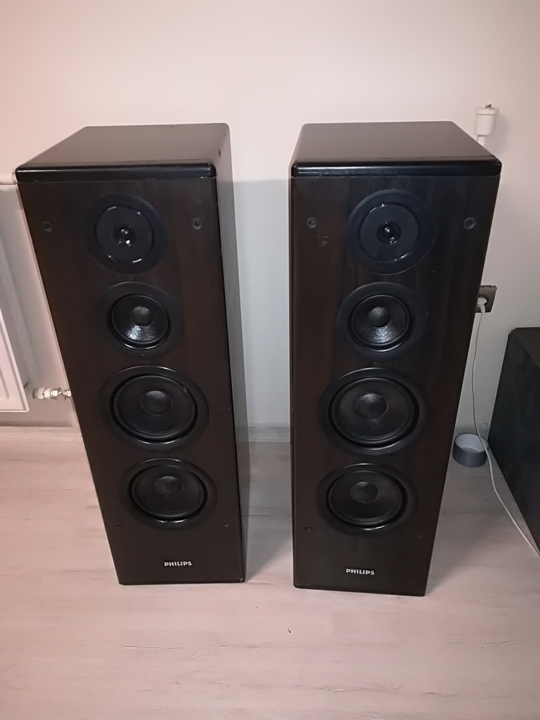

What was the price of this Philips speaker back in the day? Its crossover parts look good sized. Cabinet is sturdy too. It doesn't lack in general build quality impressions for a 1990 mainstream model.
Back in 1990 we still had the Dutch 'guilder' as currency. I must have paid around 1200,- for the set. Not sure what it translates to but it should be something close to € 800,- for a set nowadays. Years later, because of the way they were built, they were actually concidered a bargain and one of the better produced Philips speakers...but I didn't know that back then...just been a bit lucky. Yes, they are pretty sturdy built, with the cabinet getting extra interior supports and the front baffle being constructed of hard-pressed MDF, 3 cm thick. And yes, you are right, the crossover is pretty large in size. It all looks pretty solid built for a 1990 speaker. Anyway, always been very happy with this 'standard consumer' speaker-set. Cheers.

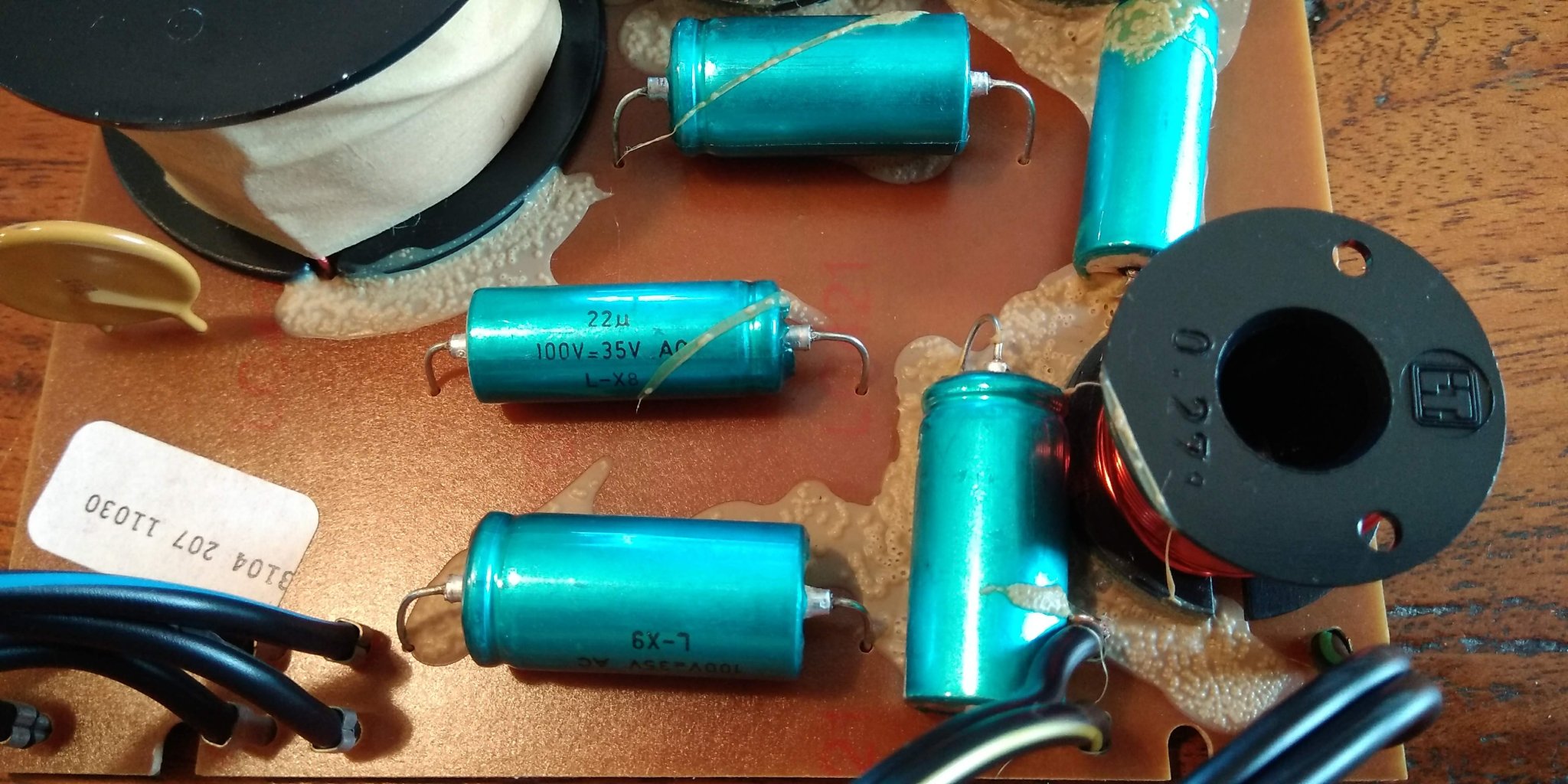

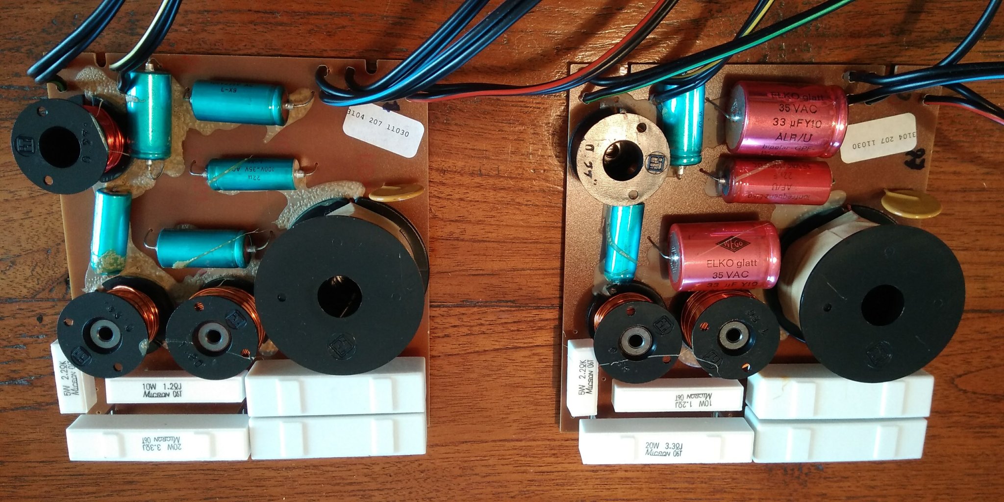

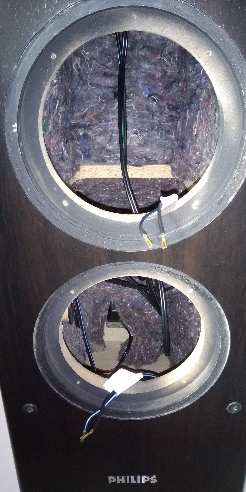

Results of my Philips FB-820 'upgrade' (recap, PTC bypass and new damping material).
Was it worth it? Yes, absolutely! When I first could really enjoy the set again in stereo, it was a good, noticable difference. Of course I cannot tell what is responsible for this as I did the recap, PTC bypass and damping all at once so I can only conclude that the 'upgrade' as a whole has taken a very positive route.
I'm especially happy with the new hi/mid balance being more 'present' and the stereo imaging is also better...a bit more detailed and 'deeper' in image.
The woofers sound much more 'sturdy' on high volume, showing no signs at all of 'having a difficult time'. I think here the newly added damping material really does a good job; the speakers sound 'bigger' yet 'sturdier'....as if the woofers react 'faster'. I think my enthousiastic nature for my vintage hi-fi set makes me biased but ruling this out, I truly notice this difference. I know these speakers well (32 years owned) so it's fair to say I can hear the difference.
Also nice to now know the caps are all new (Jantzen capacitors) and all are the same in each speaker now (they actually were different in each speaker before).
The set now rests on my vintage spikes my late grandpa made for me. Added softpads to them and now the 'upgrade' is complete. Pictures are of the speaker without the decorative rings (just to make sure everything was right before adding them with a glueing process) and the speaker 'finished', with the decorative rings.
In my case; I dare to recommend recap and upgrading. It was worth it for me, no high costs, my vintage speakers sound like new and 'fresh' again and the whole process wasn't really that hard, although I made a silly cable swap mistake (the only mistake I made in the whole process). Thanks Galu and others for your input and comments; it helped a lot!
