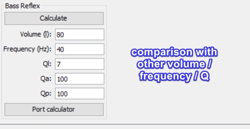

congratulations for the job! well done .
I wanted to suggest that we can compare other types of loads and see the differences
see attached image if I have not been able to explain
I am using the simulator with satisfaction and I am following the developments with interest
I had to use REW to compare. So I think there should be an option to import FRD as target.
However to see the difference when changing parameters this would not be very practical (to export and import for every change). But I do not want to make GUI too cluttered with options.
Maybe it would be the best, if graphs would show previous simulation too. This will probably require more work to implement.
I have added this two things to my To Do. I hope they will be done soon and useful. Thank you for suggestions.
