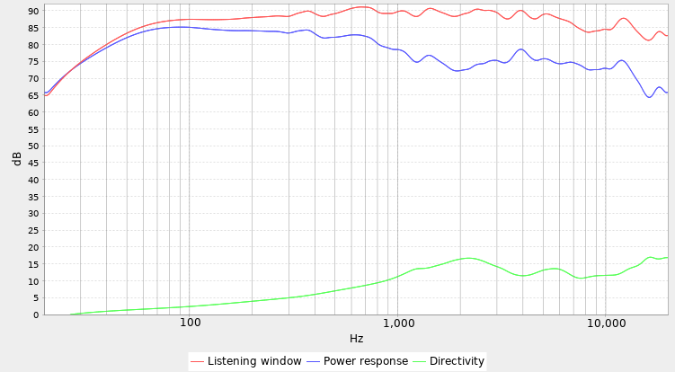

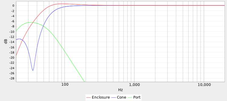

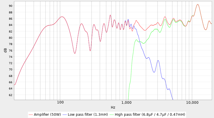

Graphs can now show multiple data. So now there are slightly less tabs.There are too may tabs 🙂
Listening window, power response, and directivity now on single graph:
Enclosure, cone, and port on single graph:
Now responses of sub-items are also shown:
