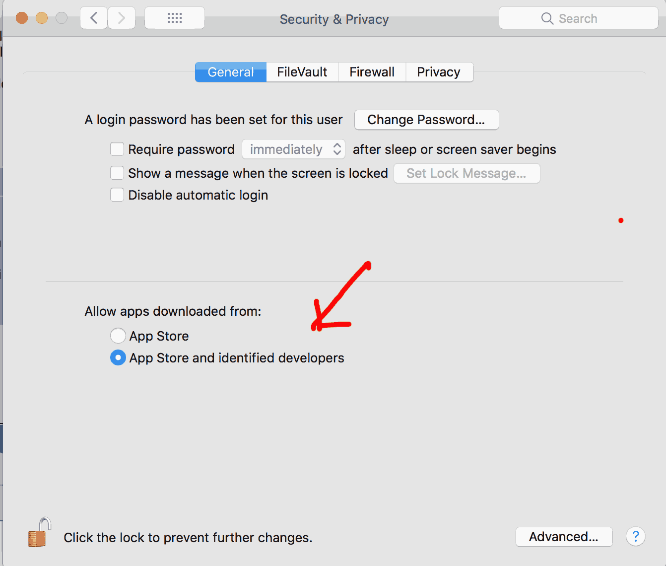

Hi planet10, LightBit,
I got down to the last operation and it came up something like "can't download this file, don't recognise the file, it's from an unknown source, not in the mood, having a bad day..." Or something like that. All that waiting and Apple throws a wobbly.
I'll try again but not expecting much. Pity cos it looks like decent sorftware...
Cheers, Martin
***Your security preferences allow installation of only apps from the Mac App Store and identified developers.
Google Chrome downloaded this file today at 1:36 pm from drive.google.com.****
This what I get, so I looked into security settings. But nothing changed after fiddling around. Bugger

You need to make sure that the part pointed to by the red arrow is as shown,
