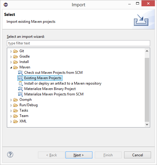

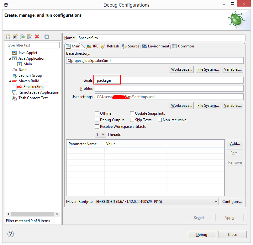

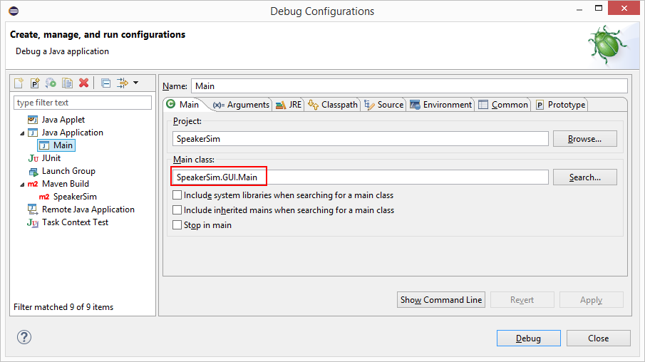

Yesterday evening I gave a try using SpeakerSim In Eclipse. 467 errors and 40 warnings 🙂
The 467 errors have been solved adding the minimal-json and jfreechart libs.
Could not run Main:
Exception: java.lang.NullPointerException thrown from the UncaughtExceptionHandler in thread "main"
I'm using Oracle 8 JRE.
Could not run Main:
NetBeans handles all dependencies using Maven. Did you import pom.xml?

Ok! It runs.
The only messages I get:
SLF4J: Failed to load class "org.slf4j.impl.StaticLoggerBinder".
SLF4J: Defaulting to no-operation (NOP) logger implementation
SLF4J: See SLF4J Error Codes for further details.
