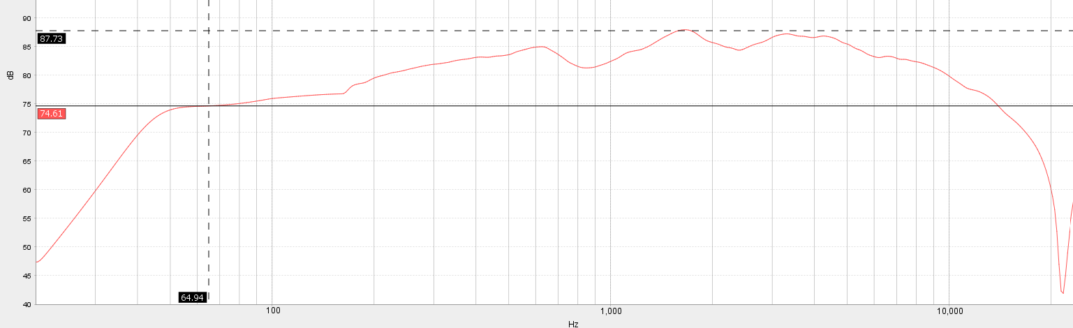

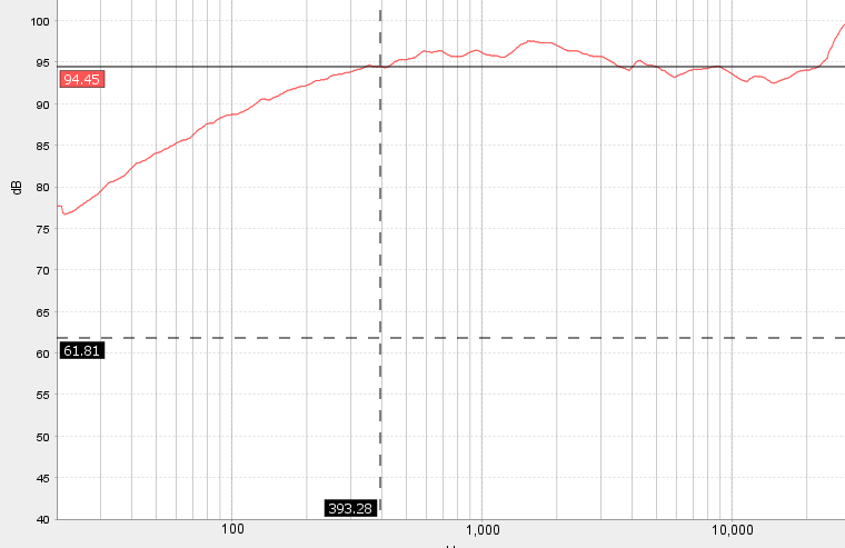

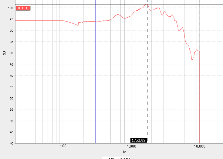

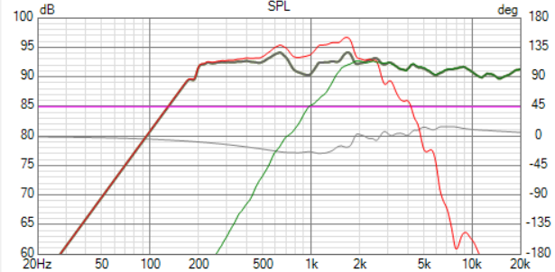

6. It seems to me that SPL is low. I tried to put the values of a specific model and computed low SPL.

Sure, take a look on photos. I attach the total SPL, response of drivers in FRD and SPL result, same config from VituixCAD.

Yes, right, changed position parameters and changed.
Still , there are differences. I will play with parameters and see what happens.

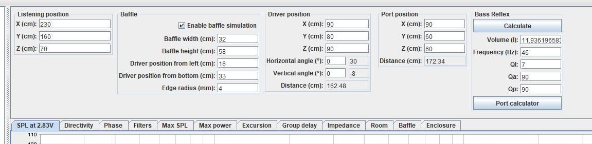

Hi again, I get more sense now I think.
1. Point (0,0,0) is front, left, on the ground?
2. "x" is on front of me, "y" is on my side, "z" is height?
3. Are numbers on the example reasonable? It's a 58x36 box
4. Angles have positive rotation counter-clock wise? Horizonal as seen from above and vertical as seen from left to right?
  1. That is how I imagine it.
  2. Does not really matter as long as you are consistent.
  3. Looks reasonable to me, except listening position seems kinda low to me (if that is Z).
  4. I'm not sure I understand what you mean, but you know it is correct if relative angle is correct. Negative horizontal means left and positive right. Negative vertical means down and positive up.
