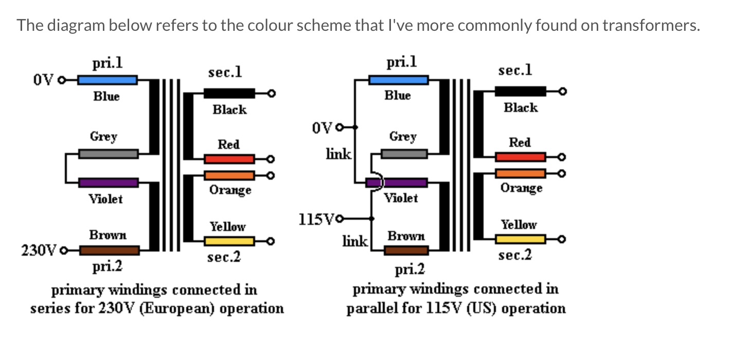

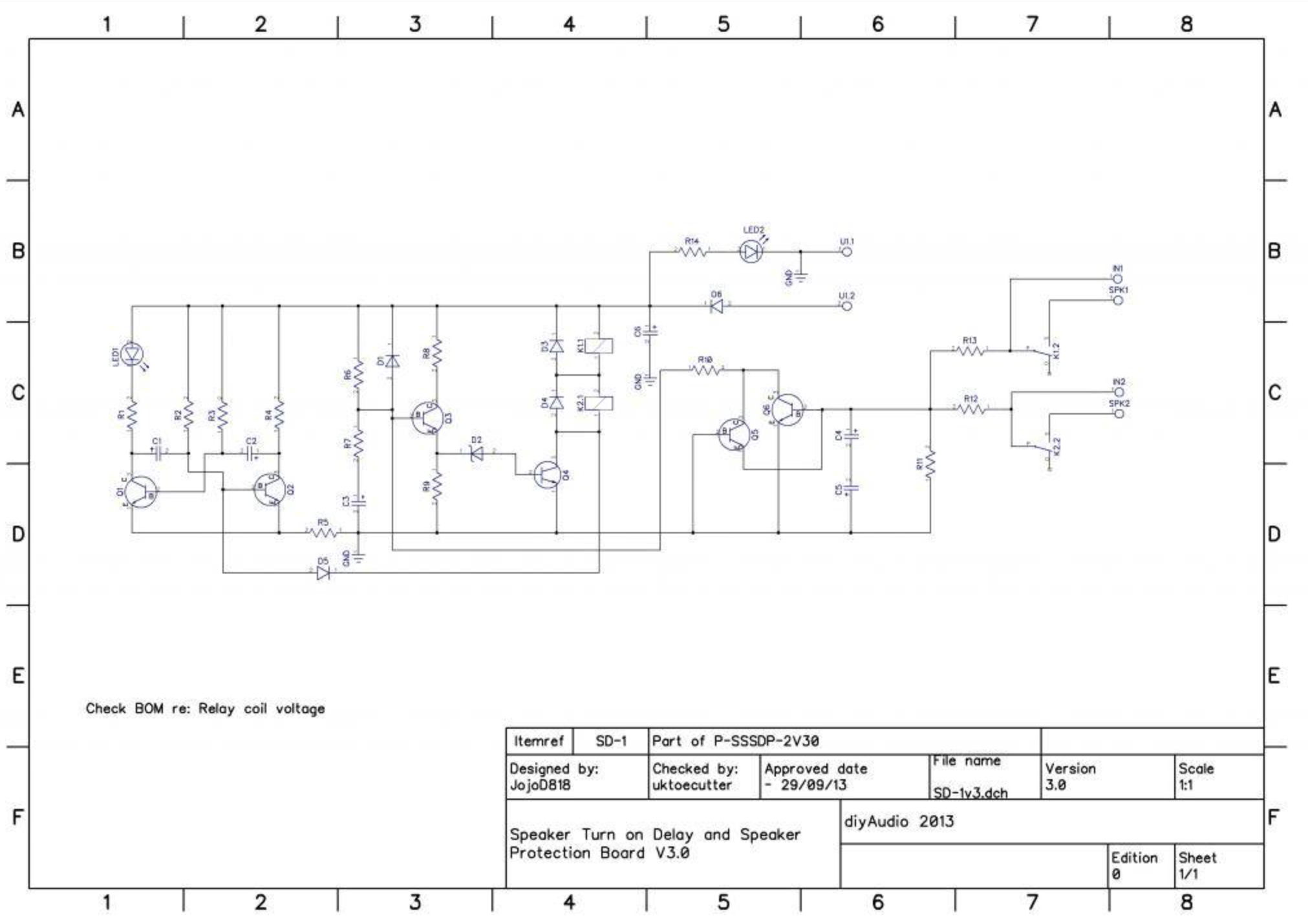

I’ve attached the schematic of the V3 Turn-on delay and protection board. The voltage inputs are U1.1 & U1.2 (I think it’s a "U"...could be a "V"). The board can be driven either by AC directly or DC if you wanted to (U1.2 is +DC and U1.1 is the common return (call it the "-" side if you’d like)). I’ve also attached a common picture of a toroidal type transformer with 2 separate input primaries and two separate output secondaries. I’m presuming you have this type of transformer and 120VAC mains?
So to drive both secondaries with xxVAC output (let’s say 24VAC) you would connect the transformer as is shown on the pic on the right (blue & violet wires are joined together as are the grey & brown; colors may vary depending who makes the transformer). You can hook up each of the joined pairs to either the mains live (black wire in USA) or the Common return (white wire in the USA). Doing it like the picture blue+violet are connected the the mains "common/white wire" and grey+brown are connected to the mains "Live" or black wire. So now the secondary outputs black & orange become the "Common" returns for their respective red & yellow "24VAC mains Live". So you would take one of those 24VAC pair (let’s say the black & red pair) and the red can be connected to the U1.2 line and the black to the U1.1 line (it doesn’t matter with AC but D6 would match up the "+" side of a VdC input so just by convention, on my part, I make that the Mains "live" side of the AC in).
I just prefer to use a AC to DC voltage regulator to drive the board to get a clean, constant voltage into the protection board.
Does that answer your question?

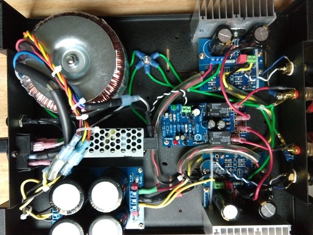

No, I used the Mean Well for one project (see the picture; mean we’ll mounted on its side). I also used a separate center-tapped transformer & AC/DC regulator on another project (a speaker protect board kit I bought on EBay cause I had a bit more room and extra parts laying around. Attached is a photo of the DIY board and the Mean Well. The switching power supply lies outside the signal path (it only powers the relay coils) and draws power directly from the mains input to the amp (which is fused) and connected to a mains on/off switch on the chassis. I didn’t get any hum through the amp but I’ve also got everything grounded.
I’m sure the 12V relays would work fine with the secondaries in choice #1. And with option #2, you are correct about the thumping issue. I learned that too.

Thanks for the detailed description. But I understand all of this. THe thing is, my 2 transformer secondaries drives, just like yours, my 2 channels. And it's the grounding part that puzzles me (nex tto D6). Even If I decided to use one of my secondaries, whre is the ground connection supposed to be made, physically?
MartyBoy...this is my understanding of those symbols on a schematic. More learned electrical folk can correct me. The ground symbols on the schematic do not represent chassis grounds (like the green wires you can see in my picture). They do represent earth grounds. The ground symbols (like next to D6) just represent the connection to the "Common" AC line/path on the board, e.g., the wire connection from a secondary transformer output generally marked as "zero VAC" or the (-) negative line from a DC input source).
You might only need to "chassis" ground the speaker protection board if it is inducing a hum in the output.
