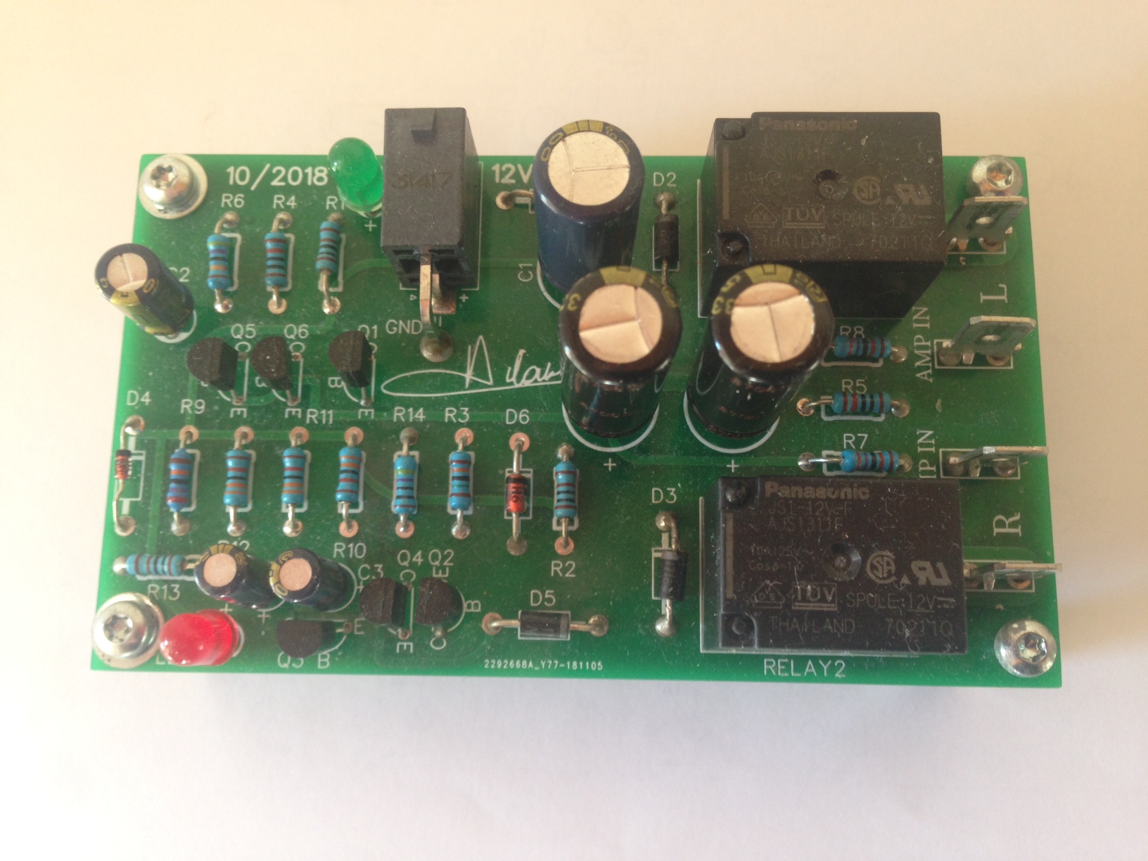

No, I used the Mean Well for one project (see the picture; mean we’ll mounted on its side). I also used a separate center-tapped transformer & AC/DC regulator on another project (a speaker protect board kit I bought on EBay cause I had a bit more room and extra parts laying around. Attached is a photo of the DIY board and the Mean Well. The switching power supply lies outside the signal path (it only powers the relay coils) and draws power directly from the mains input to the amp (which is fused) and connected to a mains on/off switch on the chassis. I didn’t get any hum through the amp but I’ve also got everything grounded.

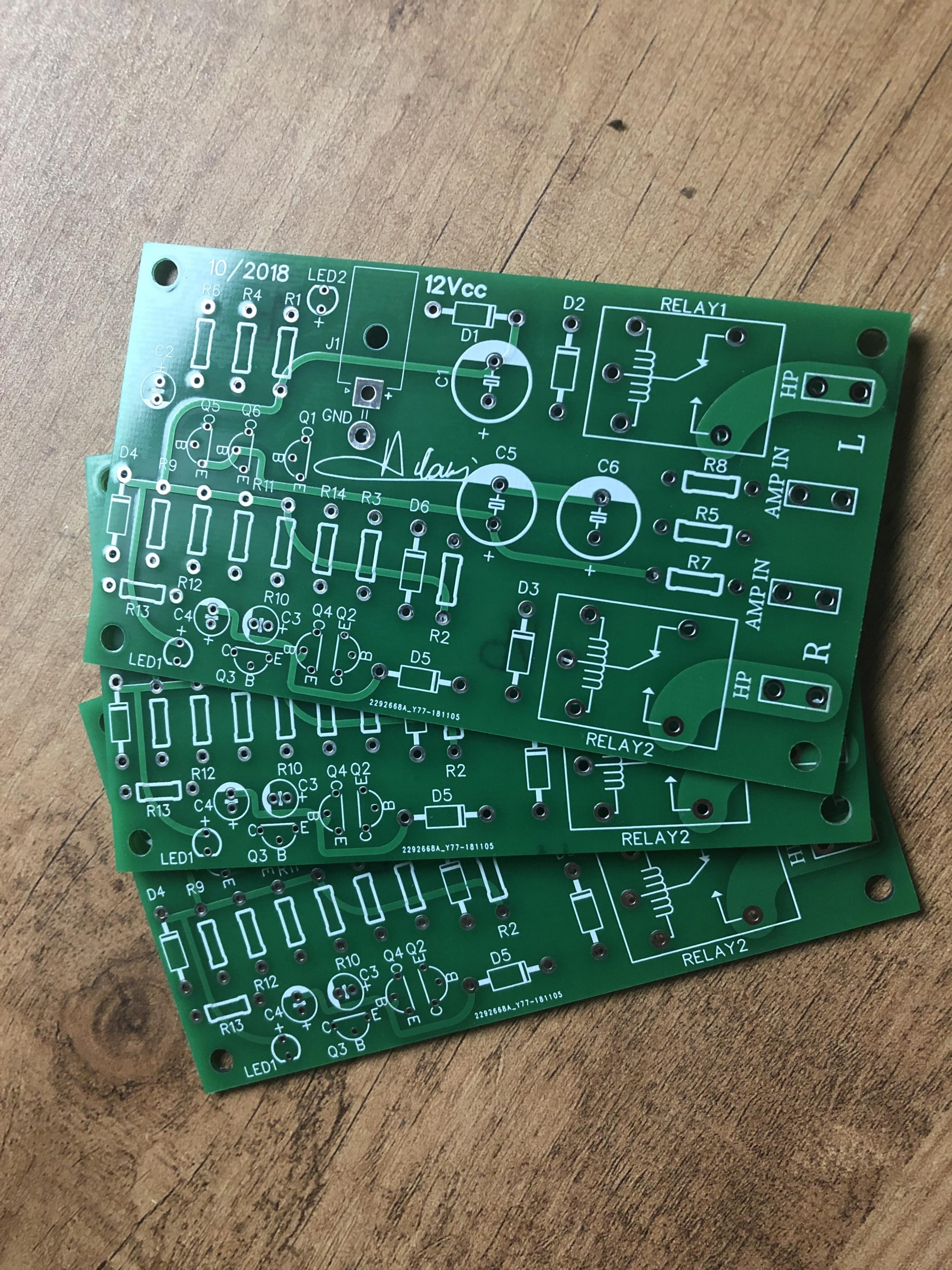

This thread is for discussions about the new Speaker Turn-On Delay and DC Protector boards (V3). This is an updated version of the V2 boards, primarily to make them compatible with the 10x10 grid mounting pattern we've now standardized on so they can be easily mounted to Deluxe chassis baseplate, riser panels, front panels and/or heatsinks. Refer to the V2 discussion thread for additional information.

- Dimensions - 100mm x 50mm

If you look at the schematic, positive voltages on the speaker terminal drive the base of the sensing transistor. Negative offsets connect to the emitter of the sensing transistor and, therefore, do not have the benefit of the transistor current gain so negative offsets have to draw sufficient current through resistor connected to the collectors of the sensing transistor to turn the relay drive transistor off. It simply takes a higher offset than the positive direction.
