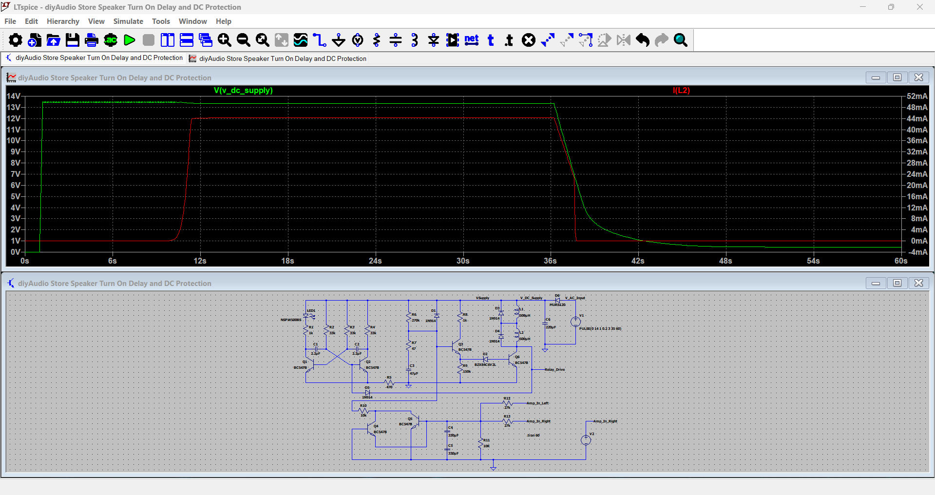

Are you powering the board from an AC source (transformer) or are you using a DC rail from elsewhere in the amp?
The relay dropout depends on the supply collapsing quickly. What coil voltage do the two relays use and what supply voltage do you measure on C6?
Using the same PSU for the amp and delay board can be problematic. The relay will not drop out until the supply has fallen considerably. If the board is powered from a separate transformer then the supply fall quickly as C6 is the only source of power.

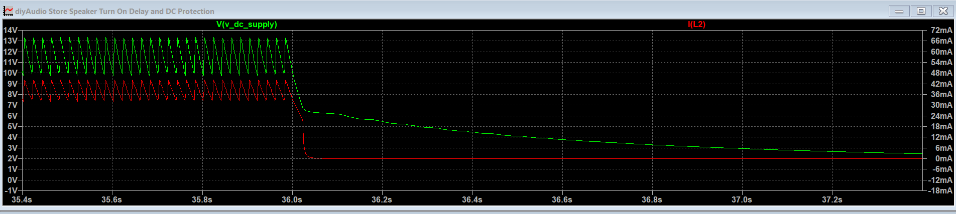

This is the 12 volt version and shows the AC supply being turned off at 36 seconds.
The rectified DC rail is in green and the relay current in red. The second image is zoomed in to 36 seconds. Notice how quickly the relay current falls because the relay is being fed only from C6.

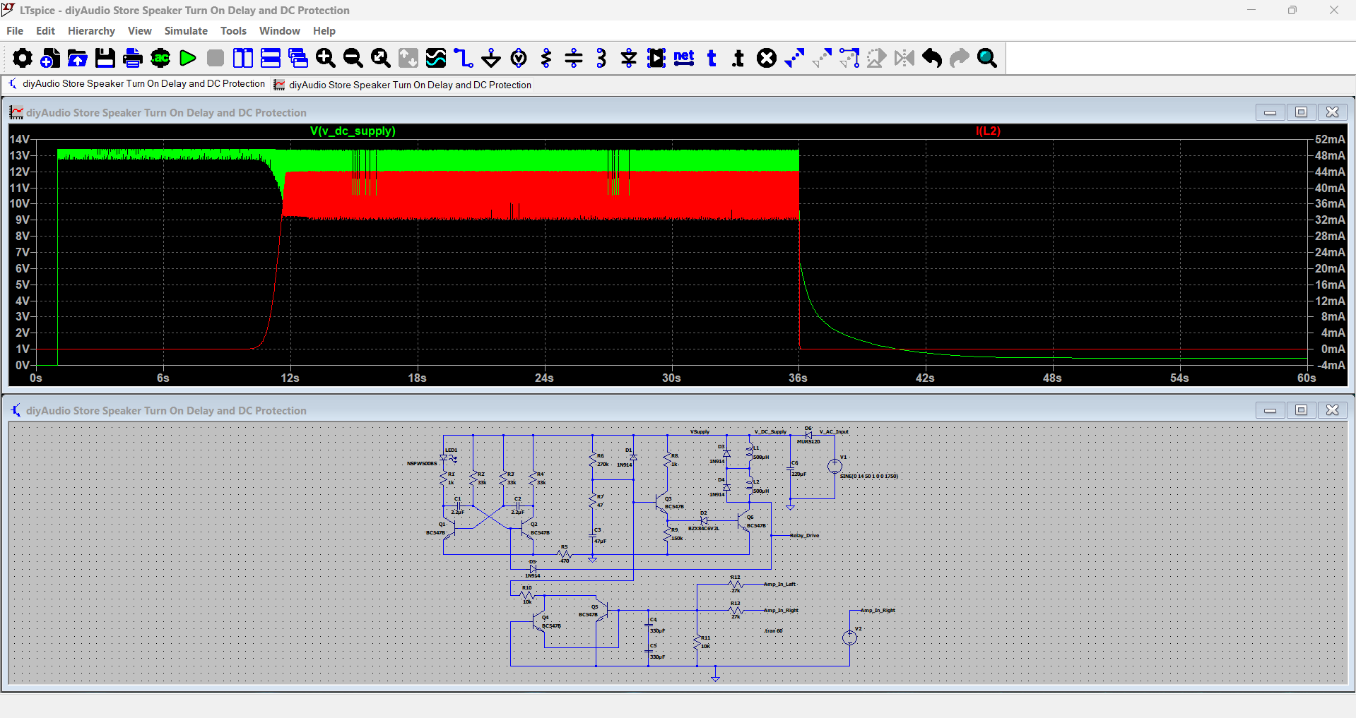

The last two images show what happens when supplied from a DC supply such as powers the amp. The PSU is turned off at 36 seconds as before but now the rail collapses over 3 seconds. Notice how the relay current simply reduces but the relay will still be engaged. The amp will make its noises during this slow fall in the supply.
(The relay current is shown at the right of the graphs)

And with a DC supply feeding the board.
