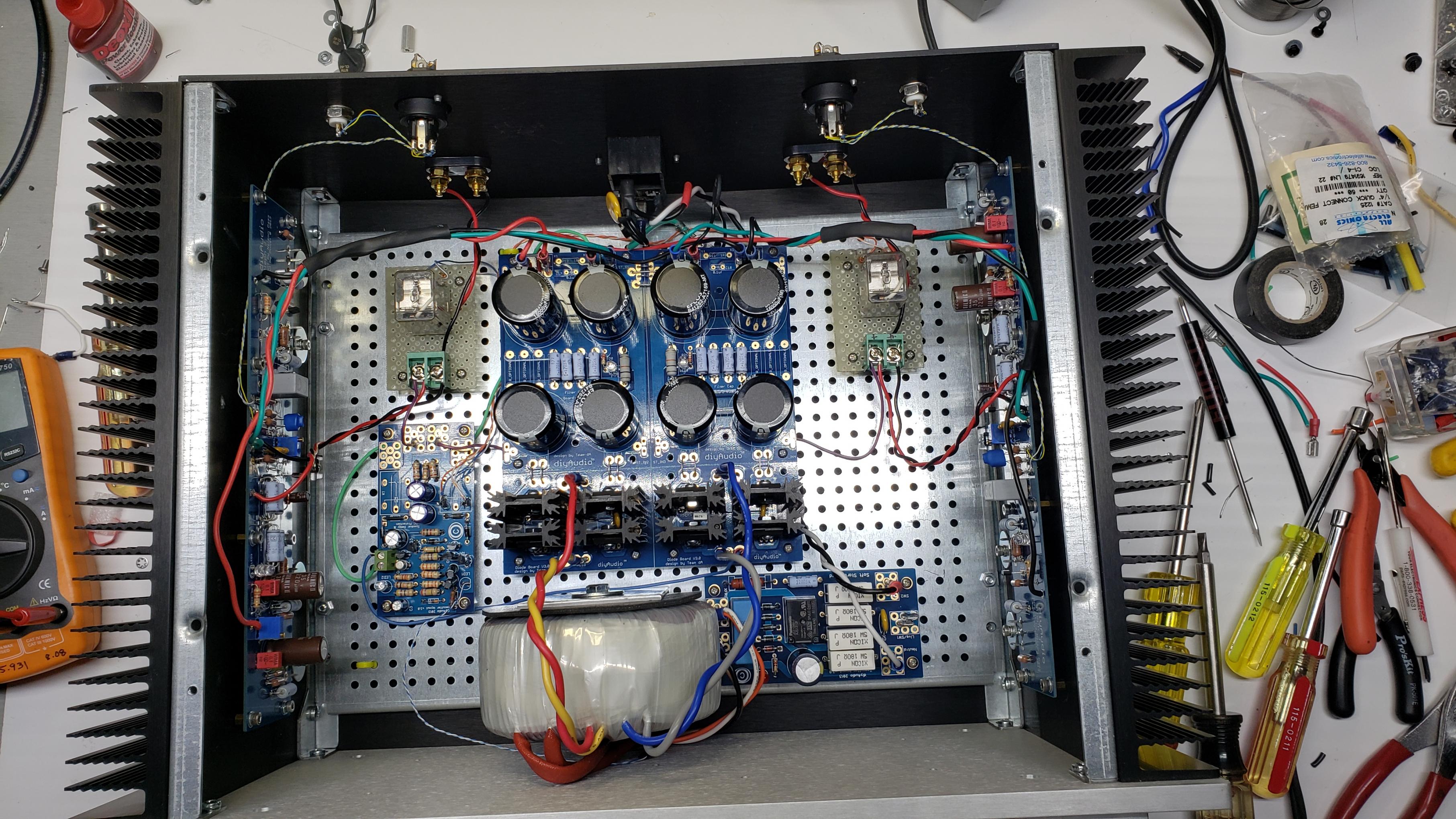

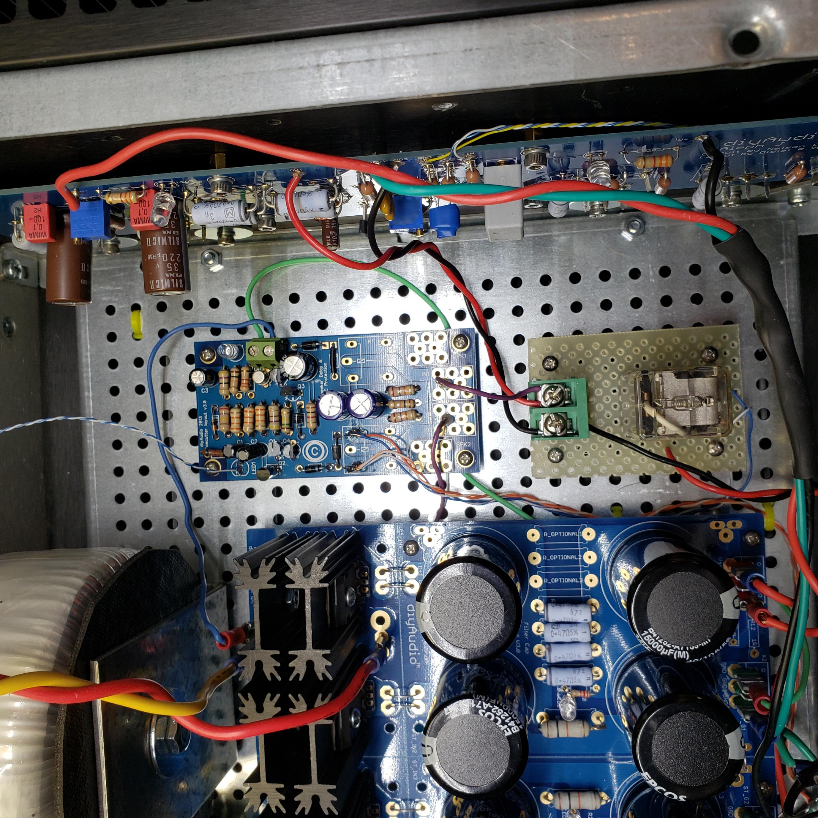

Installed on Honey Badger did not protect speaker
I had built and installed the protection board in my honey badger build, the honey badger was working fine until one day I powered it up and it blew the fuse on the left channel, also caused a large pop, long and short I lost the channel and it blew out the woofer on the left speaker.
When I built this board, I also ordered the KSC945 from the incorrect BOM, I had issue with the start up. I replaced those transistors with 2N2222, all worked fine.
BUT, it failed to provide protection on start up one time and caused the loss of the speaker.
Is there a test on which can be conducted to insure the circuit is working other than the leds going solid on start up. It functions with no issue in connecting the speakers after delay, however I am not sure the DC protection is working correctly.
Suggestions would be appreciated, I have fixed the Honey Badger found a bad transistor and resistor and replaced and got it all working, now I have to fix the speaker unfortunately this was a Sonus Faber and the damn speaker company will not give you any information they want you to send them in which is costly.
I will fix the speakers, but I want to avoid this in the future, the Honey Badger does not have an overload protection circuit in the design, which is an issue.

I tested my board before installing. With power applied to the board I placed a 9 volt battery across the speaker input to the board. The relay should open . I then reverse the polarity of the battery. The relay should the open. I would suggest reading Rod Elliot's article on the subject. Loudspeaker Protection and Muting. pay attention to the relay failure due to arc.
I did read that article was going to order a couple of his boards the shipping was too high.
What transistors did you end up using in the dyiaudio circuit ?
I used the BC546C in place of the 2SC945 for T3,4,5 and the 2N2222A ( metal case ) in place of the T6 2SC9013 , T1,2 are 2N4400. Be aware of the pinout , they are not the same. I went off board with the relays for two reasons. I could place a larger relay in line with the speaker wire, and two I could wire the speaker to the common of the relay, and the ground to the normally closed . If the relay were to arc hopefully most of the energy would flow to ground and not through the speaker. I did relocate LED 1 to the front panel. The circuit has worked well with the Aleph J .
I don't have any faith in the board, when I did the test per the instructions it took a second or so to disconnect.... a second and the speaker is toast. I'm now looking for another solution.
I am using Rod Elliot's circuit in my 160 watt per channel bipolar subwoofer amp with no problem. There are quite a few more parts in it . I built the circuit on my own hand etched P.C. board.
I don’t have faith in the board as well
I am looking at getting elliots boards as well this dyi audio board failed and it should have not connected on power up as it did.
J, I appreciate your input as the designer, but we have a diy product in the store, that offers limited/no protection. One second of DC kills drivers. I used a 9v on some cheap speakers and they damned near jumped out of the box before the relays engaged. I am not a designer , but I look at the data.... the data told me to discard the circuit utterly.
PS I built 2 boards, if anyone wants them, they are yours, just pay for the boards and the parts....
