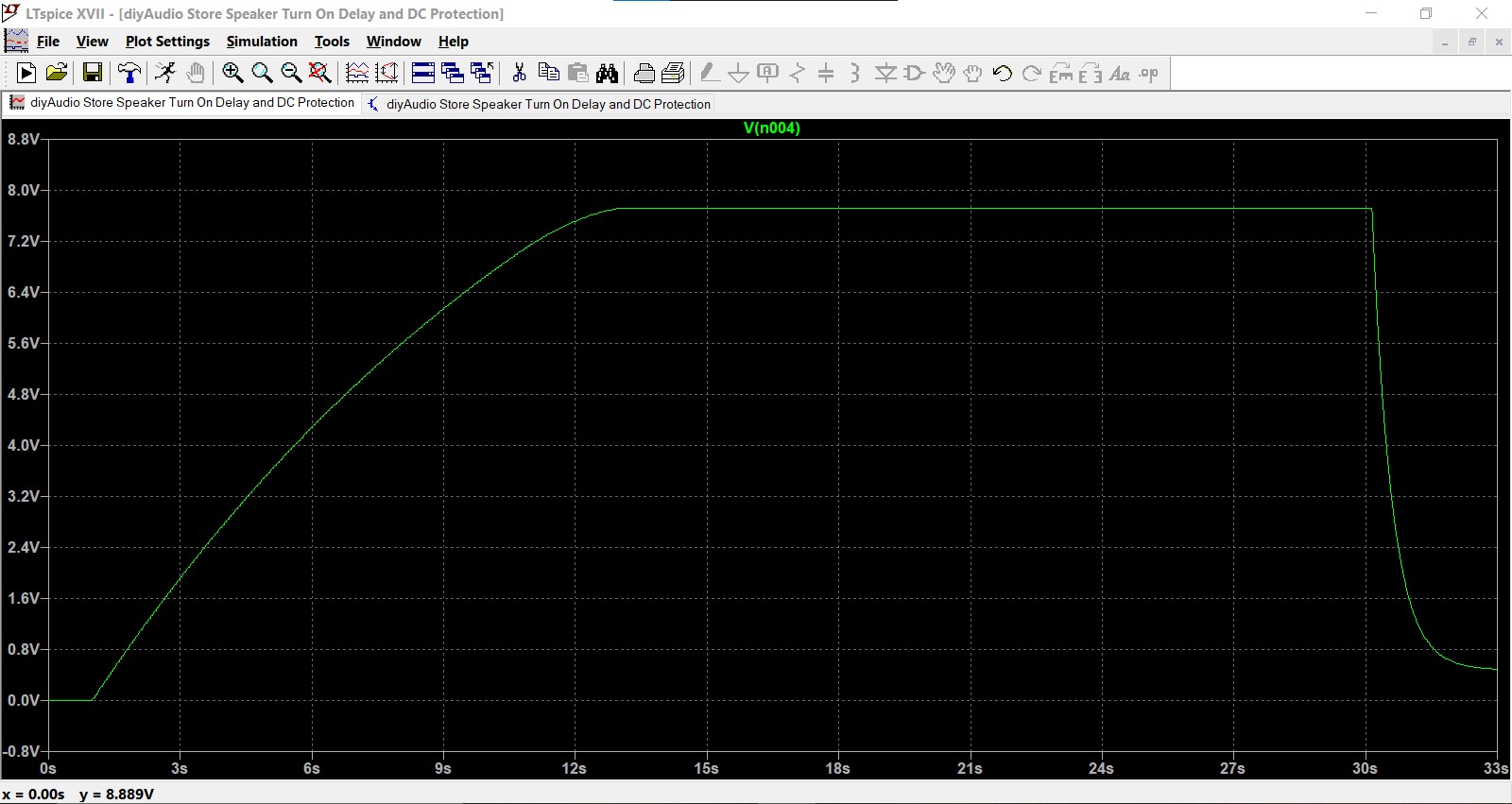

From initial power on you should see the voltage on C3 (47uF) climb slowly and after around 10 seconds it should be pretty close to the Zener voltage of 6.8 volts.
This is an important step. The voltage is shown here and you can see how it climbs and then limits at the Zener voltage.
Check that yours does this (limits at approx the Zener voltage) and that the time to reach this voltage is around 10 seconds.
Note... you must use a DVM for this and not an old analogue type meter whcih would load the circuit down to much.
So that is the first step. Isolate those two parts and check the timing voltage rises at the correct rate.
This is how the voltage on the 47uF cap rises over time.

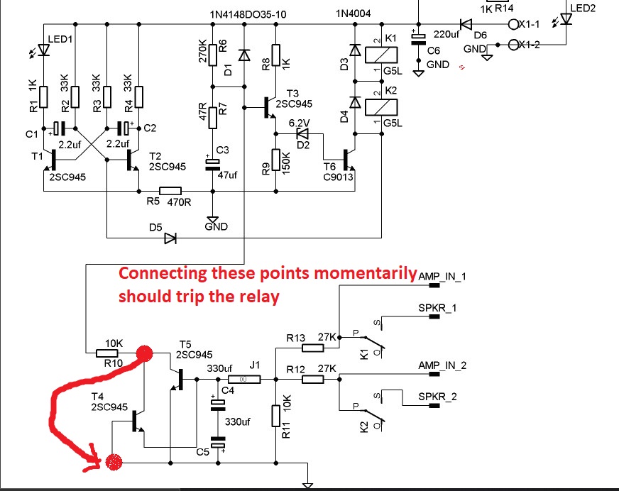

Here are some simple tests.
1/ If you apply a short from T4 and T5 collectors to ground then the relay should trip out. Doing this removes charge from the timing cap and turns off T3 and T6
Just short it out momentarily with a bit of wire and see if it trips.
It must pass this test before going further.

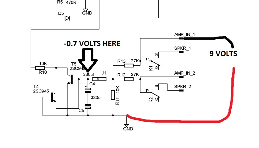

2/ If you apply 9 volts to the speaker in connection then you should measure a DC voltage of around positive 700 millivolts across the two series connected caps C4 and C5.
Remember that the negative of the battery must connect to ground on the board and that the 9 volts must be applied to one of the 'Amp In' terminals.

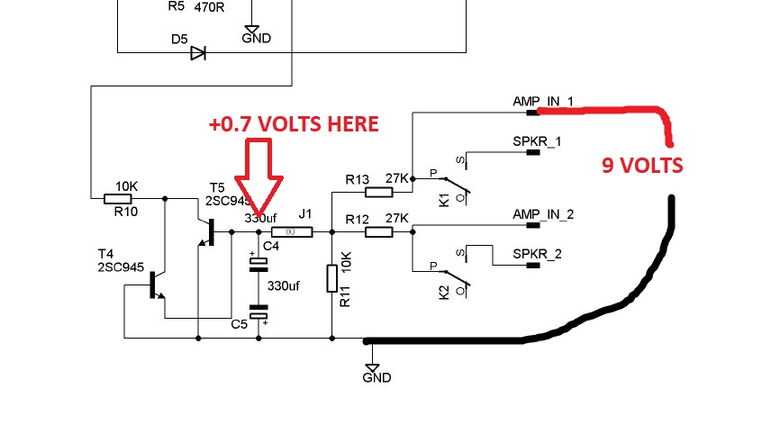

3/ If you now reverse the polarity of the battery then the voltage across the two caps should also reverse and this time measure around negative 700 millivolts.

1) immediate trip. :hypno2:
2 ) +/- 0.65V

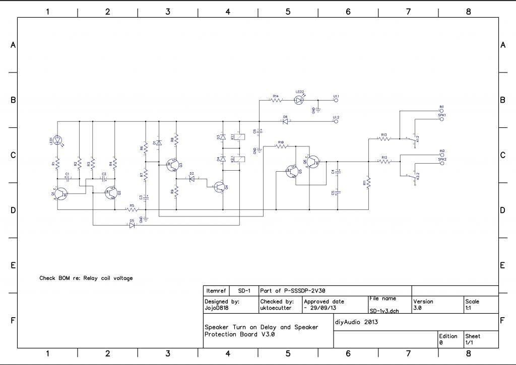

Deciphering the schematic wasn't easy—I have to admit, I still have difficulties to discern either of the attached pics...
