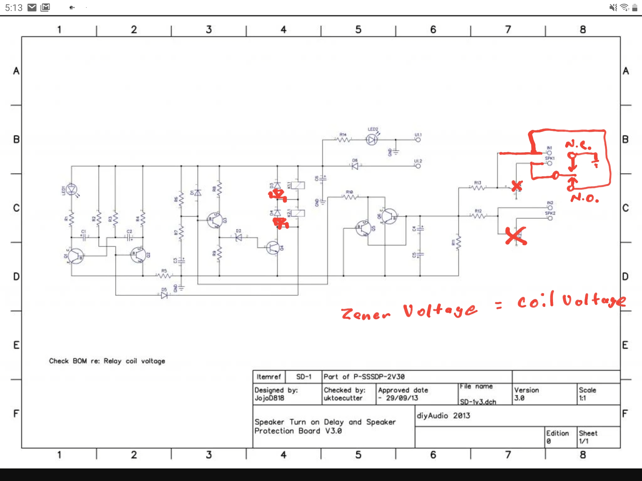

I think the weak point is the relay... It takes time to go from one state to another. That time might be more than a speaker can handle. Like I said, I ran a couple test and was not satisfied with the result.
Relay speed
I will try the modification suggested by Rod Elliot in his article on relays. I will add the zener diode in series with the coil diode. I have already wired the relay contacts as suggested in his project 33. He also suggests not to use miniature relays as the contacts are too close together, which is why I went off board with the relays.

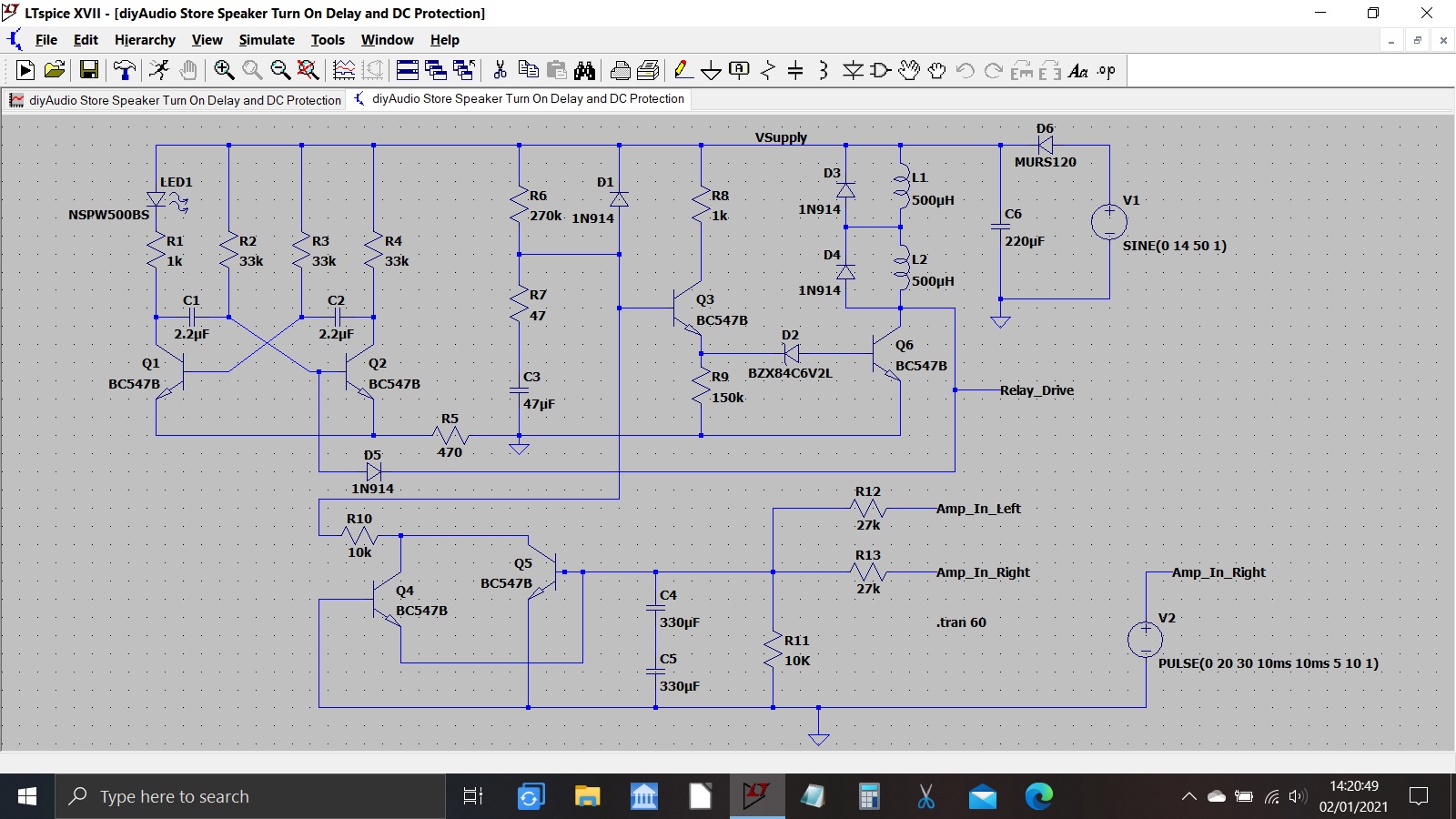

I'll be honest here, this is the first time I've seen and looked at this circuit...

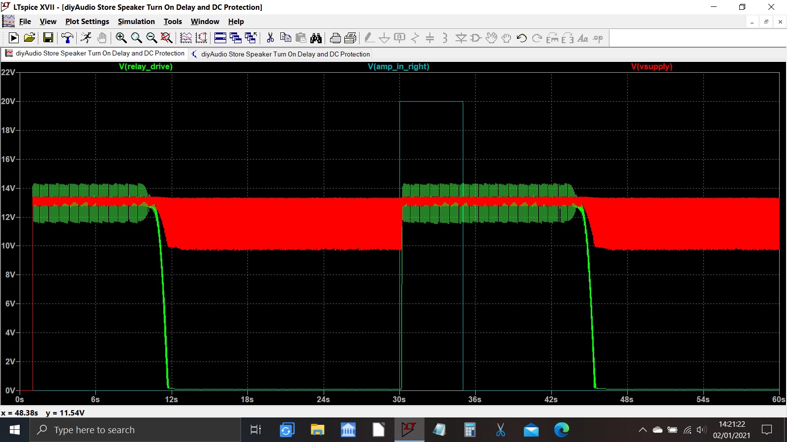

Just looking at this and simulating it and it seems to work very well. The delays are all text book R/C intervals and I have to say it behaves as expected.
This is the circuit I came across... is this what you are using?
Also shown is the relay delay which gives about 10 seconds from power first appearing until the relay closes.

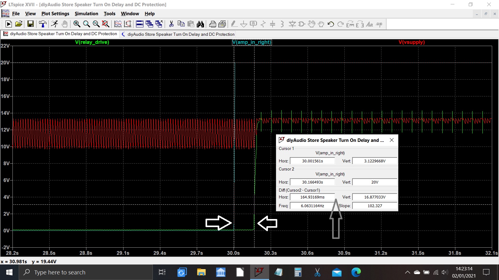

When a DC offset occurs the relay opens in around 160 milliseconds. That delay is entirely under user control and can be varied by altering the time constant of the input filter.
When the fault condition is removed the relay reconnects again after the 10 second delay.
The behaviour was the same for negative going offsets.
The .asc file is attached.

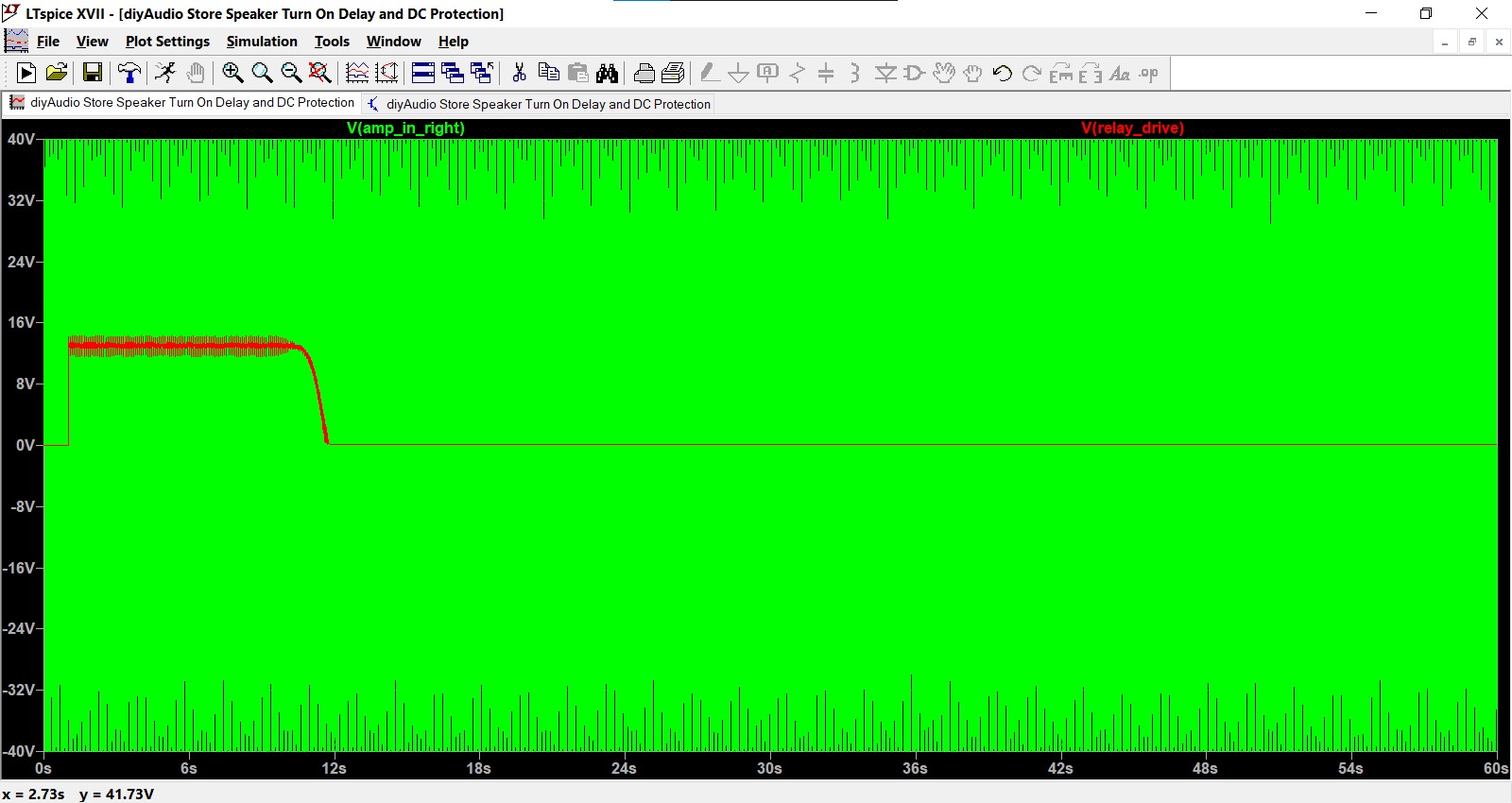

The simulation can also be used to apply a low frequency input voltage and so allow a determination of when the circuit might trip. High frequencies are filtered by the R/C time constant, it is the bass that is the problem.
Lets try 20Hz at 40 volts peak. So that is the nominal 50 watts rms/8 ohm value. And it seems fine with just 100uF caps fitted. You can see the relay trace in red.
Lets go to 47uF. And that shows the circuit now will not close the relay. The signal itself is tripping the circuit... but that is 50 watts worth of signal at 20Hz.
So I would by all means experiment. The worst that can happen is the relay trips when you turn up the volume and there is lots of bass.

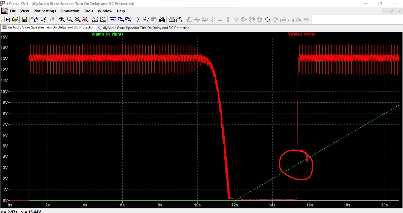

So here is the circuit when faced with a slowly rising DC offset.
The relay connects after 10 seconds and then the amplifier develops a rising offset.
You can see the trip point is around 3 volts DC. That value is higher than the 0.7 volts or so that some might have expected because of the potential divider action of the 27k and the 10k.
That actually throws up the question of what happens when a fault is present in just one channel. This means the good channel is still at zero volts and so the 27k of that channel will also effectively appear in parallel to the 10k.
The effect of that is to slightly raise the trip voltage a little higher, however these values still give very low power dissipation in the speaker during that time if such a fault as a low DC offset appeared.
For example 3 volts DC is just over 1 watt dissipation in the bass driver unit.
