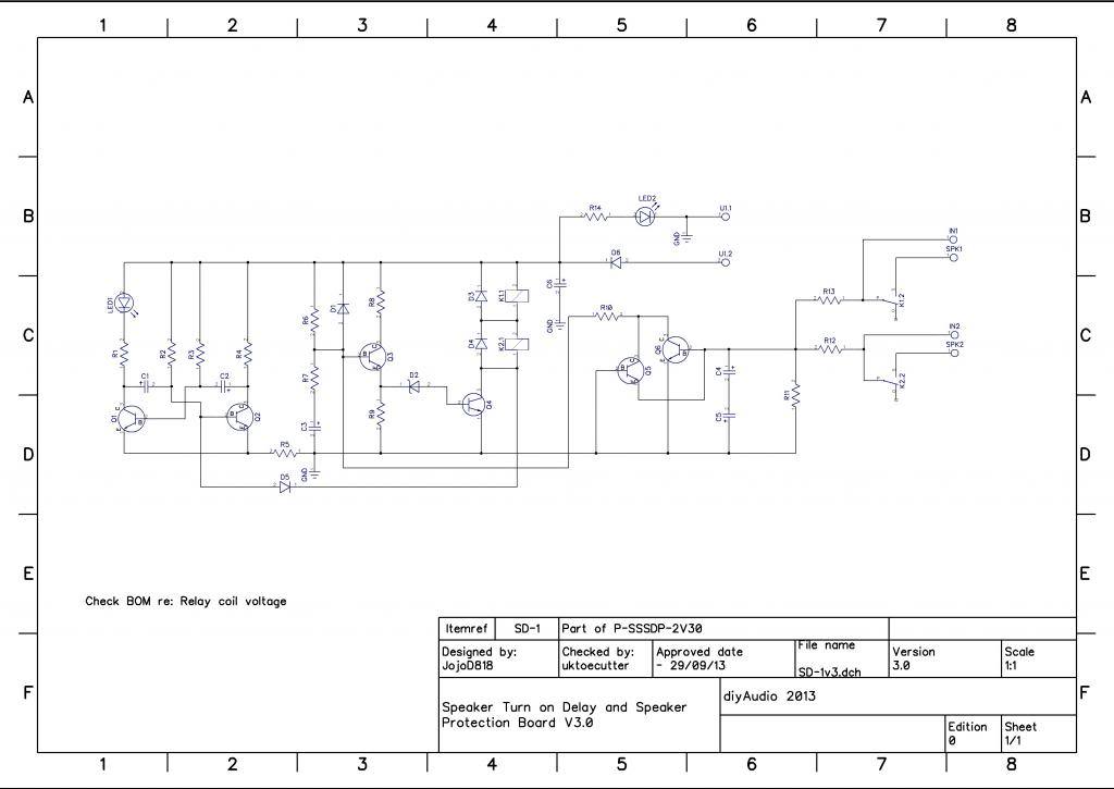

So, is this now the final working design with all the correct component values ? If we order the PCB from diyaudio, is this exactly what we would get ?
Yes, I‘d say it passed the tests flawlessly.
... You made my day, thank you for your guidance, patience, evedyrhing!
You're very welcome and I'm pleased it all seems to work OK 🙂
Ahh... well I think it is (and remember it is a very long running design).
I hadn't looked at any of this until the other day when the thread caught my eye so I haven't followed any twists and turns over the years.
I built these boards according to the boms.
Unfortunately, there has been some issues which are in the thread's timeline and such does irritate a bit. The solutions, if not plainly in the bom, board and build-instructions, are all buried in the thread.
The difficulties lie in the tiny details like delay-time etc.
But: I built it, and it passed the tests perfectly without changing anything!
It's great to hear that your issue was resolved. Further documentation on picking component values with respect to supply voltage and delay time is a great idea, in fact a full documentation reboot and thread clean up is warranted (as with almost all the "old" boards). As the saying goes "the squeaky wheel gets the oil" but 2021 is the year this is going to happen. Many thanks to Mooly for such a comprehensive and helpful debugging process!
It would be great to have Thomsontec also work through his problem through to resolution.

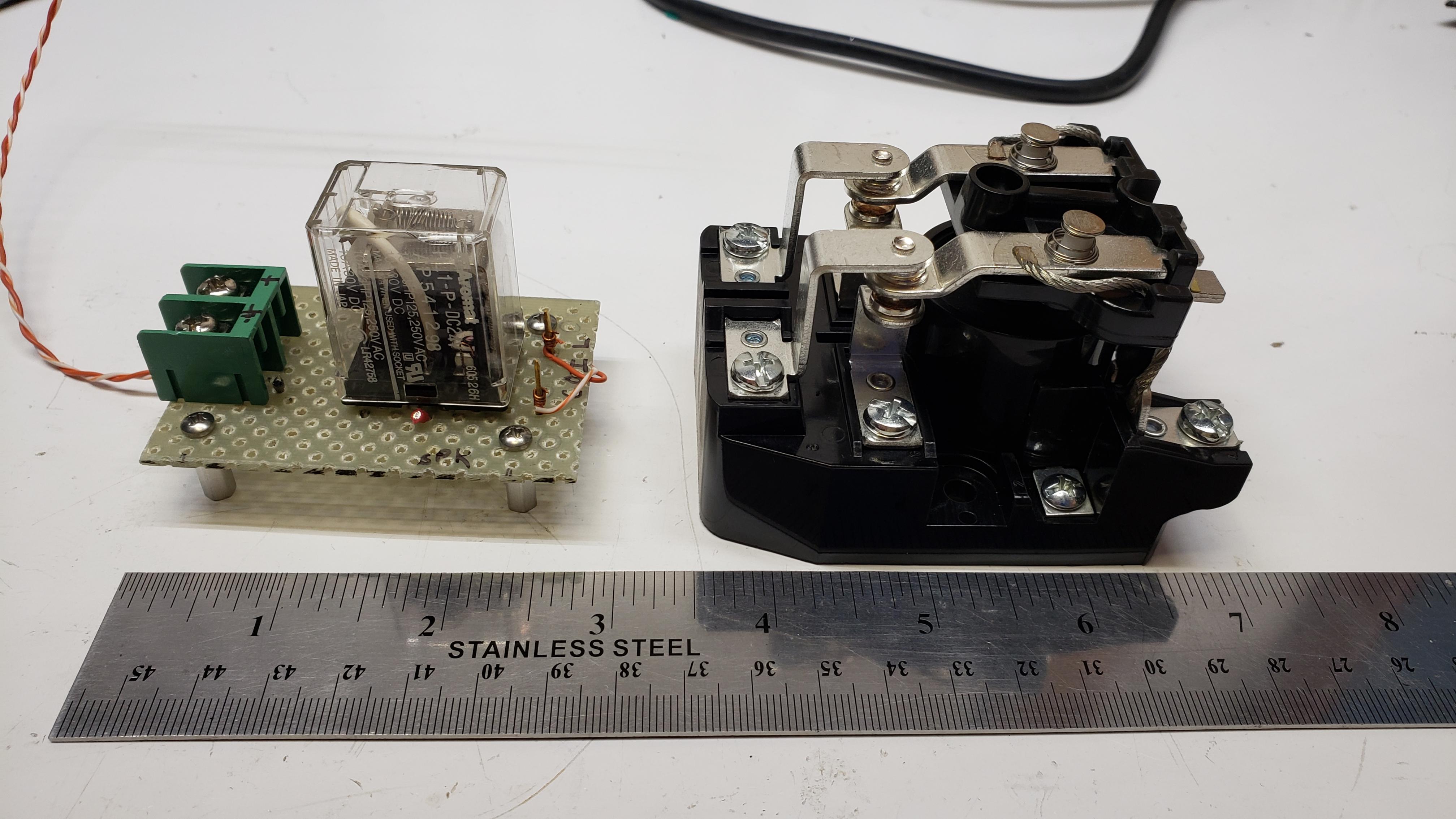

Finally got around to testing the trip points on my board. Trips at -3.86v and +2.22 volts. I then tied the input to my signal generator and got it to trip at 8 vrms 10 hz. Since I am biamping the system I am planning on reducing the value of C4 , C5. I have a new relay on order which will draw more current so I will need to upgrade T6.

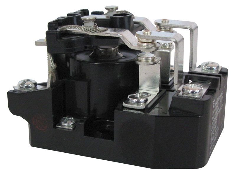

Get them while you can
Just installed this relay in my Aleph J. 24 volt 84 ma coil. Large contacts, 2 mm gap. Allelectronics has them for $7.95 compared to standard 10 amp ice cube style relay this thing is huge.

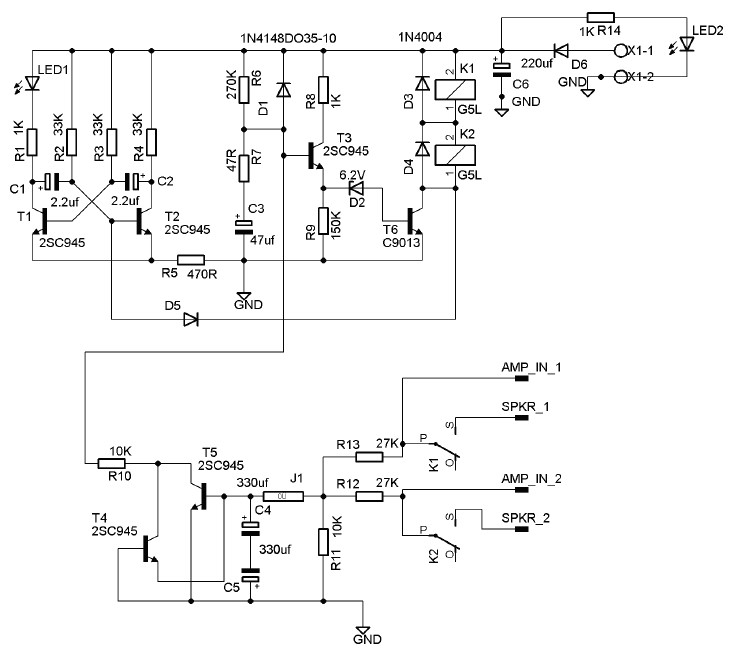

Hello again!
Just a little question regarding the LED, which are very bright:
Looking at the schematic, it seems to me that they (LED1 and LED2) are doing more than just glow? I am absolutely not sure if I can change the values of R1 and R14 to 10K to dim them like the others in the amp?
many thanks!
david
You can change R14 as desired.
R1 can also be changed to reduce the brightness but I would recommend that you also add a parallel resistor across R1 and the LED. Try a 1k2 or 1k5 if for example you make R1 a 10k.
Thank you Mooly.
Just to be sure: @ R1 I'd place a 1K2 / 1K5 across the resistor _and_ the led?
(LED gets the current through R1=10K, and the circuit gets the current through both R1+LED and the 1K2?
This stuff is fun!

Hello again!
many thanks!
david

Thank you Mooly.
This stuff is fun!
That's it. All it does is attempt to keep the mark space ratio of the astable multivibrator formed around those two transistors the same as it was originally.
Just raising the resistor value alone and not adding a parallel one would alter the timing and mark space ratio of the astable. The best value for that resistor depends on what value you decide on to set the LED current.
