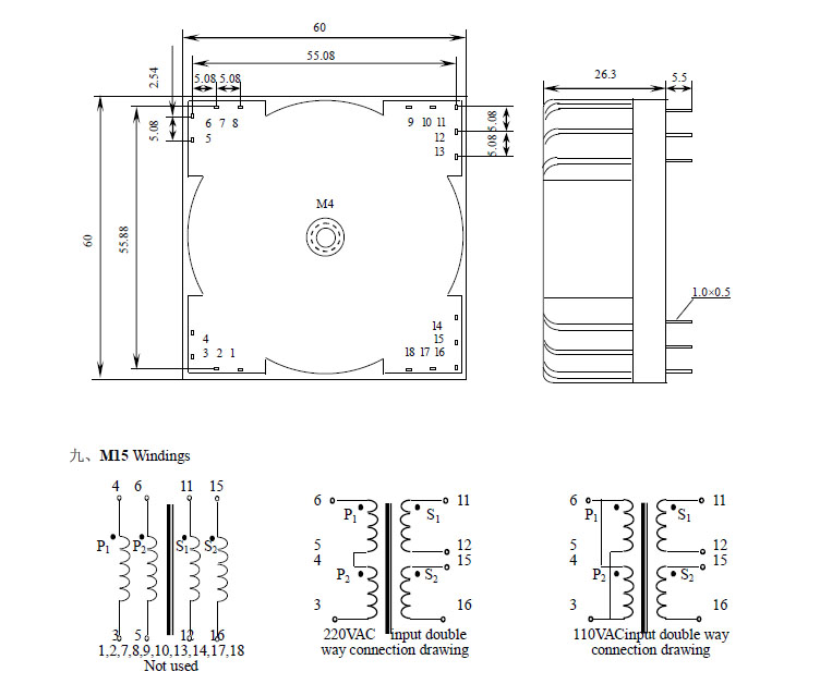

I built a PCB speaker protection, I already have a transformer with two 18V secondaries. 7.5 VA for each rail, I can't connect the outputs in parallel to have only one 18V and 15VA secondary. So I intend to use only one 18V secondary. and 7.5VA. Is it enough to operate the card? 😕
7.5VA is about 400mA, so current wise there is no issue.
for voltage , 18VAC is enough to operate 5V relays as they are in series.
No-load voltages will be higher. It's in the nature of transformers to saturate their core (if cored that is) and have a higher voltage apparent. If it's a toroidal, you can always add your own winding for small voltages. 😱.
You might also be able to get away with a slightly smaller voltage if you have any other windings at a lower voltage. That I do not know, as I didn't read every post.
18V AC rectified will also work for two relays in series, as the voltage after rectification would be above 24v, and then drop a little because of the voltage drop across the diodes.
(May I mention that that's a very overkill transformer for a protection circuit? That's a nice transformer for a little headphone amp...)
quote " 18V AC rectified will also work for two relays in series, as the voltage after rectification would be above 24v, and then drop a little because of the voltage drop across the diodes."
The pcb has half wave rectifier, so DC volts will be only 16-17VDC with 18VAC input.
The must operate voltage for two of 12 VDC relays is 18V (75% x 12 x 2)
So its a bit risky to operate 2 numbers of series connected 12VDC relays with 18VAC input. The relay coils may not operate reliably.
