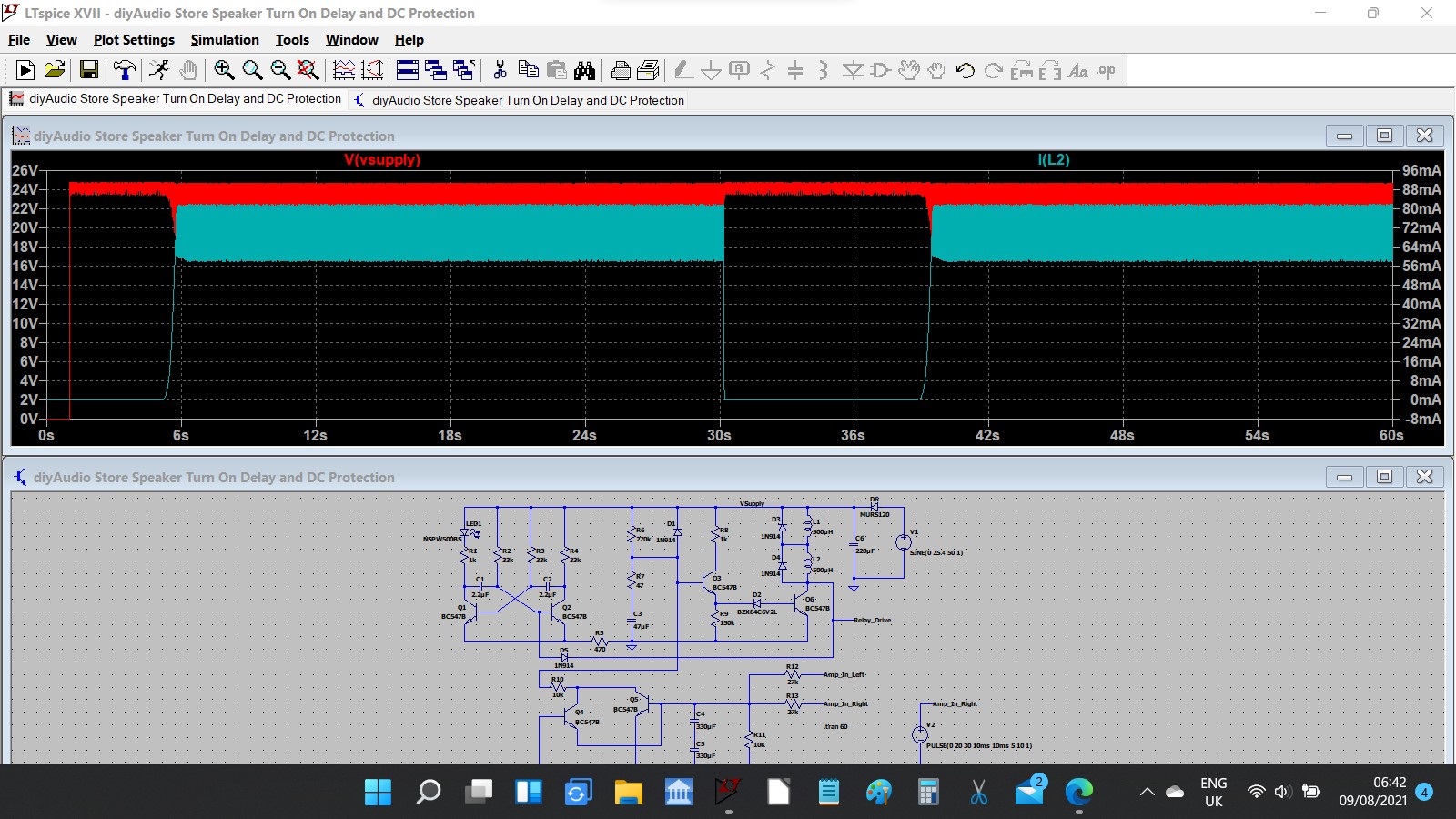

The sim of the circuit seems to operates OK with a 22 volt ac input. The caps need to be at least 35 volt rated and the series resistor for the LED will need increasing to keep the brightness reasonable.
The 12 volt relays should be OK.

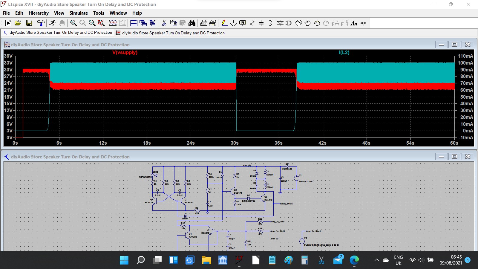

A 24 volt winding will generate nearly 35 volts DC. Your 18 volt (22 volts at light load) one generates over 30 volts. The design of the circuit and the low value of reservoir cap means the DC is not clean but the average DC voltage when your 400 ohm coils energise would be around 26 to 27 volts which is fine.

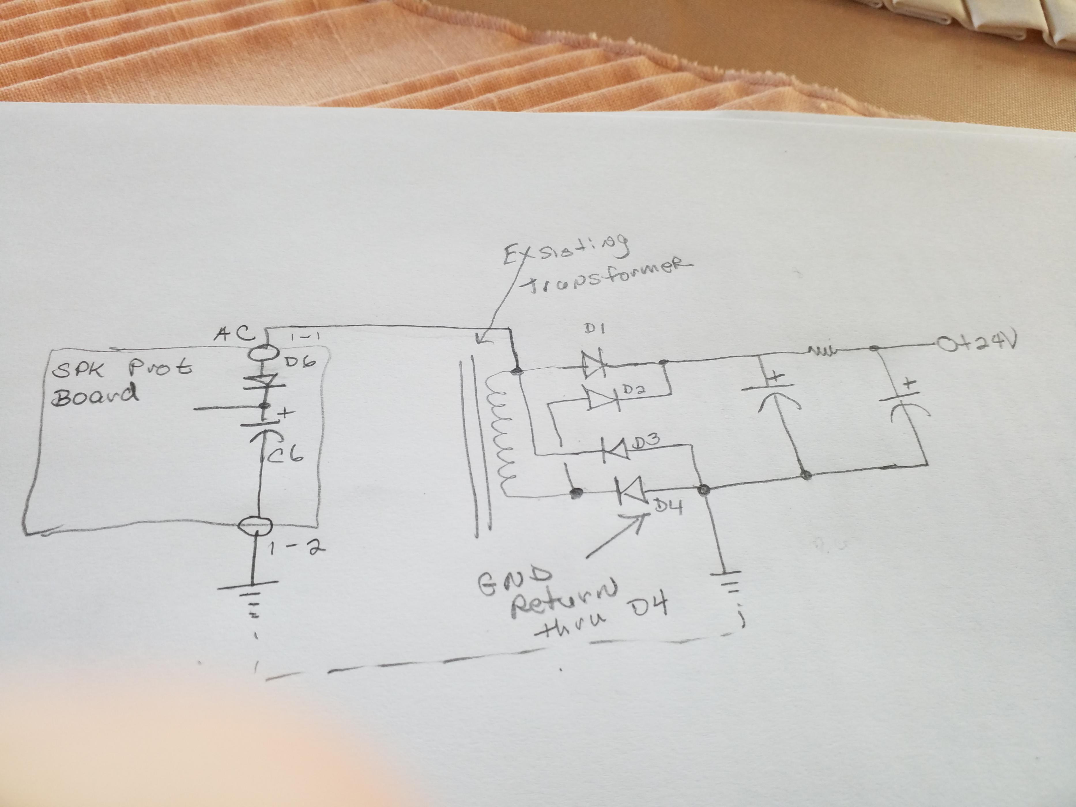

If you attach the ac input lead of the speaker protector to the correct phase of the positive supply on the exsisting 18 volt transformer . You will get 24 volts dc minus the voltage drop imposed by D4. I have used this method on several amplifiers wit great success.

That seems to be the version I had set up. Your nominally 18 volt transformer should be fine and at light loading you have measured the output at closer to 22 volts.
This is with 18 volt and then 22 volt AC applied. I've only shown the supply voltage generated and the relay current. When the relay energises the reservoir cap is at the higher rail voltage and only when energised does the voltage fall. That is a well known technique for reducing relay coil power dissipation. Once a relay has pulled in it will 'hold' on voltages down to around 30% of the coil rating.
