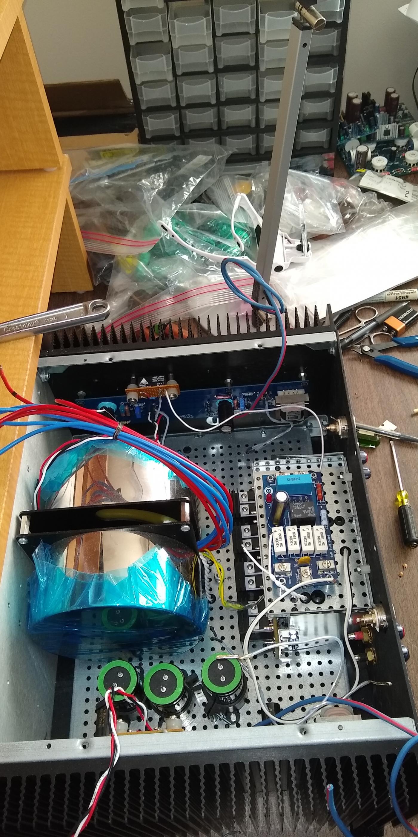

Pete, I haven't left the world of tube amps but I've certainly been dragging my feet about finishing my F6. It didn't help me that I had to pack up and move my things to storage for 6 months while I started a new job and moved house. I'm finally getting comfortable in my home work space but there are plenty of things that I still can't find yet.
Years ago I built a pair of dc coupled tube monoblocks and spared no expense on them. They have an interesting harmonic profile and they compress as you drive them harder and do that thing that some of the great recording studio tube limiters do. It's not reality but it's a show and a show that I love and it keeps me up late because I always want to put another record on. But after years of it I really want better bass control and more power before distortion so on to the F6. The funny thing about this is that after accumulating some medical bills and then a gap in employment, I decided to pull out the Black Gate WKZ high voltage electrolytic capacitors from these amps and another and sell them on eBay as the demand was crazy. The thousands of dollars that I got from that covered all of the expenses of my monoblocks and of another tube amp plus part of the cost of my F6. And my friends laughed at me for paying $140 each for the 100uF+100uF@500V WKZ. I enjoyed them for well over a decade and still made a huge profit on them.
The F6 has become a bit of a layout puzzle as I have two big transformers and a discrete rectifier board plus the soft start, speaker protector and it's shielded power supply. I still have to fit eight of the electrolytics on each side and the only way I'll pull that off is to stack them vertically.
Mike

Thanks Pete. I like the bigger boat analogy! I'll make this chassis work but I'm a little bit claustrophobic and looking at the project in it's present state triggers a little of that constrained space discomfort.
Tube amps are rewarding and working with the energized undersides of tube amps really isn't dangerous if you keep one hand in your pocket while putting a test probe on a point.
