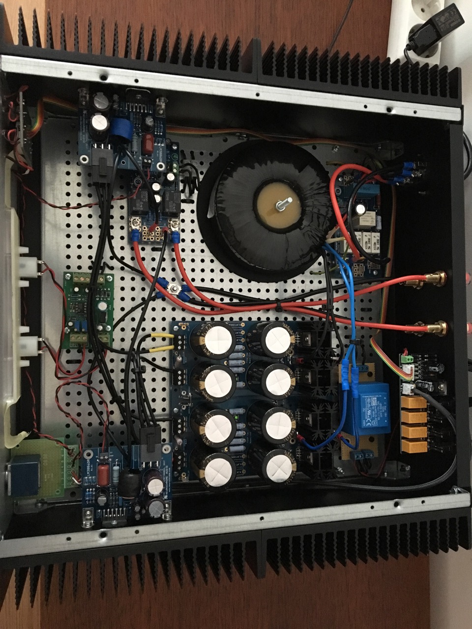

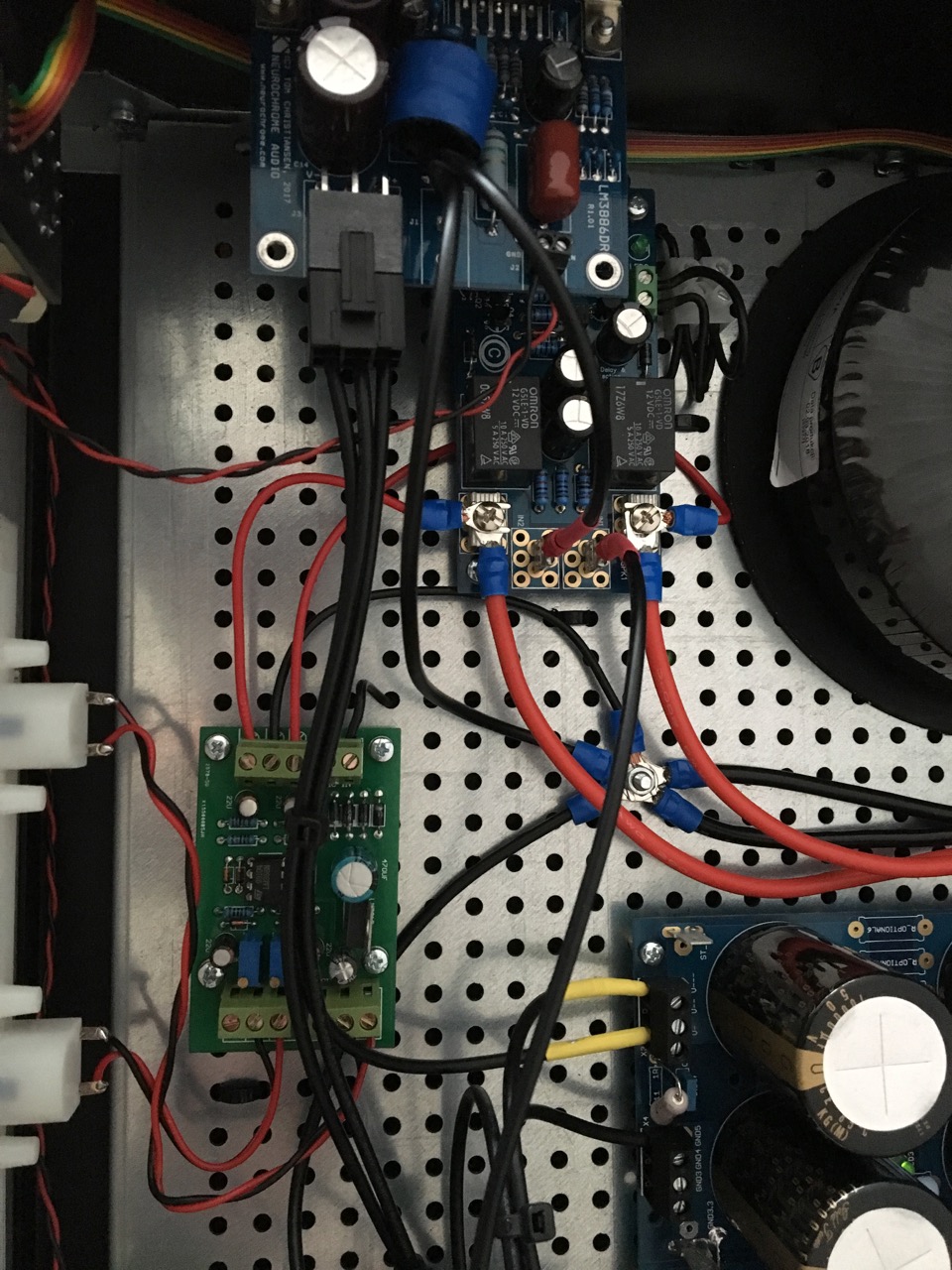

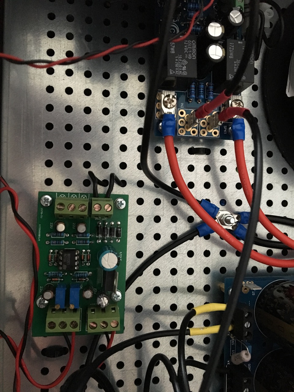

Hi diyAudio community,
this is my first post in this Forum - so Hi! I have built an audio amp based on few diyAudioStore components (soft start, speaker protection board, universal power supply). I used LM3886 Done Right as amplifier. The transformer I used is 300VA 2x22 V. I also used a secondary transformer (18V) to power speaker protection board, source switch and VU meter board with AC. I do not have schematics yet, but I posted few photos to give an impression, the whole project is pretty straight forward.
My current problem is as soon as I connect signal output terminals and ground to the VU meter board, the speaker protection delay will not engage.
I measured the DC on the input terminals on DC protection board, in both cases (with and without vu meter connected) the voltage is ~0.004V.
Does anyone have an idea why the DC protection board might not kick in? Thank you.🙂
