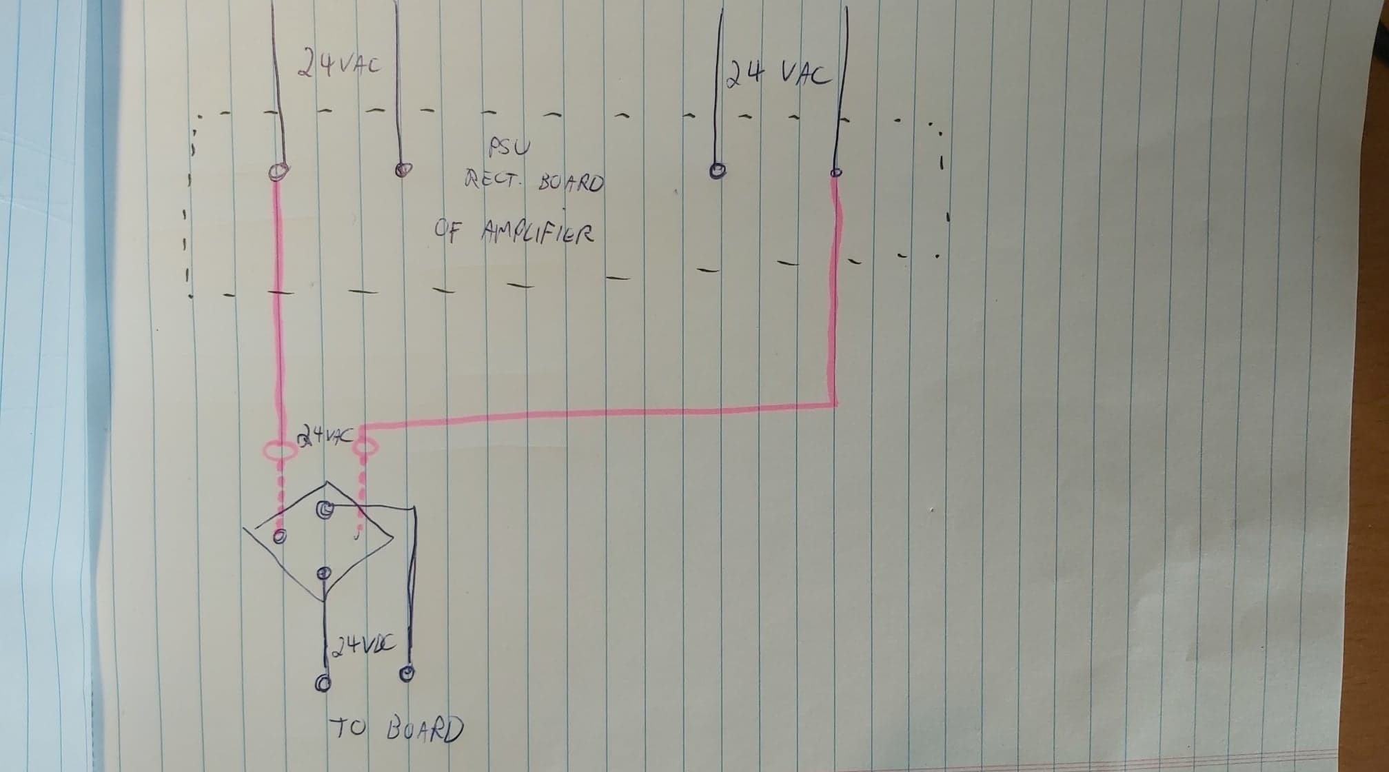

You must use either a dual secondary into dual rectifiers and then series connect the two smoothed outputs
Is this what you mean? Not sure I understand your explanation. As I understand for a dual secondary, both secondaries must be implied in the circuitery ?
rsaumure: did you measure the secondary output while hooked up to the speaker protection circuit or w/o any load on the transformer? The BV301S24023 has a no load Vmax (41.9V) of about what you measured. Measure the VAC across the input at the Protection board while it’s on. When the transformer and the board are connected, and on, what VDC do you get across pins 2 & 5 of the relay itself? I presume you are using the 12V relays?
Pete
Cool - thanks I was measuring without any load on the secondaries. I am using the 12 V relays. Right now I am trying to figure out how to stuff everything into the 4U Deluxe chassis. Did nor realize how tight everything was going to be inasmuch as I built the Universal Power Supply all on one board. Need to go back and break off the diode sections. In practice when installing the speaker protection circuit I assume you just pull power directly from the toroidal transformer? Much thanks!
