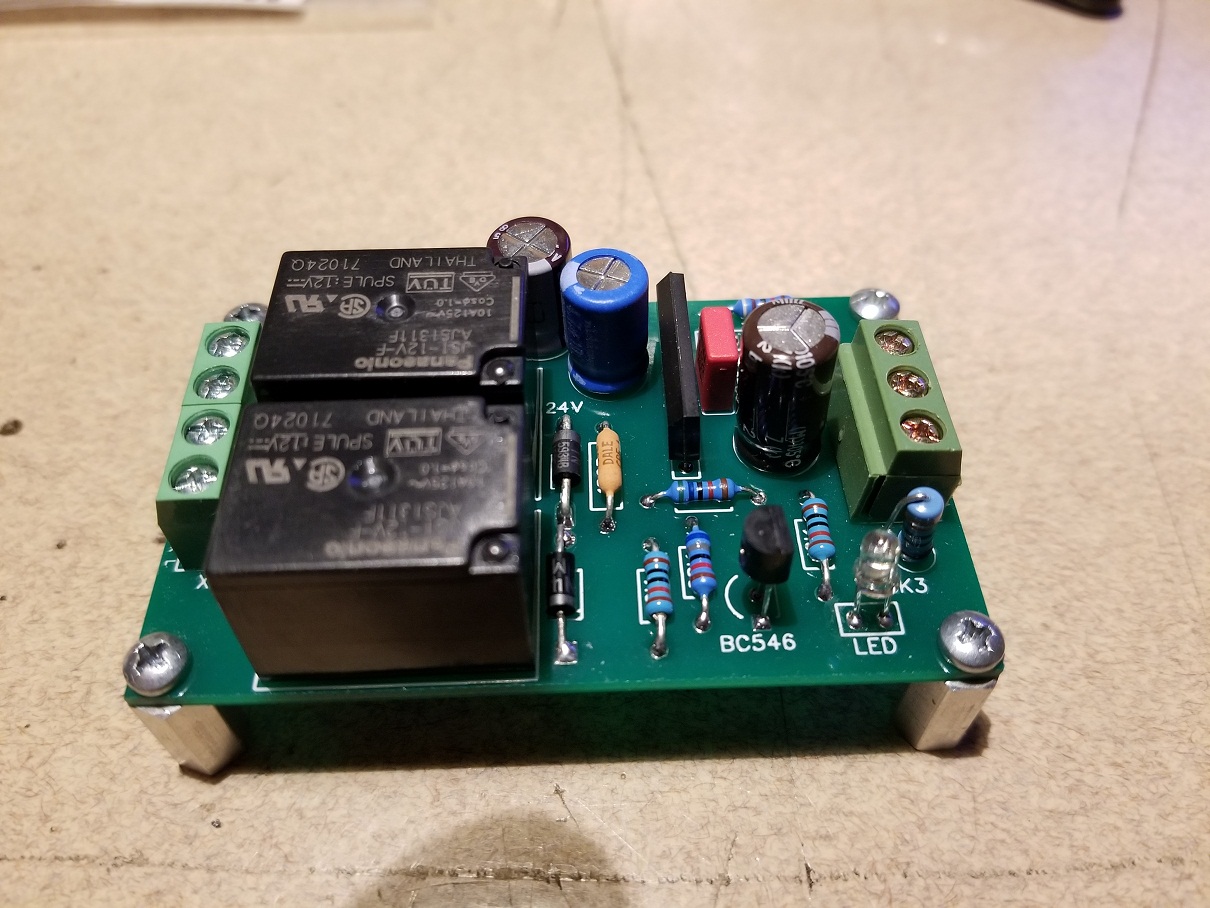

Hi, new member and first post, so be kind 🙂
I just built two of theese boards, one working fine, the other one however is only opening one relay.
I powered them from a 15VDC powersupply i had from before, using 12V relays that might be low, but the three other relays are working fine.
Now my skills in electronics are REALLY low all i could find out was that this relay got now power to the coil, and the Ohm was different over the last rectifier then all the other ones, so i swapped it for a new one.
Now i get power to the coil, but it still wont close...
I messed up my order for parts so i have double of everything except the relays, so my question is: can it be anything else than a faulty relay?
Sorry for my bad english (im Norwegian) and for the poor explanation (i am a plumber)

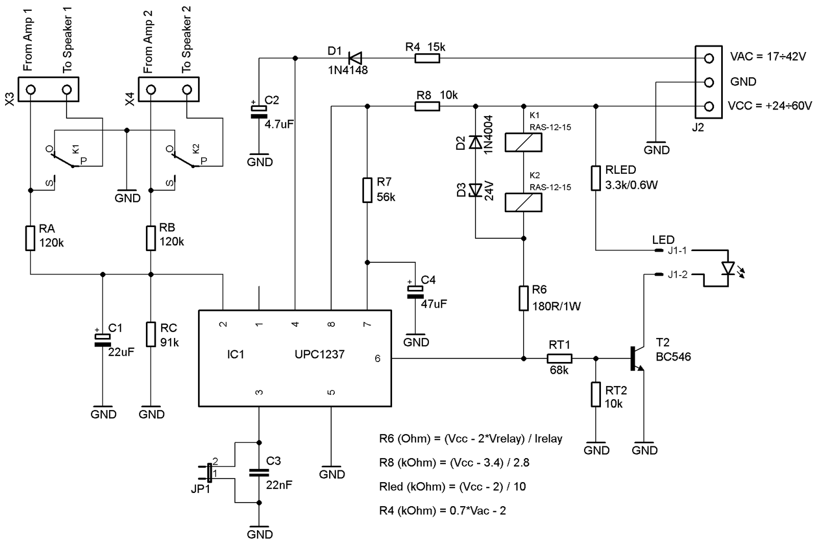

Howdy, question about source voltage (and I don't think this has been specifically asked from my travels through the thread. Apologies if I missed relevant comment) and here goes:
Based on the commentary here from Post #50:
https://www.diyaudio.com/forums/the...-dc-protector-board-set-v3-5.html#post4013138
Does that mean if I'm planning to use a main PSU transformer with 18 VAC secondaries, then for K1 and K2 it would be appropriate and workable to select an Omron G5LE-1A4-DC9 as alternate components:
G5LE-1A4-DC9 Omron Electronics | Mouser Australia
and that way I could simply take a feed off one of the 18 VAC secondaries to power the board?
Thanks in advance.

Just to throw this out there, I use a protection board I found at DiyFan.com. It's based around the uPC1237 IC. It seems to work pretty well. Attached are the schematic and hook-up files and a picture of the one I just built. I have a few extra boards if you want one. Let me know.

I etched my own PCB and i tried with 12vac and 12vdc with 5 volts relay and the led stop blinking after 13s for 12vdc and 8s for 12vac

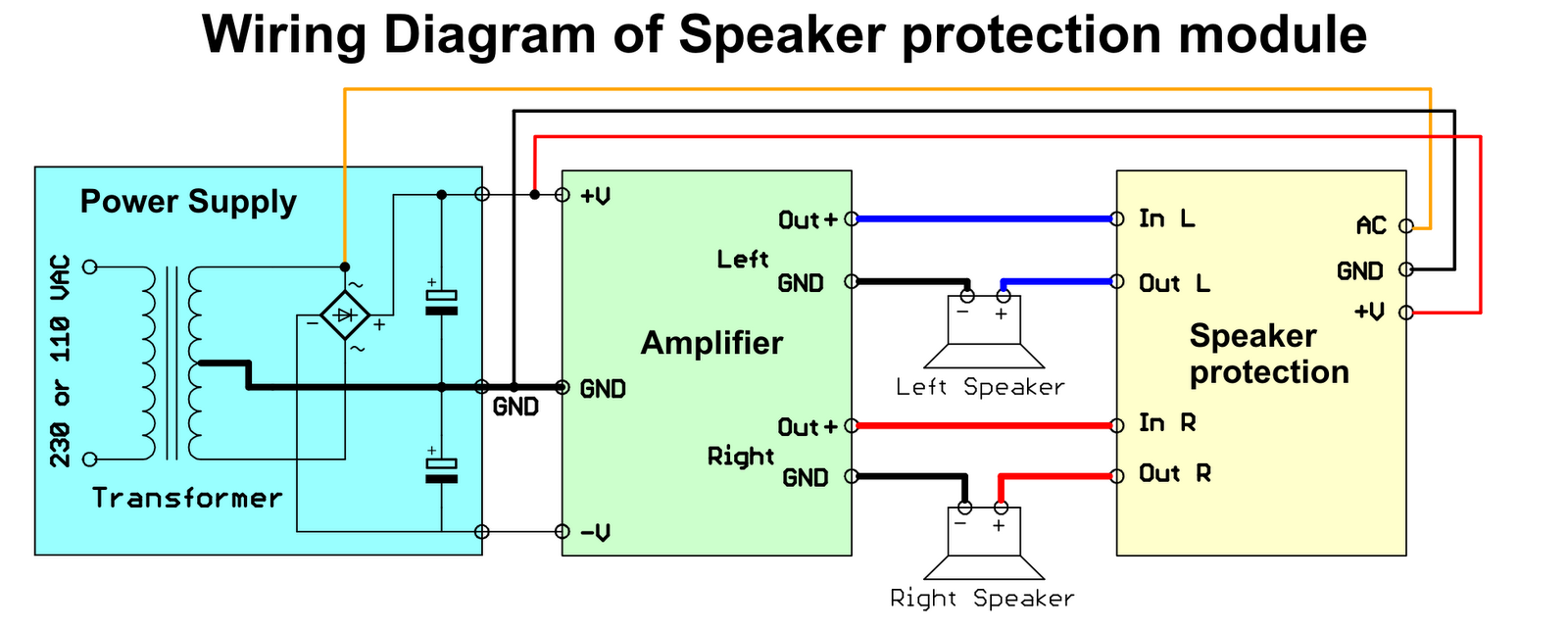

i have one 25-0-25 volt transformer for my amp that i would like to use, so i changed the 5v relays with 12v relays, when i tap one of the 0-25v to power the speaker protection board, the led do not stop blinking and do not engages the speaker relays with the connection (Amp-in connected), now if i disconnect the Amp-in the led stop blinking and engages the speaker relays after 5s.
I also tried with a separate 24vdc Power supply and the led blinked for 5s and after the same time the relays engaged (Amp-in connected).

With a separate power supply the speaker protection work well and connected directly to my Amp transformer 0-25vac that do not work
Any thought...
