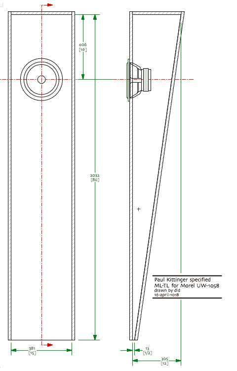

Would you get a "G-tower" by inverting an existing Met design, putting the driver up top (versus, say, a Zd of 1/2 the line-length) and moving the mass-load port from the S1 end to the front-firing position shown?
1st, the Zd in any well designed quarter wave pipe is important to suppress some unwanted pipe harmonics.
A voigt tapers the wrong way to make into a g-tower. It is an unfolded tapered TL. terminus smaller than line start.
Here an example if a design Paul K did:

Thanks Dave, it would be interesting mounting them without interfering with the port/slot at the bottom. Likely metal work. Does it provide useable bass in large rooms. Useable bass means a low note on a bass guitar, or realistically close.
