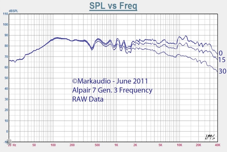

The poor little Mark Audio Alpair 7 MS is just far and away, too small to do the job..MA own website describes these drivers as "Operating range to 30K hertz-very linear response"
Very linear?...when the response bobs up & down 10 Db constantly thru-out the AUDIBLE range, 30K abilities not withstanding, this is not linear.
A FR driver that I believe is much better in all regards, is the Tang Band eight inch version, the W8-2145.
Tang Band spec sheets graphs are notorious for not being precise (very smoothed), Mark Audio graphs are way less smoothed, that is why the graph is more ragged.
But the W8-2145 is a great driver if you like the Tang Band sound. It's slightly coloured and i do like it, but not as much i like the sound and detail that a Mark Audio driver gives you.
