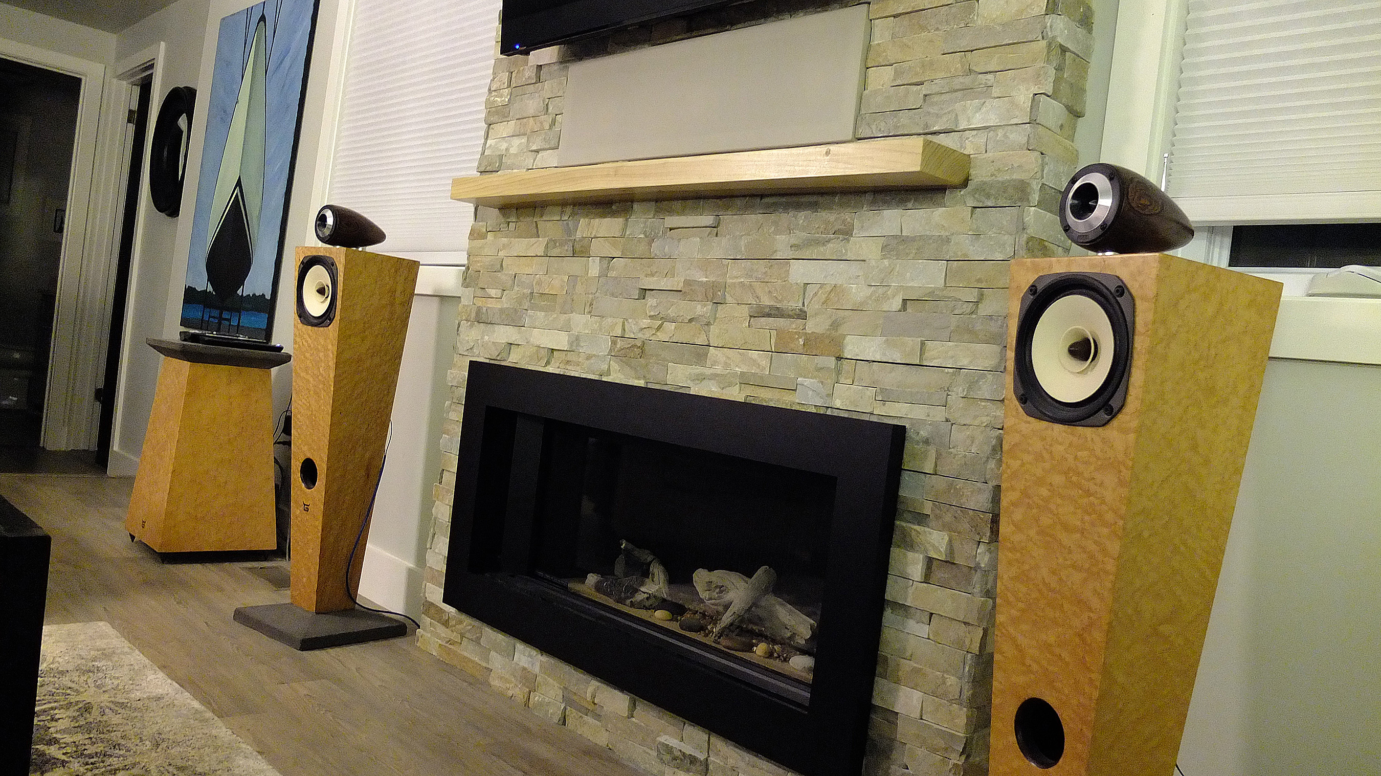

Goodwin g-tower
A short end-loaded mass-loaded tapered TL. The same format was shown in the early 2ks with RD 40-1354, a properly vetted design could be made into the same format, but it would not be endloaded, and the terminus would be closer to the end.
Would you get a "G-tower" by inverting an existing Met design, putting the driver up top (versus, say, a Zd of 1/2 the line-length) and moving the mass-load port from the S1 end to the front-firing position shown?
BKE's wife may hate them, but I think they have an interesting aesthetic. I also like the driver up high like that, being good for certain furnishing situations.
If it's truly more complicated than just flippin' and movin', please let me know ;')
