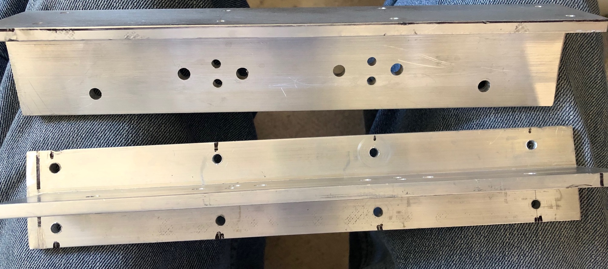

Hello,
I am looking for 1 (or ideally 2, for a friend) set of brackets to run my Vfet kit.
They are out of stock on modushop.
Do you have one set to sell me ? Thanks 🙂

Make your own. I bought 6 feet from Online Metals 2" x 2" Tee 1/4" thick.
Laid-out the boards to mark holes, etc. In the process of cleaning it up, will then blacken it using Jax's Chemical's Aluminum Blackener.
and mount it.
