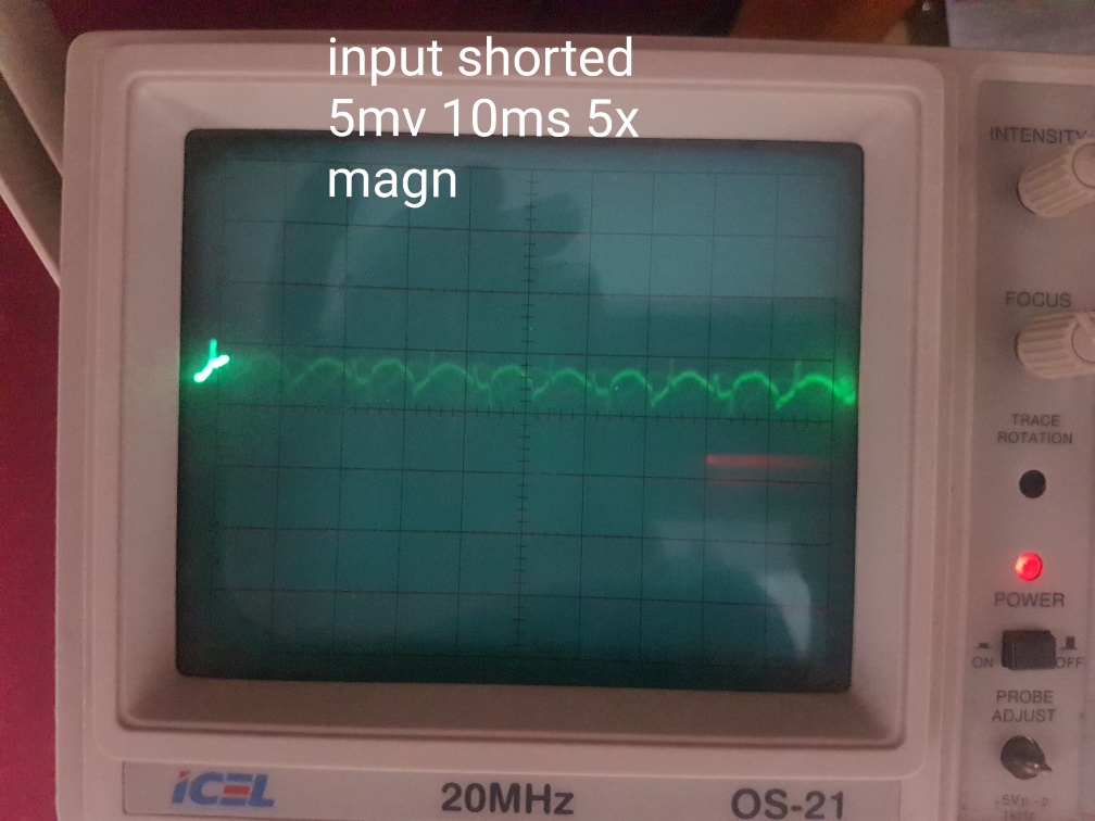

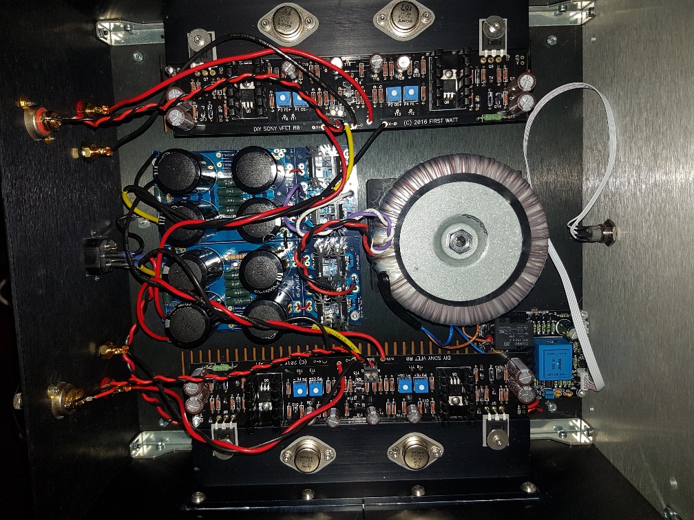

REf my previous posts about hum and noise problems I switched the transformer to the other side to decrease magnetic coupling with the sensitive input circuits. However, although better, this did not completely solve the problem. I also did some scope measurements. This is how it is now.

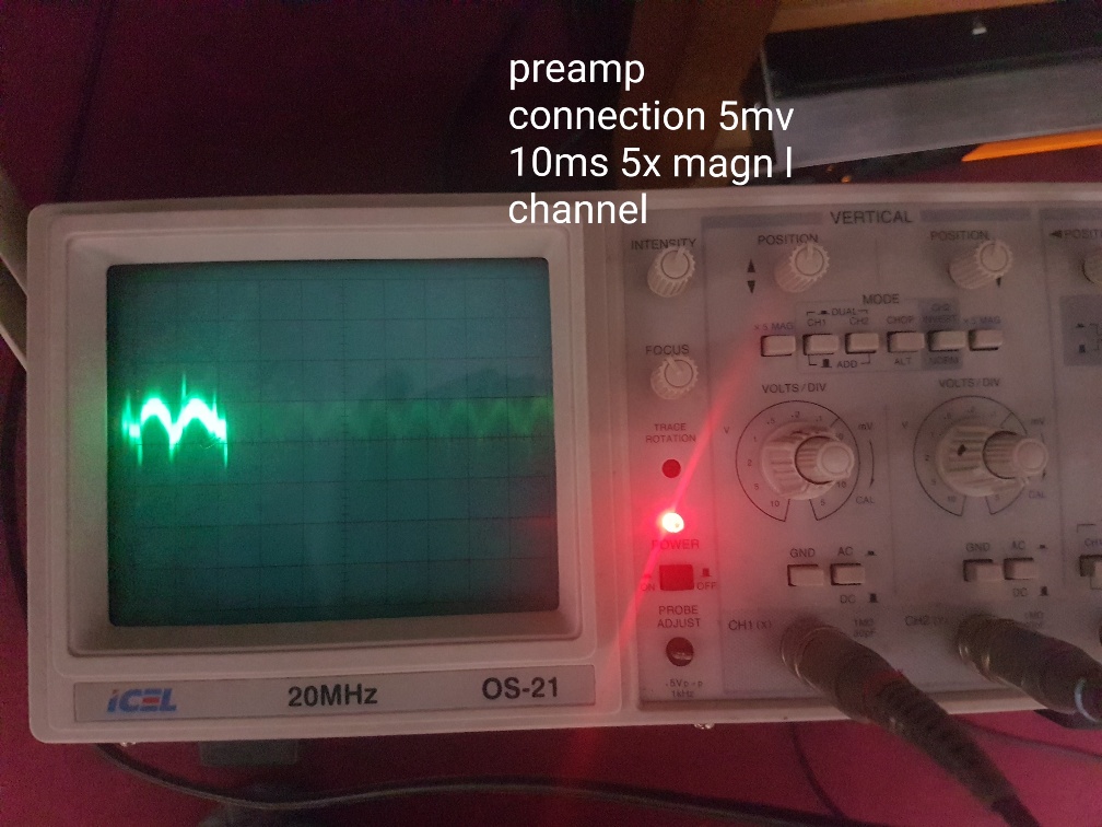

So the hum/noise is around 2mv with input shorted although the left channel has more HF components and this makes it more audible. This would be around -60db ref. 1 watt? With preamp connected the problem magnifies.
When I was repositioning the transformer I experimented moving it around as far away from the circuit as it would go but after a certain point the noise would not go down any further so I guess it is grounding issues. The earth mains is not connected in any way to the PS only to the chassis.
First i would separate the ground from the +- twist running to the board.
Second i would rotate the transformer with the inputs open to minimize the magnetic interference. It should be quiet with the speakers attached and no inputs.

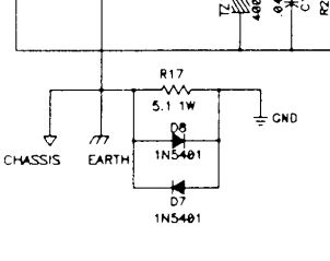

Then if it still hums with the preamp attached, i would replace the CL-60 to ground with Nelsons Ground breaker from the A75 amp.
Hope this helps,
Some of my amps prefer a CL-60 to ground, some needed a direct line to ground, others needed one of the diodes from a bridge rectifier in order to eliminate the hum. Experiment with different arrangements. Whichever you choose, be sure that your connection to earth can handle the full voltage and current of your PSU rails. When a problem happens (a PSU cap shorting due to age/heat exhaustion) you want the fuse to blow, not your connection to ground.
As I said there is no connection of the PS 0v to mains earth. So with the input shorted the earth mains connection cannot influence the circuit. The earth mains is connected to chassis for safety in case of short circuit putting the case at live voltage etc.

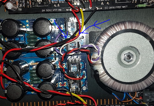

It is not as close as it seems from that viewpoint. There is a gap of 7or 8 cm. And of course any very small EM coupling on the DC supply should be taken care of by the PSRR.By the way I measured the PS ripple under load and it was about 75mv so it cannot be a problem from that side of the amp.You try moving the DC wiring away from the AC wiring?

I don't mind a bit of hum/noise as far as it is not audible from the listening seat but with 96db speakers I can hear this noise.
