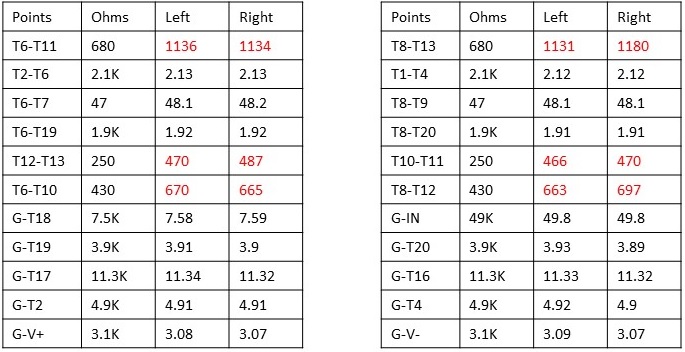

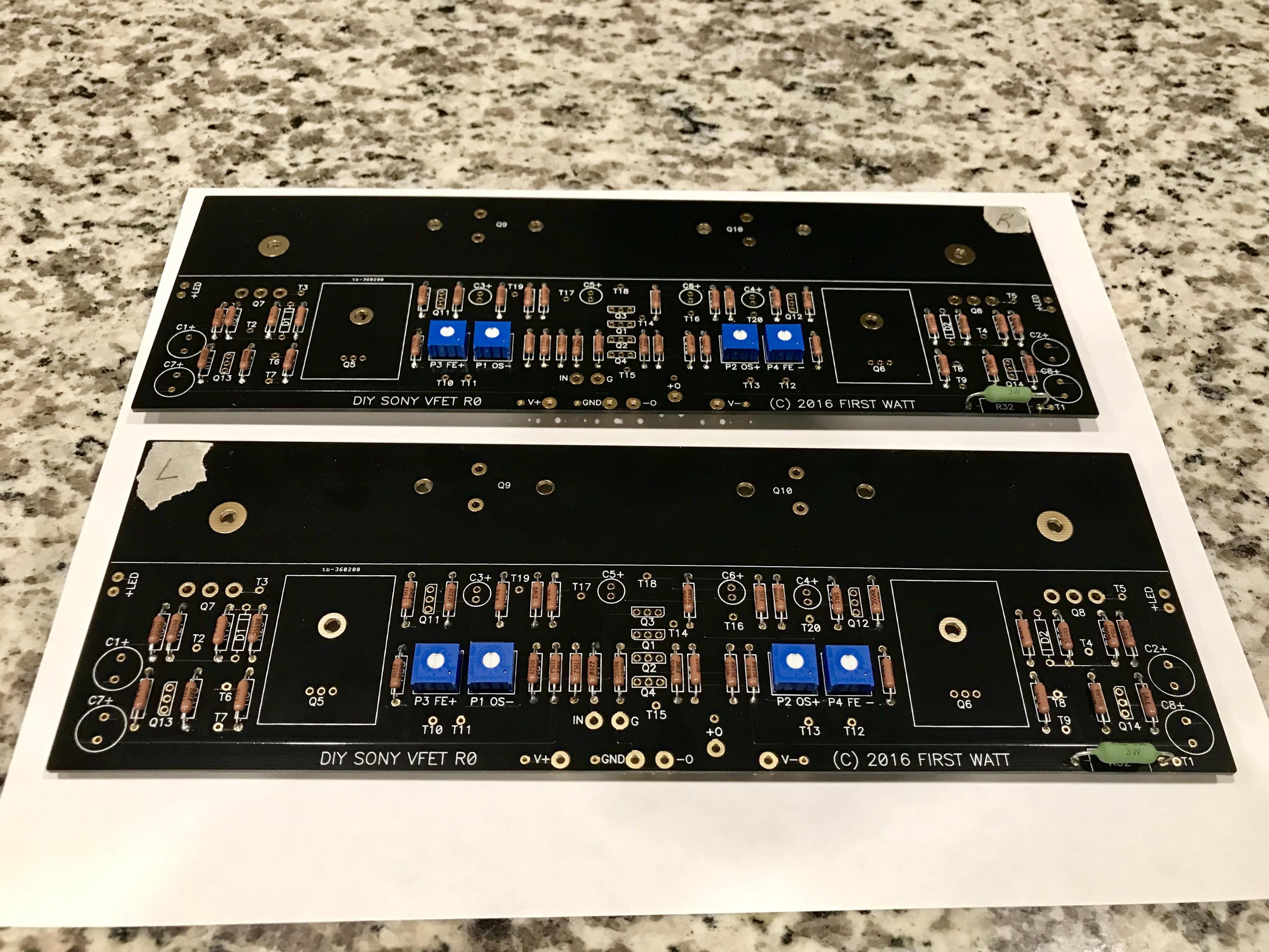

I am finally getting around to building the Sony VFET P-P amp. I carefully measured and matched the resistors and capacitors, and I populated the boards following the schematic. One deviation from the schematic is the use of Bourns 1 kohm pots for P3 and P4 (PN 652-3386P-1-102LF) and Bourns 5 kohm pots for P1 and P2 (PN 652-3386P-1-502). This should allow me to properly set the bias high enough for FQP MOSFETs instead of the 2SK and 2SJ MOSFETS.
Going through the initial resistance measurements, I found some of my measurements to deviate from Nelson Pass' document. I had all pots set in their halfway positions.
Here is a photo of the resistors and pots installed on the board:
Before I move onto the next step, I would appreciate any feedback on my measurements. I did re-check everything and I believe the differences are due to using the 1 kohm pots instead of the 500 ohm pots for P3 and P4.

I have been trying to help Rich on his build, I sold him the V-fet's I bought from Acroman years ago, and my understanding is that after he adjusted the pots some the numbers did get closer to the specified ones Nelson posted. Any other opinions, advice, suggestions on his build will be much appreciated from other members who have built this amplifier.

Hopefully others will chime in but I too think your differences are due to the use of
the 1K pot.

Thanks for the help wdecho and Dennis. I am open to input from others. This is not the first amp I’ve built, but it is the first Pass DIY amp I’ve taken on.

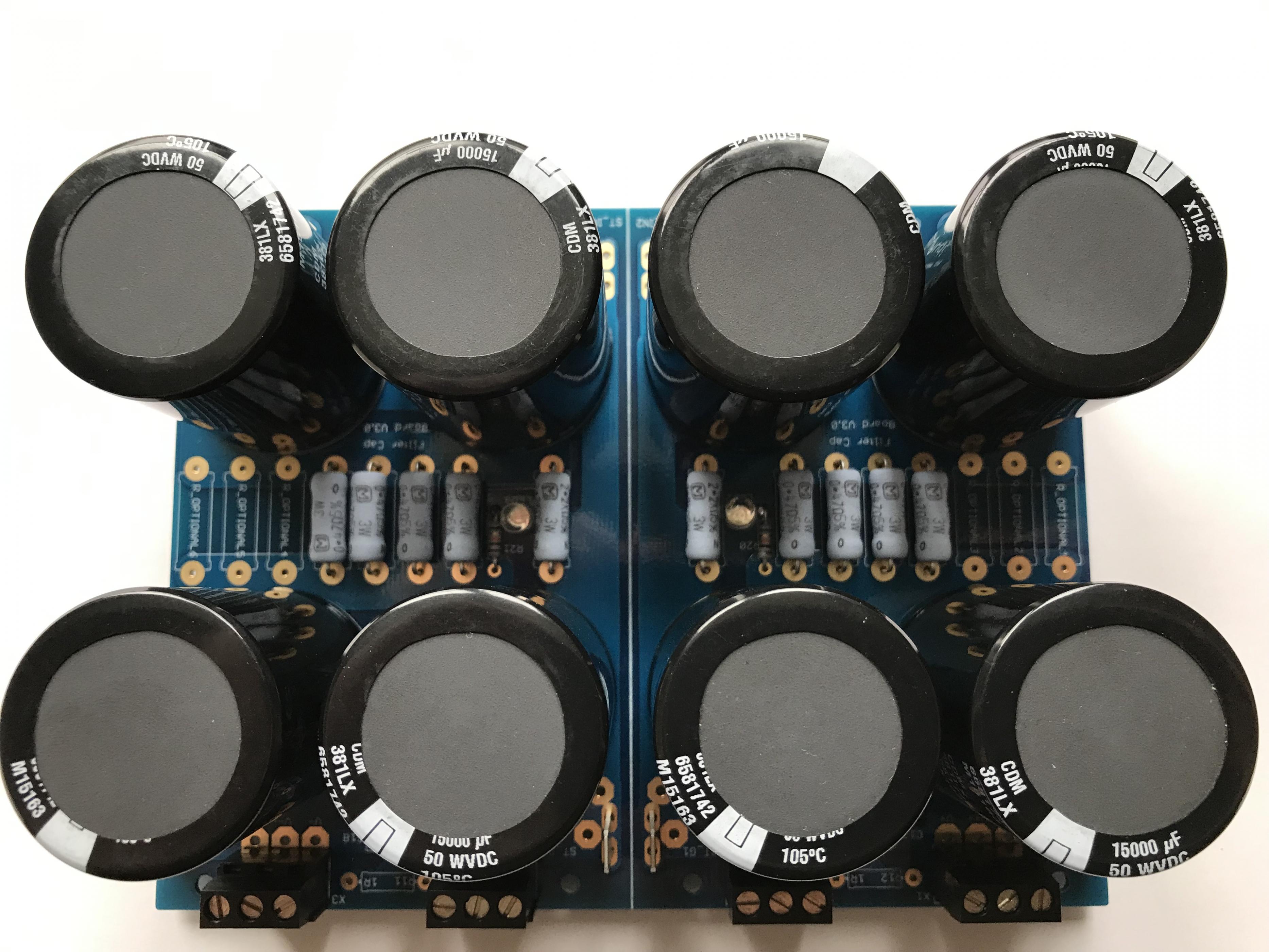

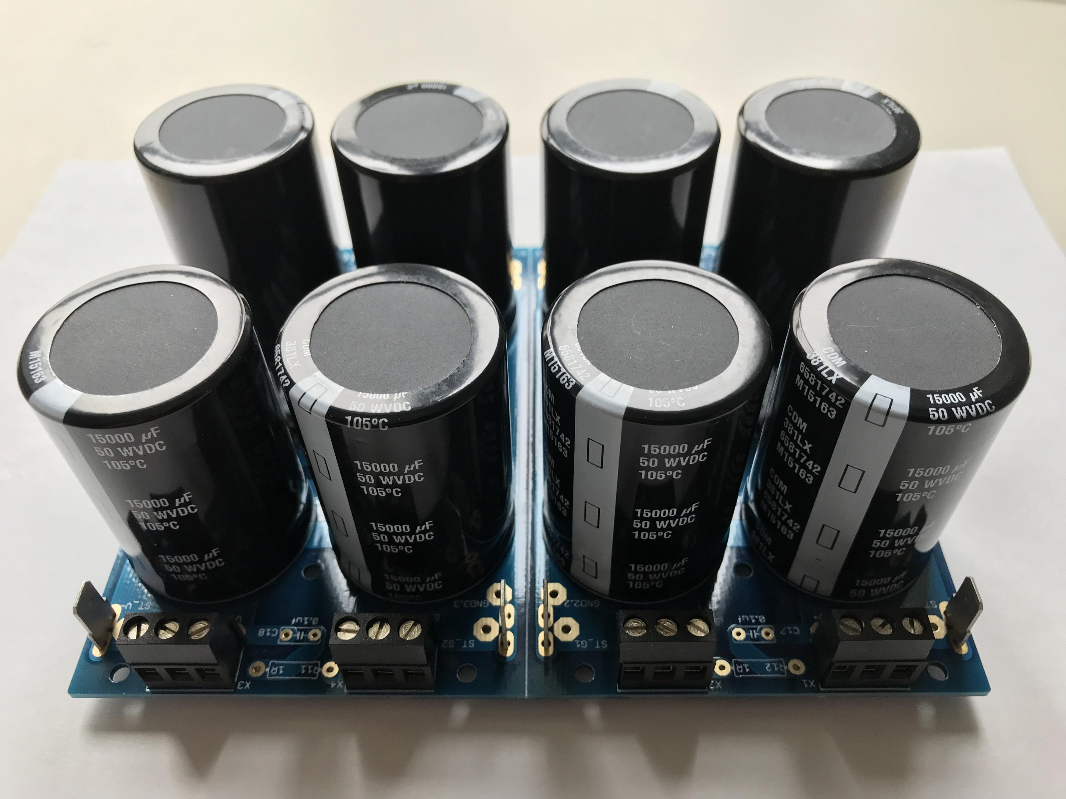

Looks like you need to join the ground planes to make it a bipolar supply
See diyAudio Power Supply Circuit Board v3 illustrated build guide for reference.
