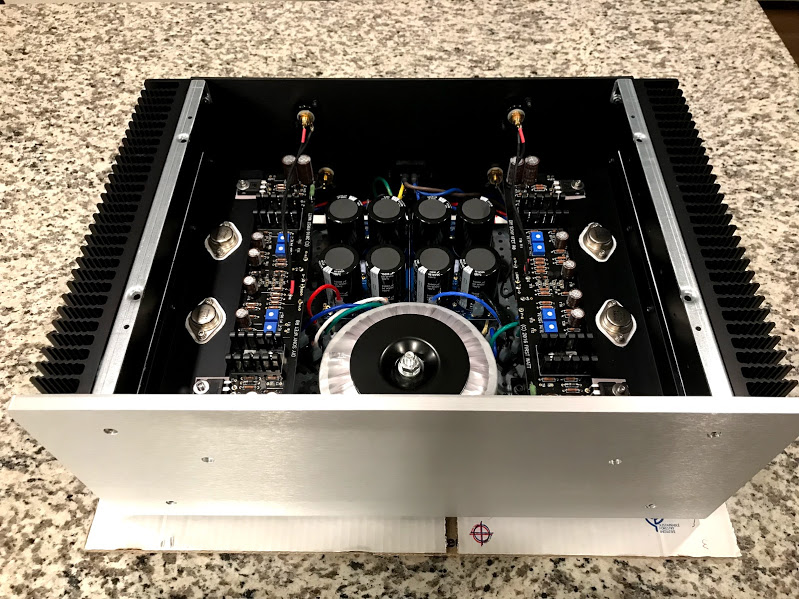

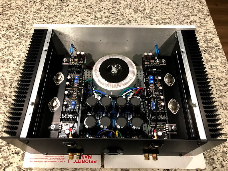

With tremendous help from Chuck (Botte here on diyAudio.com) on the Sony VFET bias settings, I have completed my build and I am very impressed with this amp with only 6-7 hours of music playback.
As I previously mentioned, I purchased a set of untested (unmatched) Sony VFETs from wdecho that he bought from Acronman a while back. He also included a pair of the T-brackets, mica insulators and a pair of the PCBs. After budgeting my money and purchasing all the parts through Mouser, Parts Connexion, the diyAudio store and the local Ace Hardware, I set off on measuring and matching resistors and capacitors and followed 6L6's excellent build guide and Nelson Pass' instructions.
Chuck really helped me with biasing the Sony VFETs and then we set it up in his system to audition the amp. The DC offset was kept well close to 200mV on each channel with the final settings. Having a great local resource like him in the Twin Cities is a real blessing. It sounded like a freshly built amplifier on his very efficient horn speakers. We then tested it with his distortion analyzer to see how closely matched each channel was since the VFETs were no tested and matched by Nelson Pass.

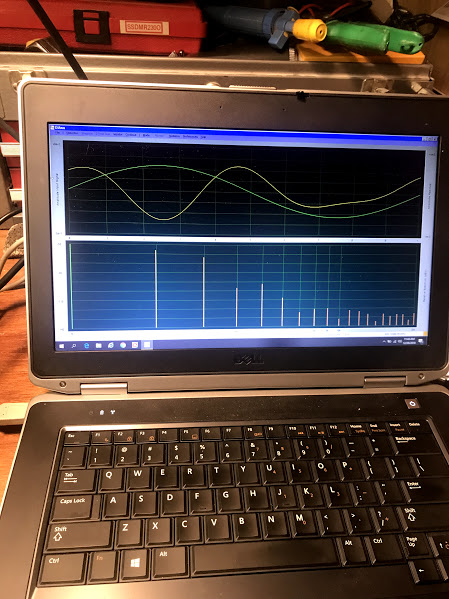

The photo shows the spectral analysis for the right channel. To my pleasant surprise, the left channel was virtually identical to the right channel. THD on the right channel measured 0.0130% @ 1 watt, while THD on the left channel measured 0.0135% @ 1 watt. It was time to close up the chassis and take it back home to enjoy.

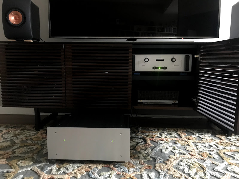

I plugged the amp into my system consisting of an Audio Research vacuum tube phono stage, an Audio Research vacuum tube line stage and a pair of KEF LS50 monitors.
This amp has no problems driving the KEF's with the gain from my ARC LS7 line stage preamp. Chuck advised me to give this amp a lot of hours for it to really settle in, but I have to say that I am already impressed. The sound is so natural and clear. This is my first Pass DIY (and solid state amp) project ever, and just following Nelson Pass' documentation, 6L6's build guide and sage wisdom from wdecho and botte really made this project a success. Thanks again all for the help.

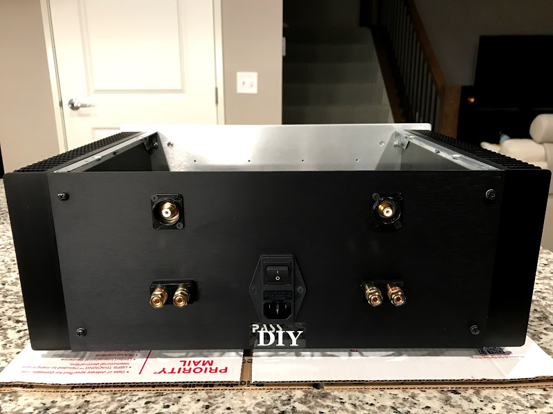

Thank you. The speaker binding posts are Vampire BP-1HEX types that I purchased from Michael Percy Audio. I also installed Vampire CM1F RCA connectors in the Neutrik RCA-in-XLR connector housings for the inputs. The input wire is Duelund DCA20GA 20ga Cotton-insulated Tinned Copper, while the output wire is Duelund DCA16GA 16ga Cotton-insulated Tinned Copper. I used Kimber Kable TCX 15AWG Teflon-insulated Copper wire for the power-supply-to-amp connections, and Cardas quad-eutectic solder throughout.

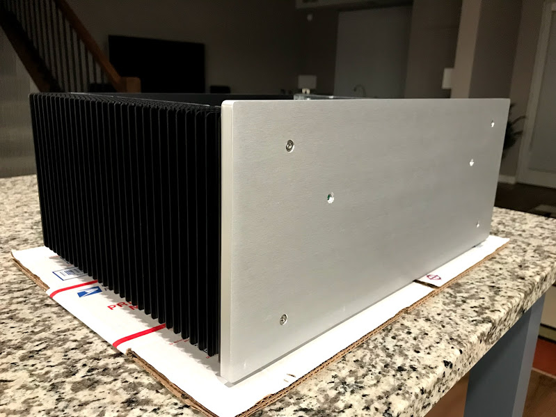

This was my famiy’s Christmas gift to me, and all I had to do was supply the labor. My colleague and friend from work offered to drill out the countersunk holes for mounting the LEDs and faceplate to harmonize the First Watt aesthetic of the 4U Deluxe Chassis with my Audio Research gear.
