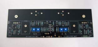

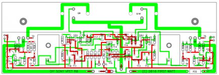

I've been reading other posts where increasing R34 and R35 are necessary? Also, I'm looking for a pic of a bare board so I don't have to guess where R34 and R35 are.

Hi Dan,
I think you can go by Papa's document:
http://www.firstwatt.com/pdf/art_diy_sony_vfet.pdf
Page 5 shows the silkscreen of the PCB.
Dennis
Dennis

1V8/220R=appr. 8mA , which is good
now , be sure that you dial back both P3 and P4 , replace R34 and R35 with , say , 390R-430R and try biasing mosfets again
check for P3 : upper leg of R35 and T10 , ohmmeter must read 0
check for P4 : upper leg of R35 and T12 , ohmmeter must read 0
"upper leg" when looking at pcb as shown in post #755
