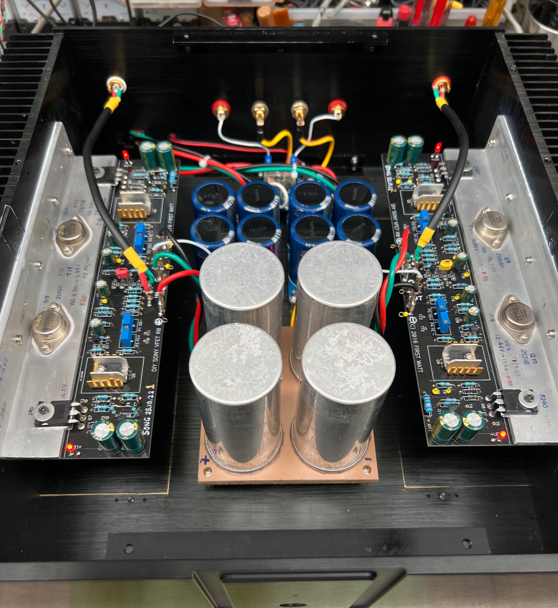

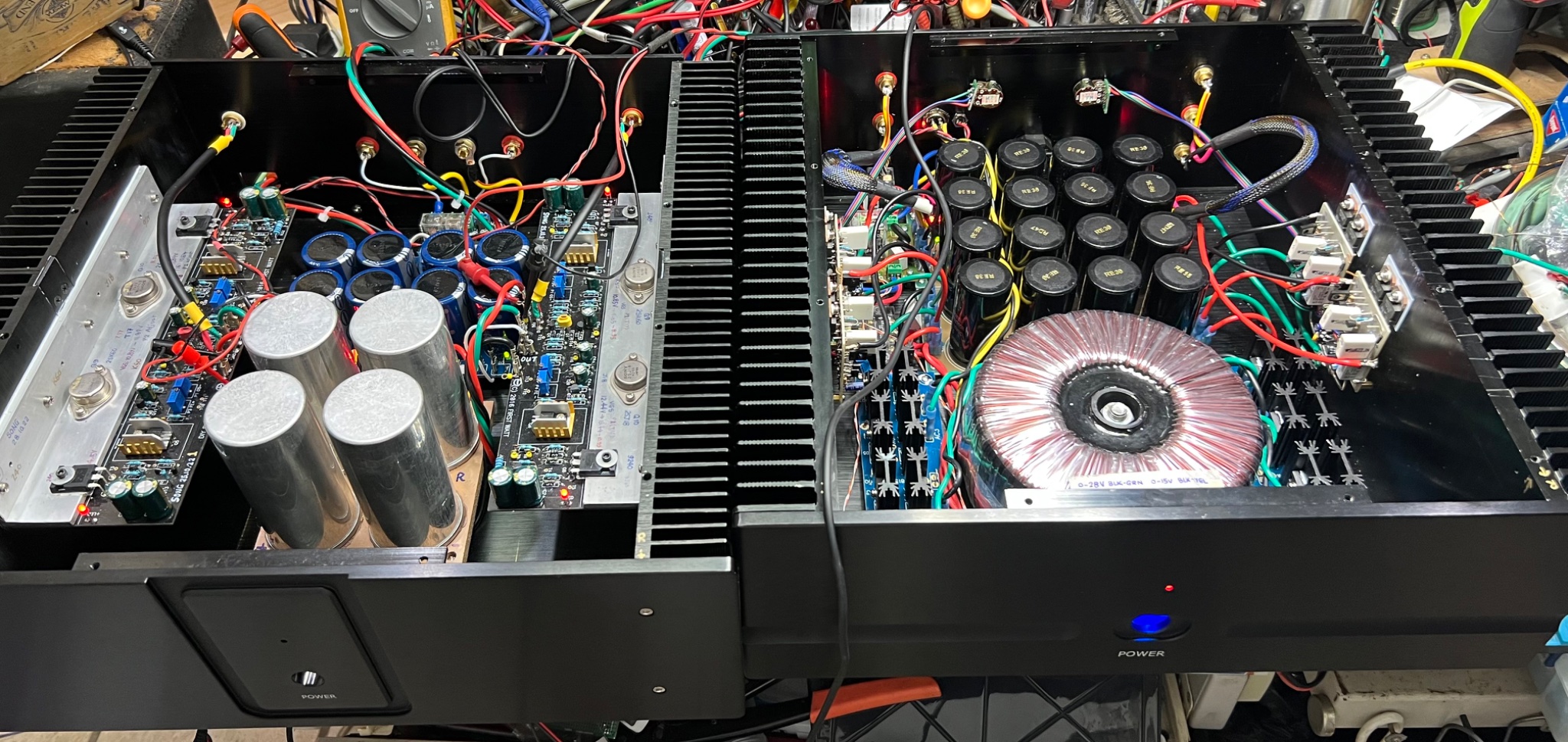

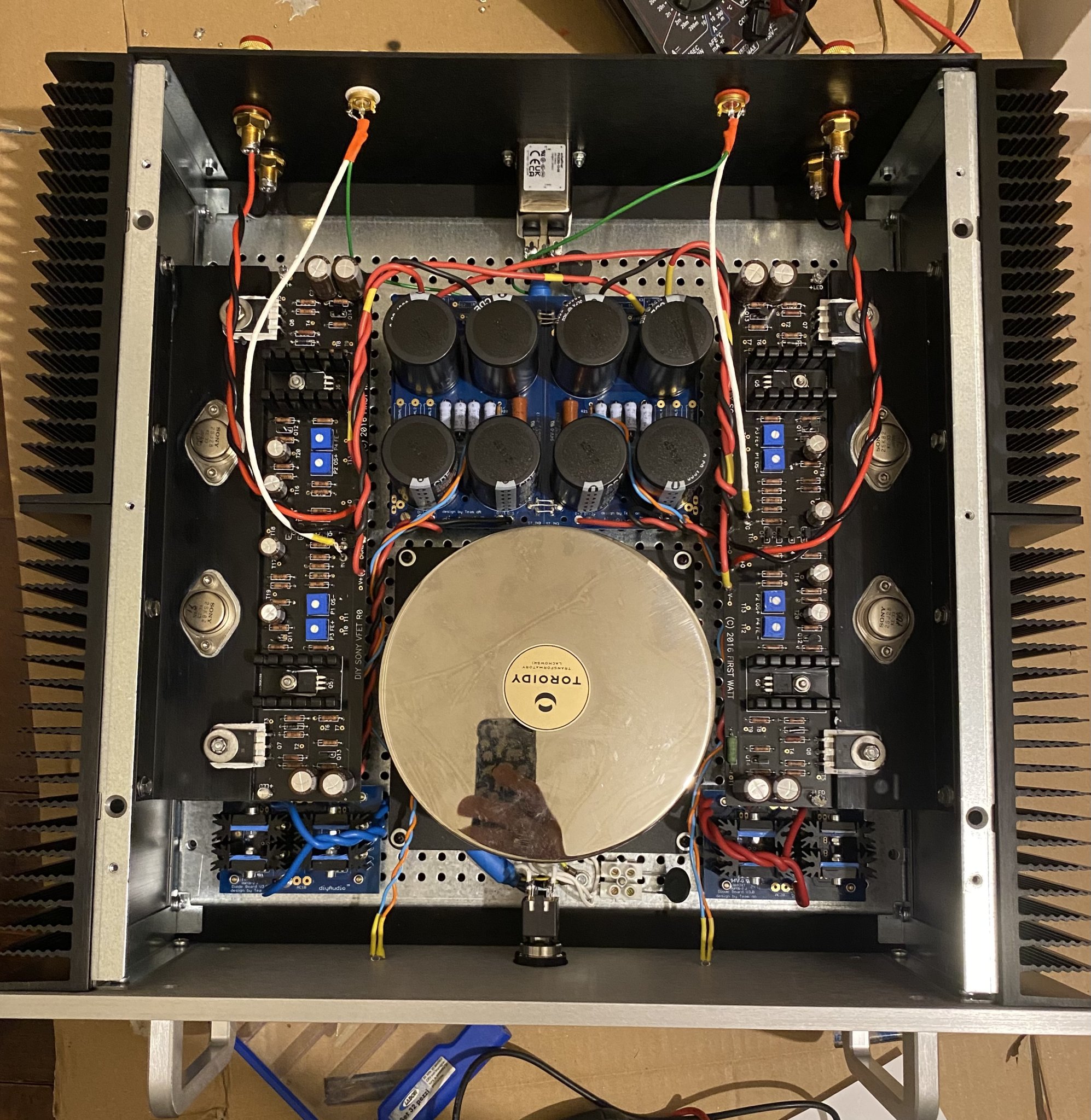

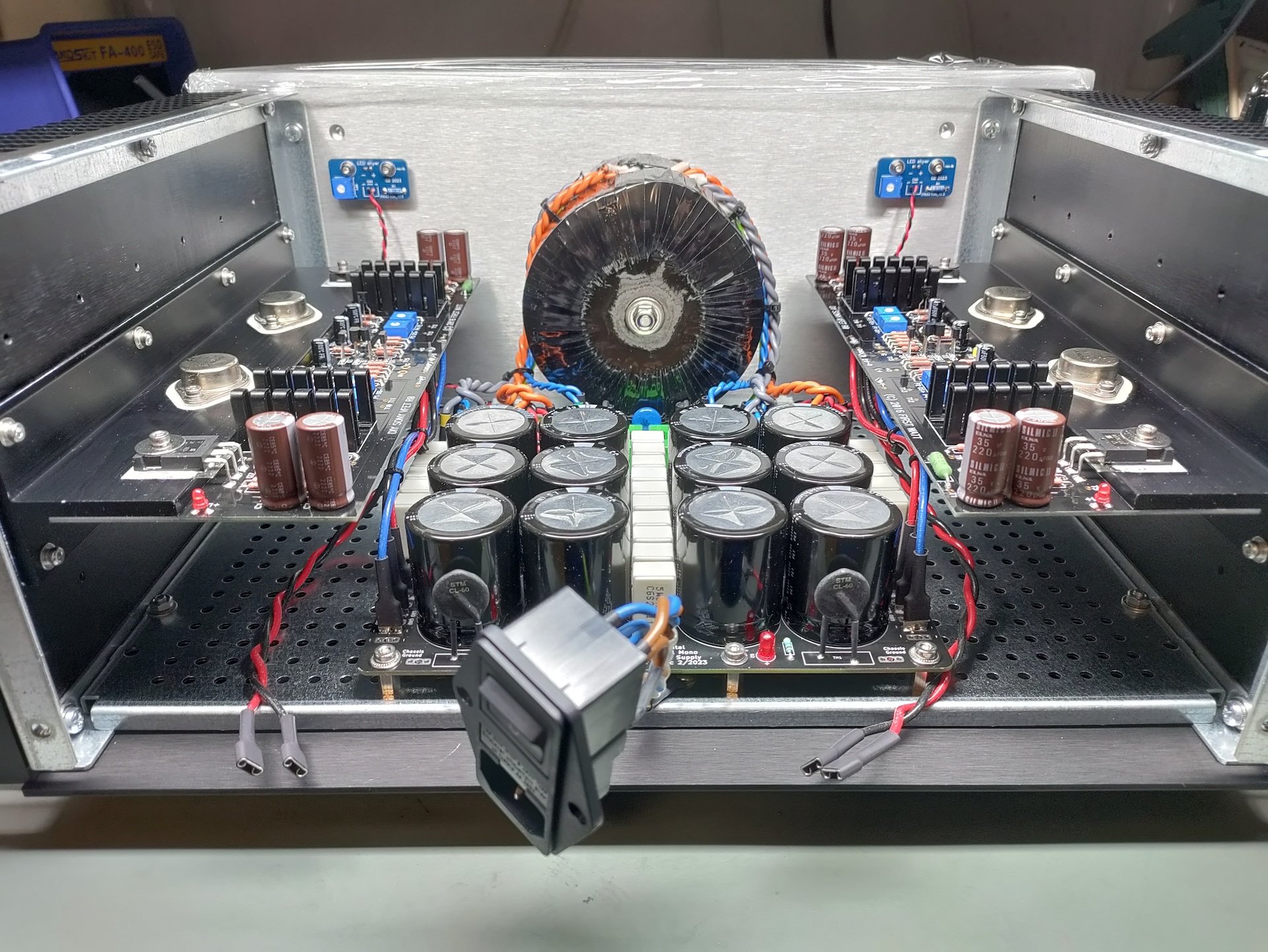

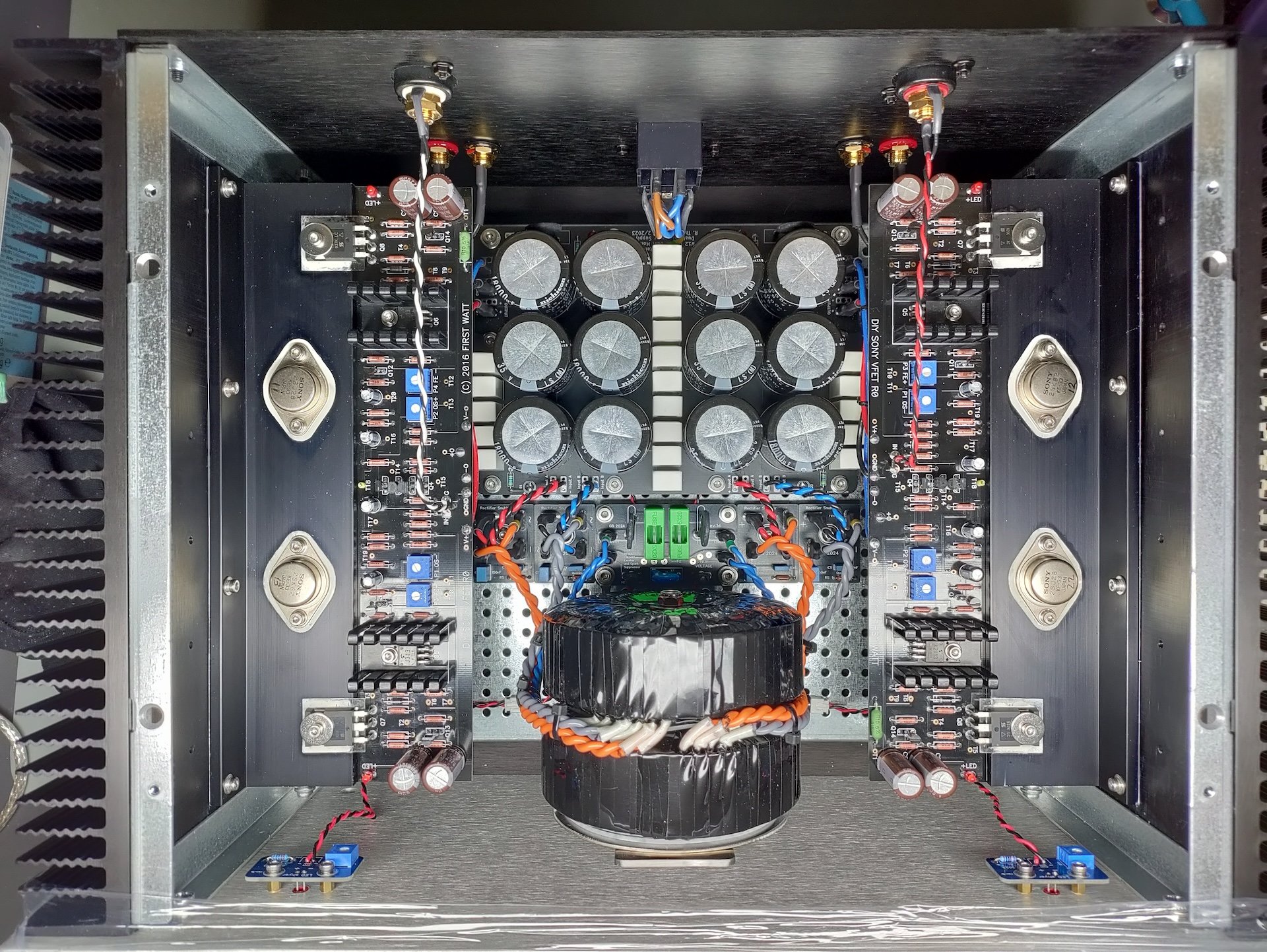

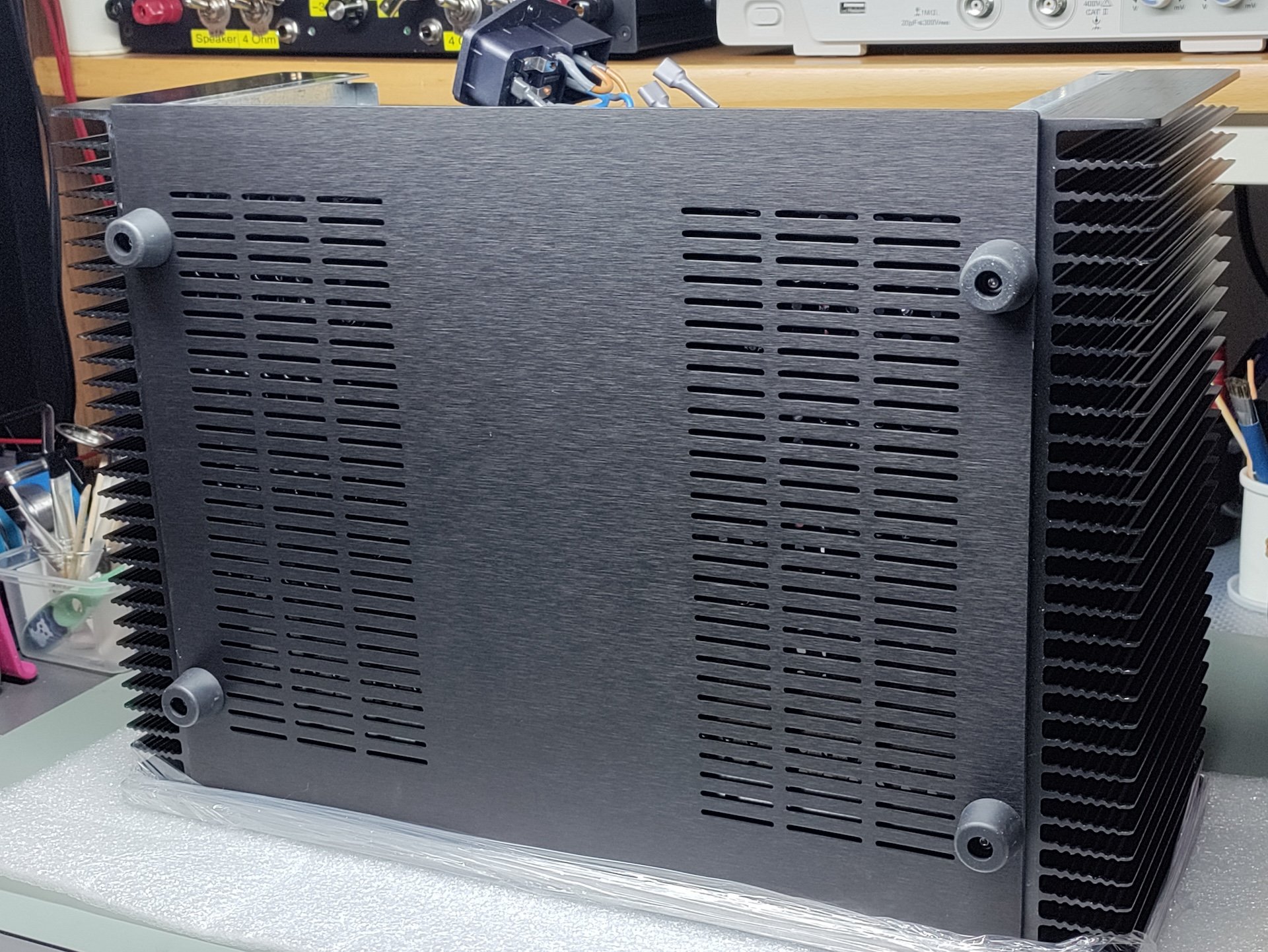

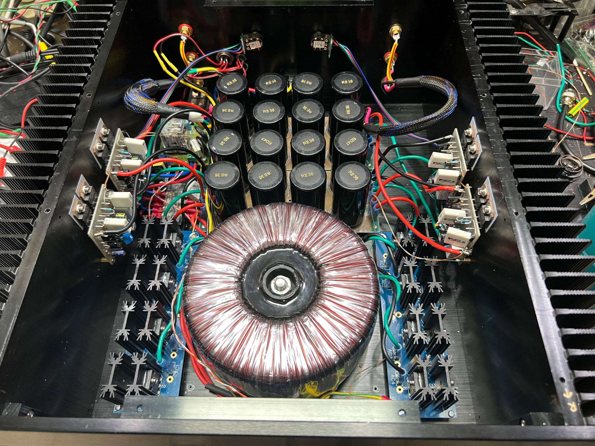

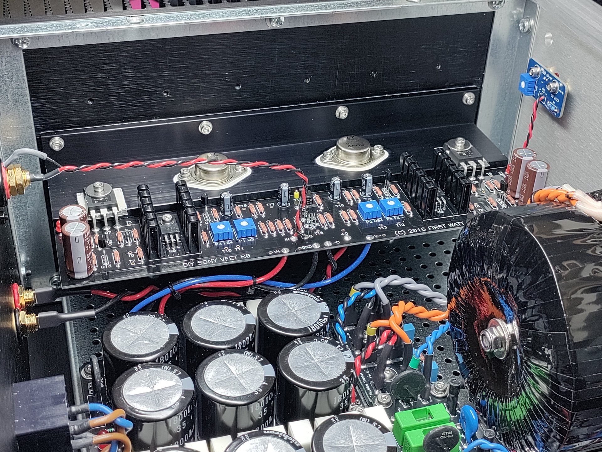

I have know completed my build. I’m still bench running it. Construction was without any issue. The goop was probably the most painful part. Testing and initial set up also went smoothly.
The amplifier has been running know for a couple of hours. Output dc offset is stable at under 10mV and so is the voltage drop between T1 and V- at around 100mV. Dc offset at T18 is around 50mV. I just get some drift on T6T7 and T8T9. They stay at 1.5v without the lid but after one hour of operation with the lid on they Were at 1.53v. Is this acceptable or should I turn them slightly down?
Congratulations on the nice build! I wouldn’t worry about such a small drift.
Is the green wire coming from the RCA a second ground return? Just curious if it's addressing a specific issue.
Not a functional mod, but I’d consider adding some heat-shrink tubing around the mains power inlet tabs/wires - just as a safety precaution. You never know when poking around inside the amp. ⚡

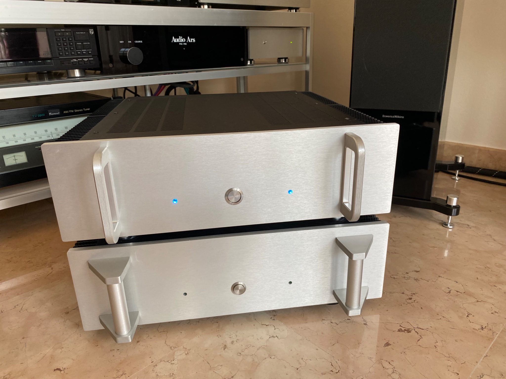

A picture of the front panel would be appreciated - I am thinking to add handles to my next project as well. 👍
Thanks!
You are right about the shielding of the 220v terminals but know I would have to desolder everything and at this point I’m just to lazy😅
The green cables are the ground connection of the shielding of the signal cables. I already had them and used them. Probably pointless but didn’t want to leave the shielding unconnected.

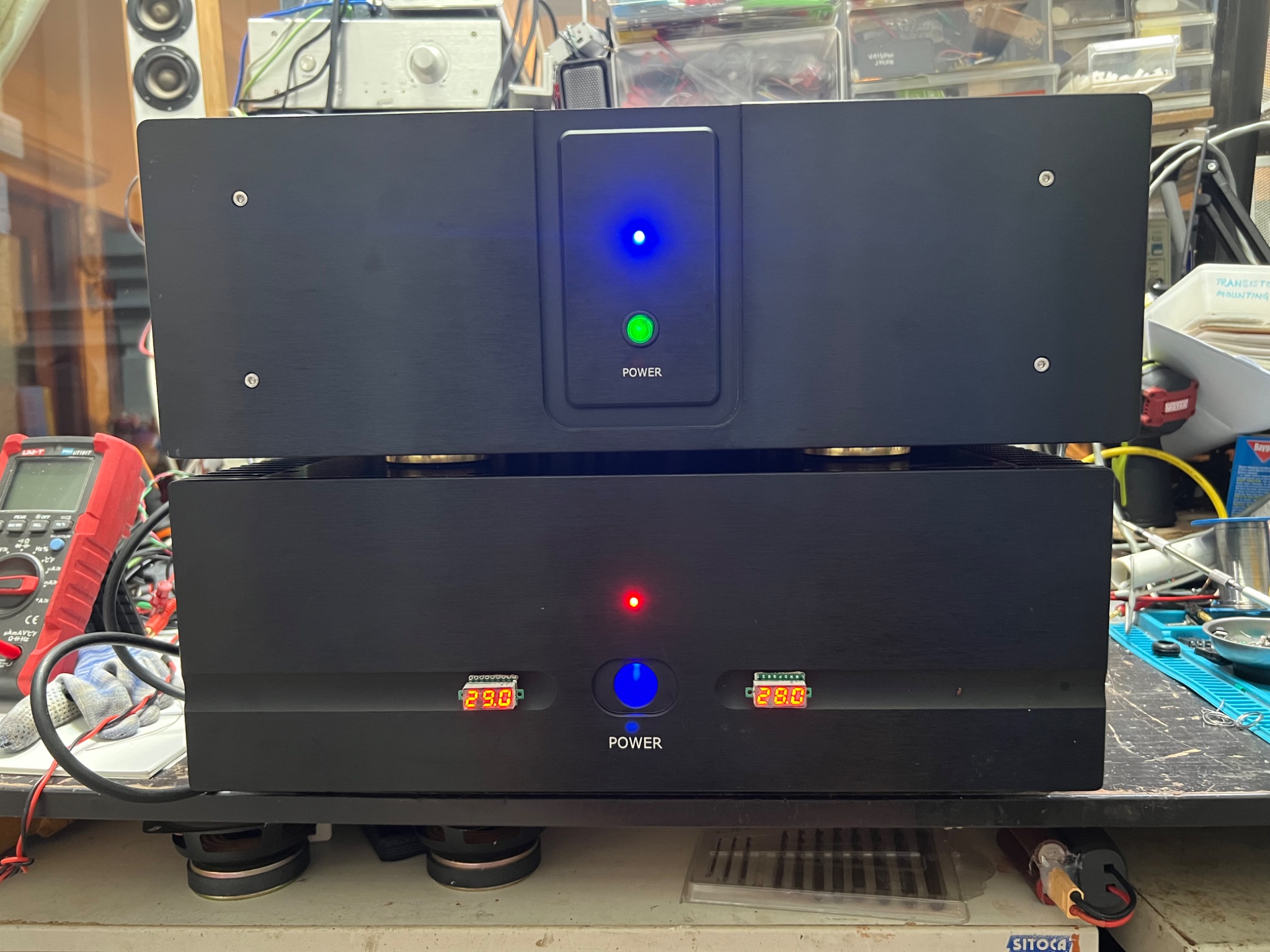

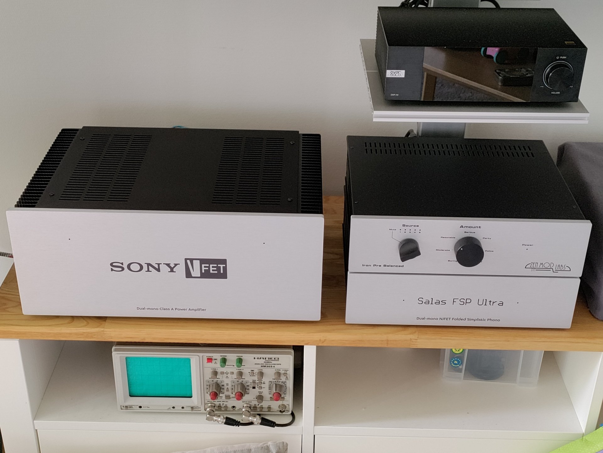

Attached a frontal view (above the vfet, below a dual mono F4)

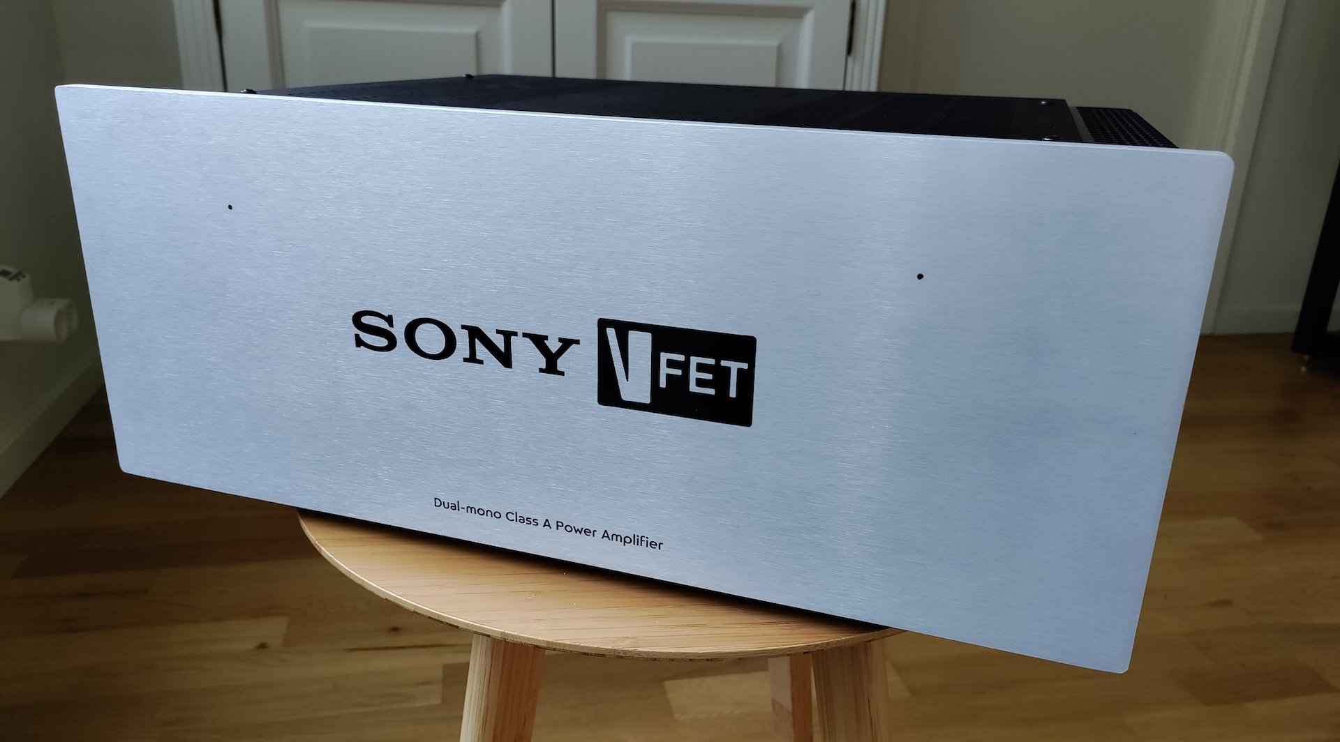

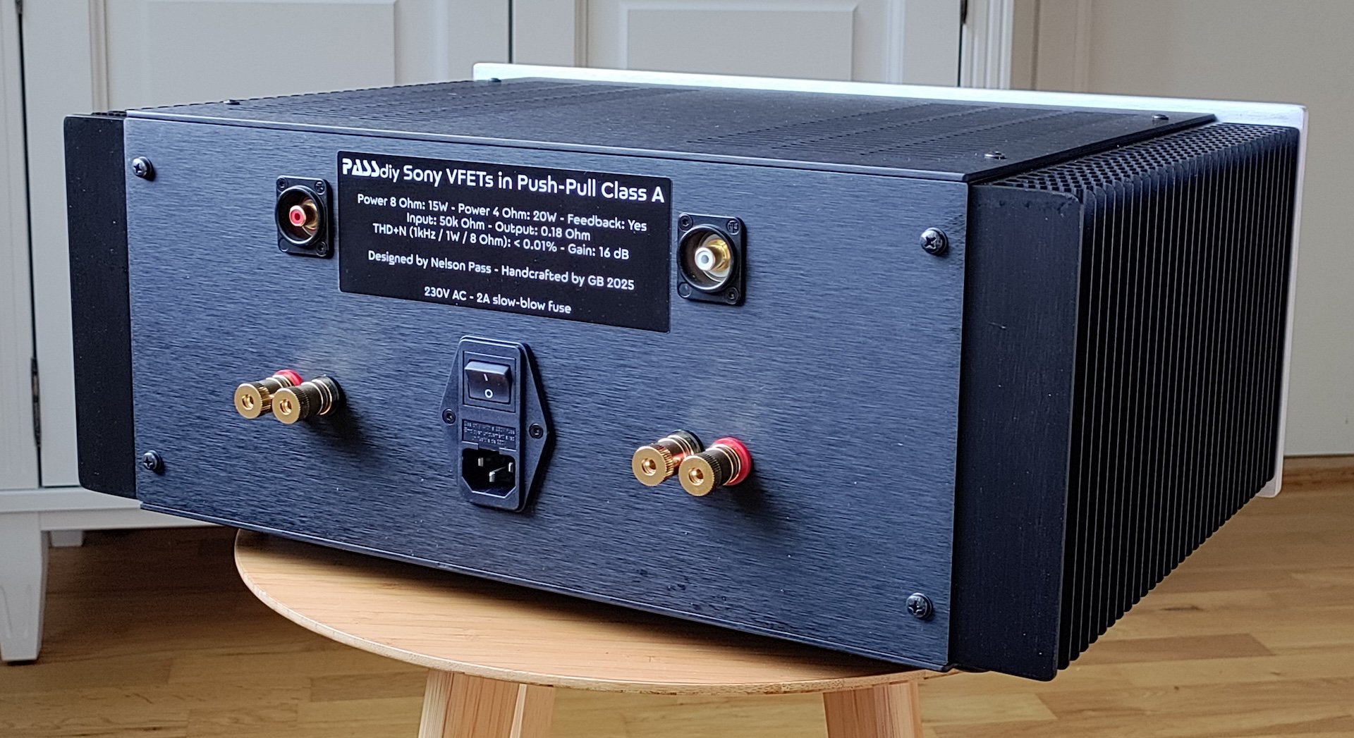

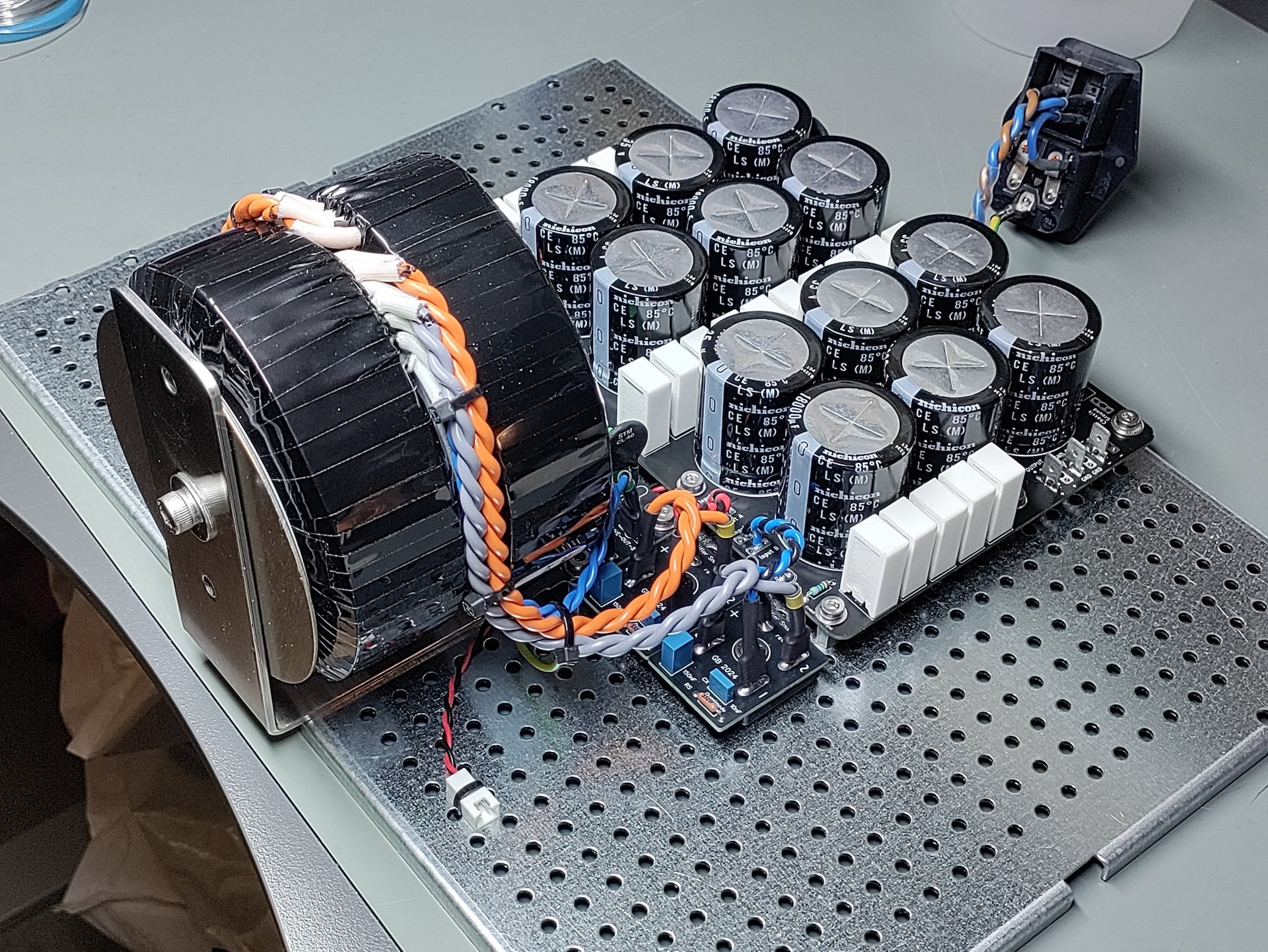

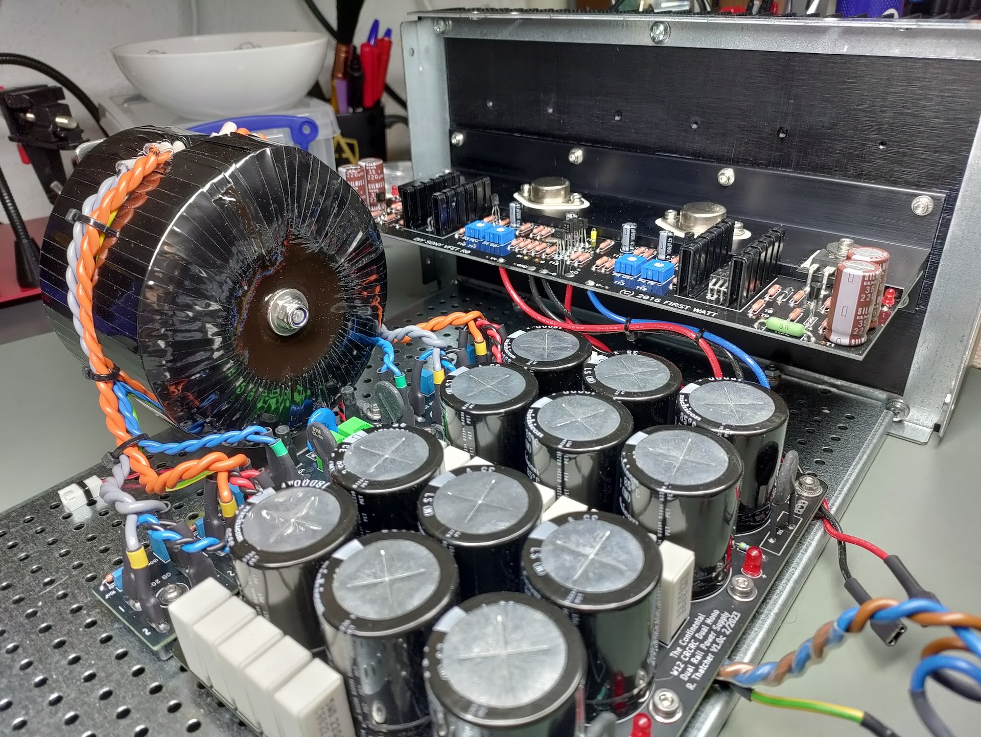

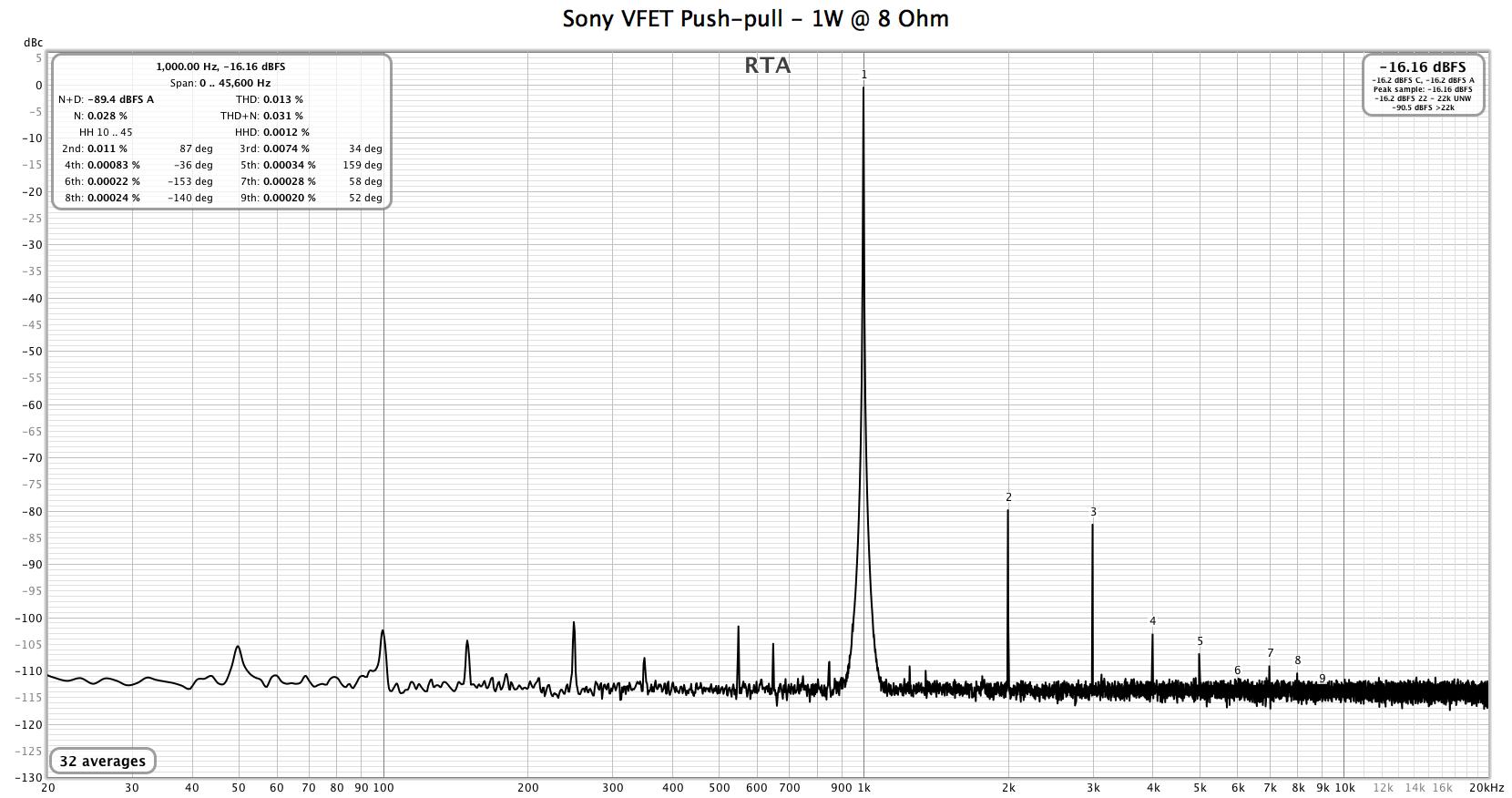

My Sony VFET Push-pull is finally singing. I am late to the game, but just in time for this year’s birthday. 🎁
It’s been a fun journey chasing all the unobtanium components across three continents, and following Nelson’s documentation along with Jim’s excellent circuit explanations.
Many people helped through private conversations — thank you all! A special mention goes to Charles, sadly no longer with us, whom I had the pleasure of getting to know thanks to this very special project. 🙏
