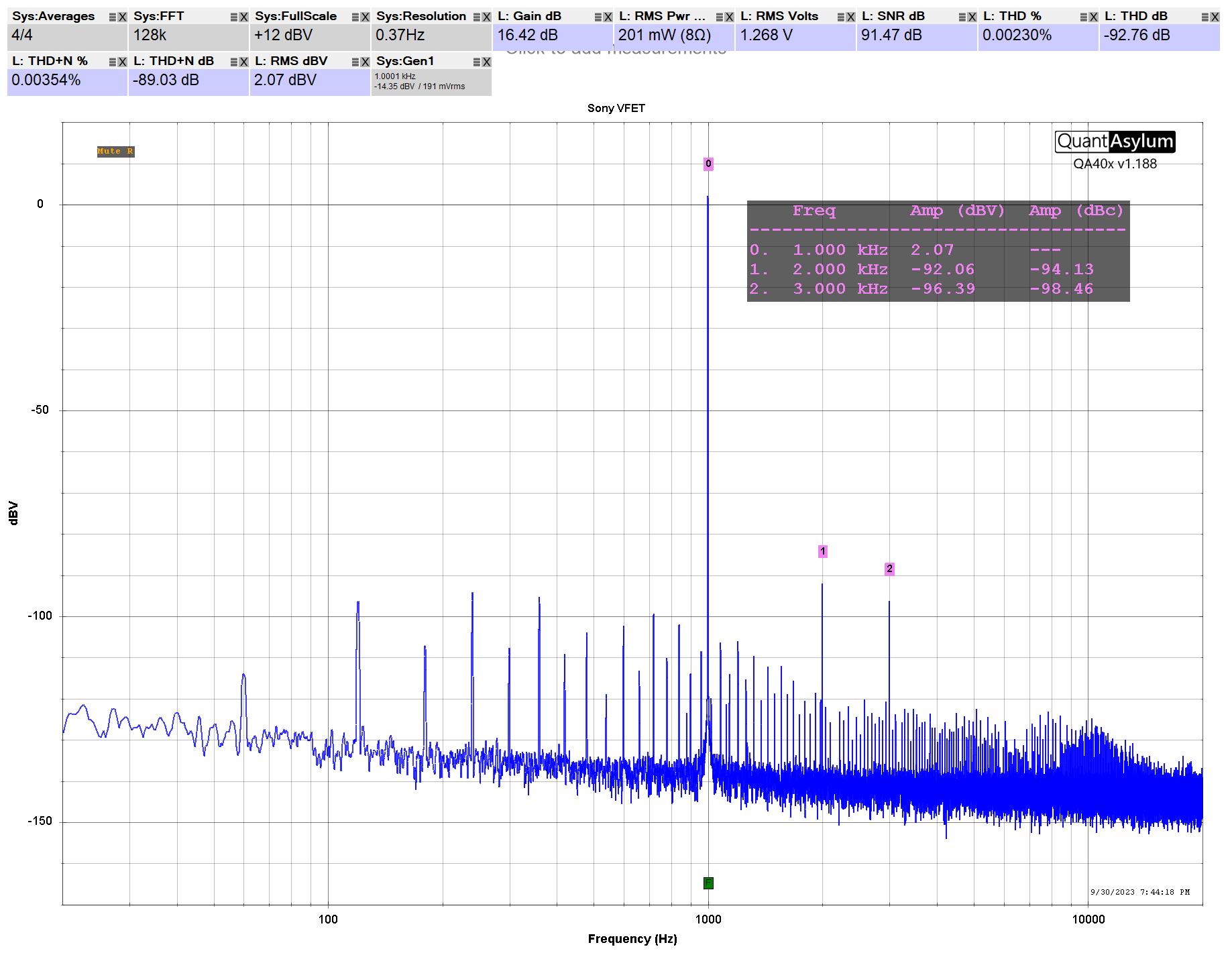

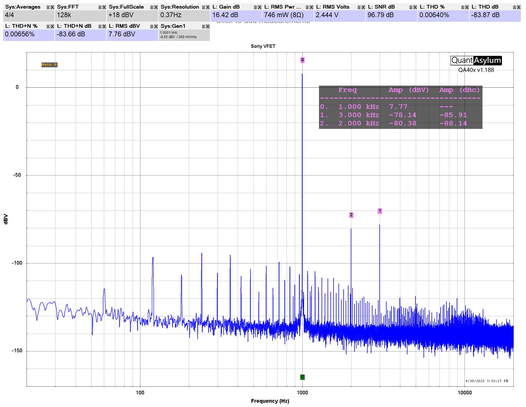

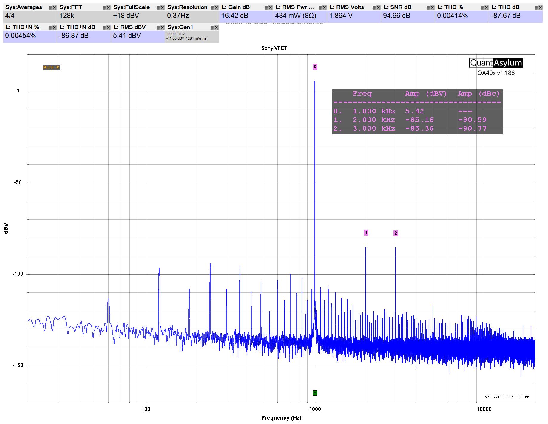

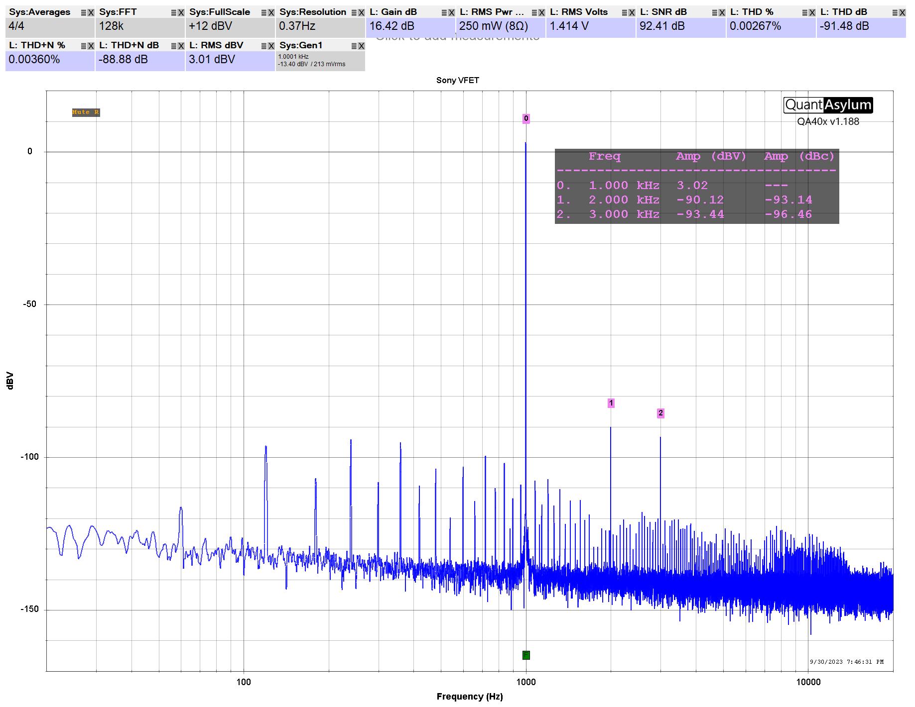

I had a little 'play time' available. So, I ran a few measurements. Your observations match mine. Note, I did not do any replicates, and admittedly this was rushed. So...
I found the level roughly where the distortion emerged from the 'noise floor'... I considered the noise floor above the highest peak in the audio band from the PSU. Now... whether that distortion is audible or not.. I dunno. I don't want to even be a part of a subjectivist objectivist discussion. I just love fooling with this and learning a little along the way. Plus a few of you indulge my long posts with a like every now and again... so, if someone else out there is in a similar boat and wonders about the same things... great.
Note - all of these were done with the attenuation for the QA off. That lowers the noise floor of the analyzer nicely, but ... it makes things visually look a bit of a mess. That's why I love the markers to specifically note the relative dB along with the measurements calibrated to a known voltage.
It does make me want to re-look at the PSU for this amp... nah! If it ain't broke.
Anyway... just as the distortion emerged from the noise floor at 200mW. I could have backed the power down a bit more, but it illustrates the point, I hope. Nice 2nd.
Round number of 250mW
Took a few minutes to try and find the power level where the 2nd and 3rd were close to equal... close enough for me anyway...
434mW
The previous measurement was close enough to 500mW, so I bumped to 750mW
Thanks for the suggestion. I admit that I play my amp a little louder... and have a reasonably sized room, but you're dead on that I do listen at <1W a lot, particularly in the mornings. I've always wondered a little bit why I like some amps better at lower volumes... this may give me more insight. 🤷♂️

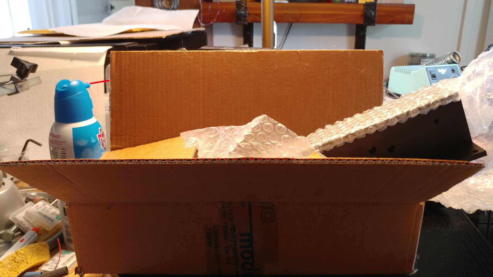

Very late to the game but... Is there anyone that can help me get the black T-brackets from the original kit? Please PM me.
(I know I can build them myself, but I really would love to find all original pieces of the puzzle for this specific project)

I can tell you this. I was the last to get the kits. Ordered the limit of 2. Only one pr of brackets were available for the 2 pair. Meaning 'I'm short a pair'. 😵Very late to the game but... Is there anyone that can help me get the black T-brackets from the original kit? Please PM me.
I will be making my own. They are not available.
Unless you are not in a rush I can make my brackets off the originals and pass them on to you. I assume you are building just one amp? I would need some time.

I am not in a rush. I have 2.5 project to finish still, and in my best estimation this build will not start before the second part of the year. This project is rather special for me. When it was happening, I was away from this site for a number of reasons (changing country, starting a new job, moving house, and expecting the first child). If I can make it happen as in the original kit, it would be like I never missed a page here. And the fun is in trying, anyway.
However, I do not feel like taking from you what it seems you will need and use. I am convinced there are still people around that took two kits for the parallel VFET version. Indeed, I am still waiting an answer from a member that may still have a pair stored away. Others may show up eventually.
@von Ah good suggestion. But if I don't find the originals, I think I will make my own with the exact number of holes and in the right locations.

I was only able to buy the one pair brackets in the day. I bought two amp kits for bridged Dual Mono.
Knowing I'd have to make 2 long brackets to put 2 amps in one case.
I have to get these amps done just to make sure the parts still are sound.
These NOS brackets I basically bought for the measurements.
I always wanted to say "I was short a pair". And this has been accomplished.
For the record you know at least one pair is out there if you can't find any. All I need is to get them up to the MIll and transfer the dimensions. My body is the problem. The timeline for you to decide if you need them is not an issue.
von Ah has a good solution. My only concern would be how flat they are. Even ModuShop has difficulty.
Best, H.

Yeah these are out of stock. As with everything, if more people are interested into these, another group buy could be set up so more can be produced 🙂
Gianluca estimated a critical mass of 10 pairs to make a new batch.
I do have one bracket in my hands, but I can't tell where the second one went. It might still hide somewhere in my stuff.
However, it shouldn't be too difficult to make those braces. Find a suitable profile, and find a metal shop that drills a few holes.
These are not drilled holes. They are reamed to dimension. T Stock most likely is region dependant if original is required.
As always you want original there is only one with the tooling that was used in period to create.
Then the process of matching the color and texture of the anodizing.
