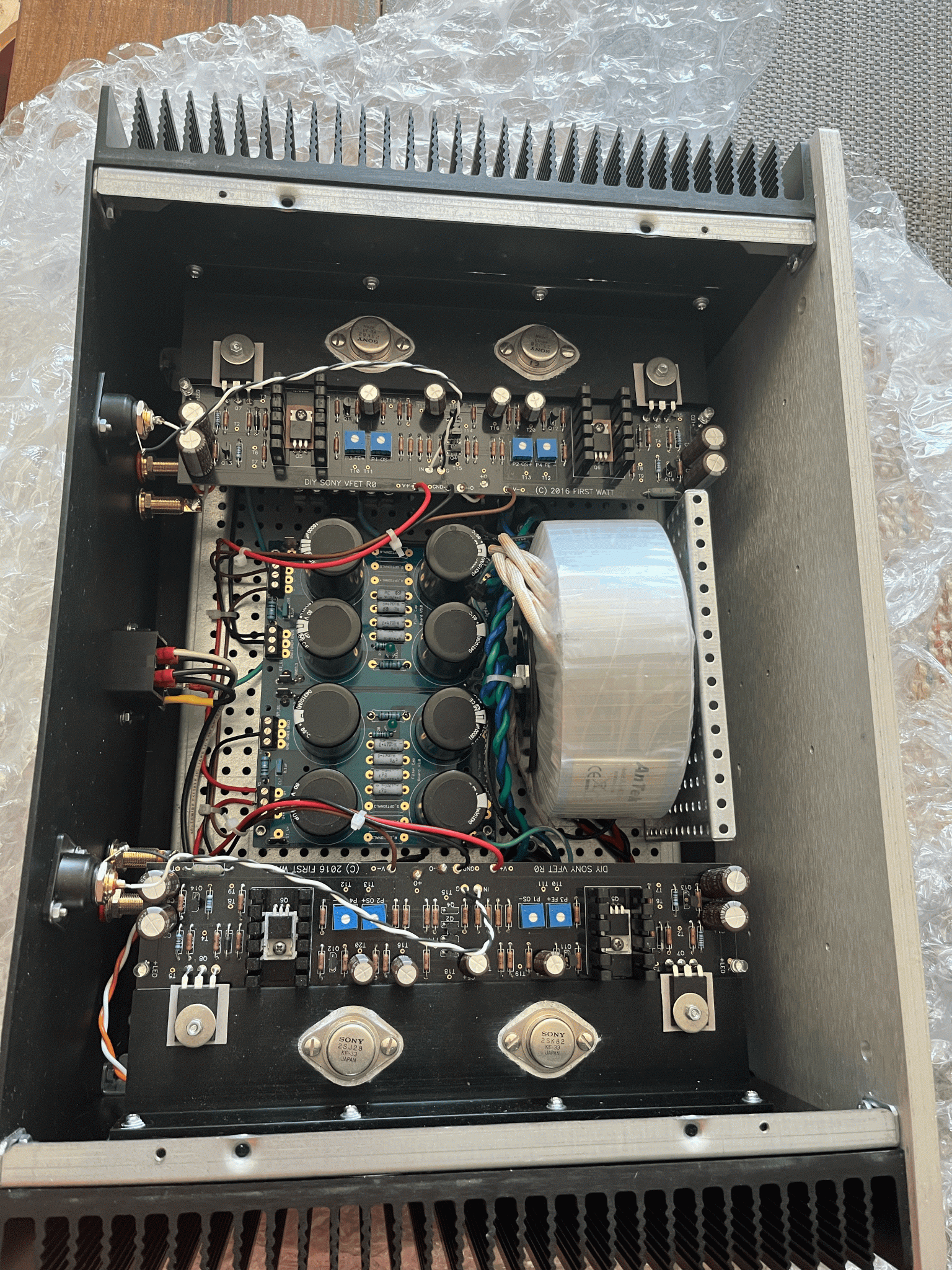

A couple of weeks ago I saw an amp listed on the goodwill auction site as "unbranded amp". I recognized the chassis as I've built projects from this store before and realized it most likely contained a Pass clone. I won the auction and had it shipped. In the meantime life goes on and I went into the hospital for a major surgery. I got out of the hospital today and finally got a chance to open the box and chassis. I was really surprised to find a Pass Sony VFET amp inside as you can imagine. I've been wanting to build a pass clone for a long time and have browsed the pages over and over many evenings.
This brings me to my main question. What do I need to do to determine if this amp is whole and functioning? I wanted to ask here first as this is the community with specific knowledge of the amp. I'm not a total newbie having built tube amps in the past, but with the scarcity of the vfets, don't want to take a chance with this amp. Thank you in advance for any knowledge you may impart.

Wow, a very lucky find, and a great amp. I have one and love it. If your luck holds out it will be in working condition. There is a startup tutorial available here which gives instructions and allowable voltages at the various test points on the amp boards. As a start you might want to consider powering it up and checking that the test points jive before risking speakers. I'm sure the kind and knowledgeable gurus here will help if you run into problems.

amp - it seems it is complete and in nice shape
so, leap of faith, connect some preamp to it and power it up
hopefully you have DMM, fist check that there is no DC on outputs, and - if good - connect speakers

As ZM wrote, the amp looks to be in good condition and I think a lot of care went into its construction. There weren't that many of these kits back in the day and I wonder about the builder/previous owner. Perhaps we've even seen this amp somewhere in this thread.
Leap of faith of power up to check for DC offset and then verify the bias by measuring the voltage across R32 (0.1 ohm resistor). You should see about 0.1V there. Obviously no speakers attached during these initial tests.
Let things stabilize a bit. Unless the DC offset is quite high (say over 100mV) or the R32 voltage is way off then I would not attempt adjustments, as some of them can be tricky, especially with the vfets in place.

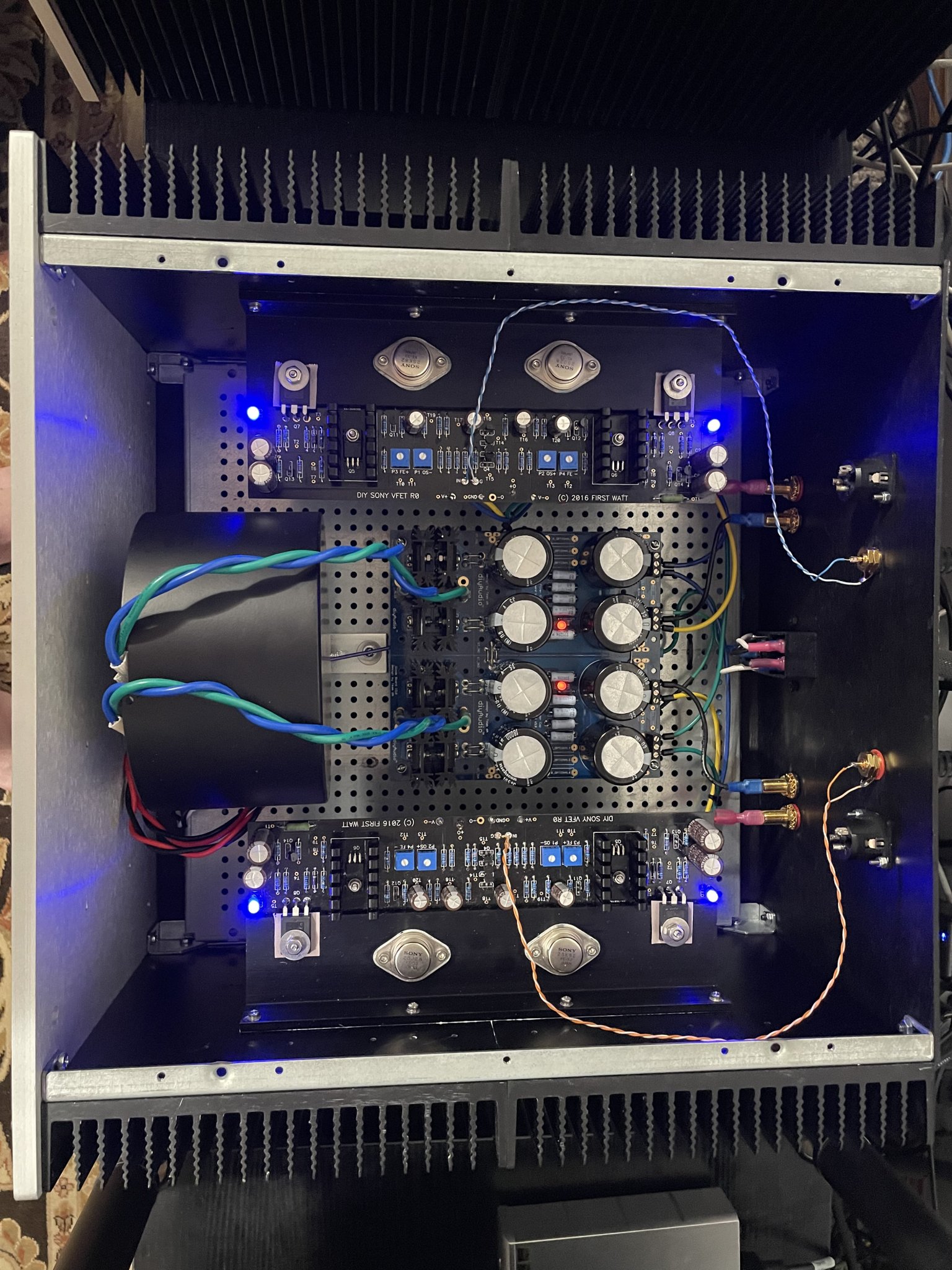

It must be said that the people in this community never cease to amaze me with their generosity both in sharing their knowledge and in this particular situation... a Sony VFET kit. I got a surprise PM offering me the kit, and I graciously accepted. It immediately leapt to the top of my mountain of projects. Home maintenance, golf, cycling and and all other activities took a back seat. As a result, I think a few of my long-neglected PCBs are mounting an insurrection due to negligence, I'll never shoot 70, ride in the Tour, or win lawn of the year, but... it was worth it.
The build took me a bit longer than expected, but it mostly went off without a hitch. There was an 'incident' involving a broken standoff in the heatsink from the donor chassis. I invented a few new curse words, but that was the extent of unexpected issues; unless you count spending 2 hours looking for a non-existent short during initial testing. I was charging my PSU caps with my DMM. I figured it out, but ... DOH!
I was meticulous in following Papa's directions, and I had read this thread and the previous thread several times taking notes along the way. @Rodeodave your early post re: using 5 meters per channel and watching for interactions was perhaps the most valuable bit of information for me. I was trying to do it with 3 meters at first, and I was going batty. Once I had them all connected at once and could see in real time how much the input bias affected both the FE offset and the output offset etc. etc. and how volatile it 'seemed' ... but it really wasn't ... it all went smoothly and steadily. Had I started by following that sage advice, I likely would have saved about 8 hours.
I ended up (once at stable temps and in the chassis) with <5mV of offset at the output and <20mV of offset for the FE with about 103mV across R32 for both channels. I dialed them both a bit finer on the bench... but as others have stated, it drifts a bit. I decided that I cannot obsess over it. I monitored it over 12 hours from initial turn on to reaching equilibrium and beyond with one tiny tweak, and I'm pleased. I'll continue to check it once a day until I tell myself to just leave it in peace.
Onto the good stuff...
Once I hooked it to 'real' speakers, I Let There Be Rock. The air guitar commenced along with some drums and horrible singing. Then, Chris Cornell's rendition of Nothing Compares 2 U live in studio left me verklempt. To see how it flexed on some delicate music with extension, Bela's famous Cosmic Hippo tiptoed and stomped its way around the room. SRV had me tapping my toes, playing more air guitar, and mashing the keys on my imaginary piano as I took a Look at Little Sister. I took a deep breath for the last, and the most dangerous test. How would Alisson Krauss be portrayed? Would she have that almost indescribable presence of an angel, or would she be cast as a screaming banshee hell-bent on tearing my ears off? I went Down to The River to Pray with the angel.
It would be an understatement to say that I'm thrilled with how this amp sounds in my system. To steal a Zen Mod saying... it definitely has a spooky factor, but it can absolutely rock too.

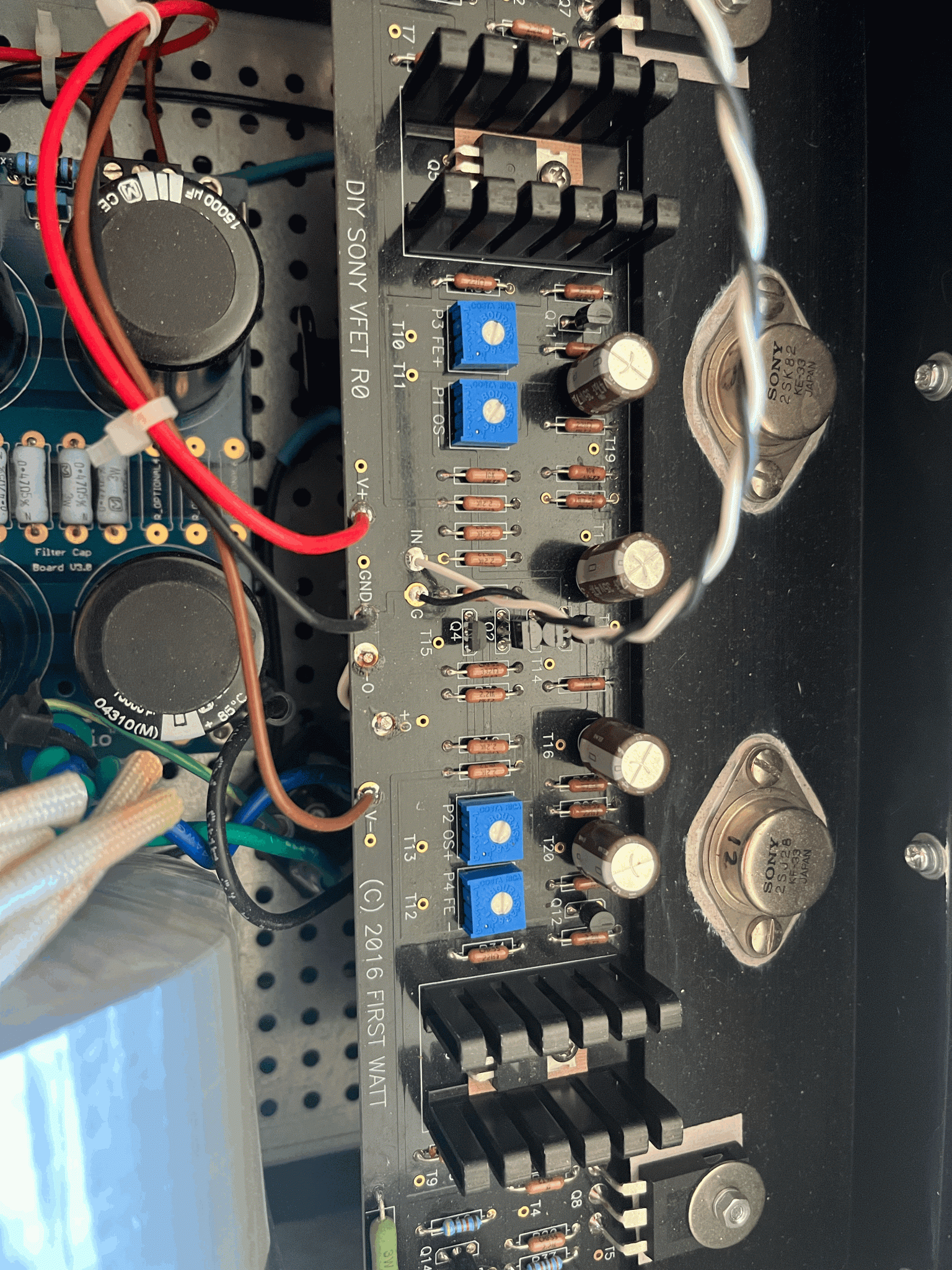

Pic attached. I haven't swapped out the temporary input wiring yet. I meant to do that before I heated it back up for the last time on the bench, but I forgot... and I couldn't wait to see what it sounded like.
