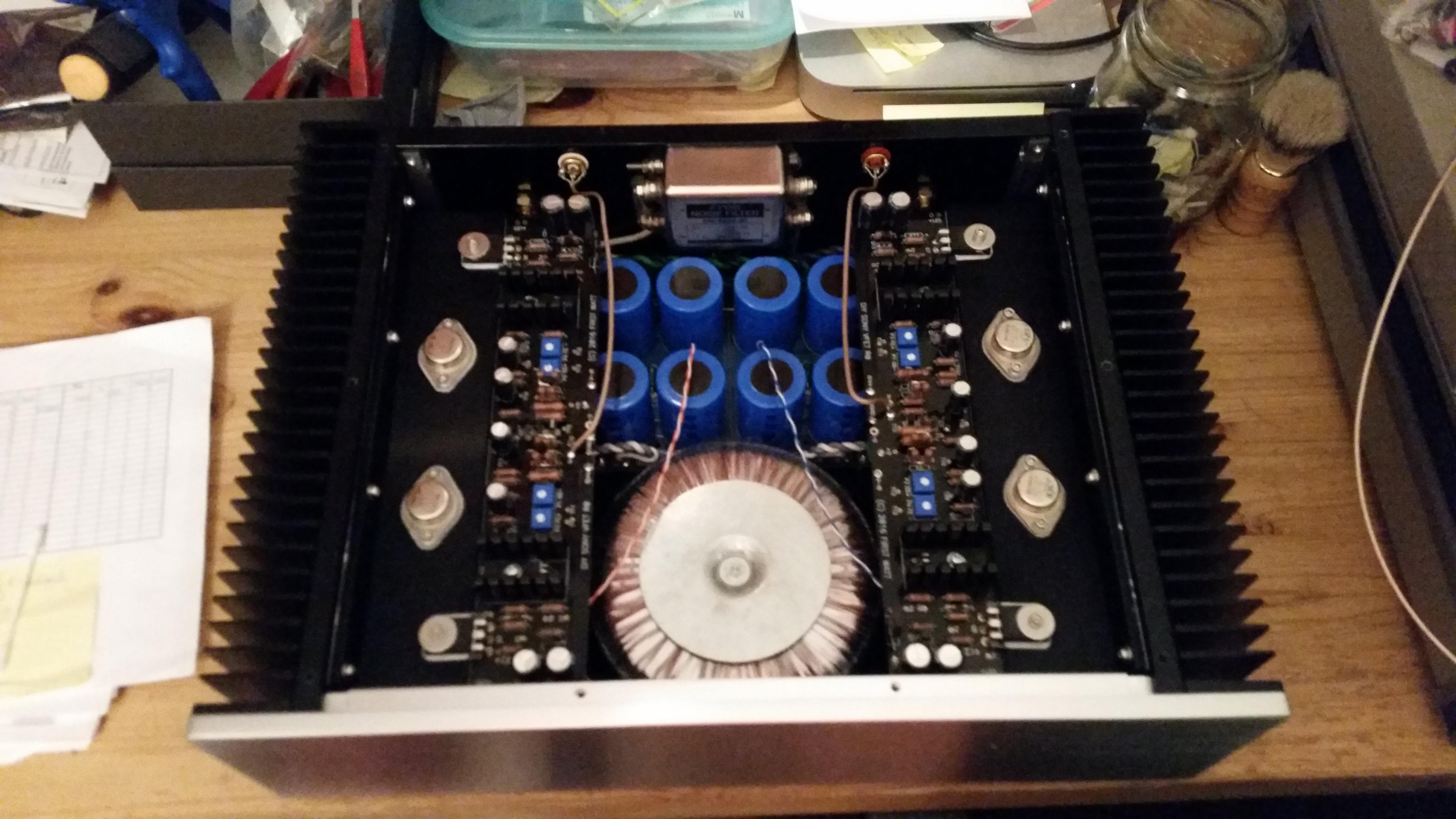

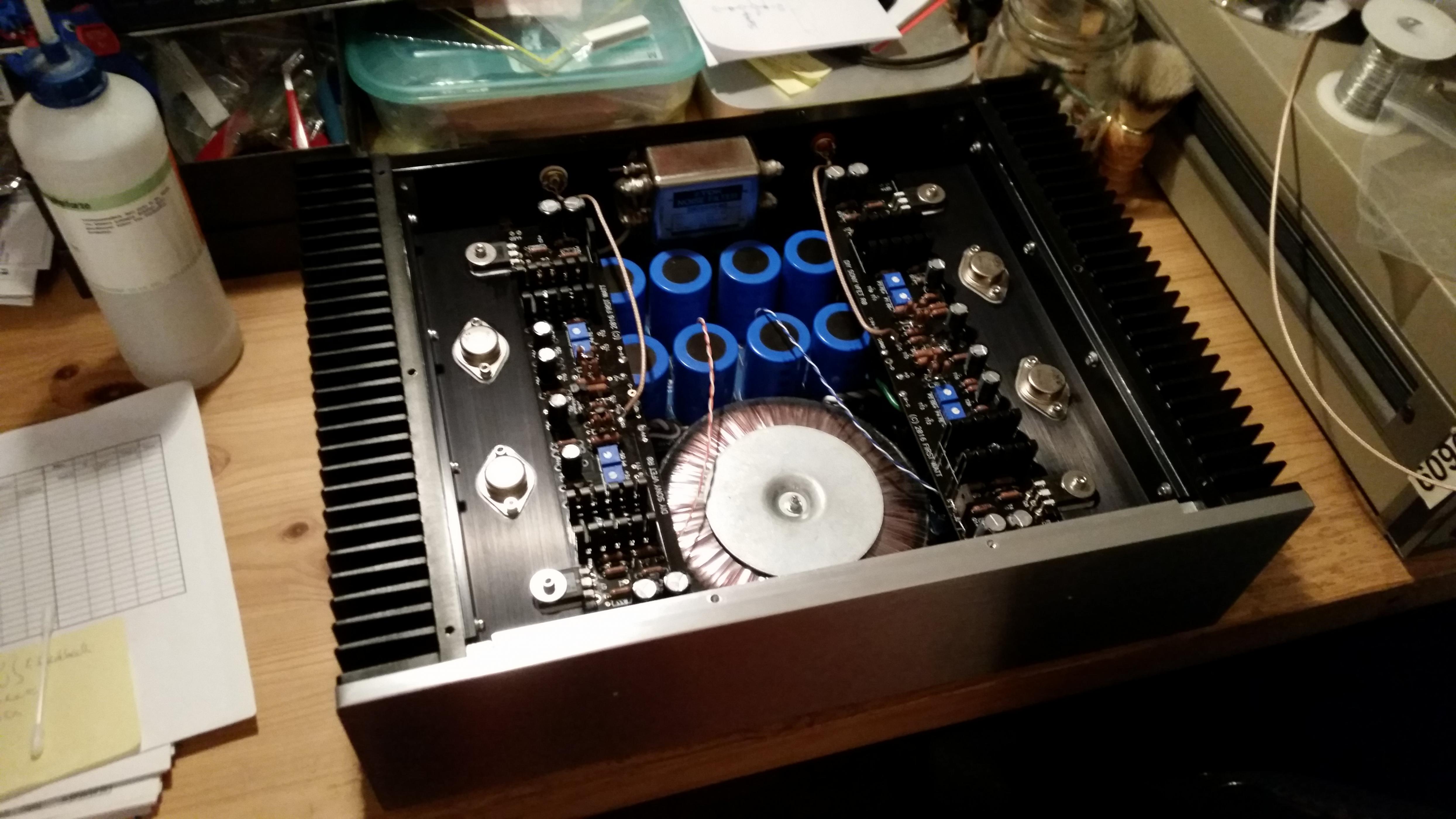

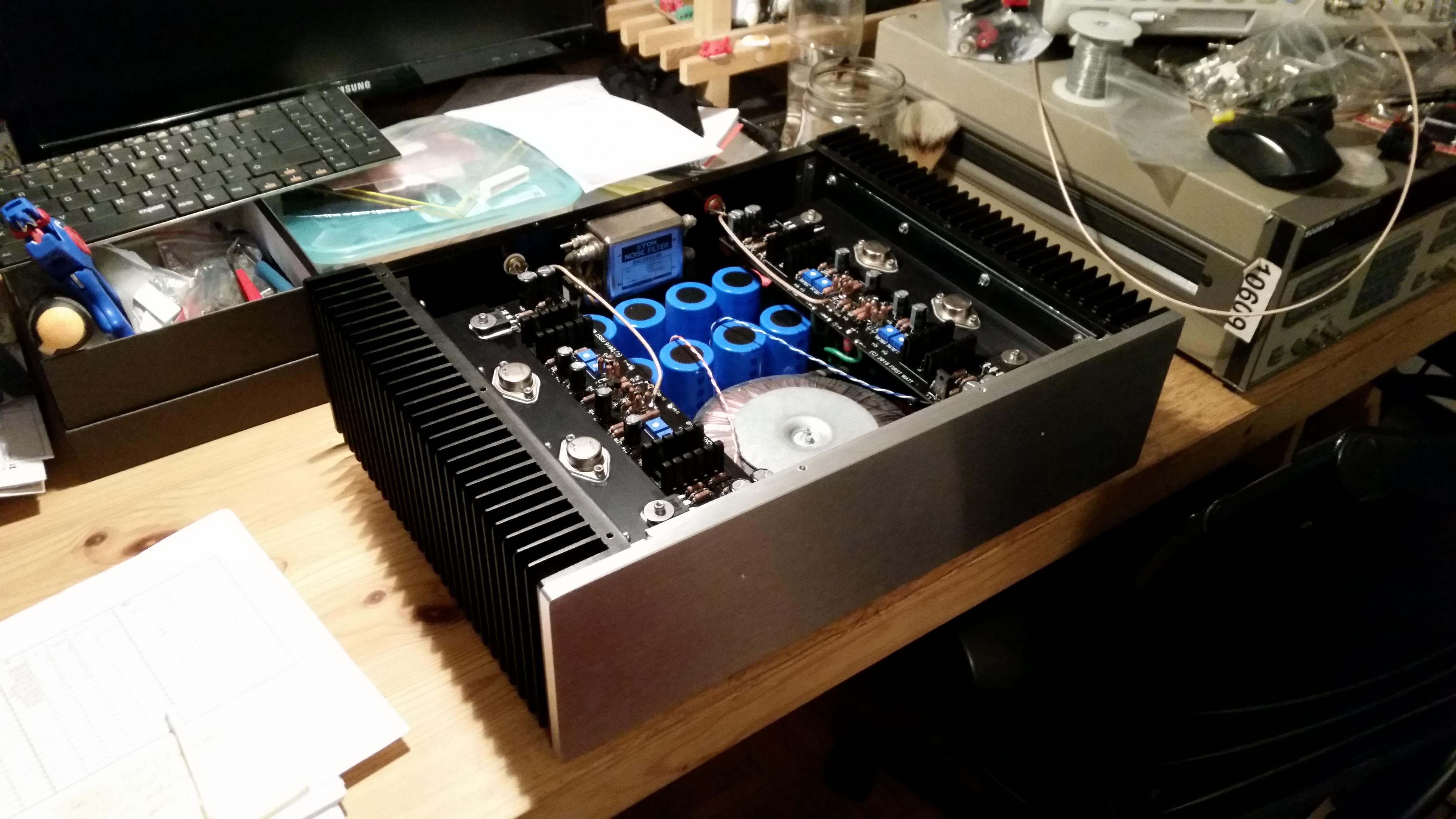

It's done. She's a beauty. But it's too late o'clock, so I'll have to wait until tomorrow to fire her up. A great man once said "Check everything twice, once in the evening and once in the morning.", and that's what I'll do. I don't wanna to let out that magic VFET smoke due to some silly wiring mistake tired me couldn't spot 🙂
Which chassis did you use?
