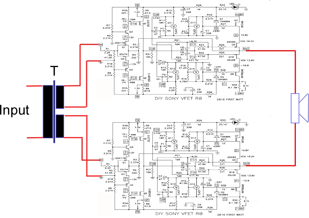

You can take two channels with a common ground and drive each of
them with signal out of phase with the other. Generally the performance will
be twice the power of the 4 ohm rating of a single channel.
many thanks, nelson.
is the attached diagram correct?
any other (internal) option in order to avoid the external phase splitter (input transfomer)?
best regards

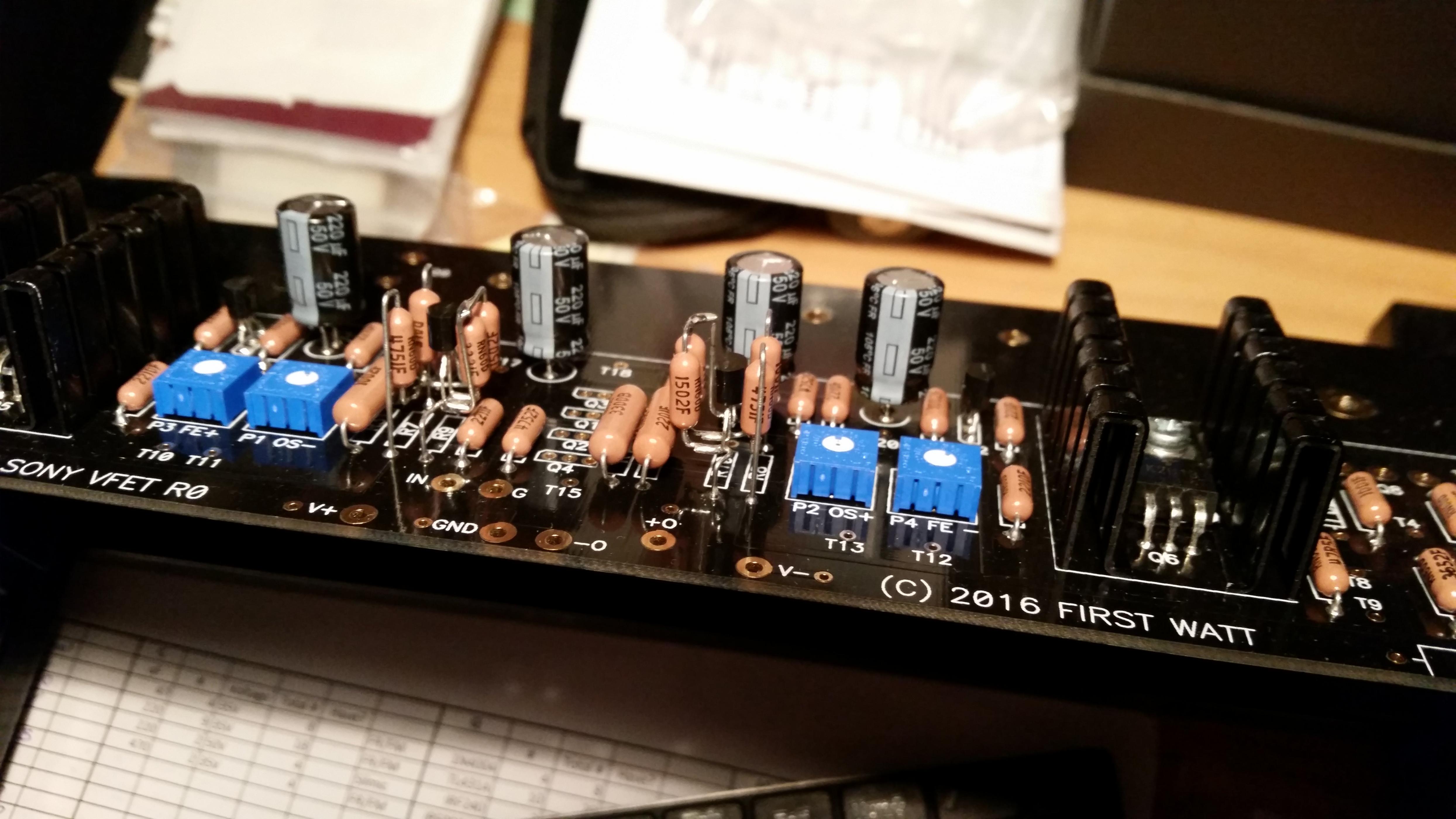

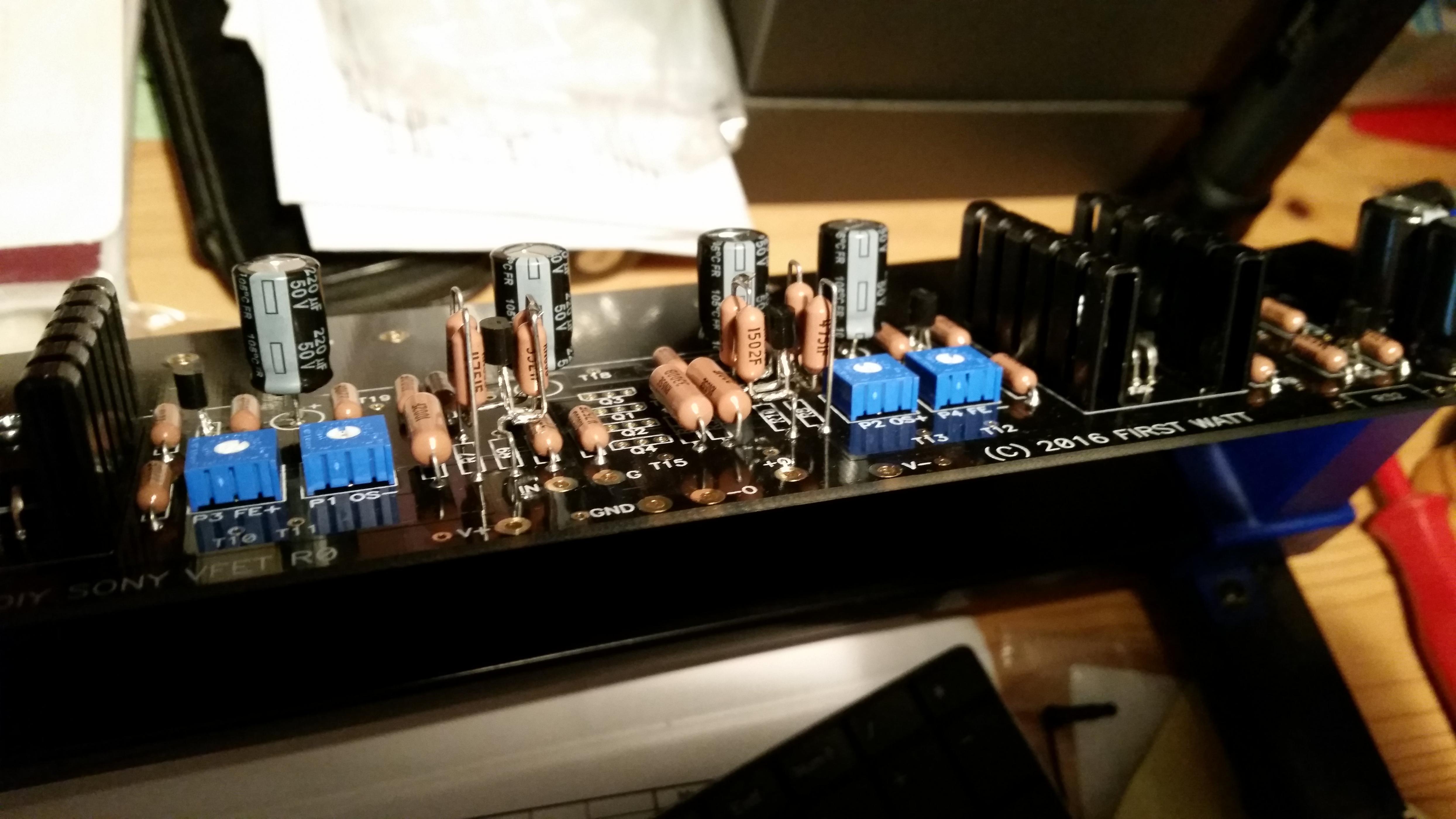

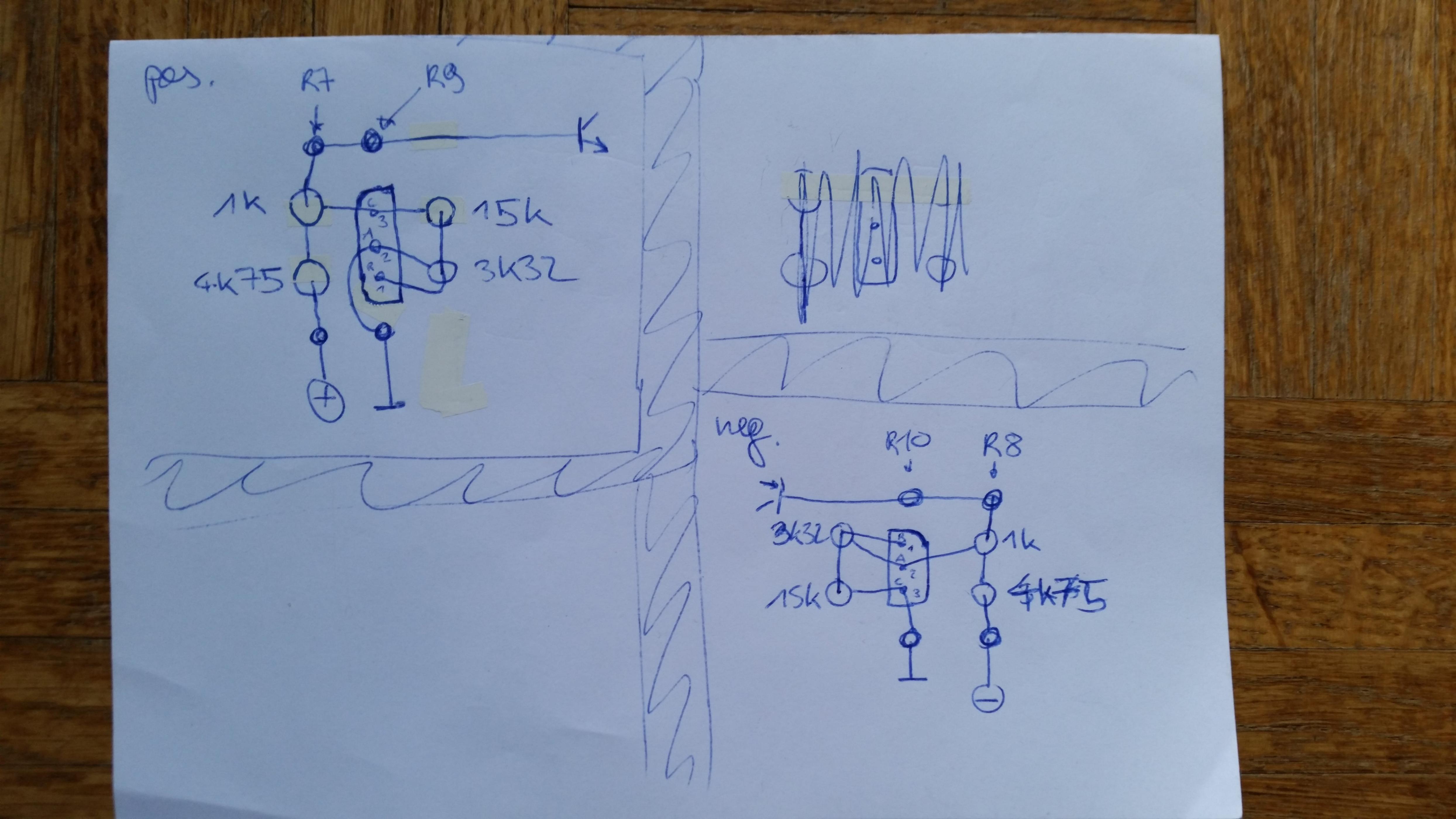

Alright, here's a sneak preview of my ongoing build. I really felt like having the shunt regulator circuit for the cascode transistors from the Sony VFET Part 2 article, so I built a nice p2p subcircuit that plugs right into the pcb. I also happen to like big fat resistors, so I'm using RN60D types throughout. For the feedback path and frontend loading like even bigger and fatter resistors, so I'm using RN65E types. I should get around to finishing and biasing the frontend tomorrow, we'll see how it goes.

Could you post details of this subcircuit?
