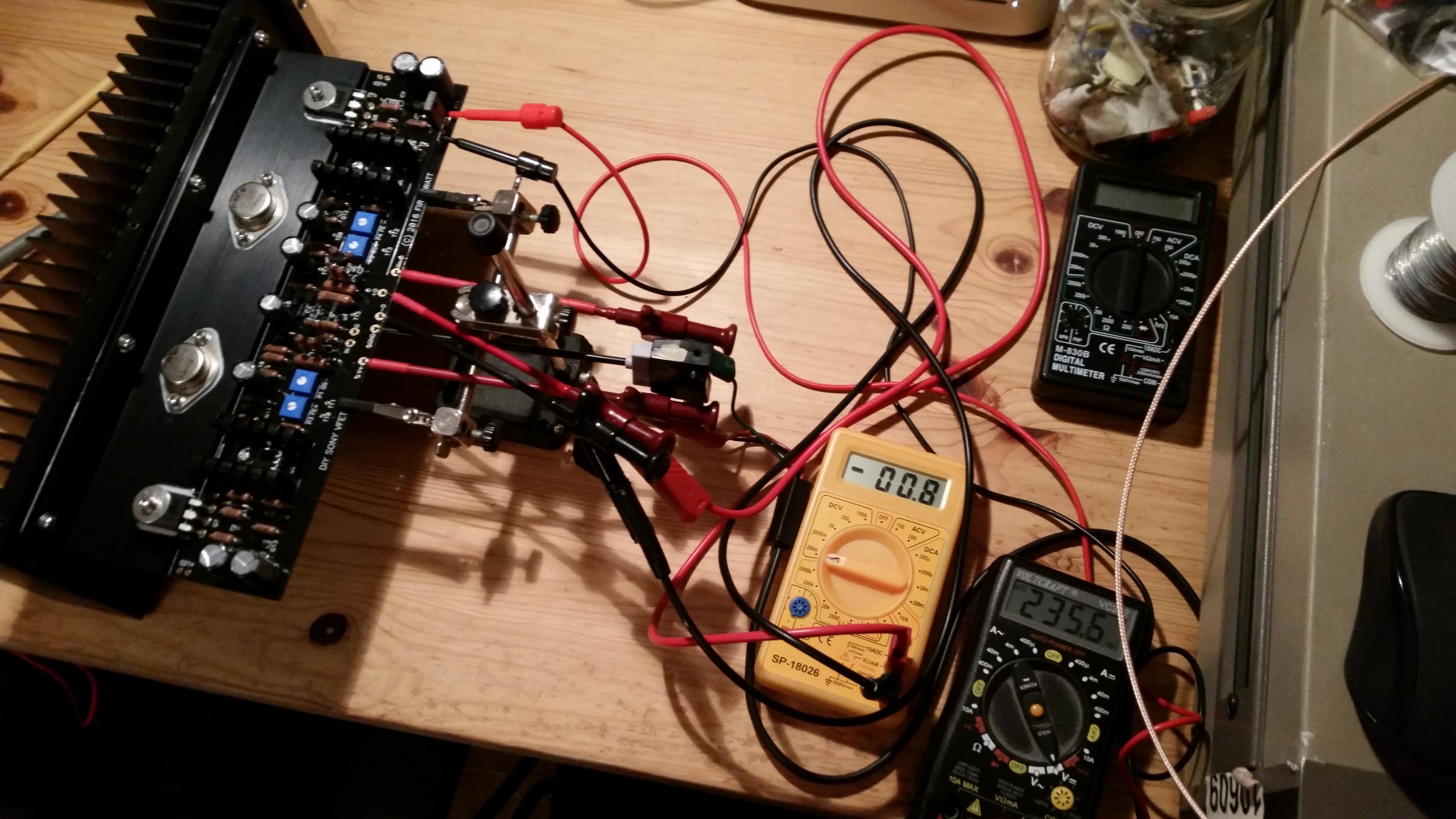

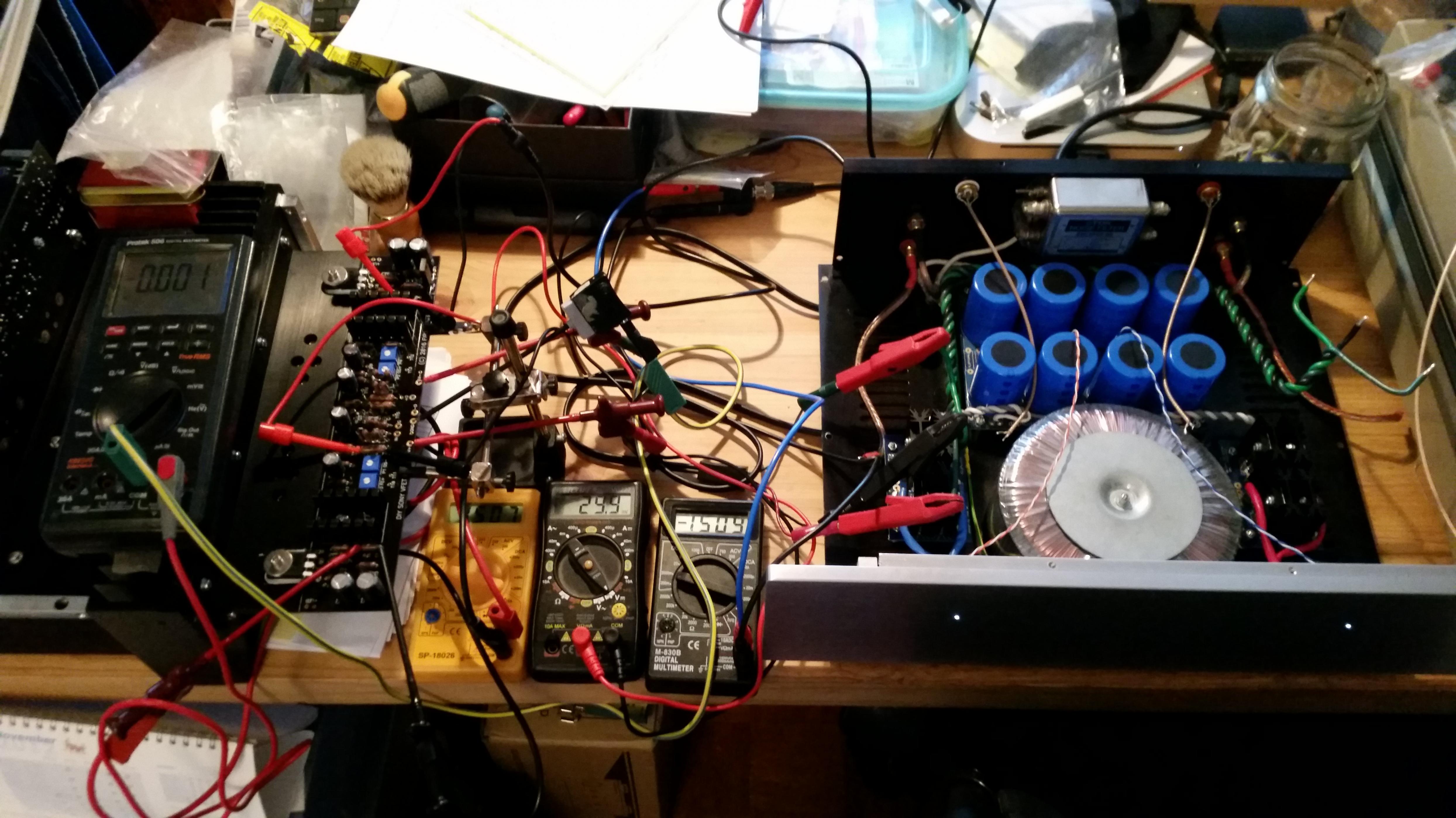

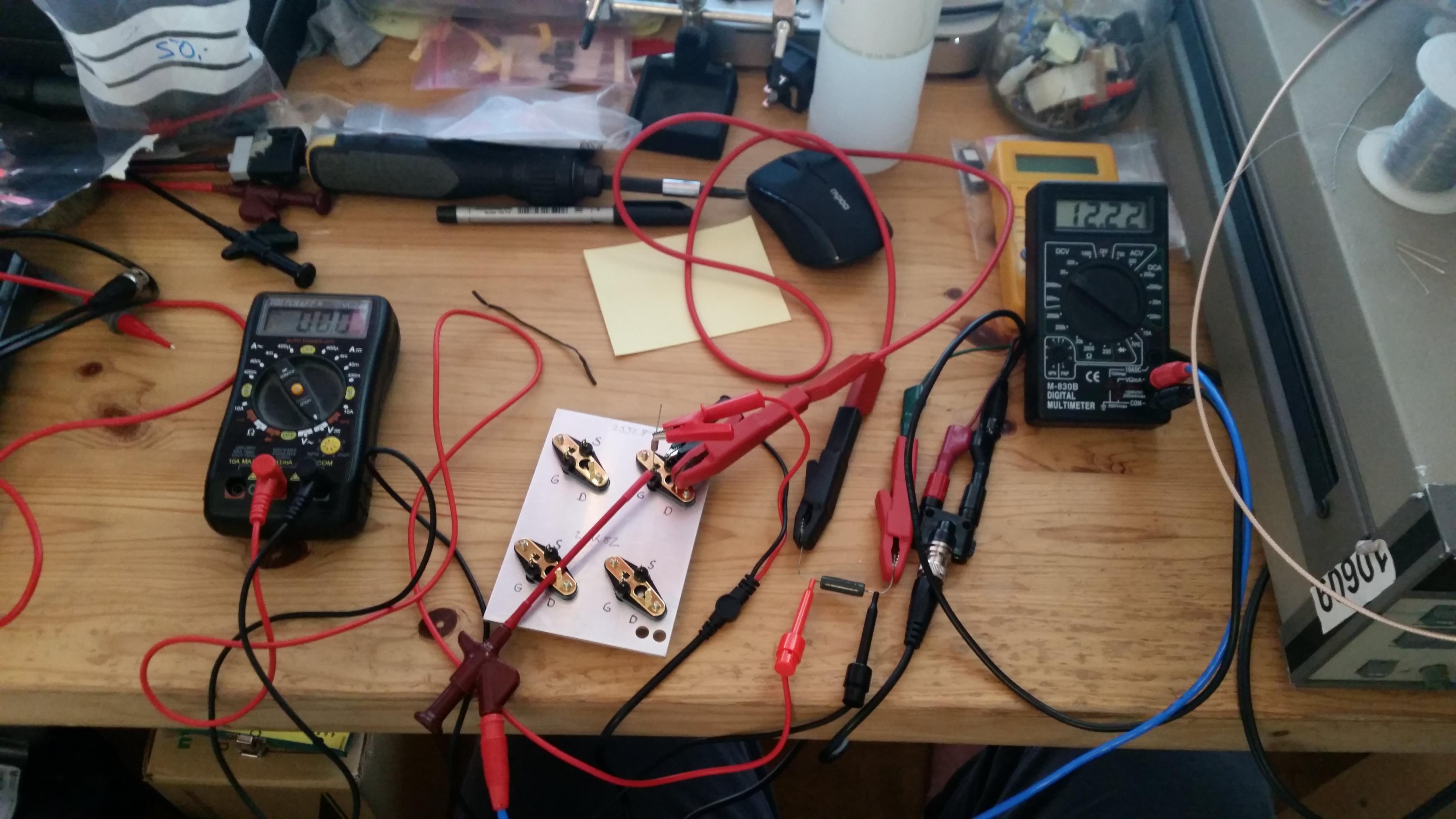

I've had an interesting weekend. Measuring Vgs of the VFETs sourced from Acronman, biasing up the frontend, installing the VFETs and biasing up the output stage.
So far everything looks good, I got the frontend offset down to about 50mV, and with the VFETs installed the total output offset down to single digit mV.
There's one thing that bugs me a little, T5 (drain voltage of Q10) reads one volt less than T3 (drain voltage of Q7). I've tracked the issue down to the regs, and it seems that the voltage at the gate of Q8 differs by almost a Volt from the voltage at the gate of Q7. I still have to check if the other channel exhibits the same imbalance.

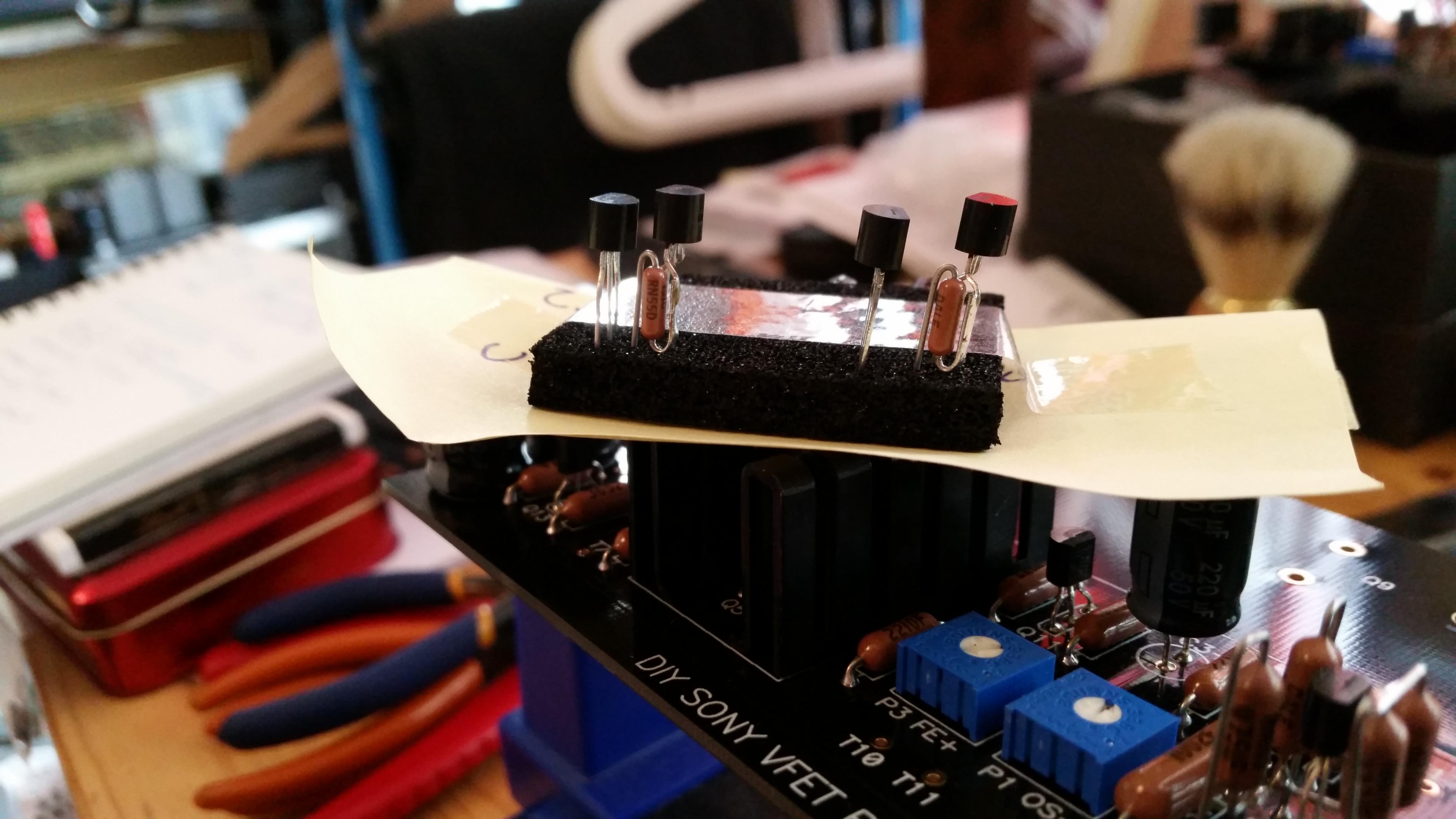

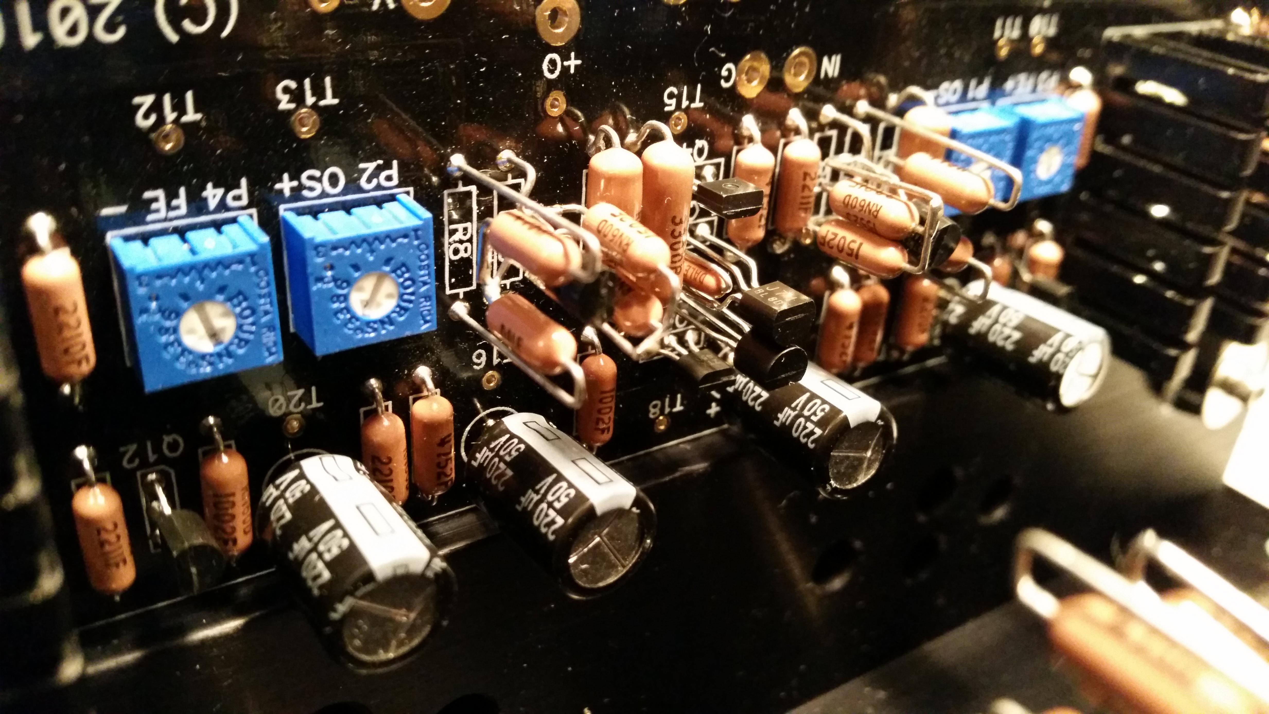

Bonus pics are showing a close up of the input stage and a close up of the 5R source degeneration of the 2SJ74BL jfets.

Check your resistor values around Q13 and Q14, R15 to R20.
A quick update: The resistor values around the shunt regs seemed to be consistent enough in both channels. With the shunt regs themselves being the main suspect, I measured Vref (between R15/R17 to GND and between R16/R18 to the shunt's output) in both channels. While three of them measured the expected value of ~2.5V, the channel with the drain vintage inconsistency measured ~0.7V for Q13. After replacing Q13 everything now measures fine. Next step is putting everything together in the enclosure 🙂

Just admire your boards and C3, 4, 5, 6 are 220 uF why not 47 uF ?
Kindest regards 🙂
I took the values from the Sony VFETs part 2 article and http://www.diyaudio.com/forums/blogs/tea-bag/352-sony-vfet-version-2-al-boards-build-blog.html with C3, 4, 5, 6 being 220uF and C1, 2 being 470uF.

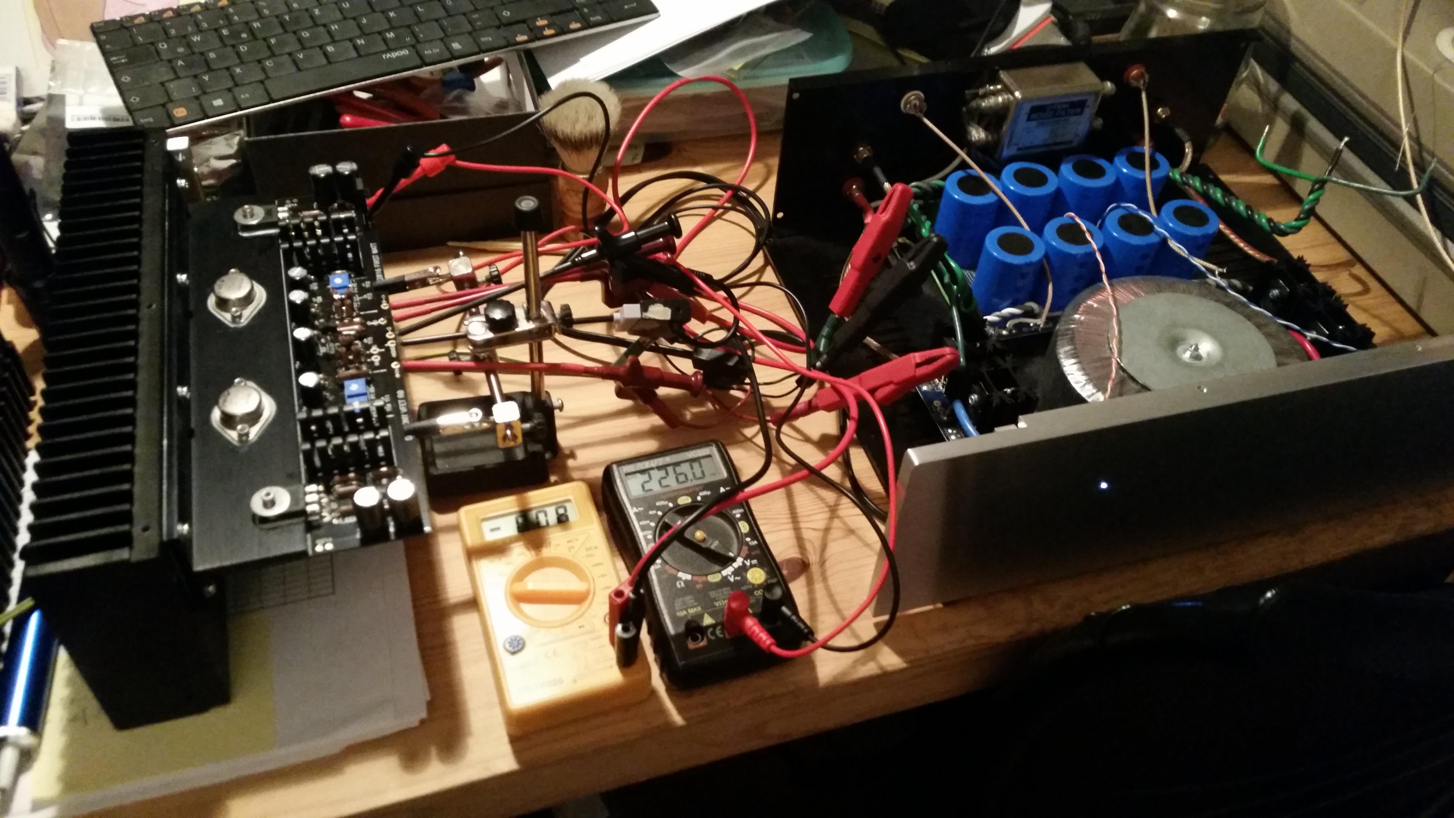

The attached pic is showing the newly biased channel with the replaced TL431 in action. I'm using a Caddock MP930 0R47 1% resistor as R32 since it's the only suitable part I've had on hands. 235mV drop would relate to 500mA through R32. Output offset is below one mV.
