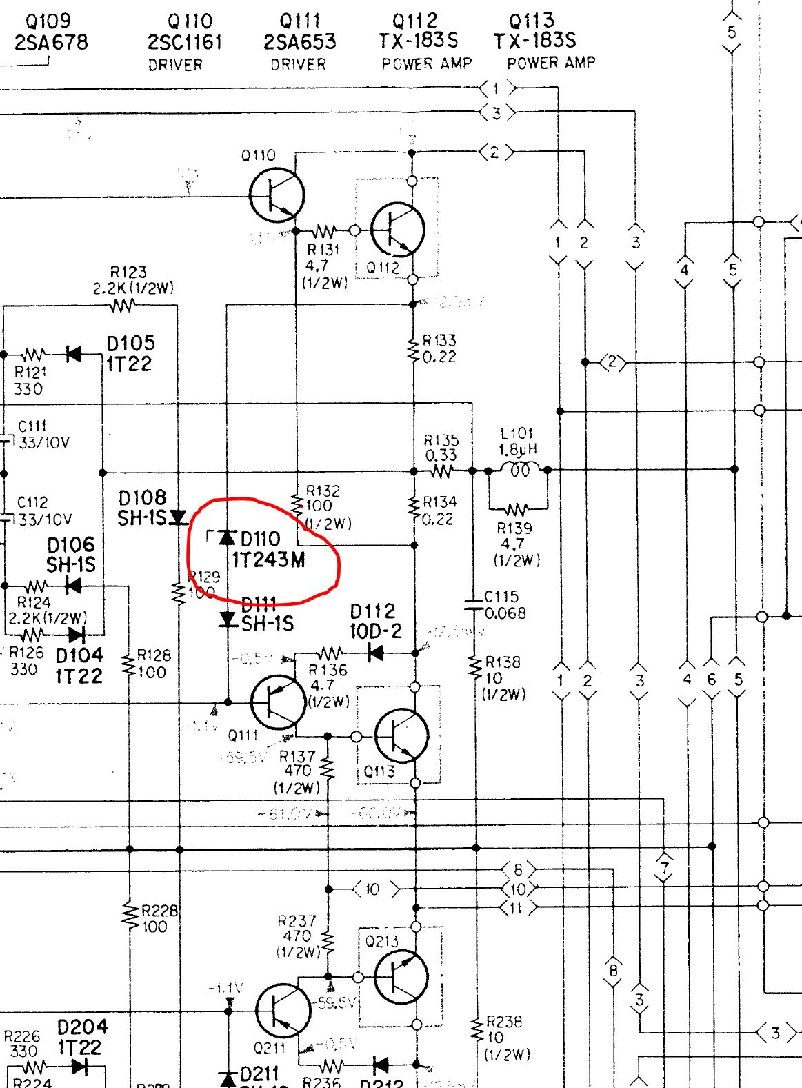

Just to make sure we're talking about the same diode - see snip enclosed.
Ah, no we are not
That one looks like some kind of protection device (Zener) but if it were leaky or anything like that then it would effect the negative going part rather than the positive as it tries to turn off the PNP driver.
If you have any doubts then just snip it out as a test. It shouldn't normally come into play.

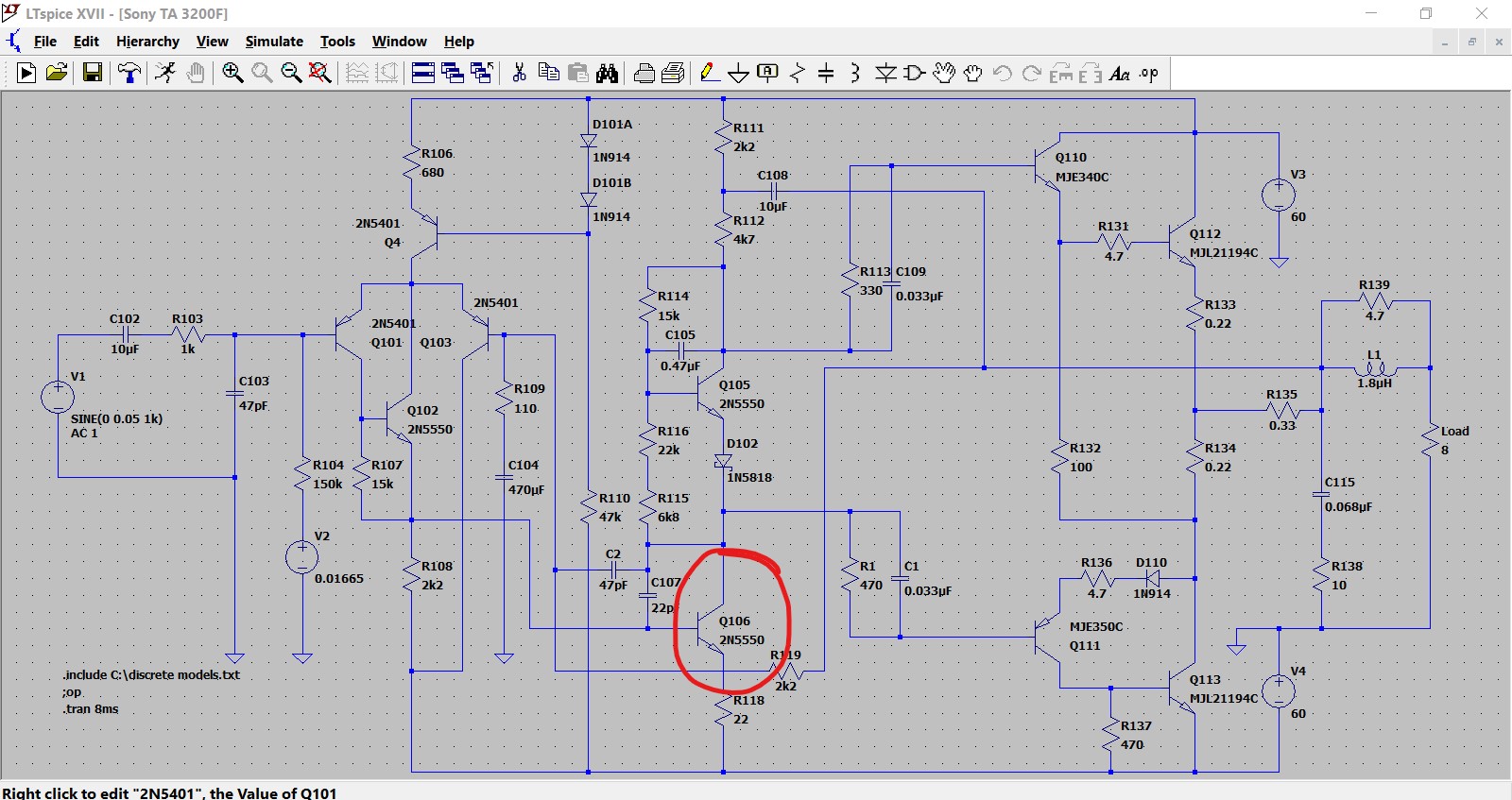

Putting notes here as I collect info. Decided to input sines @ 1.4V and trace through signal path. Well, this is weird. Q201(B) already shows the positive part of sine cutoff... Can't imagine why as there's sol little circuitry before it. Tried switching HPF on and off to no difference.

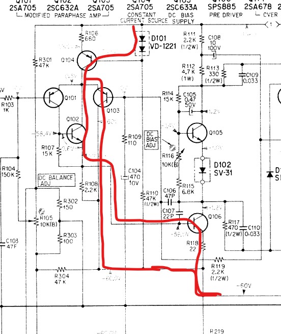

I don't know, there's either some sort of short thorough a path in the input stages (Q205/206?...), or Q301/302 exhibit some short (BC), but only under load (though both?...). Q206, for one, shows a bit low Vbe for comfort (0.43V).
I feel trouble lives in the Q205/206 neighborhood. It puzzles me whatever short goes through there can fry a milspec CMF60 (R312), but seems to leave Q301/302 standing. Though maybe I should test those two again. No matter how I look at it, I can't really place the melting PS resistors in the context of fixing the CCS.

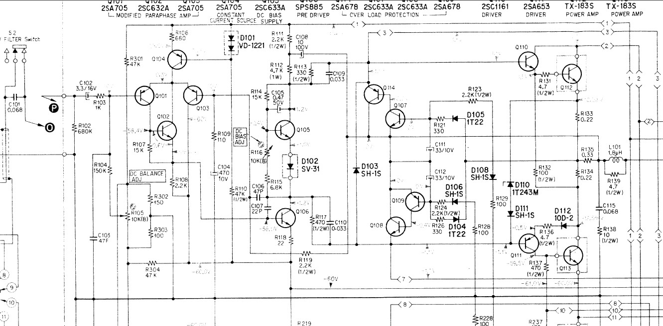

Non adjustable bias comes down to ensuring the voltage across Q105 and its series diode can put enough voltage between the bases of the drivers and outputs.
Its a Quasi stage so needs at least three Vbe's worth to do that, say 2.1V.
Q108, 114, diodes D103 and 110. Pull them all out until its fixed. You don't want to be fighting possible problems with the protection circuitry pulling things down. And of course use a bulb tester in that scenario.

If the offset is good then that implies the DC conditions on each driver transistor base will be correct... but check them. You should see approx plus 1.2 volts on Q110 base and approx minus 1.2v or a little less on Q111 base.
Assuming that is good then you need to look at the voltage across Q105 +D102 and also the current flowing in that chain.
So that is the voltage between R113 and R117. This should equal your plus 1.2 and minus 1.2 added together as a total. So 2.4 volts in total and this voltage will vary as you alter the bias preset.
If it reaches and goes over that figure then something fundamental is wrong around the drivers and outputs.
If it adjusts but doesn't reach 2.4v then that is why there is no bias current available. You then need to check the current in the bias chain.
You should have a total of approx 60 volts across R111 and R112. Check it.
Then calculate the current from your measured voltages. Lets say you have 52 volts. That is a current of 52/(2200+4700) which is 7.5 milliamps.
We check that result by measuring the voltage across R118, the 22 ohm in the emitter of the VAS stage. You should see approx 0.0075*22 which is 165mv.
If it falls down at any point then stop and check the resistor values are OK by measuring out of circuit.

Measure across each item rather than measuring from ground to see that actual voltage. Each volt drop is circled. One of them is likely showing more than it should. Don't discount breaks in the print either.
You could try measuring from the Collector of Q105 (Red meter lead here) and work around the loop. You should see the drops add up as you go around each node.
Hope that makes sense
Lets work with the bias voltage that can be swung as high 3v and over. That should take the output stage to destruction and so we need to see why it is not doing so.
If you turn the bias voltage up to the high end (so 3v and over between R113 and R117) can you measure any volt drop across R113 and R117 as that will allow us to deduce the current flowing into the base of the drivers?
There shouldn't really be anything significant across those resistors and consequently only very minimum current in those resistors.
Each half of the output stage is a Darlington configuration with massive current gain and so only a few hundred microamps needs flow in those two resistors.
The 3.2 volts (for example) that you have across the bias generator must be accounted for in the sum of volt drops across the 330 and 470 ohm resistors together with each B-E volt drop and the diode D112. It is a series path from start to finish.
They must add back up to that starting voltage. So something somewhere is dropping more than it should and yet not allowing the output stage to conduct.
Each B-E junction and the diode should clamp firm at no more than around 0.7v which is only 2.8 volts total. In practice the figure would be less because each transistor will begin conduction below that 0.7v level.
I've measured the above (gotta go back on a couple of spots) - but I'm not sure if protections (Q108, Q114, D103, D110 & other side) should disconnected for these measurements to be relevant. Also, what about the Q303 through Q307 part of the circuitry?
I'm getting some pretty weird readings and wonder if it's again the case that the protections are on and messing with the "natural state" of the devices.
You can remove Q114 and Q108 together with either D110 or D111 although I doubt there is a problem here, at least with the transistors because any conduction at that point would tend to lower the bias voltage available... and you have over 3 volts available.
Those diodes though, yes pull either of the two.
Q303 to 307. Again the fact you have 3+ volts available suggests these are not adding to the problem but again, we can be 100% sure by isolating them. Just lift D316 and D317.
It's advisable to make notes of what you do lift as its easy to forget and keep track of
