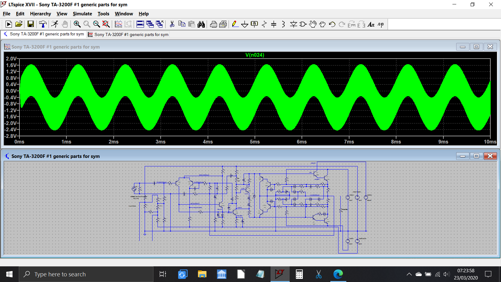

I assume an oscillating amp should show some dirties at output (or along signal path), via scope. Or maybe I should employ AP box + EMU0404/ARTA, which would bring the frequency domain examination benefit.
I haven't had one do that, I'm not entirely sure how I'd check. Welcoming any pointers.
A decent wideband scope (not a USB thingy) should show any oscillation clearly. If all you see is a clean DC offset then it's not oscillating, on the other hand if you see some significant HF present then that may (on the scope) still appear centred around the 0V point and yet confuse a DVM into showing an offset.
Even the simulation can easily be prodded into instability. Look at the asymmetric nature of the oscillation and how it gives an apparent DC reading even though it appears centred around zero volts. This is the main speaker output. The frequency is around 1.5Mhz.
No oscillation I can discern - <5mV AC on output, which to me its likely just noise. Clean as a whistle.

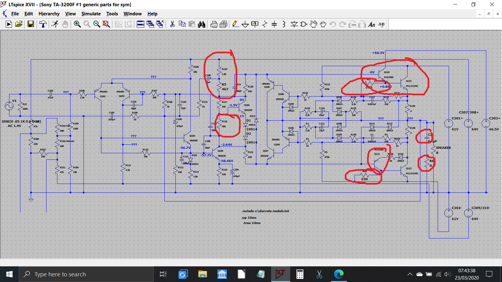

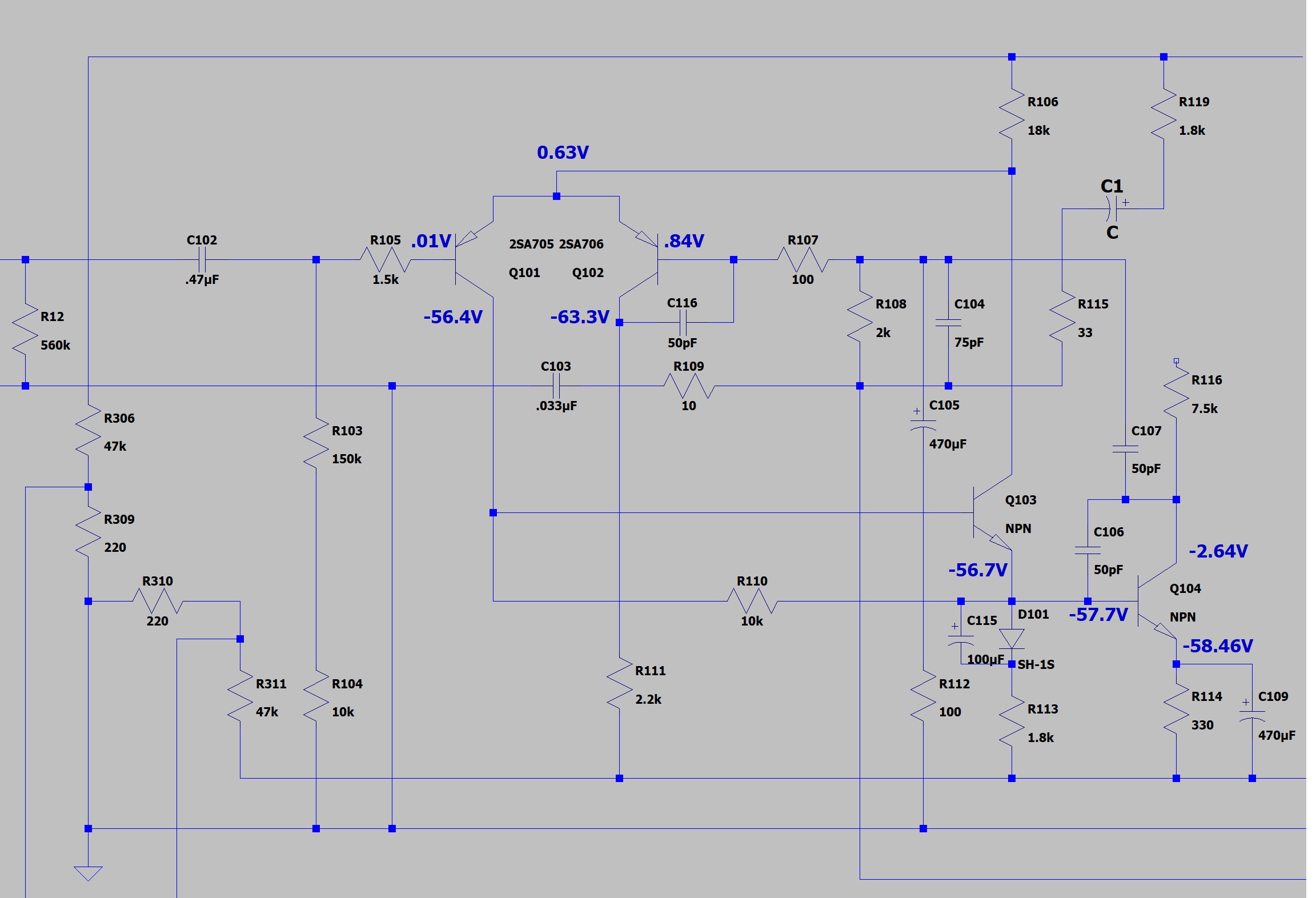

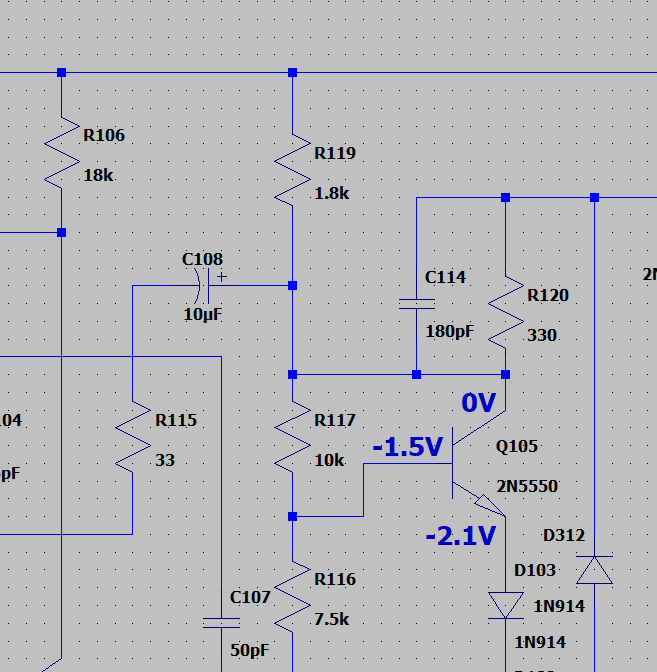

Here's some partial information (while I continue drawing the circuit in LTSpice - btw, where the heck is the potentiometer? I downloaded files off of this community, but I can't seem to be able to load them).
These are voltages actually measured while symptoms are on. Some voltages may be measured with the original 2SAs, others with the MPSAs (different days), but it didn't seem that there are significant variations between them. I may remeasure everything tonight, possibly after I get 2N5401s etc. in there.
Thank you!
Thank you!
Mooly and all,
I'll really need to review this, as it's late and I've been at this for a while, but here's a provisional asc file for the schematic. I am no wizard at LTSpice, so I still need to populate this with supplies and other peripheral stuff. It takes me more time that it would someone versed in this.
But this should at least emphasize this is an early TA-3200F. For instance, the current source on the differential input is missing. Other differences may apply.
As I said before, I also have a later one (may be very close to yours Mooly), and due to the differences, I can't wait to get that other one up and running - the design details seem to point to a better concept. So a better sounder, chances are.
More tomorrow. No time on the bench today due to contingencies. Just virtual bench via LTSpice...
On the voltage readings - isn't it a sign of illness that the differential pair is so unbalanced? I'm referring to the collectors of Q101, 102, sitting at almost 10V difference, which is about, what, 10%? I don't think this should be this large. Stepping back and looking at this big picture - it worked absolutely flawlessly for hours after adjustments and AP measurements, and then a POP! and there's no sound. A part failed catastrophically, I wager.

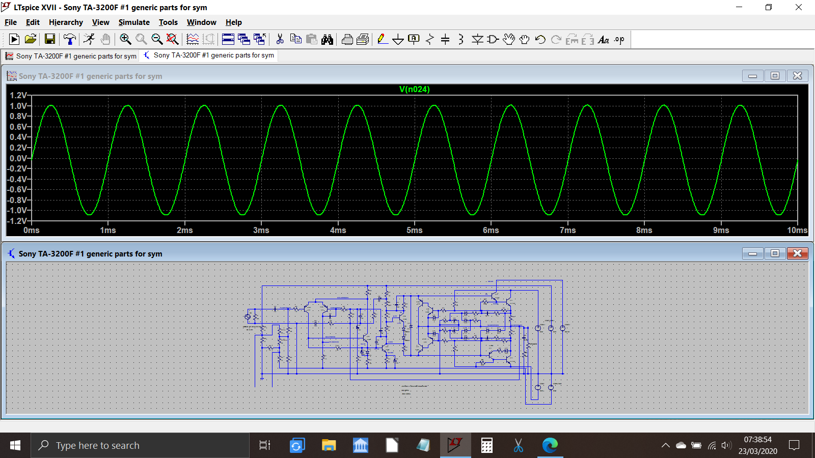

It would be worth checking the amp isn't oscillating as that can give rise to an apparent DC shift in output, particularly if it is asymmetric in nature.
For reasons that elude me I found I have a LTspice simulation for this amp... must be another thread somewhere from the past.

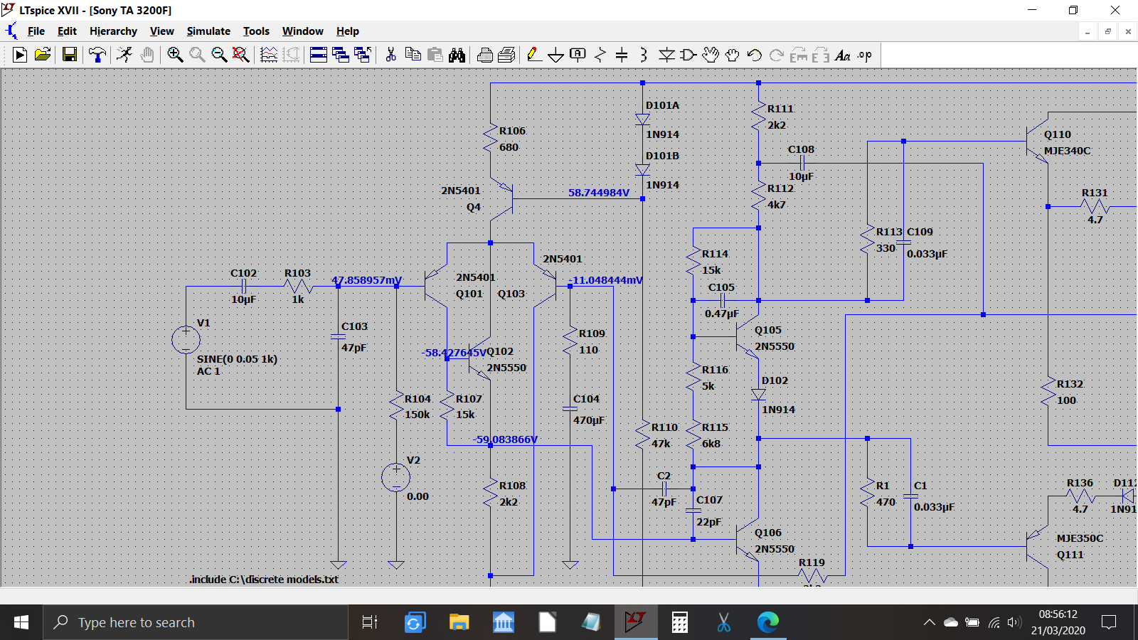

OK, I have some sort of simulation - I used some best guess parts from the main library everywhere and I get no error. I don't get any signal out though.
I am playing with this right now, but any glaring mistakes, please feel free to point out.

Here you go. Lots of ways of doing this but I add the model file to the root of the C drive as shown here. Just copy and paste it into place. You can rename the file to whatever suits you if you want. Doing it this way means it can be called from any LT file anywhere on the PC as long as you add the:
.include C:\discrete models.txt
directive on all your LT files.
It has to be in a zipped folder because it comes in at just over the forum size limit for a text file.

OK, so its making a bit more sense how its configured. Scrub the above comment for now
The offset seems to be because of insufficient current in the front end... it would be worth checking the resistors are correct. I can get the amp DC stable by lowering R106 but there is another issue with bias current.
R119 would be passing 35 ma under quiescent conditions which seems far to high. Worth checking that area for configuration of the bootstrap and the values.
Is there a resistor missing that should be connected in series with R119 ?

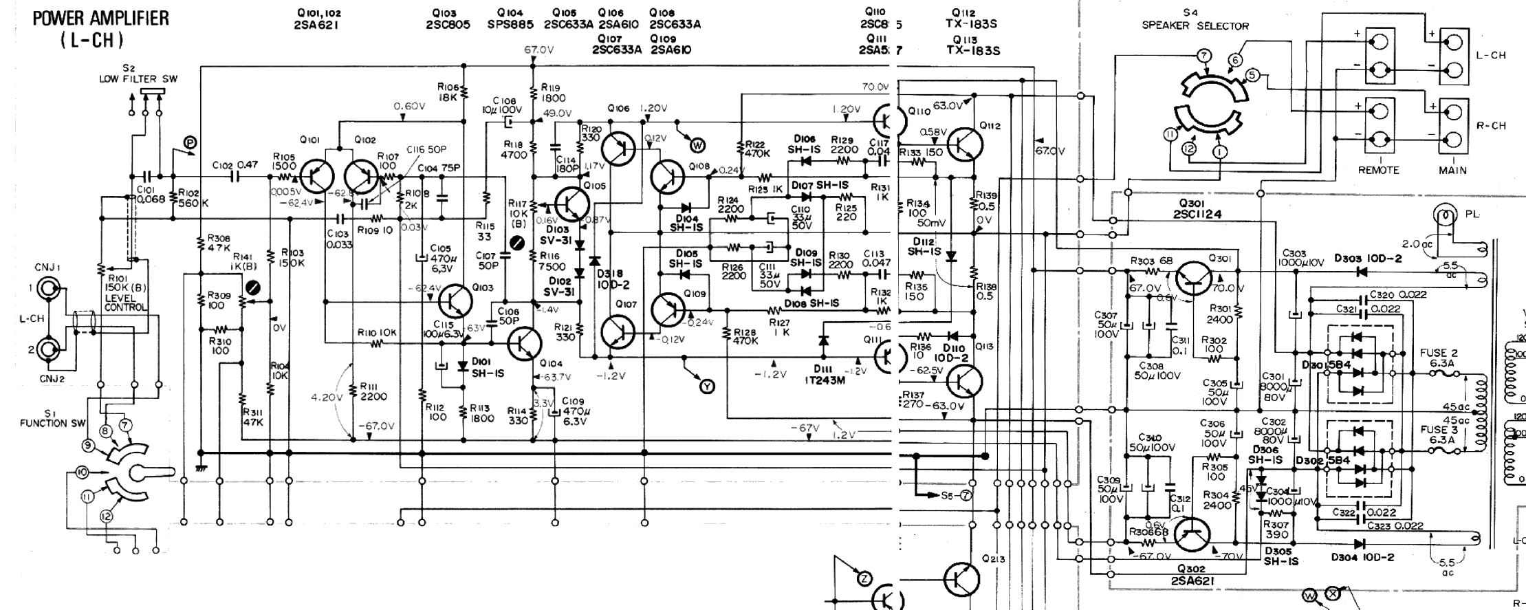

For reference, I include a snip of the early version's schematic (hopefully legible). I will be double checking my spice, but I think I followed it OK. I've also been spot checking the actual amp against the schematic, and except for the odd, dissimilar input LTPs, it seems to be matching.
Per this, R119 should see 10mA through. I have not checked the voltage at the lower leg, but will, to add some empirical data to where the amp sits in terms of OP.

Before my gear giving me a hard time, I managed to confirm R119 sees 10mA through it.

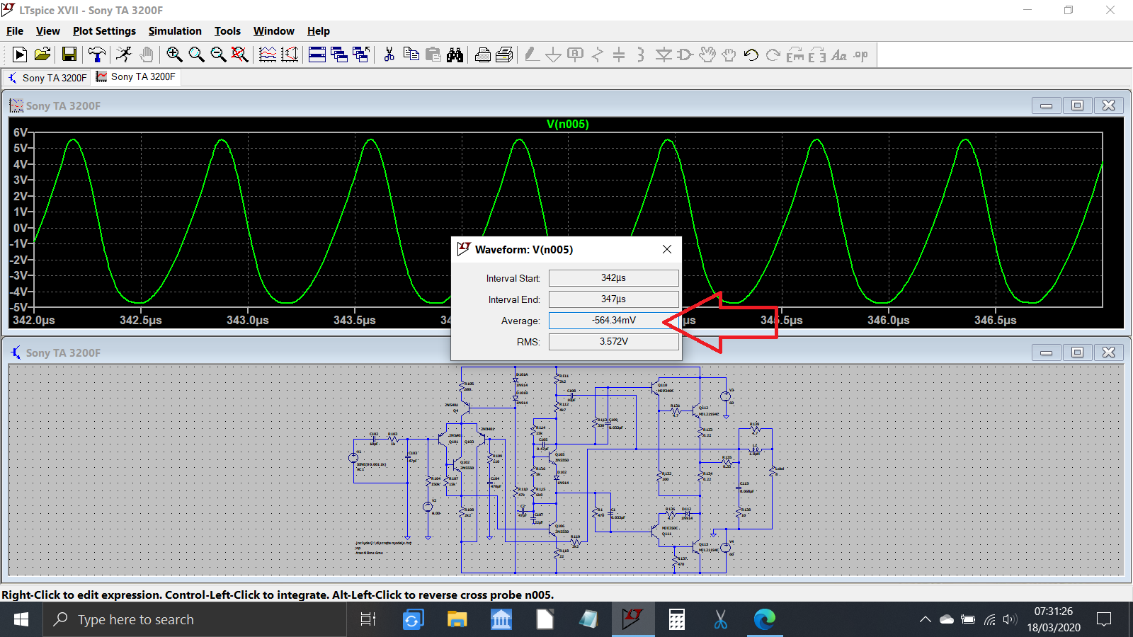

It looks like the 4k8 is missing from the sim which explains the high current and incorrect bias adjustment. 6 to 10 ma would be a typical VAS current for that part of the circuit and we know that with a 60 to 70 volt supply that the combined resistance has to be somewhere around 65/0.006 to 65/0.010 giving around 10k to 6k5.
Lets see what happens... this is a running commentary...
So current now at 9ma, DC conditions basically OK but bias still high. The two series diodes seem to be creating to high a volt drop. Also the amp is unstable now. I've replaced them with shottkys... still to high and unstable.
Think we will have to remove one of the diodes... unlesss... yep, its the driver transistor causing that problem. Now using MJE340 and MJE350. Bias sets correctly now.
Still unstable though.
Zobel network added... all good off load, no good on load... and just spotted it. The PNP driver is upside down

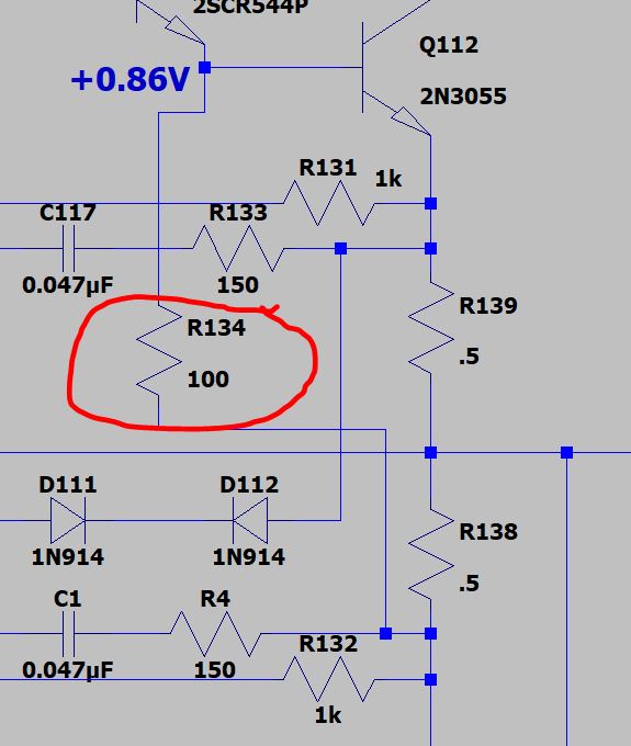

Bias now high again... is there a missing resistor between B and E of the upper NPN output?
I'm going to add one. 220 ohms sounds reasonable. Bias lower now but not low enough.
Time for some different outputs, MJL21194C. Now we have an offset, that's odd. I'm going to add a similar 220 ohm to the lower output.
Stable and bias now adjusts to 100ma Latest file attached.

- There's a resistor (R134) which I don't know where to place... This is because of a crease to the original scan or whatever. Will seek to identify on the actual board and see where it connects. May explain why some of this is still off.
- I couldn't figure out for the life of me yesterday how to add the MJ transistors to my LTSpice. Still can't (though I'm still working my way to the first sips of coffee this morning, so not yet at much capacity...). Can you pretty please share some hints? I think I'm so lucky as to already be talking to the LTSpice resident specialist...
To this end, I've downloaded lib files for the transistors. Not sure what the next step is there.
