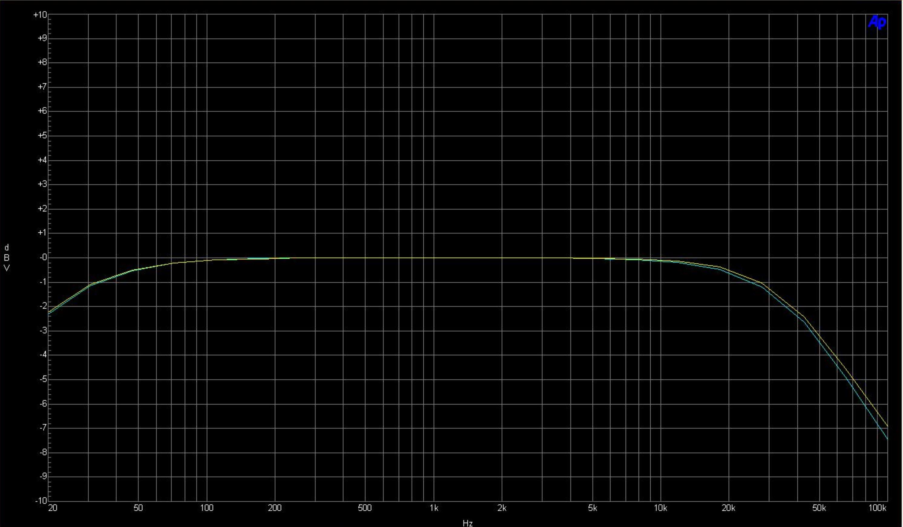

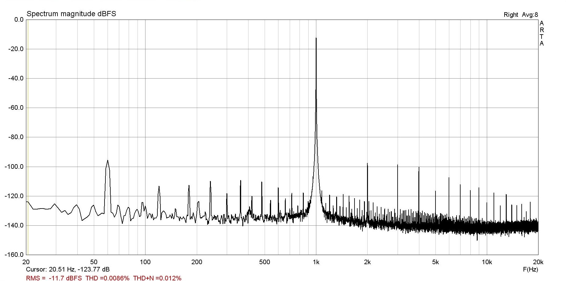

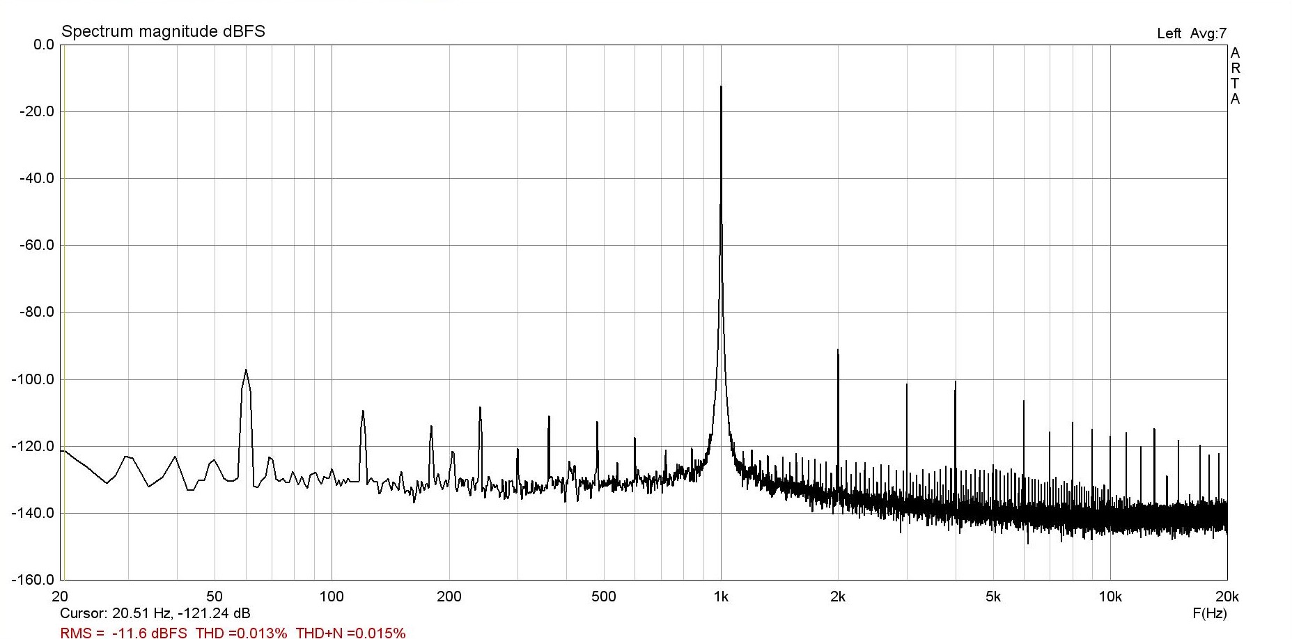

I enclose some quick measurements. Interesting thing is - the R channel is all new, current production Qs on the input, and has distinctly lower distortion numbers. Having said that, the old one also had a channel with much lower distortion readings, also R, so take that with a grain of salt.
The frequency response is not as good as the old one's at the high end... Not entirely sure why. I am considering replacing the low value ceramic caps - which look very bad, all sorts of oxide and deposits on them - with C0Gs and polys where I can, see if that makes a difference.
