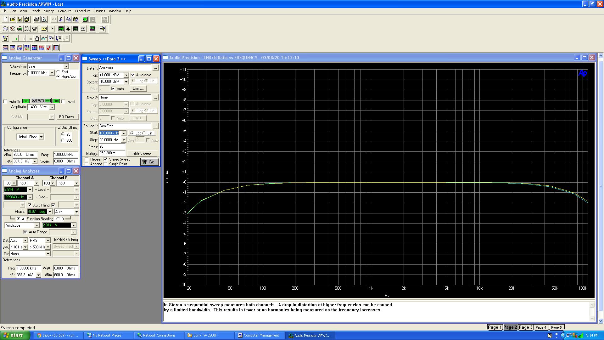

I'm working on this amp, which I recapped, adjusted, measured (fairly well - enclosed), and played for hours, until there was a POP!, and I lost both channels.
Smelling something too hot for comfort from the speakers protection board (it's an early model), I measured DC voltages coming into the protection board from the outputs and I get 0.85V for one channel and 1.38V for the other. Obviously, humongous. No wonder the protection boards clamps both channels to no output (base of Q110).
Obviously, at the end of my adjustments, the values for bias and offset were pitch perfect.

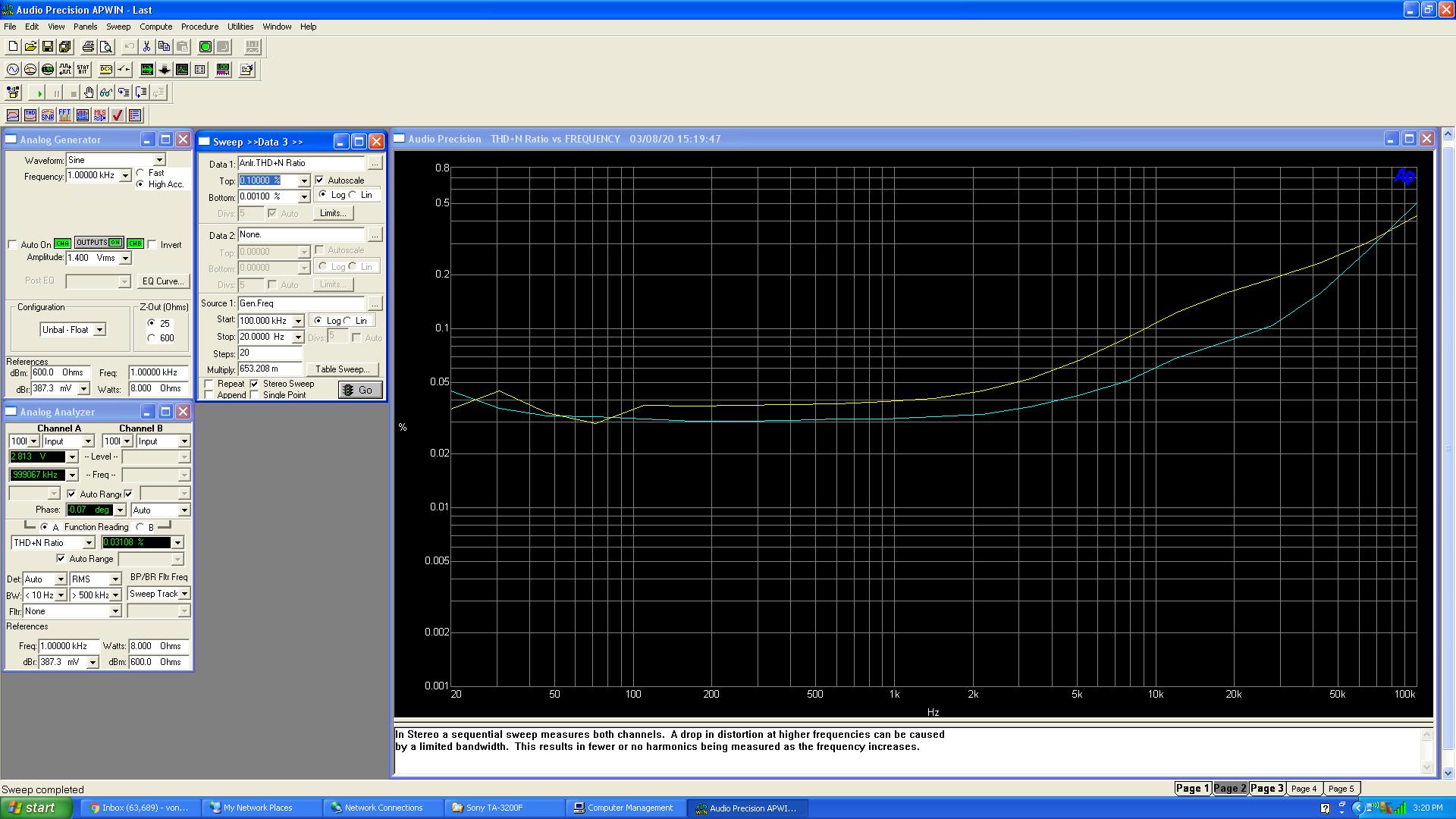

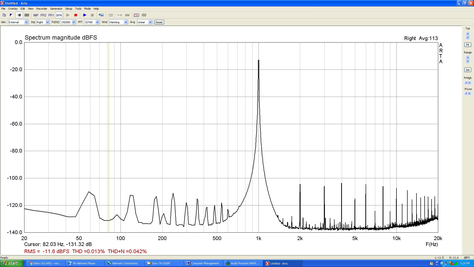

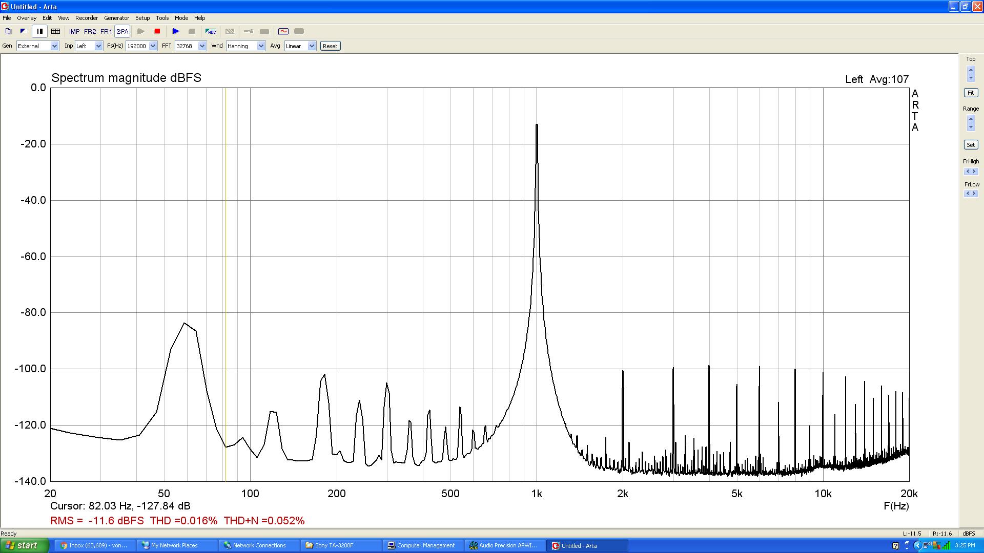

Sony TA-3200F ARTA 1.4V in 2.8V out L - ADJUSTED - 03-08-2020.JPG197.2 KB · Views: 346
Sony TA-3200F ARTA 1.4V in 2.8V out R - ADJUSTED - 03-08-2020.JPG193.2 KB · Views: 327

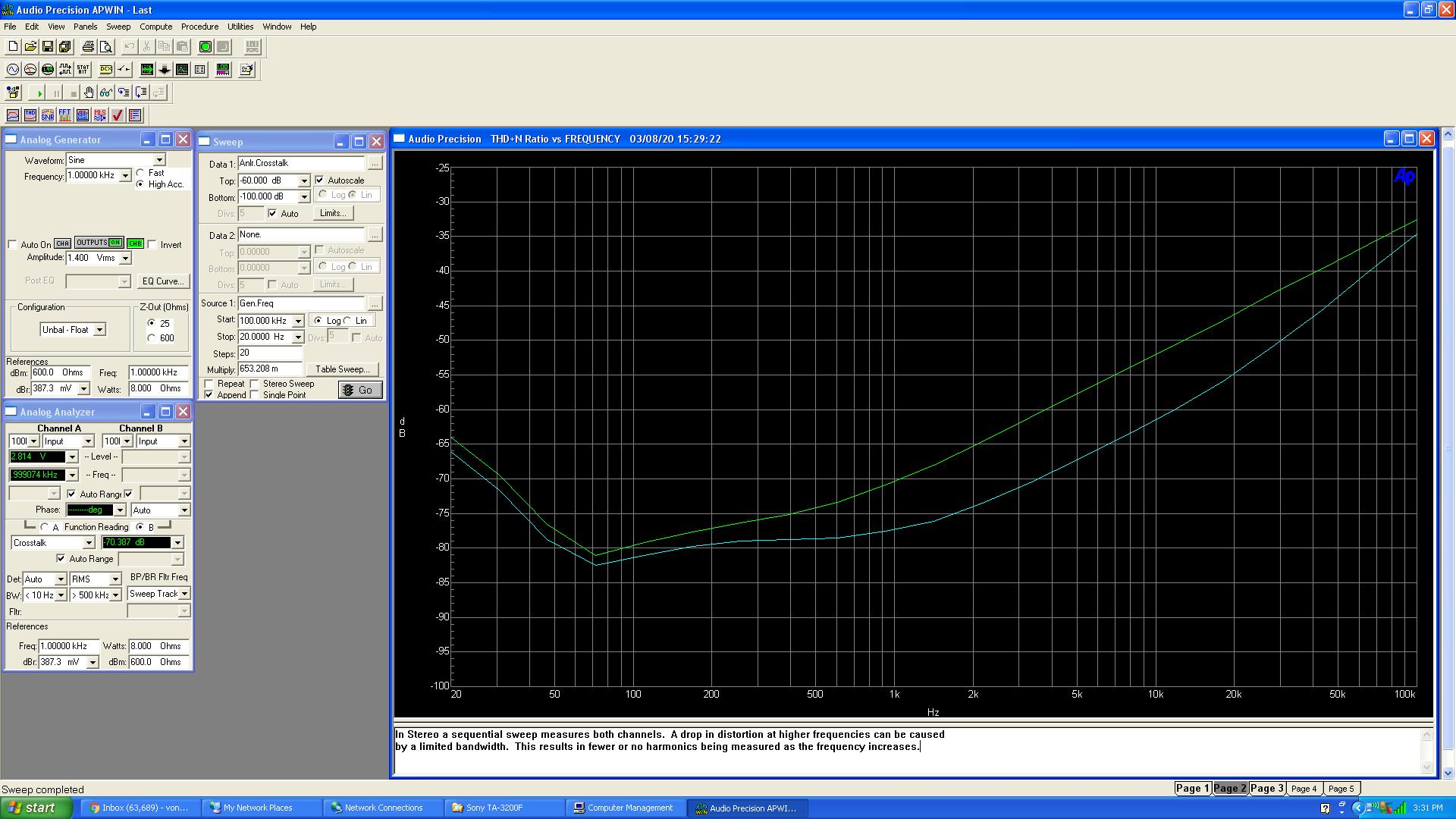

Sony TA-3200F crosstalk vs Freq B is green - ADJUSTED - 03-08-2020.JPG287.6 KB · Views: 323
Sony TA-3200F THD+N % vs Freq - ADJUSTED - 03-08-2020.JPG302.1 KB · Views: 309

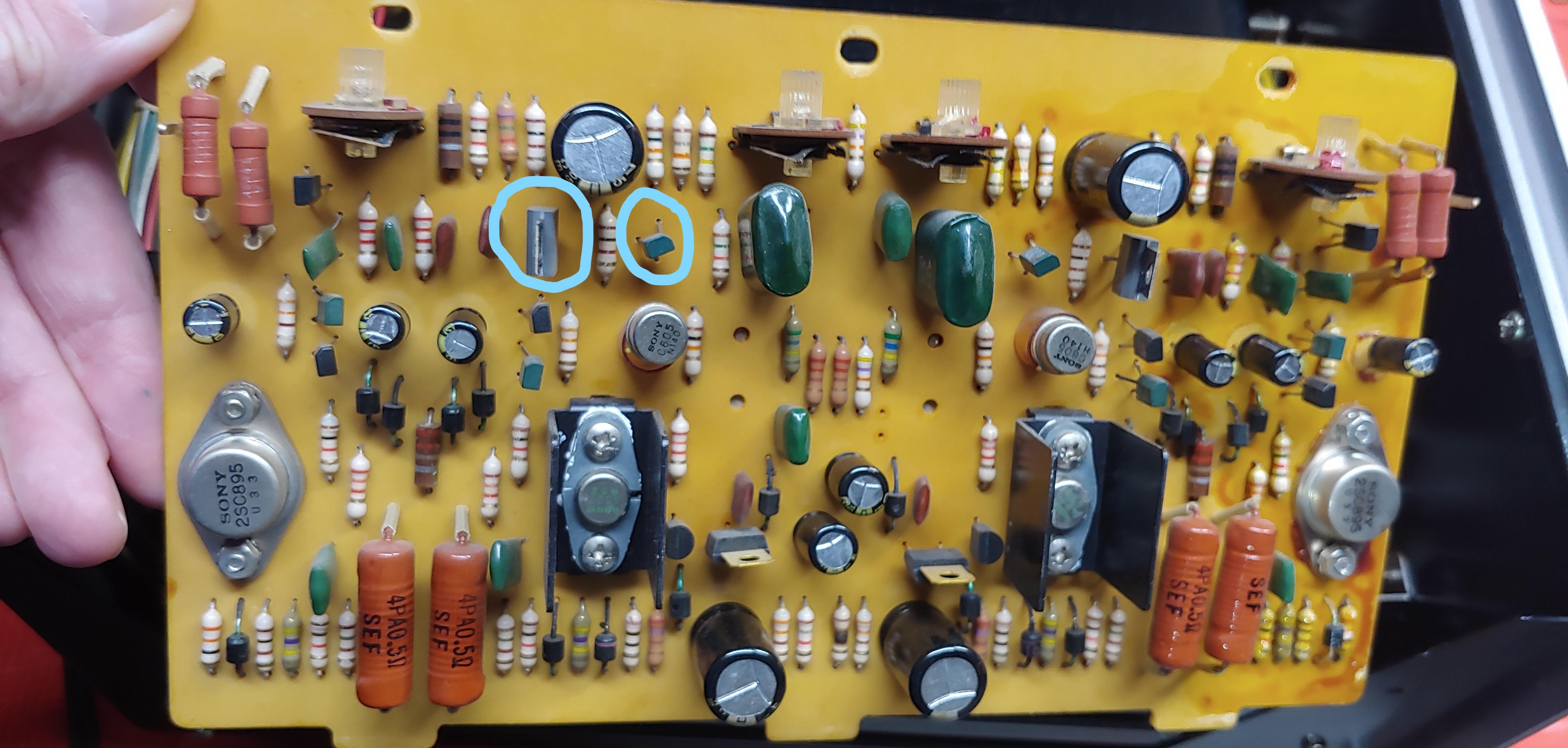

The differential input seems to be very unbalanced: Collector of Q101 is at -56.3V while Q102 has a more expected -63.3V. I also don't see measurable current through R111 (barely a fraction of volt over it), so I am running under the assumption Q101 is busted.
The same measurements apply to the other side. How can this happen? Well, my fault entirely. I missed snipping the legs off of C115, C215 in that snake nest of wiring that's back there, and so they were collapsed into themselves when I fit the board back into its cradle and they may have shorted. Not 100% sure this is exactly what caused this - especially as it measured well and ran for hours under these conditions - but it's likely the root cause of my issues. Bad form, what can I say.
I am assuming I ruined Q101 and Q201. They are part of pairs which are very strange in my unit - it seems they mixed an 2SA706 and a 2SA705 on each pair (why?!?). Despite their name, they are completely different transistors - 2SA706 is a TO202, 2SA705 is s small signal plastic case transistor. I have no explanation for why this would be. The service manual calls for 2SA621 in a symmetrical pair. Per my info, this is an early production unit and the respective service manual applies.

also check your brown / gray / orange / gold resistances (1.8k) right next to your potentiometers and your potententiometers
Thank you, huggygood, didn't see that. I replaced both R113/R213 with CMF55s 1.74k to no avail. No change to the observed faults.

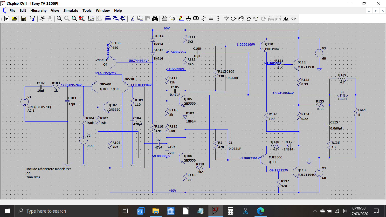

For reasons that elude me I found I have a LTspice simulation for this amp... must be another thread somewhere from the past.

Mooly - shall I take the alternate parts shown in the schematic (2N5401, etc.) roughly confirmed for this application? Preparing a parts order and will add some Qs for any needs on this.
The 2N's etc are all just standard generic parts that are commonly used (in simulation as well as real build) but while they may well be OK they can't be 100% guaranteed to result in a stable (no oscillations) repair without testing for real using a scope etc.
Using them may require some small tweak of a component value.
