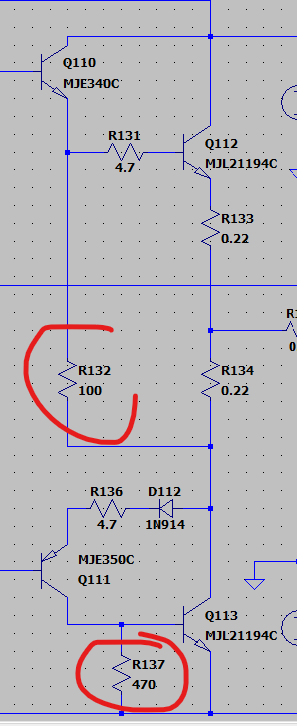

I temporarily have R134 like this (see enclosed). It seems to be helping....
That 100 ohm is really doing the same thing as the two 220 ohms I added.
They very significantly speed up the turn off of the power transistor by removing charge carriers from the junction as well as reducing leakage current of what is really a Darlington pair (driver and output)
Pretty much every amplifier has them in some form or another.
I'm just looking at the TA3200 diagram I had and that shows a 100 ohm for the upper device and a 470 ohm for the lower.

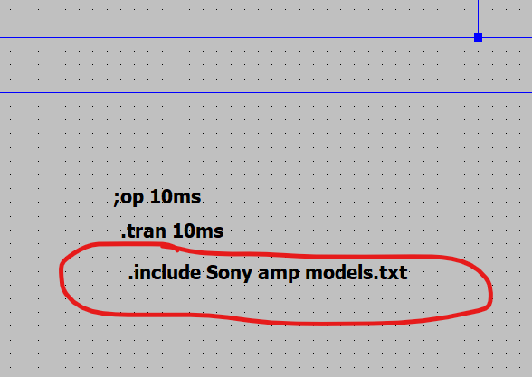

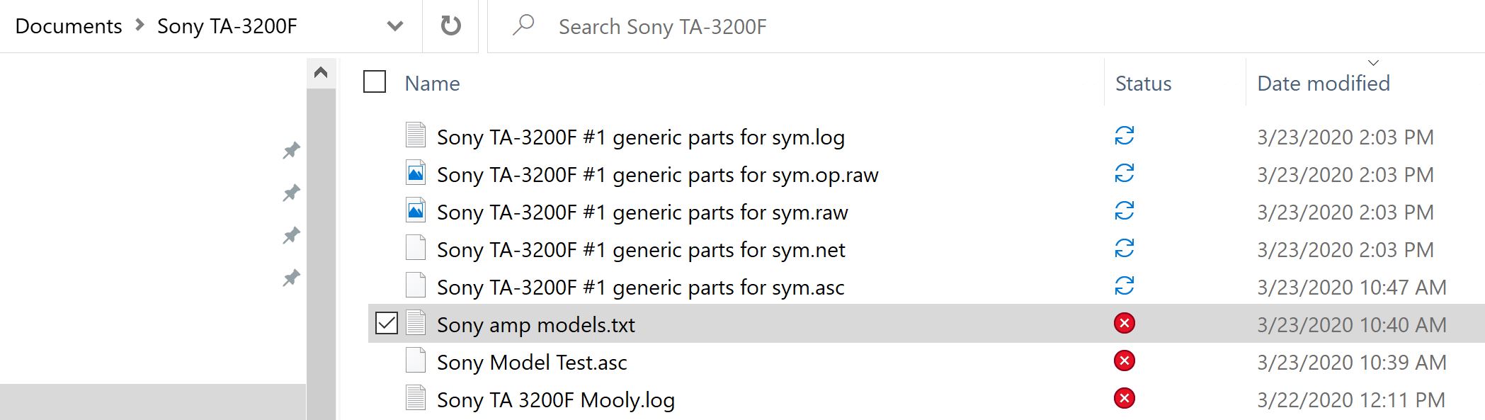

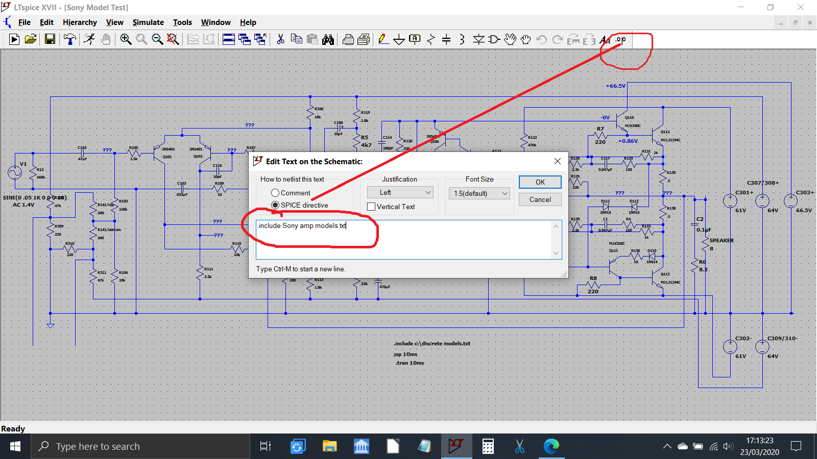

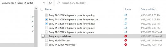

So I added the directive inside my regular asc file, and placed the txt in the same folder. Should I then see added transistor choices when I right click on the pre- or drivers?
If yes, I'm doing something wrong, cause I don't see those added choices. I will persist though.

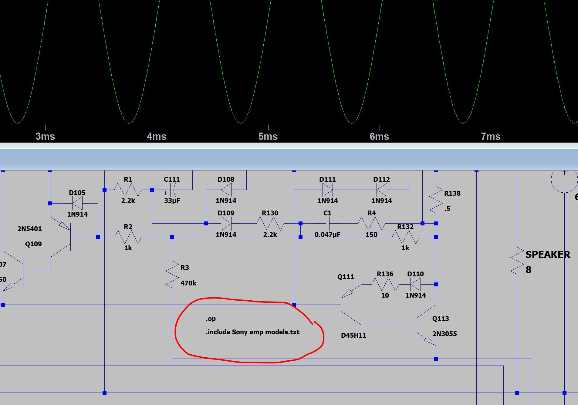

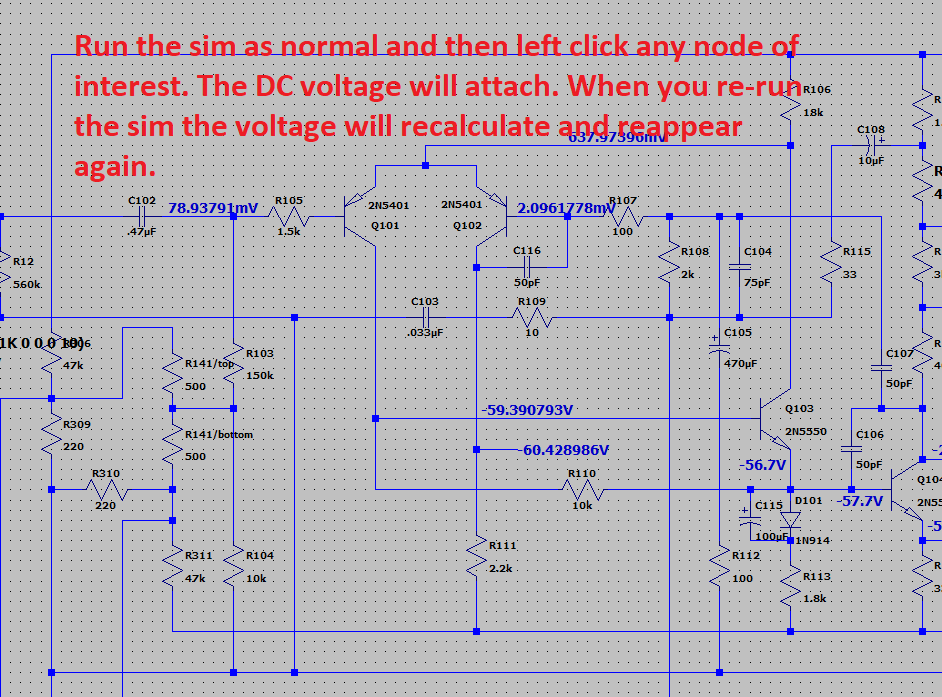

Stepping back a bit (and as the sym seems to be stable now - right?), I think next step towards troubleshooting is to generate DC readings all over the place, compare with what I'm getting from the live circuit, and interpret. Agreed? As the values I placed on there this far are bare text readings from the live circuit.
If yes, I am not yet sure how the DC readings get generated from the sym file. I added a directive (".op"), but I'm probably missing a step.

I think I figured it - at least to read DC OPs, not display them - and it's down in the command bar.

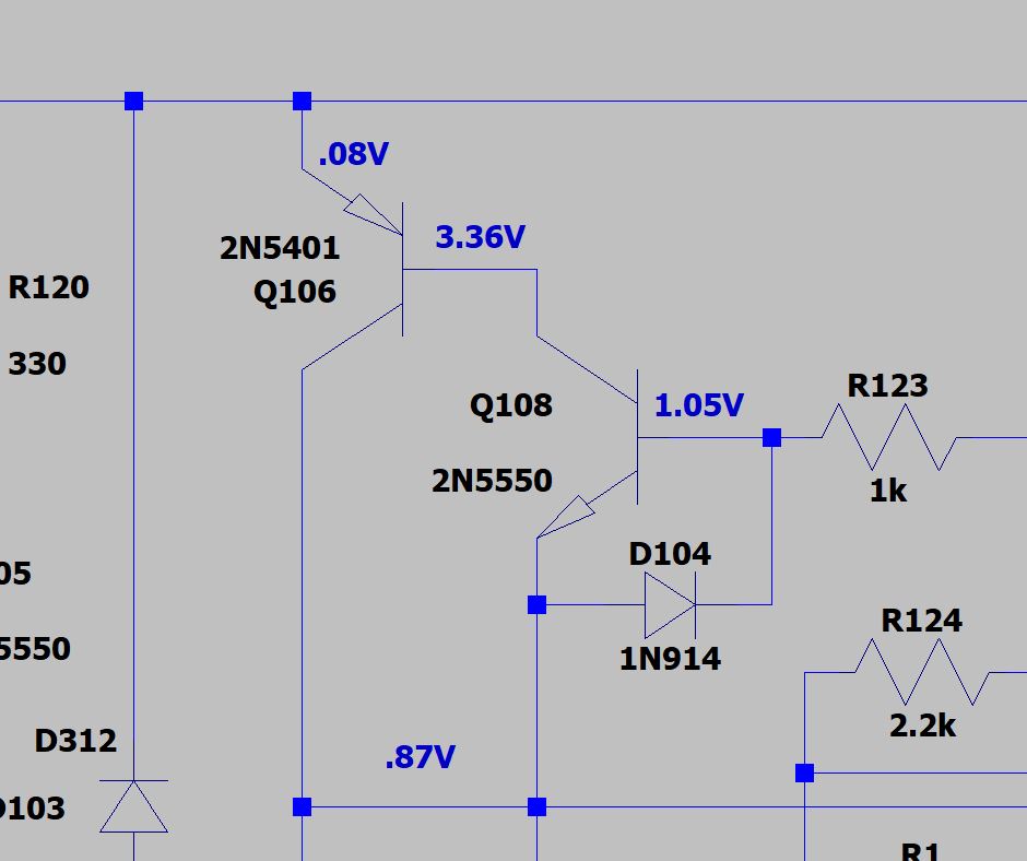

Doing this, I'm trying to verify my actual readings, and the whole area between the collector of Q105 to the base of Q110 (largely reading 0V) seems wrong - should be form 1.6V to 1.8V depending on where you measure. Maybe Q106 is shorted between collector and emitter? I think I should investigate right there.
The working circuit - even with the still off Q choices - shows about 30mV offset at output per sym.
Q106/Q108
Here are some measurements from this trouble spot. Something's totally out of whack there, if you stack it against the sim. The .87V there is the output offset on that channel. The other must have different readings, but just as out of whack. But obviously, no C to E short there. Not sure why I thought of that, frankly.
I think one clarifying point out of this simulation work is that the differential pair collectors imbalance is confirmed by it, against what the service manual may want you to think. I wonder if they made up those numbers (-62.4V; -62.8V) just to make it look tight... :cool:

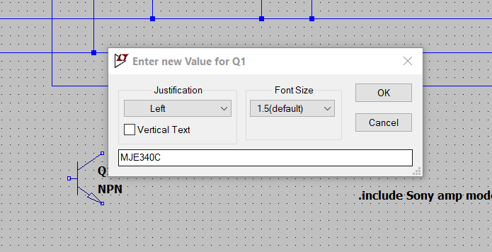

With models added the way I have shown you actually have to go and right click device type and type in the new device exactly as it appears in the model list. So in the image here you right click 'NPN' or whatever device type is already showing.
When you run the sim either as a .tran or a .op you can then go and click on any node of interest and the DC voltage will appear.

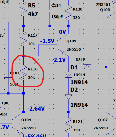

Make sure the sim is running with a low bias current. I have R117 at 3k and R116 at 40k which is giving about 50 milliamps bias current.
In the real amp the connection between Q106 base and Q108 collector is normally what could be called 'floating' because the transistors are normally off, and so any measurement you make there may not be accurate as it is effectively a floating node.
I would really recommend using a bulb tester on the real amp and perhaps investigate whether there is a problem around the drivers/outputs.
The 0.08 volts on the emitter of Q106 shows the outputs are not biased on. The main amp output is actually more positive than the base drive voltage to the upper driver... so something is amiss. The base of the upper NPN output should be approx 0.6v more positive than the emitter and the same incremental increase should be seen on the base of the NPN driver.
I would force zero bias current by shorting Q105 out from C to E. You should then see zero volts across each output emitter resistor.

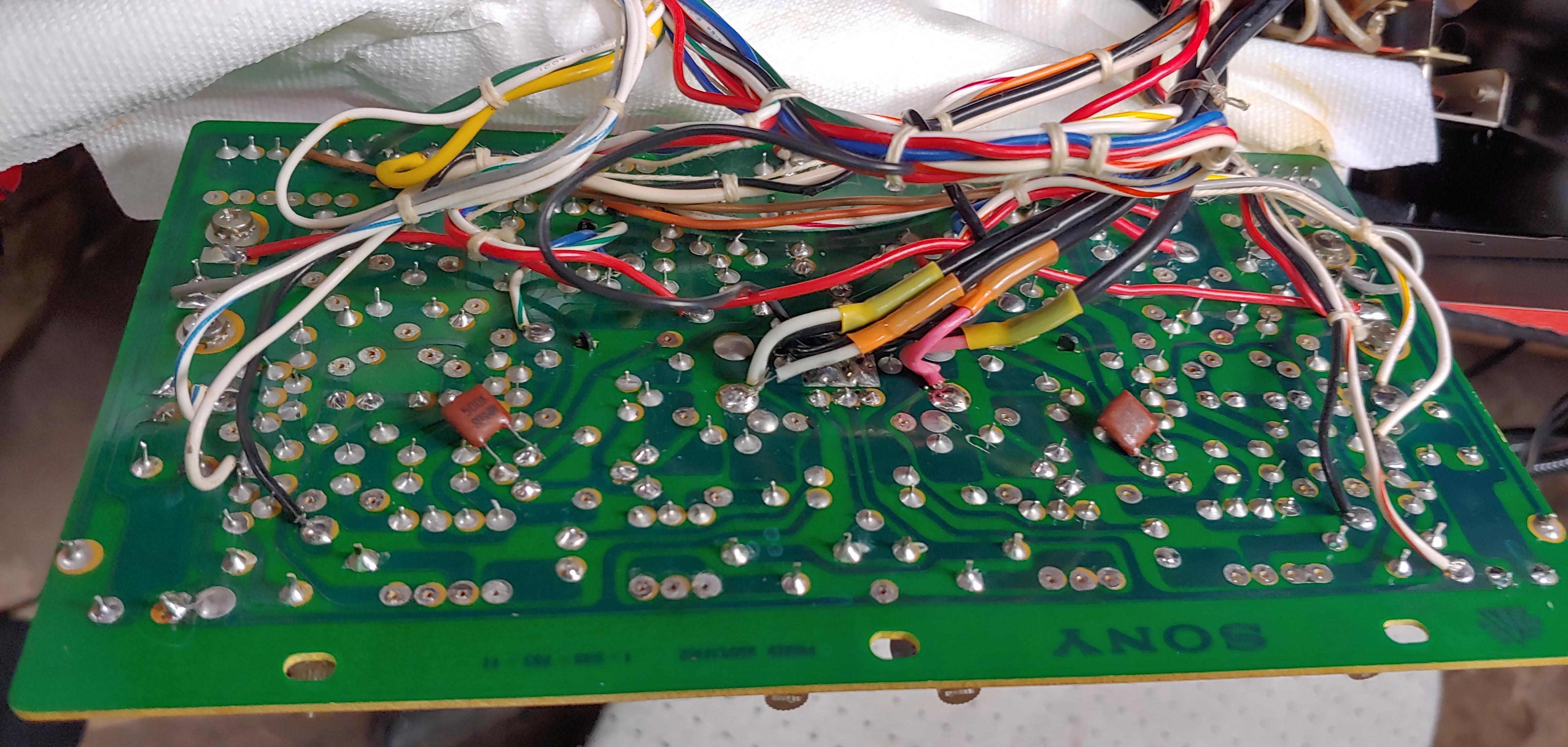

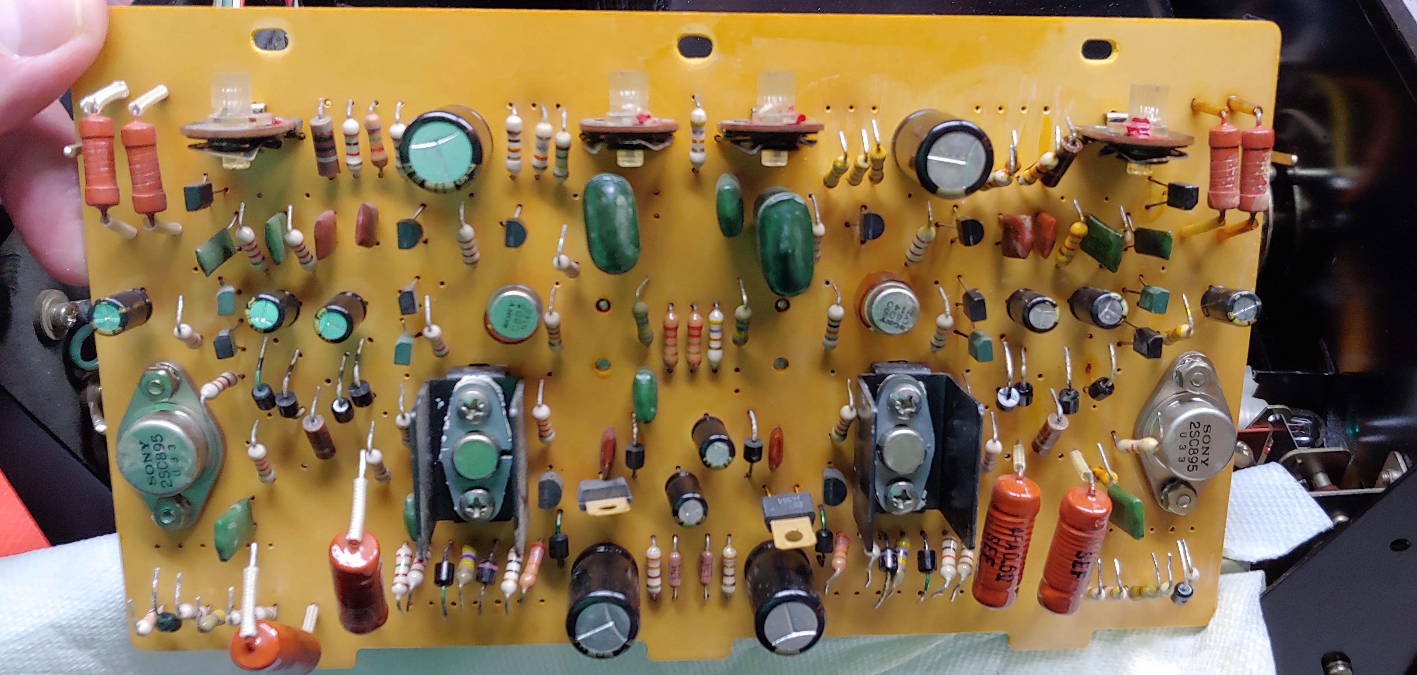

I've been working closely on this for longer sessions - having all this time in my hands... - and here some new information I have to put forth:
- I came to believe someone (prior to my ownership, of course) spilled coffee on this or something of that nature. I kind of thought what I'm seeing in the amp may be leaking caps, or aging PCB, but there was a thick sludge of sorts. It took a lot of work, but I managed to remove it pretty well. See pics enclosed for sparkly clean PCB.
- Having one resistor leg out, I though, what the heck, let's just replace all resistors with known quantities like my faves CMF55/RN55 and such. This is also because it didn't make a lot of sense to wash the old resistors of the sludge till I got so sweat left and them no markings on. It was that bad. Also, fresh, well done soldering counts for something.
- I did junction tests on most transistors - most prominently, the finals - and got to strikes. Everything seems to be in good shape this far.
From such extensive rework - I don't usually rebuild vintage components to this extent - I expect it to just work when I put it back together (fresh parts, fresh solder joints, checks on everything). If it doesn't, I'm going to re-examine everything, and probably re-run Spice it with exact parts used and see if I get stable operation.
Still, a bit stumped and hope somethings pans out and I have it running again fully.

You can see the sludge somewhat in my initial pics (it was worse than it looks). There was crud under the driver transistors, and in some spots I had to scrape it off with a flat screwdriver. As you can see in my last picture, it looks like new now. What you're describing about washing them off makes a lot of sense. I've just used a combination of pure isopropyl alcohol and flux cleaner (both spray cans). In my case, I am a bit worried the shape of the trim resistors (after the spilling and washing), but I have replacements for those too (I couldn't find the exact physical configuration, so a bit of surgery and "art installation" work will be needed; at least, they're new and encapsulated). Also, cleaned pretty thoroughly the trace side too, as it was full of darkened flux and other dirties. Both sides look pretty handsome now.
