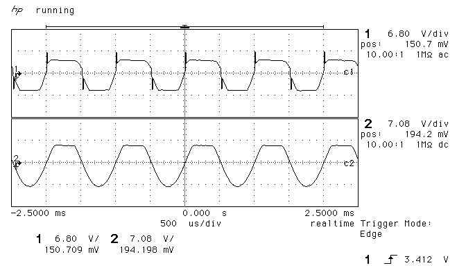

Here's what I'm getting out of this at this point. See enclosed waveform from scope. 1 is R and 2 is L. I input 1.4V RMS 1kHz tone out of AP box. 8ohm loads attached to outputs.
- R: not much useful output coming out, highly distorted, and not exceeding a few tens of mV regardless of volume controls.
- L: Positive part of sine becomes cutoff around a bit past 2V out (was reaching for 2.8V RMS for 1W measurements). This seems to indicate to me one side of PP is broken.

The clipped sine indicates a problem with the upper half of the output stage. Even something as simple as the resistive feed supplying the VAS stage going high in value could cause that... the two series resistors the bootstrap cap connects to.
Also if there were a break in the print (or OC resistor) from the driver to the upper output transistor base or the upper 0.22 ohm being open.
Its very rare to get an open circuit power transistor but I suppose it has to be considered although DC voltage checks would prove that.

So the basic readings all seem OK so we need to look a bit further.
A good check is to place your meter negative lead on the output node (junction of the 0.22 ohms) and work forward looking at DC voltages.
Try and set the bias so that at least there is 'something' flowing and then measure the voltage on the base of the upper NPN output. It should be around 0.6v Now move to the base of the driver. You should see another 0.6v added, so 1.2v in total.
If the upper NPN driver was very low gain or had a B-E short but otherwise OK it would also give you the effect you have of a clipped sine. That might be worth looking at although those two voltage checks should reveal an issue like that.

Which all gets us no nearer The positive clipping is a problem in the upper half of the stage.
OK, so we have to look at the theory and the two upper NPN's form a Darlington which should have tons of current delivery available.
Provided R111 and R112 are OK then I'd guess that something is amiss with one of those transistors. If all the interconnecting paths are good and the 4.7 ohm and 330 ohm base resistors are good then I think we have to try different devices in those locations to prove/disprove the theory.
