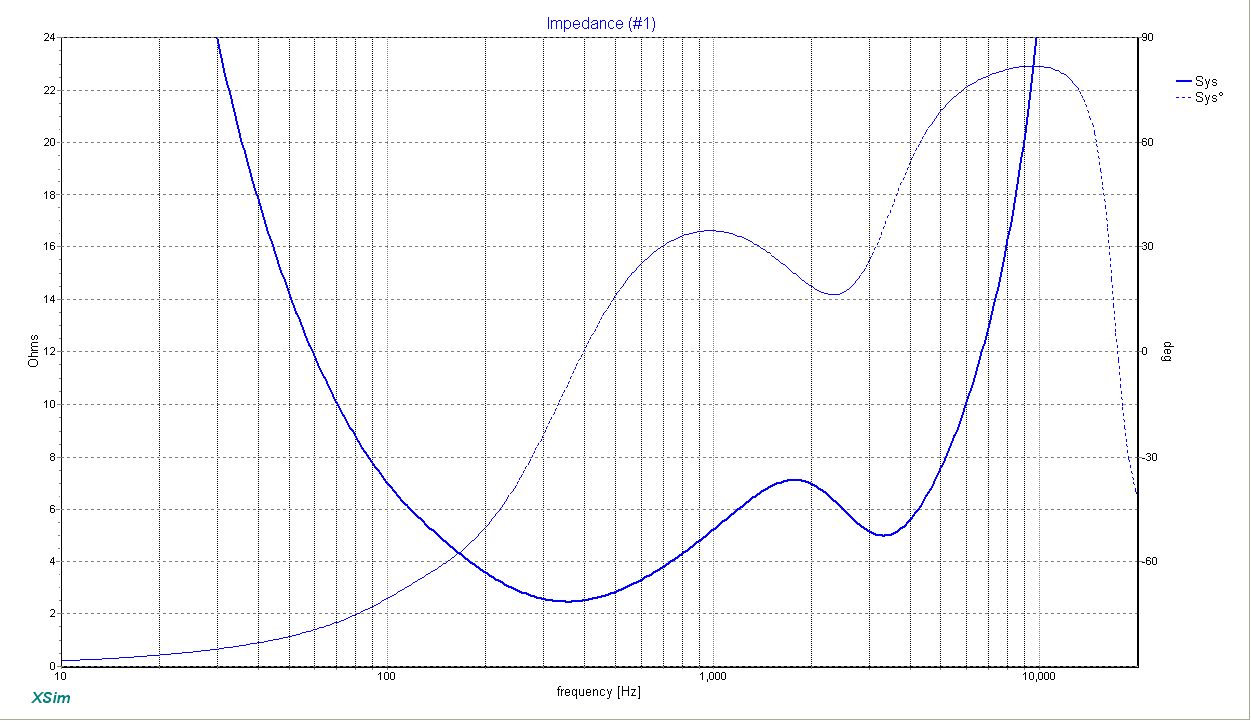

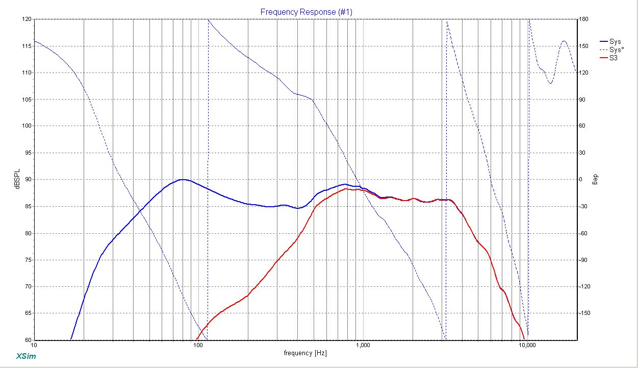

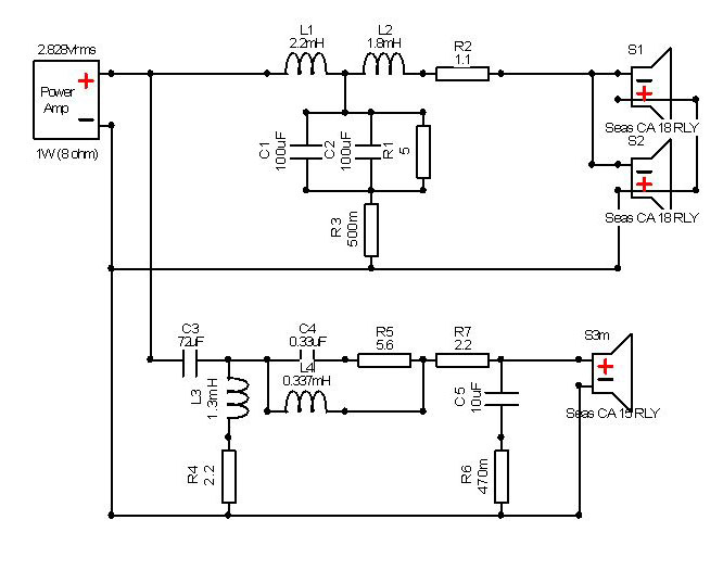

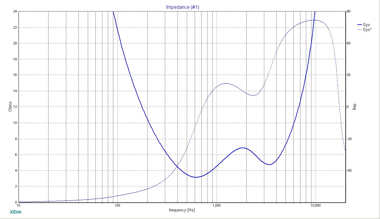

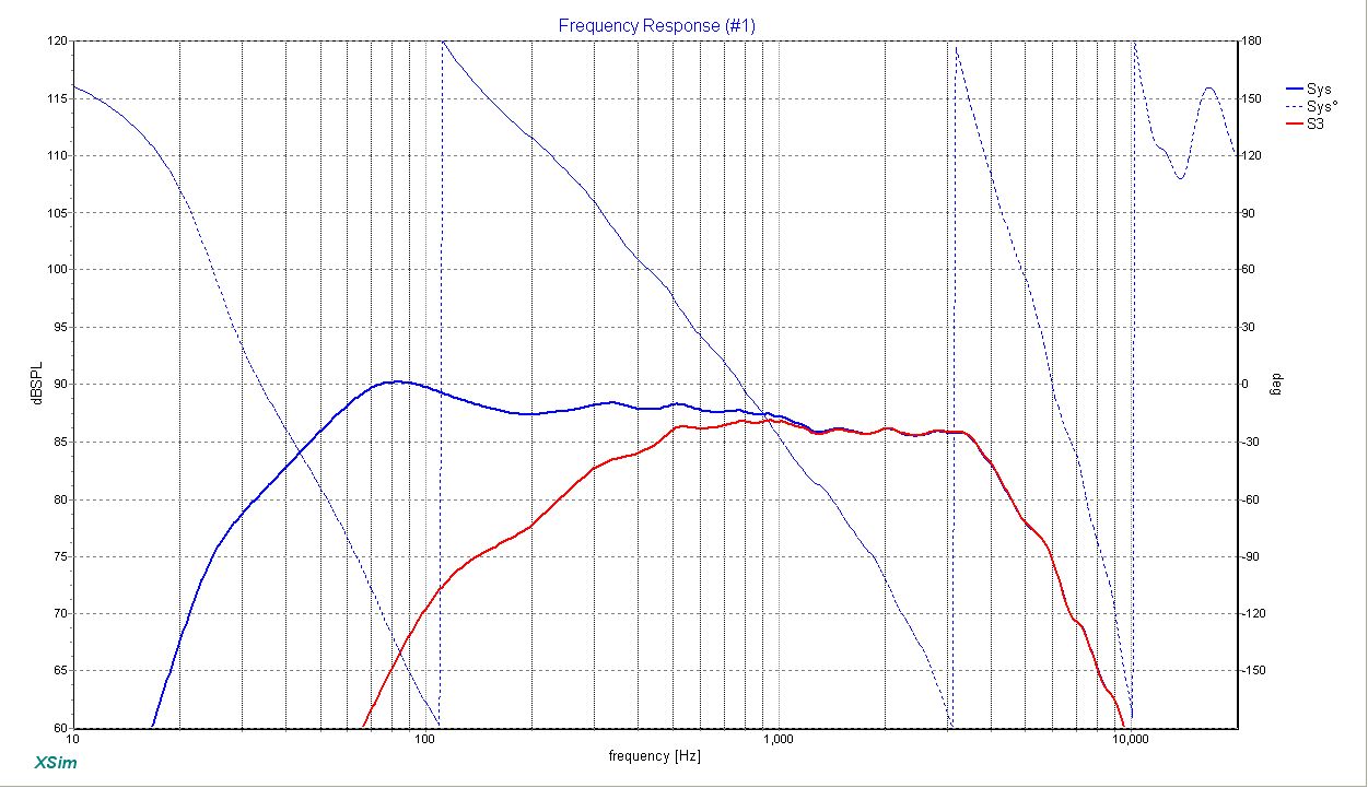

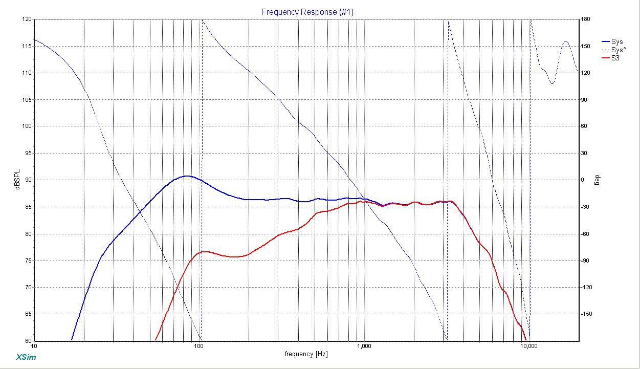

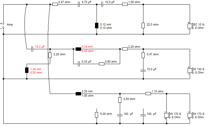

I did a quick mock-up in XSim using ideal drivers. The tranfer functions don't look too unreasonable actually. I still think this crossover went with different drivers altogether.
Did Sonus have another 3 way speaker at the time?
I have also attached the XSim crossover file in case anyone wants to take this further.

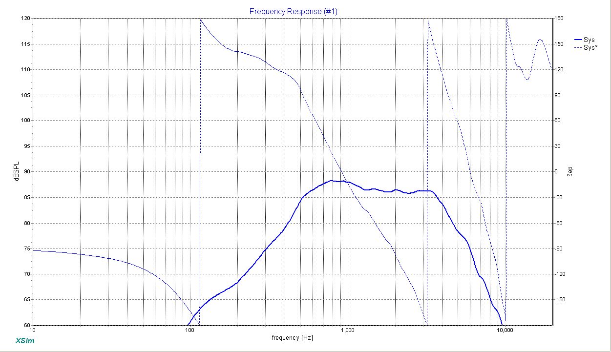

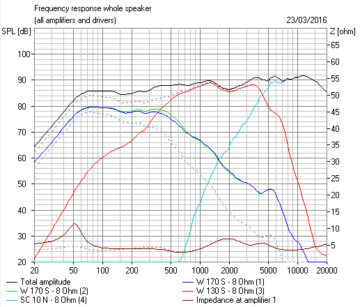

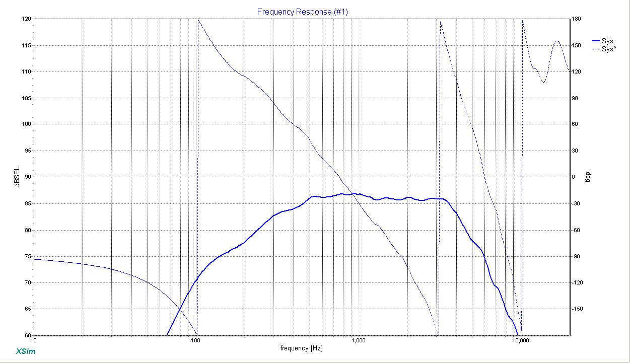

OK, I clearly have no life at all outside of this forum, and to prove it I used SPL Copy to import the data I could find thanks to Steve. Here is the output based on the crossover values and the traced driver data. Driver delay is assumed to be 0. Drivers were phase restored using OmniMic:
attachment.php
This makes no sense. I mean, first the crossover appears ideal for the drivers with no time offset. Also, it's pretty damn flat. Where's the W shaped humps? The only thing I can think of, is we have the wrong drivers, or the cabinet volumes are all messed up?

So, it looks like we have two options: working on the crossover or on crossover and drivers. The thing we do not have info about drivers. I think they are prestige series, but custom made. What measurements can I do to have a full picture?

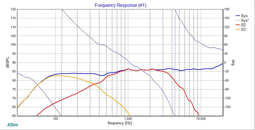

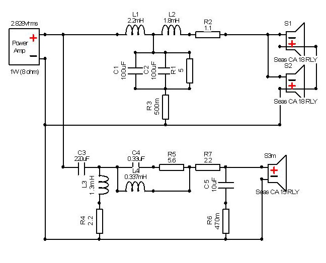

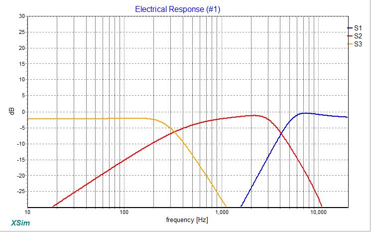

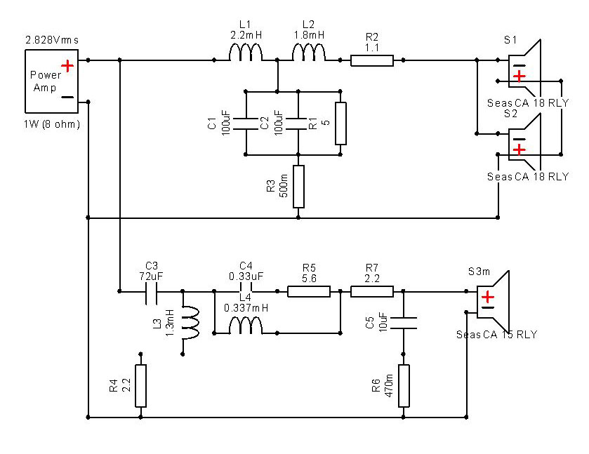

I have prepared a sim that at least resembles somewhat to measurement you
provided. It wouldn't take much of your time to try 2 mods. First is to cut the
wire between 2R2 and 1,3mH which might improve the sound in woofer-
midrange part of the spectrum or a second one to bypass the 72uF(50+22)
with a 150 uF NPE.

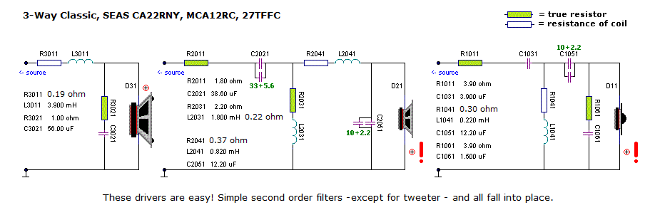

Lojzek, TBH, I'm a bit dubious about what you have done here.
Is it a good idea to work the mid harder here? Surely if there is a bass issue, it lies with the bass filter. Two 6" basses can hardly be stressed.
IMO, the mid filter could do with some change, but not by lowering its crossover point. The whole 3 way idea is to save the mid any bass duties, thus lowering distortion.
Troels Gravesen's 3 way classic uses wildly different mid crossover values.
SEAS-3-Way-Classic. Below.
We don't know what the drivers are exactly, but certainly a SEAS 5" mid without dustcap, which may explain the midrange hole. The exact SEAS 6" basses aren't mission critical IMO. Woofers are woofers.
My feeling is that plugging the reflex port is good to reduce an apparently lumpy bass.
Without knowing much about the drivers, I feel that a simplified bass crossover and the reflex mod will largely fill the hole. Easily doable. The mid, I can leave for another day. There may be some level adjustments required for a good balance too. A little bit of scope there.

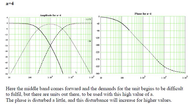

Anybody remember the woefully bad Wilmslow Audio Prestige project?
http://www.diyaudio.com/forums/multi-way/210627-wilmslow-audio-prestige-platinum-72.html#post4326410
Great and expensive drivers, but an apparently random crossover and tonal balance. But IMO, crossovers are an established technology. We aim for Steen Duelund curves and it mostly works out. This is our hope and expectation. 😱

My attempts at simulation were just to see where things would be if optimal. Often simulations and models provide a best case scenario, and when our real world examples don't match it is when we go looking for ways to improve.
This is one of those cases, I think. 🙂
Measurements of the drivers in situ should be next. I'm very curious to see just how you make a W shaped curve out of those drivers. 🙂
