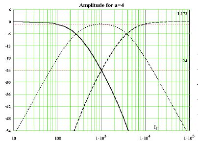

What I hope you might take away from this is that you can adjust things if they aren't working for you. It's a fun hobby where the individual can take control. We have a good theory how it works, below.

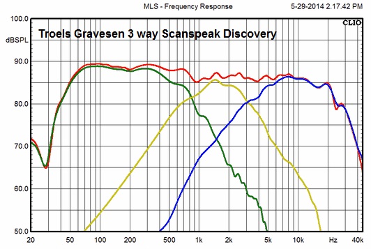

I think you've done very well here. IMO, the coils are a uncomfortably close to each other, which might cause some interaction, but the levels are easily adjusted with the red resistors.
Troels' 3 way discovery is not dissimilar, even down to the ring-radiator tweeter, which seems a good design.
ScanSpeak-3W-Discovery
A bit of BBC dip is indicated. If it sounds bright. But close to a wrap and some hot-glue maybe.

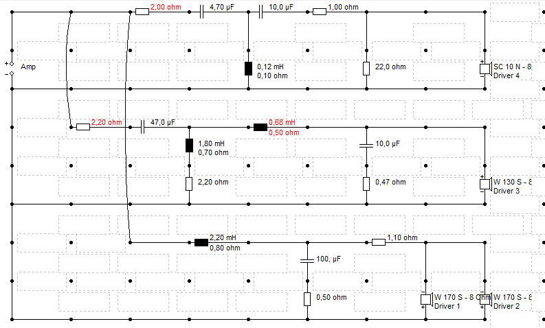

Here it is "As Built".
The way I mounted things, I can add resistance to both Mid and tweeter at the binding post, so it's easy to make some fine tuning. If I have to address tweeter and mid separately, I'll have to pull the crossover out. I think I've better wait a bit, listen and make some measurements, then reconsider.
