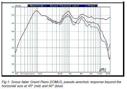

My speakers are the model after what you posted. I attach the only measurements I found, but I suspect a similar problem.
I suspect that it's not too different and I have the experience that they sound quite good when corrected with a tool like Audissey, but with no correction it's like a chorus where everybody sing on his own.
They actually improve if the bass reflex duct is reduced in diameter or even closed.
They look nice, so I'd like to try to redesign the crossover to improve it, but it would be a first time with me, so I am open to guidance !!
Can you elaborate on what do you think are the issues of this speaker looking at the graphs ?

It's quite a pretty speaker mechanically.
TBH, I'd view the heavy 2.5 way bass response as being potentially irritating.
Hence your tendency to block the reflex port.
But, TBH, without a schematic of the crossover, it's hard to suggest an improvement, though diyaudio.com people are good at this sort of thing. First order is all very well, but tends to high distortion with complex program material. Bi-amping is hardly going to get you out of the hole.

that fr response is much worse than any diy speaker, something not right here

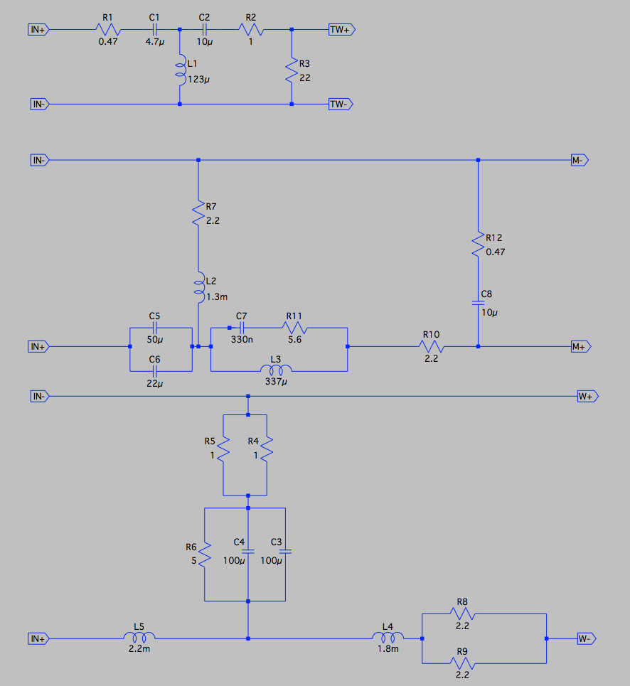

While you are in there, you'll get to the crossover. Pull it out and draw a schematic for it using XSim. Of course you'll also get to see the driver models, if any. Note those as well.

Although the SP's measurement protocol isn't one I agree with, the measurements they post certainly point to an incompetent crossover. Far too much extreme HF, and a very rough (appalling) crossover region. This is not going to be a smooth-sounding speaker, and using a 1st-order crossover with inexpensive 1" dome tweeters is asking for trouble (overloaded HF and eventual failure down the road).
The main virtues of the speaker appear to be a pretty cabinet and a very successful marketing campaign. You can't copy the marketing campaign, which leaves the cabinet.

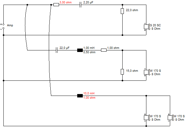

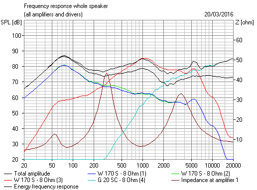

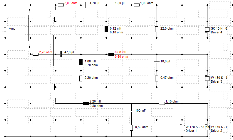

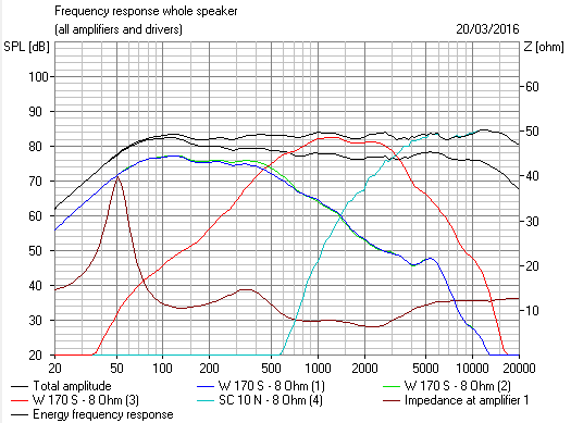

I did a bit of work tonight based on a low order crossover and the published frequency response.
This is a lousy speaker IMO. We must wait and see what the filter actually is, but it looks like it stinks at many levels. Below is my remarkably predictive frequency response. I also tried a proper 3 way filter. A bit inefficient, but how it should be done IMO. Why do people put up with low order crossovers? They just plain distort on complex program material as Lynn often says.
