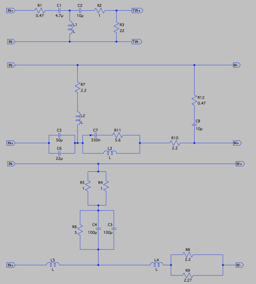

Attached the schematic that I drew. Please check if it makes sense. I have rechecked it 100 times, but I might not see my mistakes.
I don't know the values of inductors so far.
I contacted SEAS hoping to have some specs of the drivers, but they refused.
Woofers are in parallel.

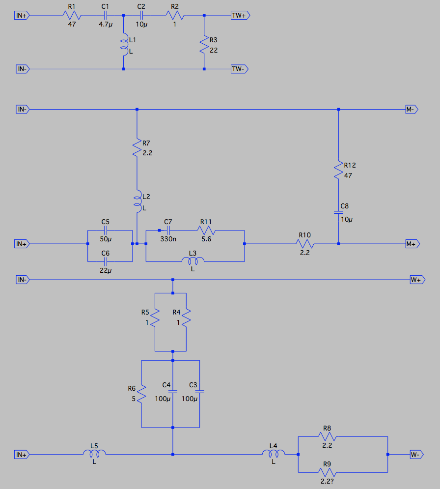

Thanks,
Davide
R1 47 ohms???? did you mean 4.7 ohms? Are those 3 white cement resistors stacked next to the woofer coil?
Looks like all 3 circuits are 3rd order and the woof and mid are wired out of phase with the woof and tweeter in phase.
I presume those are high wattage cement resistors (white ones) next to the woofer coil? Most unusual to see resistors in series with woofers because of the current load in that circuit.
R1 is likely 0,47 R because if it were 47R, then
it would have been labeled so, as shunted 22R is.
You are right. R1 and R12 are marked R47, so they should be 0.47 ohm. While R3 is marked 22R so it should indeed be 22 ohm.
The three cent resistors are R6. I can read only one that is 15 ohm, so as a first iteration I assumed they have the same value, but I will remeasure when I go to a more intrusive phase.
Woofers are out of phase, while tweeter and mid are in-phase.

It appears that LP woofer filter part is attenuating too much with its
rather large cored inductor value and the accompanying 200uF's.
Assuming the driver polarities are correct (woofers out of phase),
you could fill the gap by decreasing the L5 value and the same for the
big bypass caps (C3,C4).

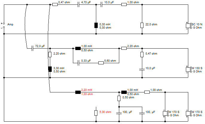

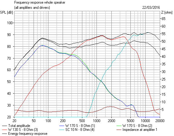

Yup, looks like the bass filter is too steep. I fixed the hole with a smaller L5 coil at 2.2mH. Drivers like these.
H1217-08 CA18RLY
H1216-08 CA15RLY
The hole at 1.5kHz is altogether harder to explain. Phase seems right. Maybe the removed dustcap on the mid is the problem?
Altogether a good filter, but the 5R on the bass section, which reduces level 2dB looks a bit wierd. It must get HOT! I'd lose it, and maybe up the mid and tweeter levels to compensate, if it's too bassy. I think you must measure those coils. Multimeters with an inductance scale are invaluable.

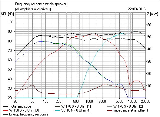

We seem to be back to the bad filter response:
There's a lot of odd values there, IMO. A lot of of the lump in the bass comes from the reflex tube. Stuffing a sock in it seems a good plan. Still don't like that 5R.
The coils in the mid filter are too small. I don't know what the 15kHz tank notch is meant to do. The tweeter filter is a kinda regular 3-4kHz design for a 4 ohm driver. Lot to think about there, it seems. I think the engineer got fed up with this one, and did some quick and dirty fixes.

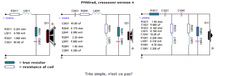

I looked at a design with a 5" SEAS midrange, below diagram:
Poor Man'
Really the trick is to get the midrange on a smooth curve, and build the rest around it. I reckon it wouldn't be hard to fit a MCA15RCY mid, as it goes. 🙂
Doubling up the basses is simple enough, halve the coils and resistors, double the capacitor. It seems to work better. With 2X 6" basses, I used 2.2mH and 0.47R and 100uF for the bass filter. The SF mid section is still way off IMO. I think some new bigger coils needed.
