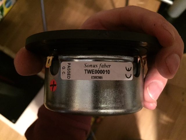

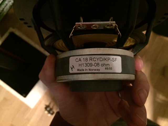

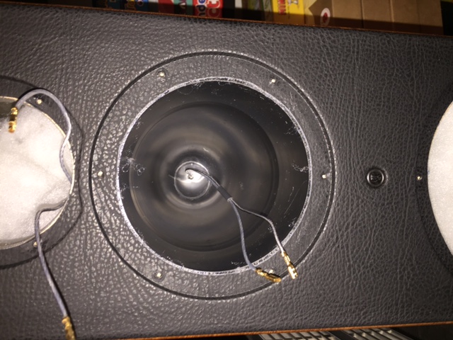

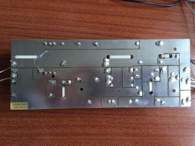

Dear All,
Let's try to fix this: I have done some homework and disassembled the speaker. I am drawing the schematic of the Xover.
The driver are like in the picture. It's interesting that the midrange has its own enclosure. The woofers are in parallel.
Attached some pictures:

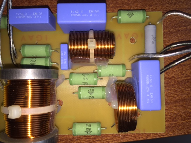

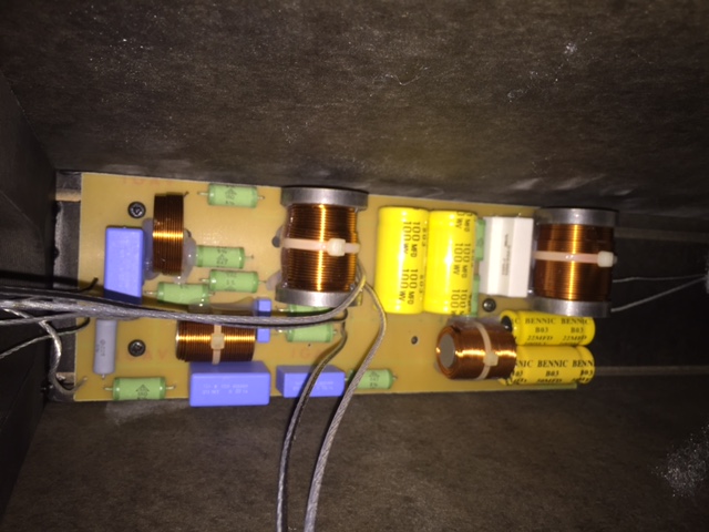

Very interesting!
The crossover also looks interesting. Jantzen air and p-core inductors, but less expensive caps.
Lots and lots of caps and resistors in this crossover, I can't wait to see what it finally ends up looking like!
I still wonder if the entire XO design wasn't meant for different drivers.
The woofers were probably Seas with a Scanspeak tweeter? Hmmmm.

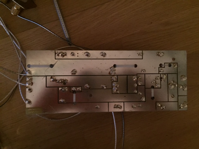

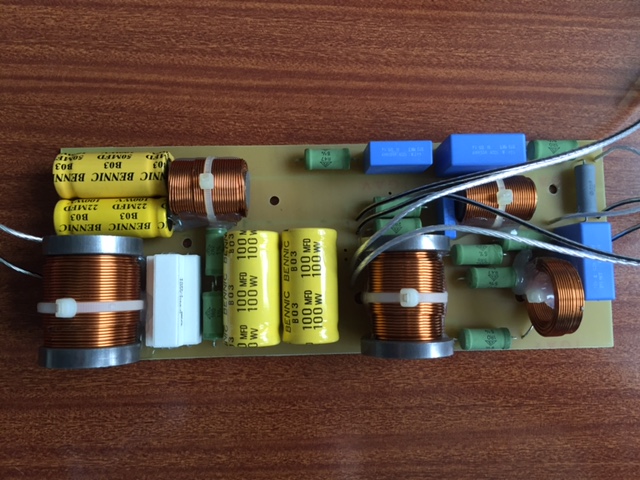

Dear All,

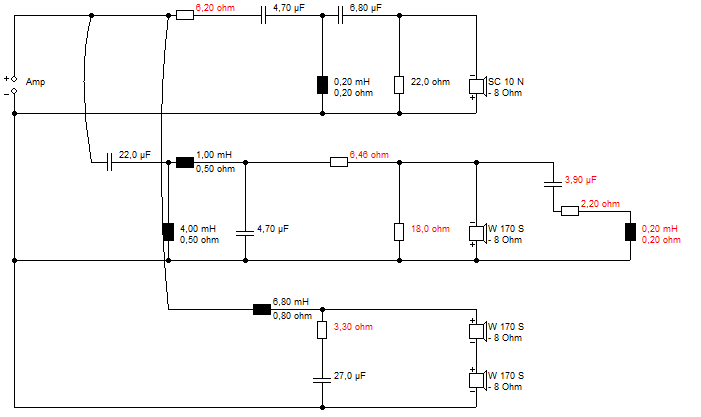

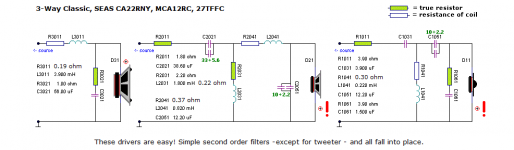

Clearly we must upgrade our impression of Sonus Faber crossovers:
This is not some Mickey Mouse first order jobbie. The 6" SEAS paper bass drivers, 5" SEAS paper midrange and vifa/scanspeak ring radiator tweeter speak of the sort of quality we might expect from a £4,000 loudspeaker. 🙂

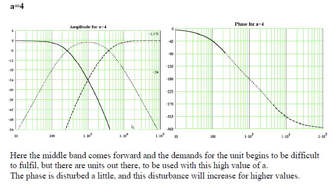

It's always quite hard to disassemble a 3 way crossover. I'd guess the top right is the bass section. The best help I can give you is that this must resemble the three way classic:
SEAS-3-Way-Classic
I'd be looking for something like below.

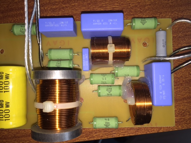

Try to take a better shot of the boards, from both of the
sides, so one can read the values without a problem. Check
the photos before you upload.

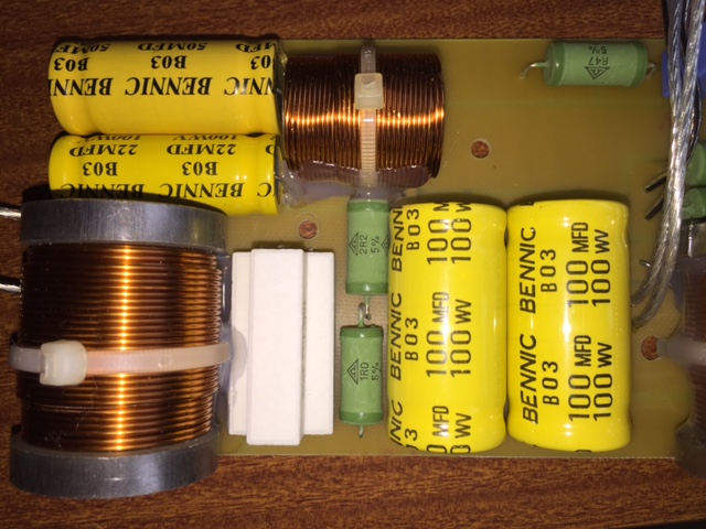

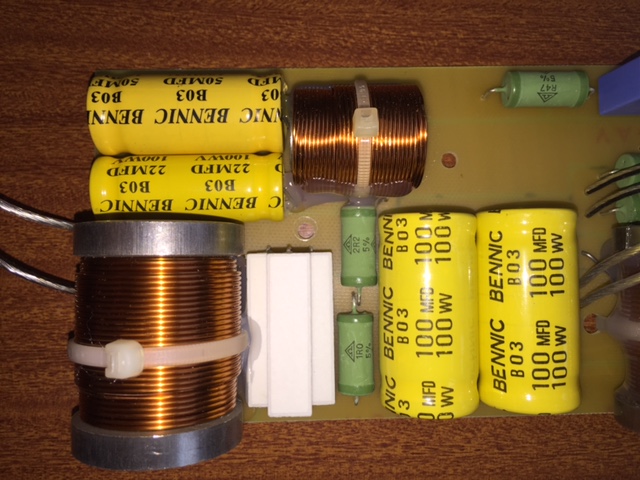

Here are more detailed pictures. There are values on the resistors and capacitors, but I do not see and mark on the inductors. I could pull them out and measure DCR and L, but at what frequency do you measure L ?
First thing that I noticed is that the woofer have opposite phase of the mid and tweeter. My AVR was always giving a warning about this.
D.
D.
Unless you want to go boutique (i.e. $$$$), those blue, PP film caps should be fine as is. Test a few NPE's for uF and ESR to see if in spec. I suspect they will be because Bennic is a good cap maker, at least in my book.
