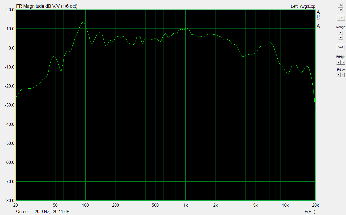

Driver DC resistances would suffice, wouldn't they? Just to make sure there are no obvious pratfalls here...
I'm seeing a correlation between the measurements here:
Really the question for you is WHAT IS WRONG WITH THEM?
I'm seeing too much bass and some dips in the midrange and too much tweeter rolloff. What are you hearing?
1) With the port open, I definitely would say boomy basses. I find interesting to see that the port affects mostly below 100 Hz.
2) In general I would say that the sound is closed and the instrument "disconnected" between each other.
It's difficult to verbalize.

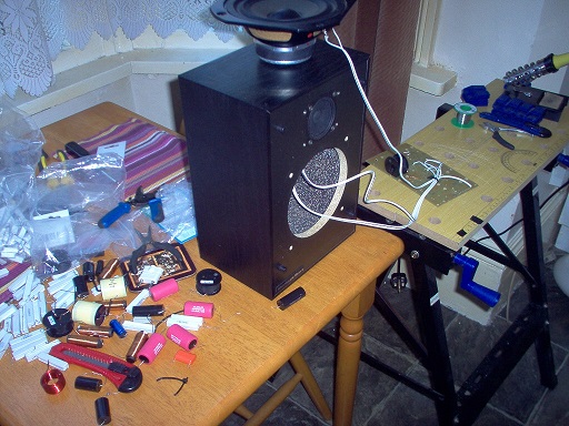

Once again I'll put a marker down so I can remember what we are doing here:
Somehow I thought this sort of thing was better:
The bass circuit can be adjusted in situ IMO. Quite easy in fact. Bit of unsoldering with that copper braid to soak it up, and solder a piece of 20-30A fuse wire (it's tinned copper really...) across the second coil. Quite reversable too. And I thought the port was best closed anyway.
Maybe some level adjustment later on tweet and mid, but the only other thing was to remove the tank and increase to 0.68mH in the mid. There was also the thought of putting the 1.8mH in the mid and unsoldering the 22uF. But I'd do the bass section first, and have a listen.
That's only hot glue, my friend. It peels off a PCB with a blade. It comes off with hot water. Messy job, but doable. Most components are waterproof and safe up to 85C. But I might try to keep the electolytics from water. And you can buy new nylon zip ties easily enough. Nothing hard there at all, IMO.

Why do you need ANY new components to modify the bass filter? 😕
You do realise that two existing 1R resistors in parallel make the 0.47R in my schematic? And the 1.1R is just two 2.2R in parallel. I did try to make it easy for you. 😎
Ready for testing. I also managed to put the 2.2 ohm on mid and tweeter. Probably testing tomorrow, let's hope in good weather🙂
D
Davide, this is good! Truly diy! 😀
So we're mostly going for the whole thing here?

The 2.2 ohm resistor is made with two 1ohm + one 0.22 ohm in series, so I can ply with the value. It's one for both mid and tweeters. The bass crossover is disconnected, as I reused the big coil.
