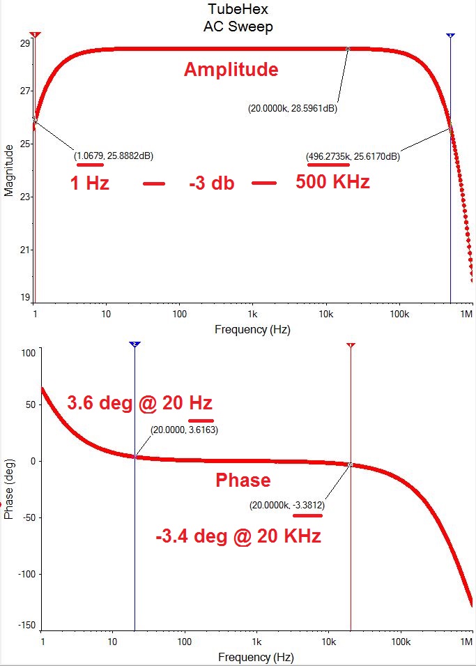

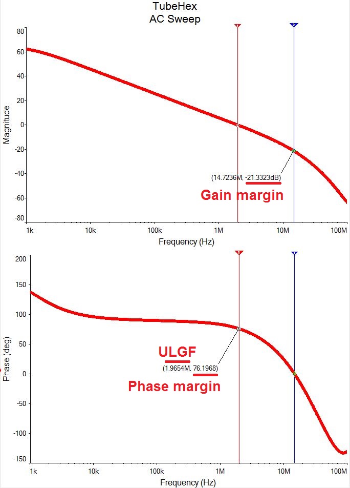

Feedback loop AC analysis and closed loop Bode plot.
ULGF ~ 2MHz
Phase margin ~ 76 degrees
Gain margin ~ 21 db
1Hz - 500KHz bandwidth @ -3 db level
3.6 deg phase shift @ 20 Hz
3.4 deg phase shift @ 20 KHz (negative)
Pretty cool 😎

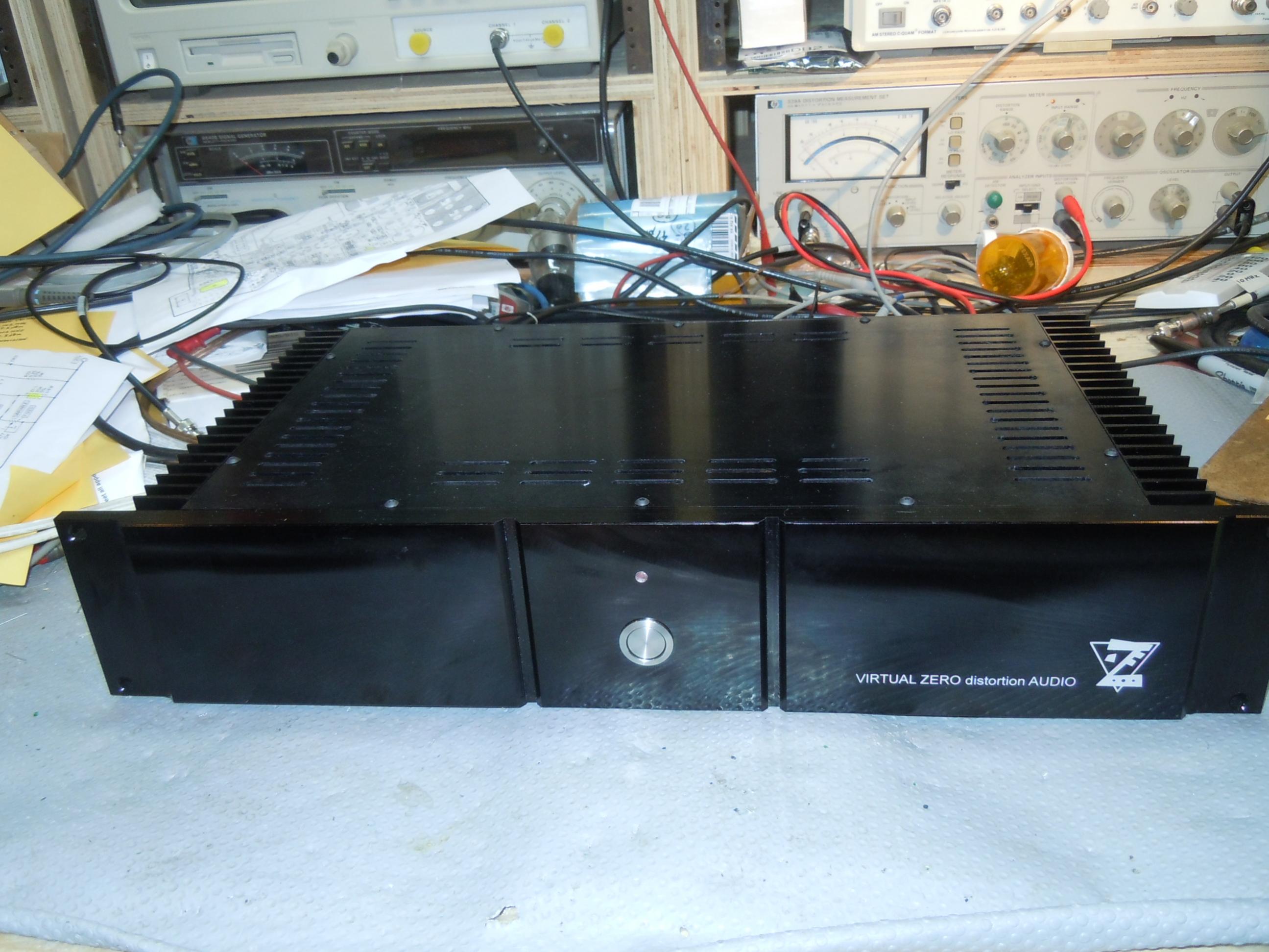

I've just finished doing some noise and distortion testing on my VHex+ amplifier. This is a complete stereo amplifier with simple dual supplies and a single main transformer under noisy florescent light in real world conditions.
At 1W output THD
1kHZ 0.0039%
10kHZ 0.0079%
20kHZ 0.013%
At 50W output into 8 ohm dummy loads
1kHZ 0.0059%
Noise floor with open inputs 0.17mV
Noise floor with shorted inputs 0.08mV
I'm very impressed with this little amplifier!

When I saw those numbers, I was also very pleased with the performance. That amplifier was basically immune to the florescent lights that put out a nasty amount of noise around 28, 56 and 84 KHz. I just stuck a wire into my audio FFT analyzer (HP 35665A Signal Analyzer) and got those approximate numbers. Jeff turned off the lights and we saw very little difference in the THD readings using only the 400 Hz high pass and 80 KHz low pass filters. That is excellent noise rejection and one of the best I have seen on this bench.
Of course we used properly shielded signal leads, but the speaker loads were connected by a zip-wire style cable, #16 gauge wire. The loads were 8R 250 watt Dale dummy loads, the industry standard. The test setup represents connections that would exist with decent quality RCA signal cables and your average speaker wire. So these tests do not represent some unattainable setup, but rather performance that anyone would expect to see from their own setup.
This amplifier is pretty to look at as well. I wouldn't have any problem looking at it in my system, that's for sure. These are real performance numbers measured on my bench without any connection between me and Valery's efforts. Jeff simply asked if I would measure the amplifier, and I didn't even know what amplifier I would be looking at. So there you go.
Too bad the picture I took doesn't do this amplifier justice. It's more shiny and deep black than it looks, and my bench is a disaster zone. But, here it is!
Great job guys! -Chris
