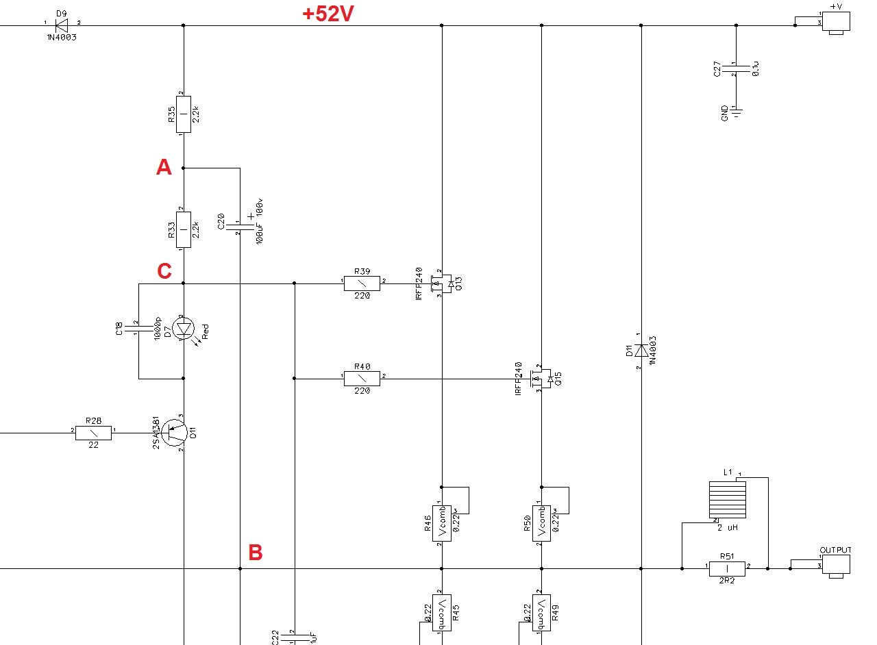

The way it looks to me, the positive side of C20 is on a voltage divider which would limit it's voltage to a minimum of half rail voltage. The negative side is connected to output which will swing close to negative rail on full output. How does it only see half rail voltage total?(Not disagreeing with you, just trying to figure out how it works)
How the bootstrap works

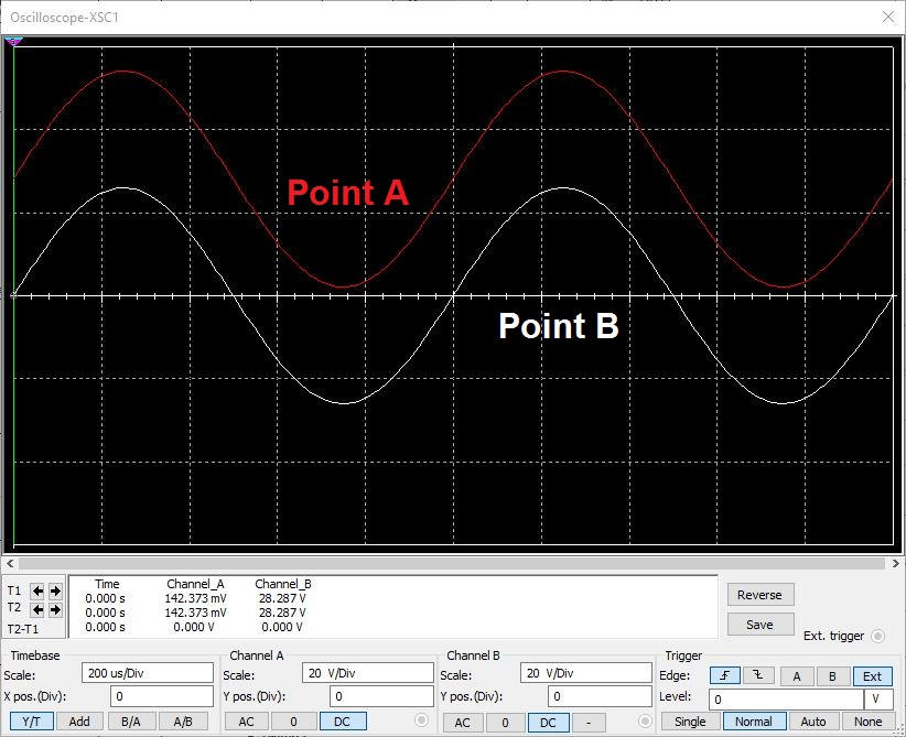

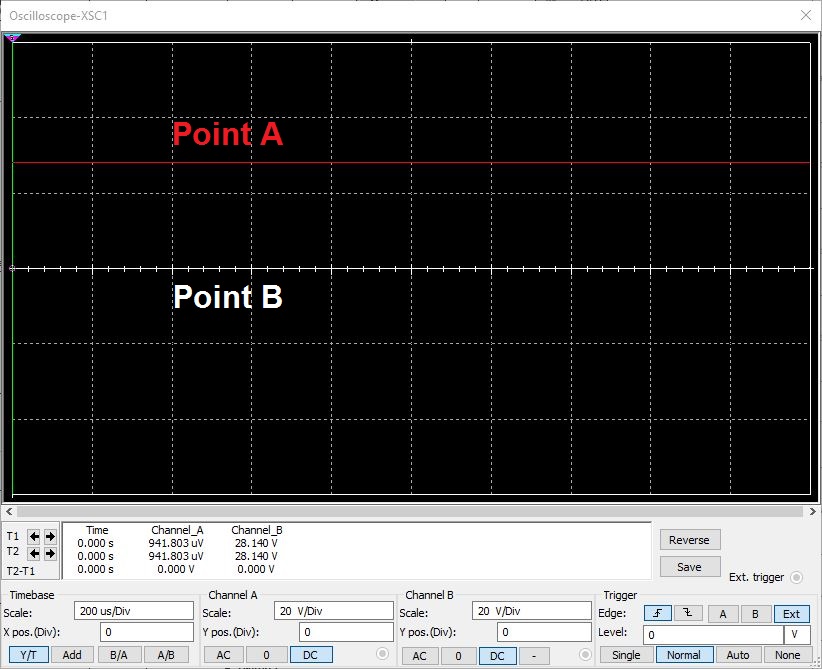

OK, here is how it works - see the fragment of the schematic.
Point B is the output. With no signal its potential is 0.
Point C is our bias. Referenced to B its around 4V.
The most interesting - point A. With no signal its potential = (52V - 4V) / 2 + 4V = 28V.
So, the bootstrap capacitor, C20, sees 28V.
Now the magic starts. With signal, because C20 always tries to keep the potential it's charged to, point A follows point B very closely, keeping the voltage drop over C20 CONSTANT. This is the key to the whole thing.
See the curves (static and dynamic). Red - point A, white - point B.
What it gives us - basically 2 key things:
1) Point A can easily go above the rails. Meaning, we can have rail-to-rail output swing without the need of additional lifted-rails PSU for the front-end.
2) The driver's (Q11) dynamic load impedance is very high - the bootstrap circuit behaves as CCS. Q11's idle current = (28V - 4V) / 2K2 = 10.9mA.
As we have seen above, this voltage (28V - 4V) stays virtually constant at any swing.
So, current through Q11 also stays virtually constant at any swing. That means, despite the fact, static load of Q11 = 4K4, dynamic one is MUCH higher. With signal Q11 sees much higher value, than 4K4. Same thing, as if there would be a CCS here - well, not that close to "ideal", but still.
In the ideal world:
Dynamic load impedance = (delta V / delta I) at the emitter of Q11.
Delta I = zero (as voltage over R33 is virtually constant, "I" does not change).
Dynamic load impedance = (delta V / zero) = infinity, regardless of delta V.
In reality, delta I slightly differs from zero, so it's not exactly infinity, but stays rather high. My simulation is showing the load value = around 61K @ 1KHz there. At 10.9mA standing current - more than enough.
So. One capacitor - C20 - does fantastic things here. Consider it as dynamic level shifter. Same thing - C21 in the negative shoulder.

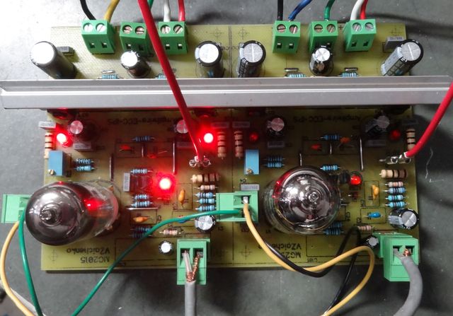

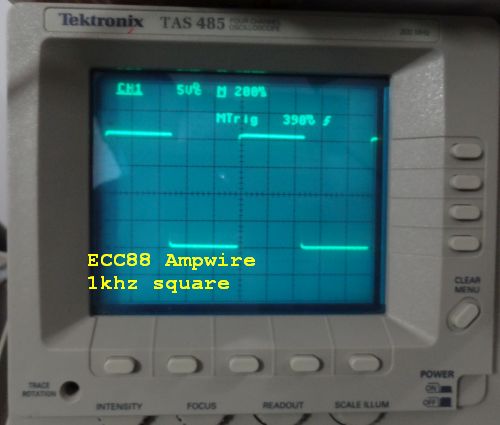

Guys, we kind of forgot about the excellent version of VHex's front-end with 6DJ8 / ECC88 tube at the input.
It's been tested by Terry in December 2015 (called AmpliWire/Tubie at that time) in combination with the miniSlew OPS - see his post here (I'm just re-posting some of his pictures):
Tubie test with miniSlew
There is also a good front-end layout, designed by Marc (Idefixes) here:
Tubie front-end layout

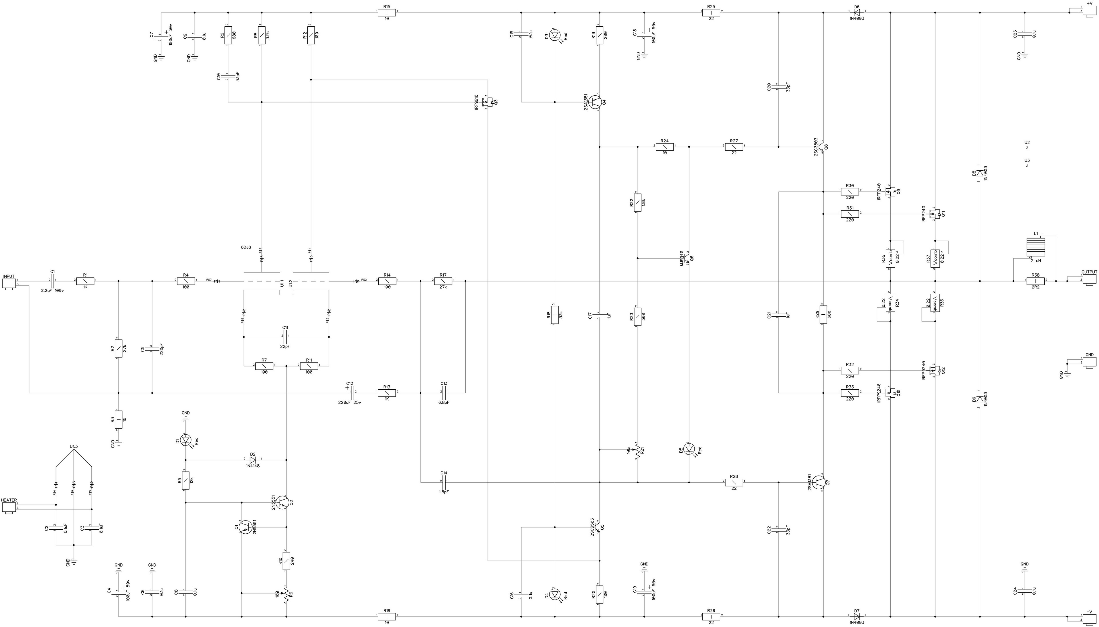

Attached is the full schematic, including the Tubie front-end and VHex OPS.
Current drive with the tube at the input + HexFet OPS - this is going to be a coolest amp.
The layout needs to be updated, incorporating the whole thing though...
