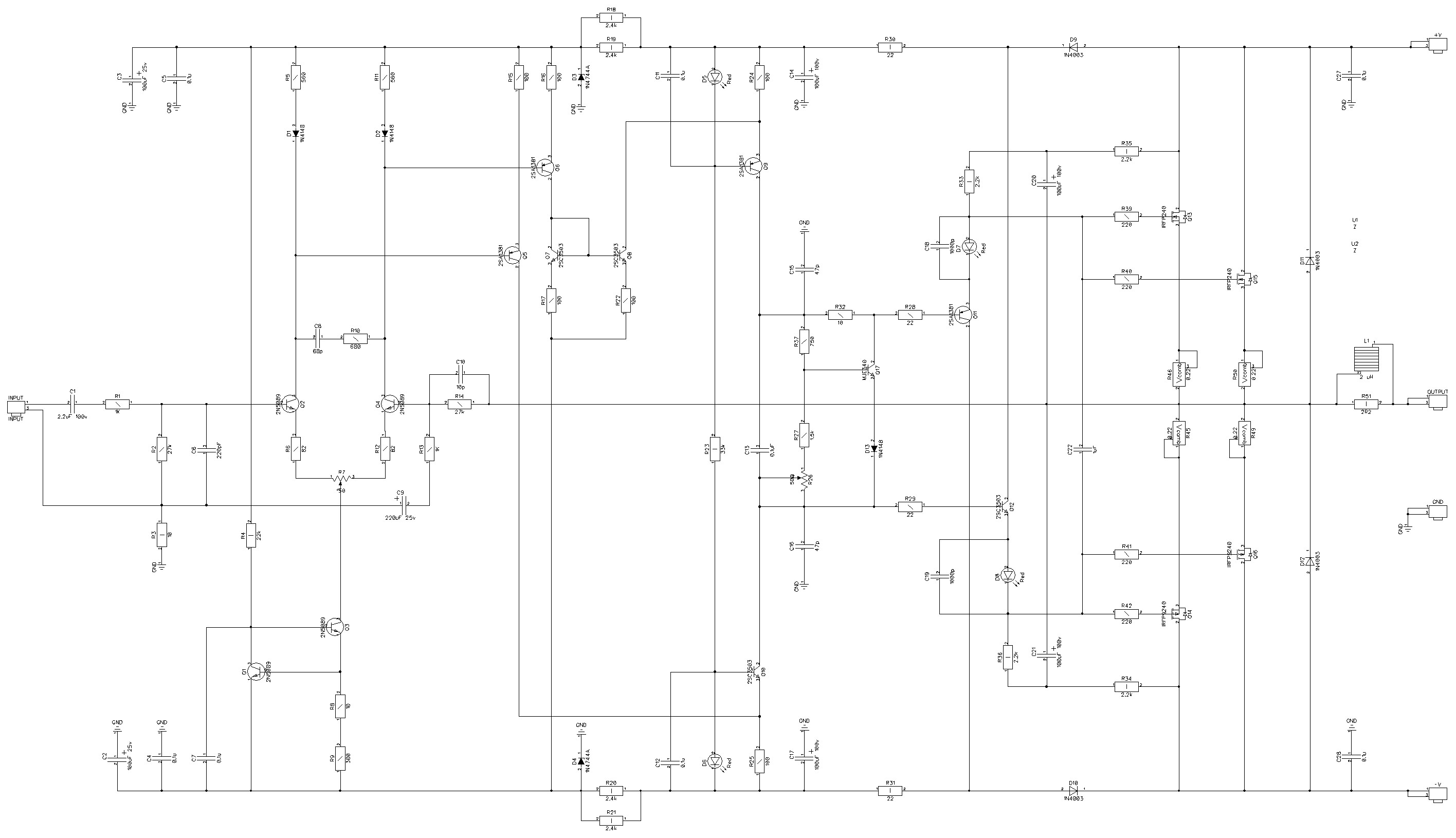

OK, today I have finalized testing the new VHex+BT.
During the long term tests at high swing I have noticed that at high temperatures the drivers' tempco hardly compensates the bias of the OPS, so I have added a low-sensitivity spreader, assisting the drivers.
Now it's perfect! :up: Tested like hell 😛
Double bootstrap ensures almost rail-to-rail operation, the sound is excellent - very comfortable for listening during a long time 😎
Final schematic is attached.

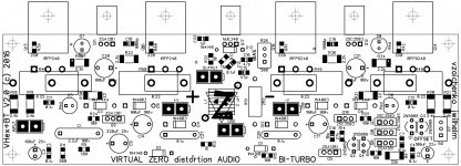

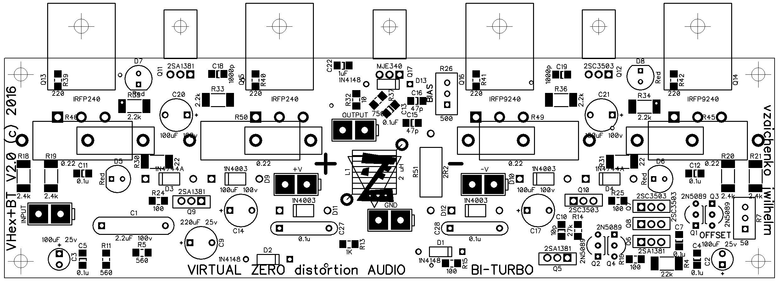

Good to know. I'm running nearly 20mA into the folded drivers feeding a single pair of IRFP640/9540. It sounds like I could pull that back significantly.
Have you considered boosting the voltage to the IPS/VAS to improve efficiency further?
Yes, half of it should do the job.
Well, efficiency is already pretty good, although I had to decrease it a bit by changing the 3.3V Zeners in the drivers' emitters with 1.7V LEDs in order to arrange some headroom for the bias spreader.
Even in present setup, with +/-52V rails, it clips above 45.5Vp (32V RMS), driving more than 120W into 8 ohm.
Yes those LEDs are an elegant touch. Kind of like a level shifter to maximise swing. What part of the bias generator do you mount on the MOSFET - the NPN or the diode?
I like this design of yours very much. Particularly the output stage - a relatively simple but very effective way of driving these Hexfets!
One last question :-D
The output impedance of those bootstraps is a lot less than active current sources. Do you sacrifice much loop gain with this approach as a result of the increased load on the VAS? If its a problem you could add an active CCS in series with the bootstrap - but that would add a lot of parts.
